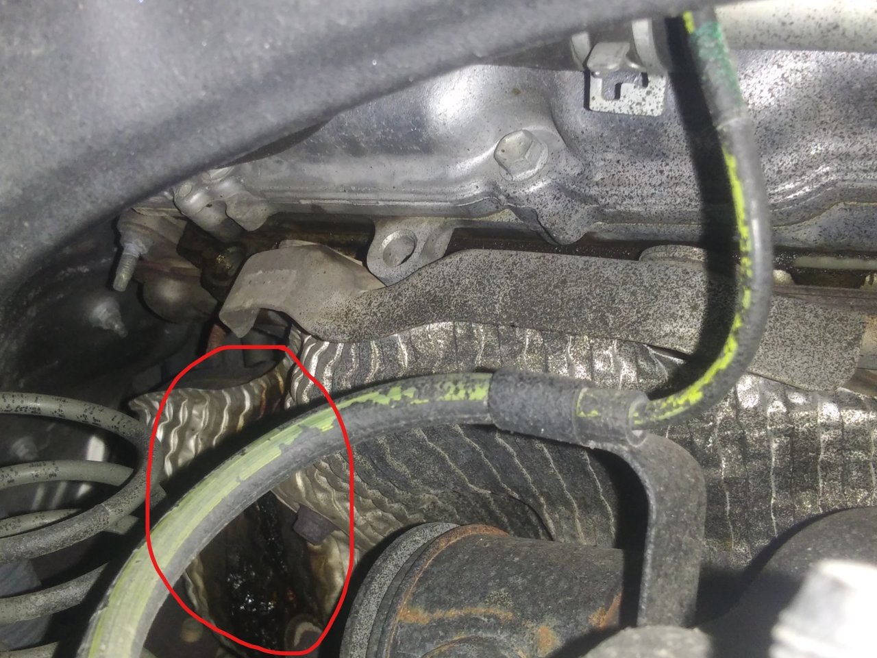

    This is very similar to mine, albeit a tick worse, and the dealership I took mine to told me there was nothing leaking on mine... Same situation, only my passenger side is leaking.
    Now, I did take pics prior to having them look at it (they also did a 4 wheel alignment the same day) and when I got it back, the valve cover and corresponding area was cleaned up with degreaser.
    Prior;
    After;
    jtwags likes this.
