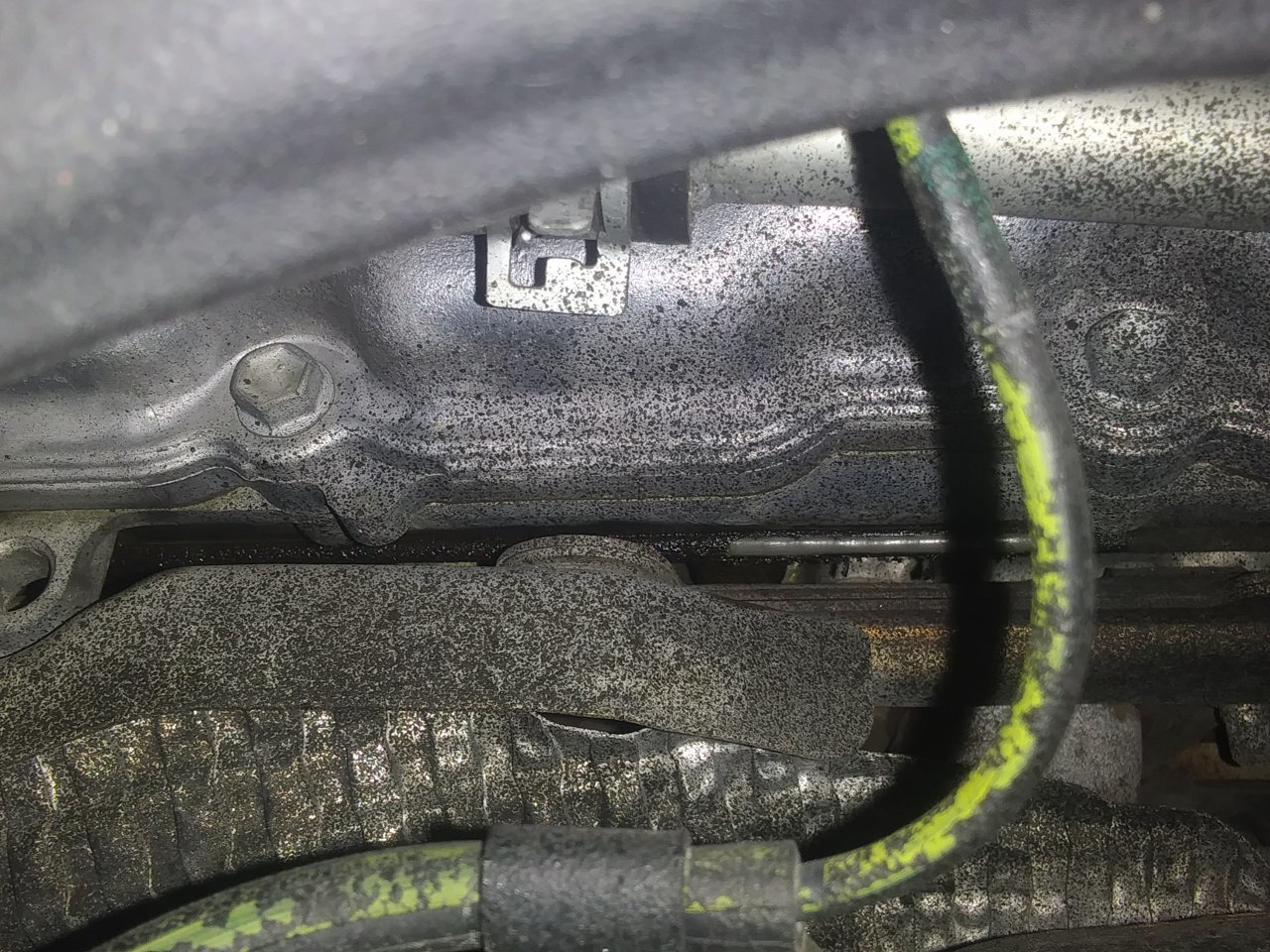

    Went out this morning to check.
    2016 with 32,000 miles. Bought Certified in Nov 2017 w/ 4,500 miles on it. Added the 100,000 extended bumper-to-bumper for ~$1500 (it’s still inside 3yr/36,000 though).
    Driver side is clean as a whistle.
    Passenger side:
    (2nd photo is rotated 90degrees)
    This is cam tower seal that’s leaking right??
    Not at all what I wanted to find, but I’m in warranty and there are worse things to happen in life. We’ll see how the dealer handles it.

    Yes sir that is it. And from what I read here that is in the common spot for it to leak as the robots applying the gasket do not apply enough sealant in that area.

    Take a photo showing more towards the rear of the engine. Mine looks bone dry as well until I look towards the rear where it is leaking.
