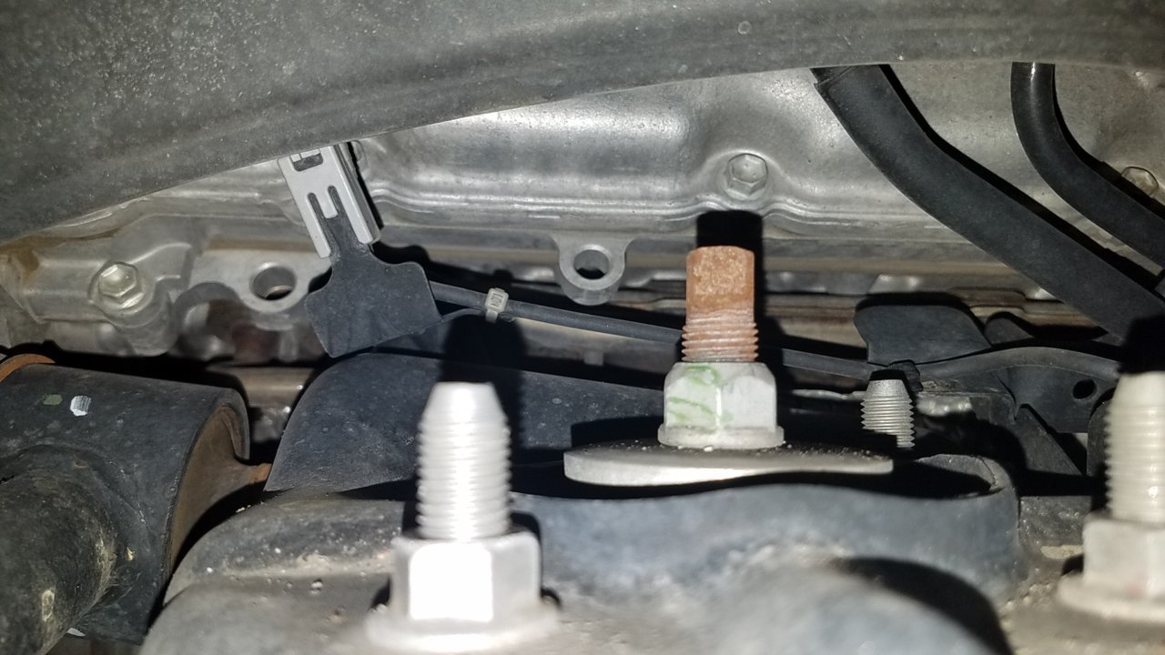

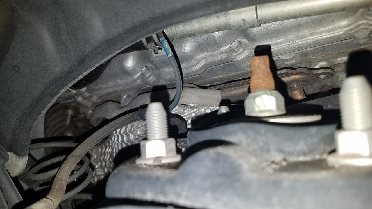

    Well sh!t. After reading this thread now I am worried about my Tundra. I have a 2014 CM that has 63,500 miles on it.
    I ran out and took some pics to be evaluated by you experts. Two are from the driver's side and two are from the passenger side.
    What do you guys think?

    None that I'm able to see...

    yeah looks ok

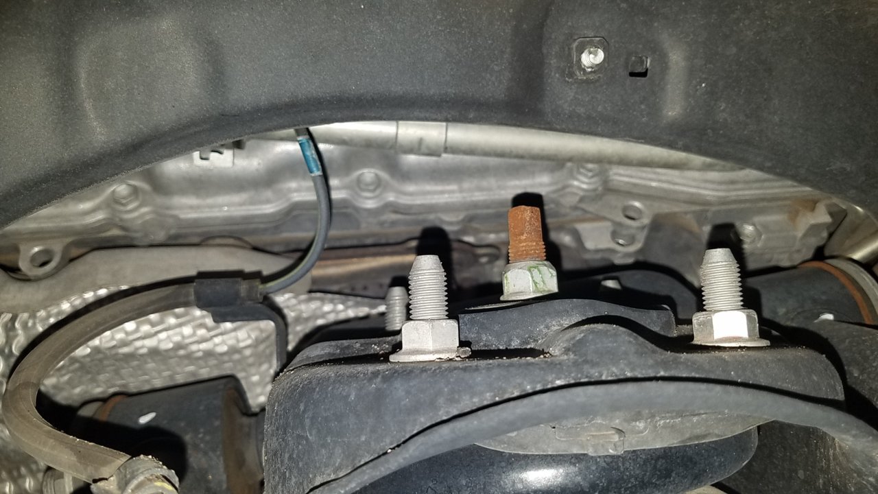

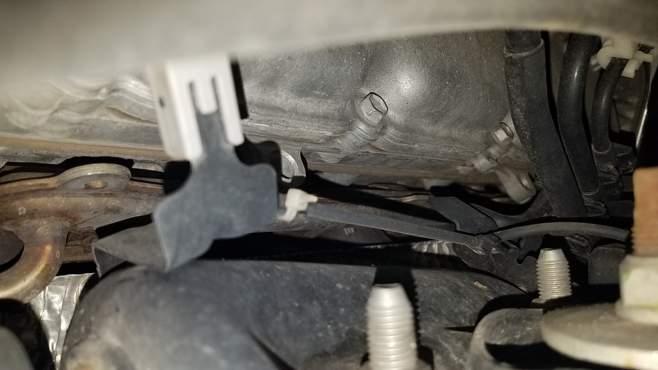

    So.. am I good? Took these photos today.
    Driver's side..
    Passenger's side..

    Looks good to my eye.

    Looking good to my eyes too
