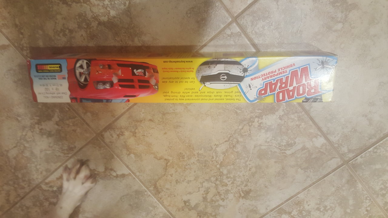

    Im with you, picky about my vehicles. I'm going to wash my truck on Sunday and add my road wrap. Can't hurt to be precautious. This Is the stuff i use if anyone is interested.20180227_214047.jpg

    Great idea. When they see the care you’ve taken, that should put them on notice...”Don’t scratch my truck.”
  14. Feb 27, 2018 at 7:07 PM
    #344
    Alloutdrs1
    Alloutdrs1 New Member
    Jan 30, 2017
    #6150
    1,607
    Andrew
    Virginia Beach, VA
    17' Tundra SR5, 12' Tacoma TRD offroad
    That's what I'm thinking, didn't realize the pic was upside down and my puppy got a paw in there...ha.
    NewImprovedRon and TheBeast like this.
  15. Feb 27, 2018 at 7:08 PM
    #345
    Blueline
    Blueline New Member
    Feb 26, 2018
    #13174
    286
    Jeb
    Temecula, CA
    2016 Tundra TRD PRO crewmax
    Bakflip MX4
    I just checked Amazon for road wrap. Not there. Can you please tell me where you found it. Thanks.
  16. Feb 27, 2018 at 7:11 PM
    #346
    Blueline
    Blueline New Member
    Feb 26, 2018
    #13174
    286
    Jeb
    Temecula, CA
    Bakflip MX4
    Found it at carID. $41
  17. Feb 27, 2018 at 7:50 PM
    #347
    Alloutdrs1
    Jan 30, 2017
    #6150
    1,607
    Andrew
    Virginia Beach, VA
    That roll I bought at pepboys, looks like its getting harder to find. It works great, I use it on the high impact areas when I take trips or to protect areas of the truck when I'm working on it. Goes on and removes easily, I used to use blue painters tape but its expensive now and doesn't stay put at highway speeds like the road wrap.
    There is some on ebay for 29.99.
