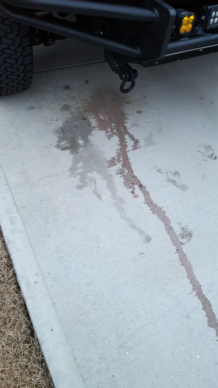

    Just got my truck back on Sat from getting both cam tower seals fixed. Pulled into the driveway and since it was light out, decided to try and look for any oil leaking. Walked toward the passenger side and noticed a puddle of antifreeze on the ground. The whole right side of my truck is covered in antifreeze under the hood. Looks like it must have spit out some yesterday as well but I didn't see it because it was dark. I hope this is just from either over filling the reservoir or an air bubble in the system. Gauge never showed anything getting hot.

    Jan 30, 2017
    #6150
    1,607
    Andrew
    Virginia Beach, VA
    17' Tundra SR5, 12' Tacoma TRD offroad
    Man this is the kind of thing I don't want to see, mine goes in Monday for the repair and I'm very nervous about it. Pop the hood and check things out, make sure a hose didn't pop off or something. Waterpump has to come off for this repair so make sure you don't have a leak there.
  28. Feb 27, 2018 at 4:29 PM
    #328
    TheBeast
    TheBeast The Beach
    Apr 27, 2016
    #3246
    12,576
    SoCal
    2012
    mmm..make sure sure to check for leaks before you start next time you use the truck. When they worked on mine I asked them to steam clean the engine bay to flush all the mess.
    I had a little oil puddle the next day under mine but it was left over oil from the cross member after they did the oil change.

    I popped the hood and didn't notice any hoses off or anything but my serpentine belt was covered in antifreeze. Radiator is still full but the overflow tank is at the bottom level now. Looks like it came out of there. I've been very nervous since I got it back because I only have 10k miles left on the powertrain warranty and that will be up before the end of the year.

    I'll be checking it first thing tomorrow. Heading out of town for a mini vacation on Thursday so I might stop by the dealer and have them check it out before I head to the airport. Not making me feel very comfortable right now.
