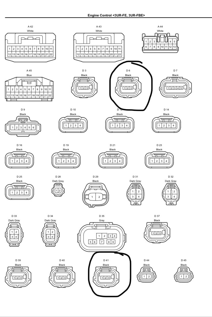

    When putting in the front two spark plugs on the passenger side I must have pushed too hard on that heavy gray wiring harness and I pulled the wires out of the exhaust camshaft sensor (the lower sensor beside the coil pack). I found out when I started the engine and got a P0393 code. I ordered a new pigtail and connector but I have no idea what order the three wires go when I splice it in. The wires are yellow, red and black. Any help would be greatly appreciated!

    Thank you so much for the help on this! It’s the 5.7L engine. There could be a blue tracer wire on the red that my tired old eyes didn’t see. Do the wire positions read #1 one wire is on the left, #2 is middle and #3 is on the right?

    It should be D41 shown here. If I’m not mistaken, it should be as you are looking at the connector from the perspective of the sensor, but I’d look at the wire colors in one of the other three connectors to double check. Often the connector body has the socket numbers molded onto it as well, but those can be had to read also.

    Look at the other sensors, chances are +12 and ground are the same color and specific to sensor location, the output wire is a different color. Regardless, you'll see the pattern (order) where they go by looking at the other...

    Don’t buy pigtails for Toyotas. They sell the connectors and should be able to use your wires/pins in the new connector if you did damage them
