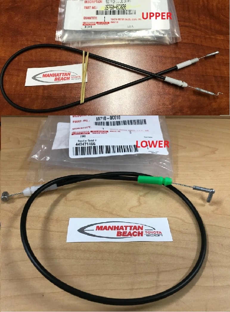

    For my 04 DC LTD, the ones below match what I have color wise....grey upper, green lower.
    shifty` likes this.

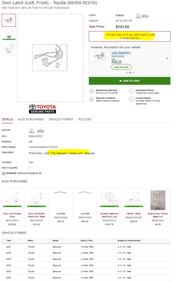

    des2mtn, I just got off the phone with a Toyota dealership here in San Antonio and he told me that the part you gave me wasn't correct for my vehicle. Sometimes I wonder about these dealership parts people.

    Yeah, that part number says it doesn't work according to their system and that's all they know. If you had an access cab, the part number would definitely not work.
    The part number their system says is compatible with double cabs is probably 69040-0C020 ($256) latch assembly which includes the lock motor. Their system also says this part number is compatible with Sequoias.
    Even Toyota's website gives conflicting info on the part number I gave you. In one section (probably linked to the same compatibility system the parts guys use), it says the part does not fit. However if you scroll down a little bit it says it fits a Tundra too in the description.
    The website @Shifty' linked also says it fits.

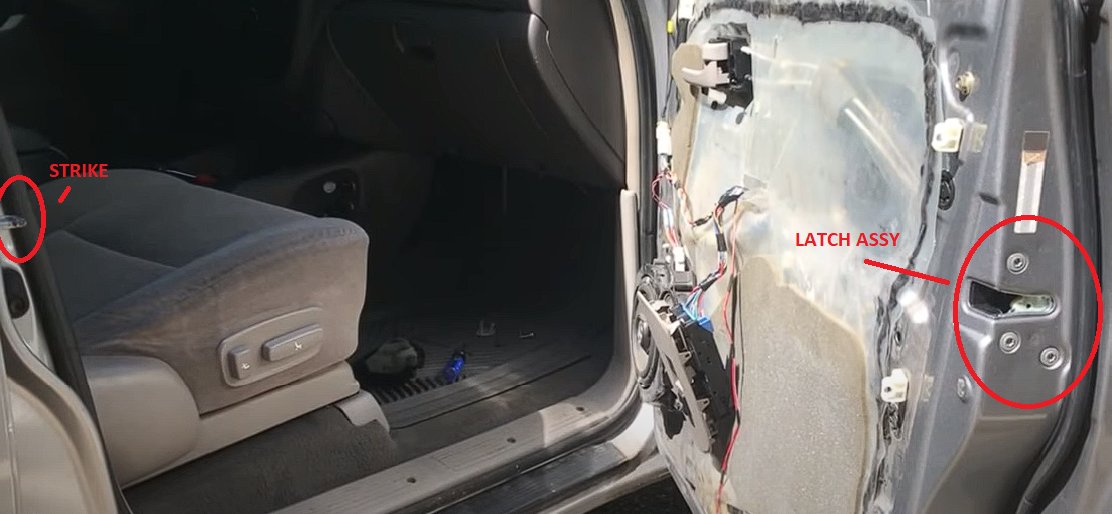

    Look carefully at how the latch assembly in the door frame is hitting the striker it latches onto. See if it's hitting it high or low.
    I don't have a DC, I have an AC so I'd need to see the latch side of your door. Usually, on many vehicles I've owned, that latch mechanism has some play available. If it's striking low, you can loosen the screws, shift up the latch assembly 1mm-3mm, then tighten it down in the higher position, then test.
    This may not be true with the DC, again, I haven't looked at it, and I'm coming up empty looking for pictures of the latch assembly in the door.
    In some vehicles it's not possible to adjust the latch mechanism, instead, you adjust the strike. My previous pickup was that way, but it used a single center-post style strike, you loosen the center post, slide it up/down, then re-secure so it's hitting square in the latch.
  22. Jul 27, 2023 at 8:00 AM
    shifty`
    shifty` Just like witches at black masses
    Jun 20, 2020
    #48239
    28,375
    ATL
    '06 AC Limited V8/4WD
    Found a pic.
    Doesn't look like the latch assembly has much ability to adjust. I may be wrong, maybe loosen the screws one turn and see if you can adjust up/down as needed. If not, adjust your focus to the strike, and seeing if you can loosen the fasteners one turn and shift it up/down as needed. Don't over-loosen!
