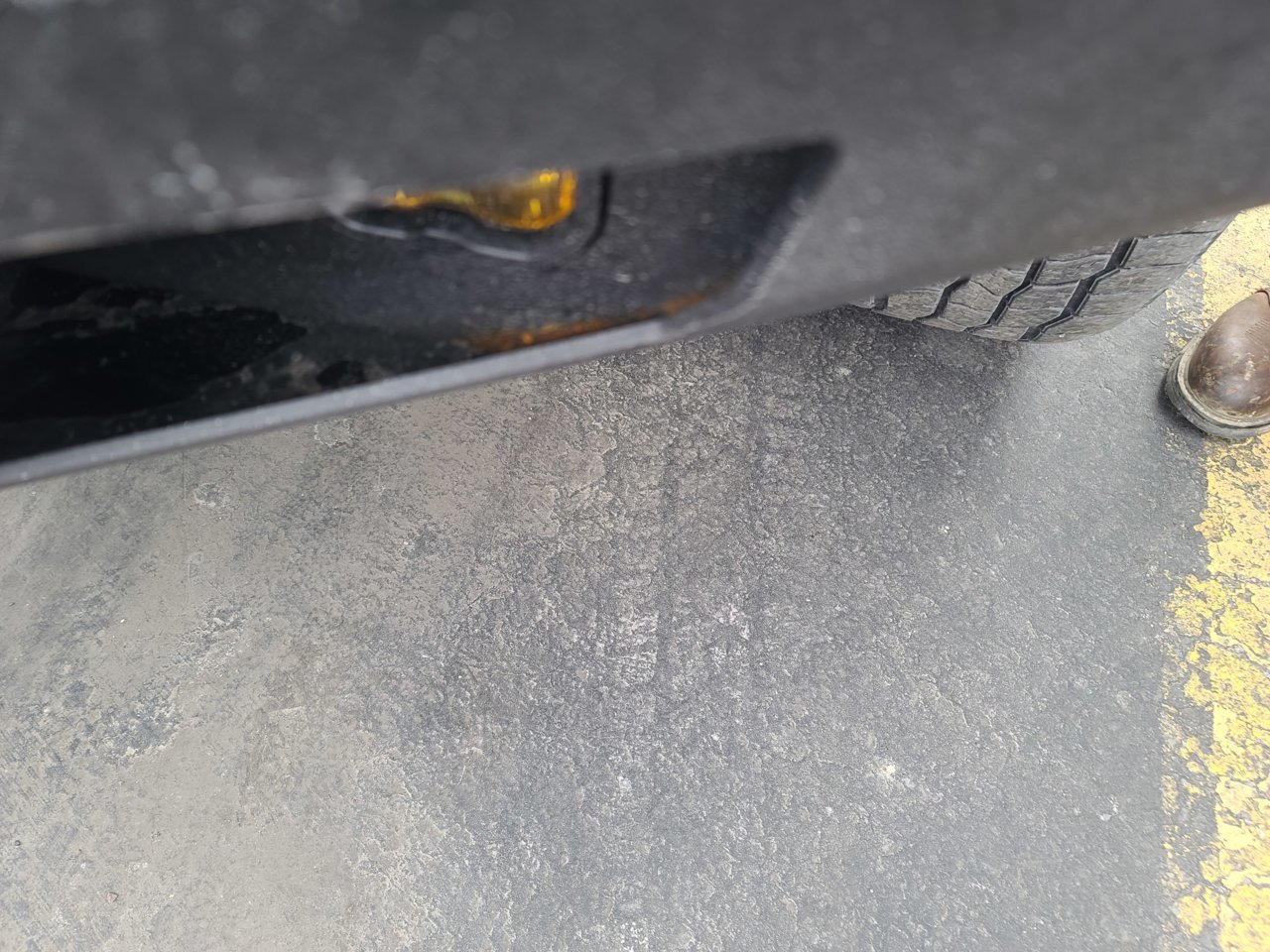

    Six days since install, guys who powdercoated it blame the welds, saying there are holes. They did offer to repowder, I am just going to clean the rust and seal the welds I can get to bed liner, and solid film the shit out of the inside of it.

  20. Jan 29, 2021 at 7:46 PM
    #620
    java230
    java230 New Member
    Jun 8, 2020
    #47708
    202
    That sucks.... Primer coat or just top coats?
  21. Jan 29, 2021 at 7:46 PM
    #621
    Angry Gunny
    Angry Gunny New Member
    Aug 4, 2019
    #34137
    240
    Rob
    Bedford, PA
    2016 SSM 1794 4X4
    Yes please
    Looks like this on both of these.
  22. Jan 29, 2021 at 7:48 PM
    #622
    Angry Gunny
    Aug 4, 2019
    #34137
    240
    Rob
    Bedford, PA
    2016 SSM 1794 4X4
    Yes please
    Sandblasted and powdercoated only.

    FL
    2017 Cement Grey Tundra TRD PRO
    Lots of shenanigans.
    I'm not an expert but those welds look pretty solid to me...
    Pitbull410, COTundra23 and Hightide like this.
  24. Jan 29, 2021 at 7:50 PM
    #624
    Angry Gunny
    Aug 4, 2019
    #34137
    240
    Rob
    Bedford, PA
    2016 SSM 1794 4X4
    Yes please
    I thought so as well, I'll get a pic of the spot on the weld.

  26. Jan 29, 2021 at 7:52 PM
    #626
    java230
    java230 New Member
    Jun 8, 2020
    #47708
    202
    That's a PC Issue. Not welds.

  28. Jan 30, 2021 at 12:12 AM
    #628
    Hightide
    Aug 14, 2020
    #50791
    8,816
    chadington von banks
    Abalama
    Magic School Bus
    The only way a powder coated steel part will rust is either misapplication of coating or occurrence of oxidation prior to coating. Improper removal/treatment of the oxidation will cause this.
    Of course wear and tear... but that doesn’t seem to be the case here.
    Pitbull410 and Zero One Actual like this.
  29. Jan 30, 2021 at 3:47 AM
    #629
    Zero One Actual
    Zero One Actual Member among Members
    Oct 17, 2017
    #10330
    2,324
    Agree. They didn’t prep your bumper properly or they did but let it sit for too long or someone was touching it with their skin or sweating all over the metal or something of that nature. There is no way that has anything to do with a weld. They need to start all over and do it right. Good luck with whoever did that work and them making it right.
    Them saying it’s a weld is a classic pass the buck to the manufacturer to handle this. Well sadly, there is a reason C4 ships their bumper unfinished and this is the exact reason. The prep part prior to coating is on the end user or the “professional powdercoating” place.
    chugs and Hightide[QUOTED] like this.
