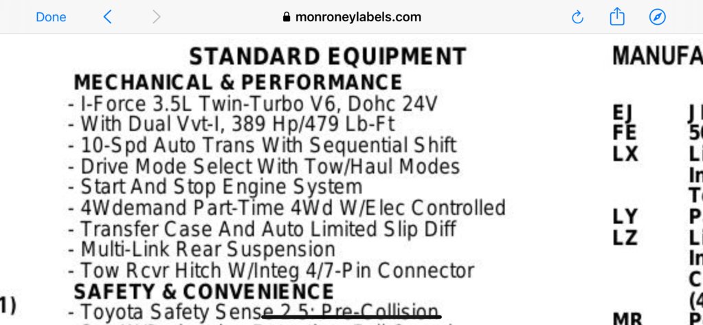

    He mentioned his window sticker says limited slip differential. I have been wondering if this is causing my truck to feel like I am in 4WD at times with a bucking feel. I am going to look at my Monroney label I purchased on my used 2022 Limited. I found it on my label, “auto limited slip differential” Hmmmm, makes me wonder. Maybe I will take it out and disable traction control to test one or both tires spinning.
    Differences between LSD (aka posi) and locker is a LSD will allow tires to spin at different speeds (for turning) when not under torque. Whereas a locker, both wheels are mechanically locked at same rotation speed.
    I am still wondering why I will rarely feel what I would expect when in 4WD like bucking.

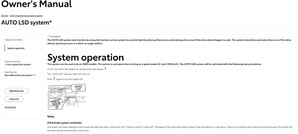

    From Toyota's website
    https://www.toyota.com/owners/warra...article/tundra-hv/2022/om0c031u/ch04se050418/

    It is not a true LSD. The sticker says Auto lsd which for Toyota is an open differential that applies the brake to one wheel causing the other to gain traction. It's not 100% but does help out but not how a true lsd would.

    You don't have a mechanical LSD because Toyota doesn't sell one. Its purely sofware based that stops the spinning wheel with the brake so that the tire not spinning can get traction. No idea why they decided to call it Auto LSD on this model other than to confuse people. It literally has noting to do with the Diff because it uses the brakes stopping a wheel with no traction. Toyota used to call it A-trac on previous models like tacoma, 4runner, etc.
    Toyota has a electronically actuated mechanical locker on TRD models that can be engaged in 4low and that is the only mechanical locker for a 3ed gen Tundra.
    By all means go burn up some tires with one wheel peels, when the brake actuated LSD kicks in hopefully you don't snap anything or cook your brakes. Might want to try it in the dirt rather than the street.
