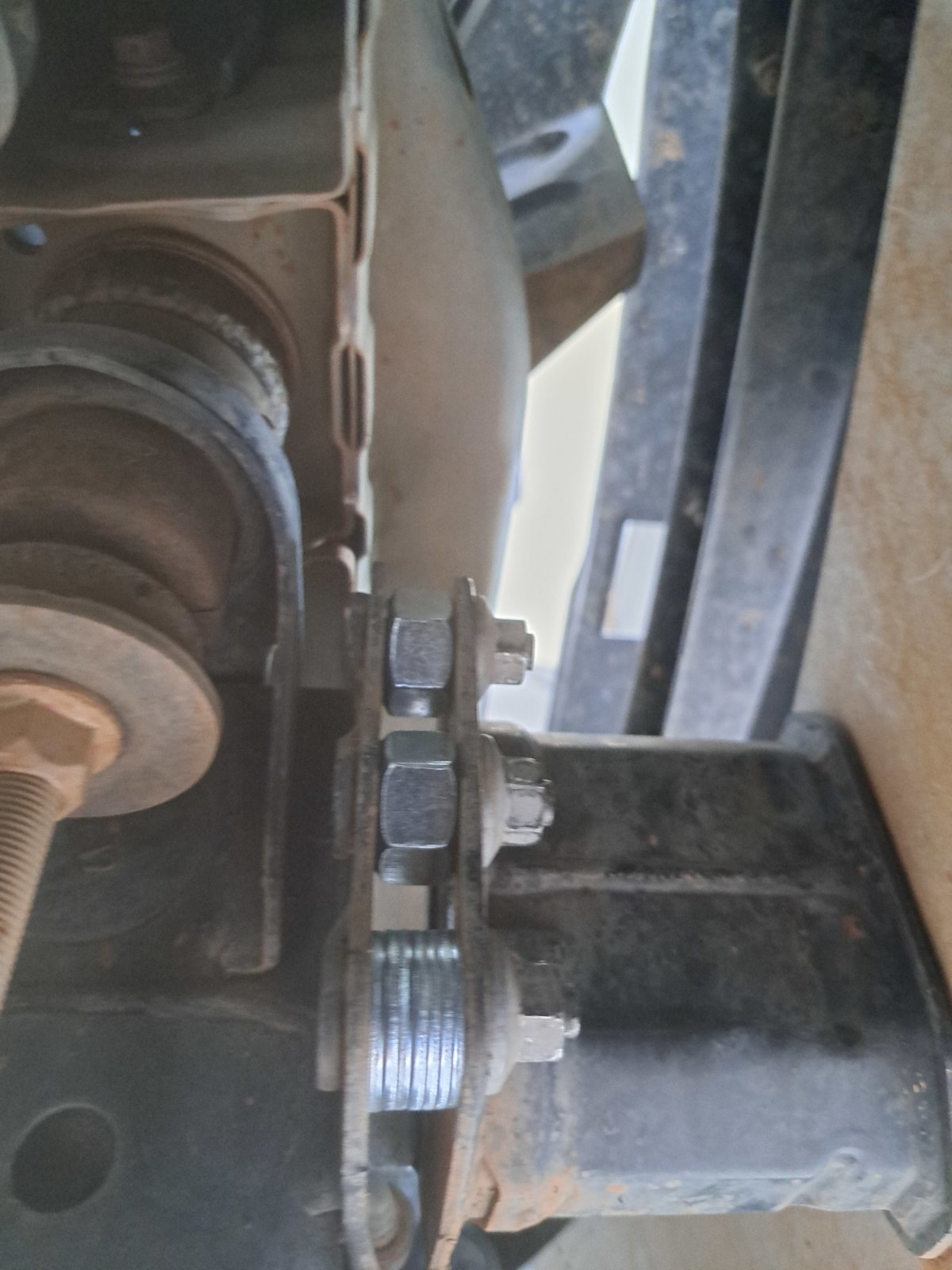

    I installed mine on my 2nd gen with out even taking the bumper completely off. I just loosened up all the bolts and did one side at a time.

    I actually tried this at first but couldn't get my hand in there w/a tool to do it, so it was just easier for me to take it off.

    I had to use a ratcheting open-end wrench.
