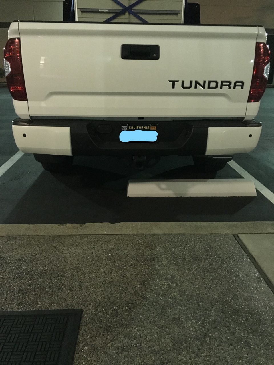

    Dealership did my 16 last year. I have a gap below the tailgate but it was different before they did the recall. I'm living with it.

    There is supposed to be a gap below your tailgate otherwise the gate wouldn’t open. Your bumper looks right from my point of veiw.

    Yes its right now. They moved it upward after the recall, It used to be lower. Thanks Bud..
