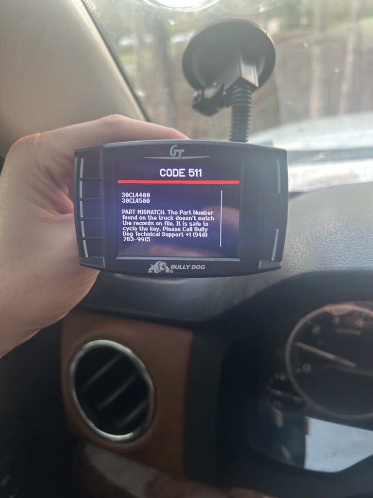

    Just an update: I finally convinced one of the, "gatekeepers", technical support guys at Bullydog that our trucks actually have different versions of programming and that they don't all just work off of one giant modified program. He finally went and spoke with an engineer, and there is only one, that is working on tundra programming. When he got back on the line, he informed me that Bullydog now has the program for 2nd gen trucks ending in 600 and that a tune will be released in approximately a month with this TOYOTA part version. I was almost ready to sell my tuner to a non flex fuel member, but I'm pretty happy to say I'll be able to keep it.
    This newest program works perfectly in keeping the truck from not going into Ethanol mode when it shouldn't be.
    This is pretty damn important if you own a ffv tundra and want to run a bullydog tuner.
    There is also another thing to consider... The new Magnuson SC's come with a bullydog tuner for flashing the SC tune to your ffv Tundra.
    This particular tune is not yet available for our trucks, but unless the part number they use ends in 600, the truck will eventually think it's running Ethanol... And you can guess how that might be bad in combination with a charger.
    Anyway, I'm hopeful they will take care of business now that they have that new part number/tune.
