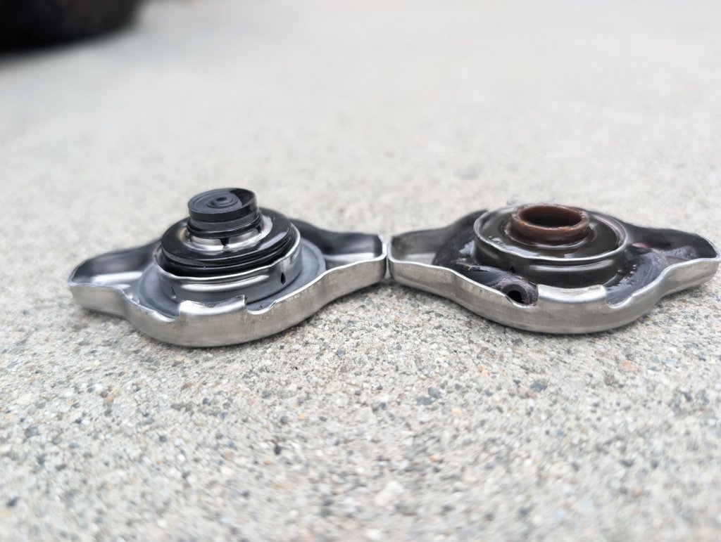

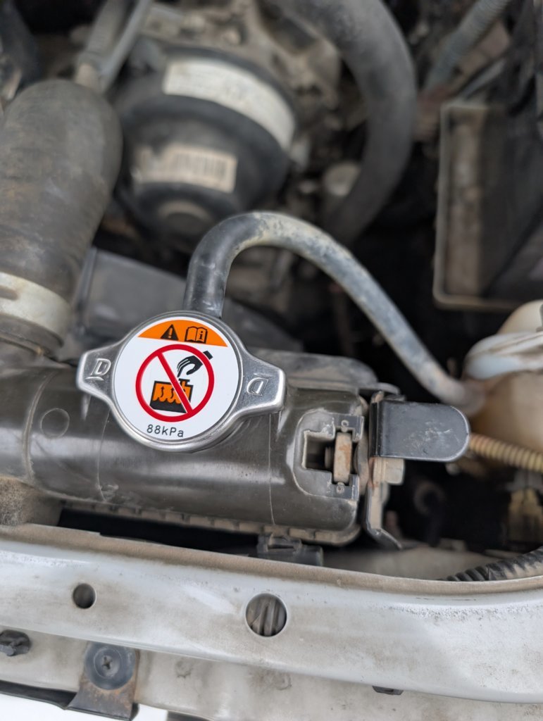

    I suggest buying a new Radiator cap also. Buy from rockauto not Amazon
    -Denso brand radiator and cap,
    -Aisin brand thermostat & thermostat gasket.

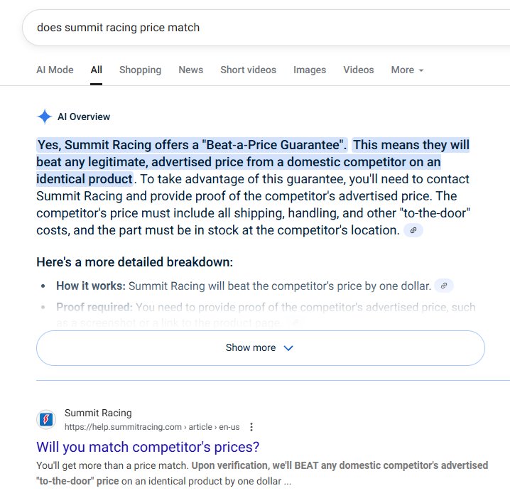

    $180 at Summit, likely with free shipping, possibly no tax (not sure if they charge tax for every state, they do here b/c there's a brick&mortar location south of ATL): https://www.summitracing.com/parts/dnp-221-0516
    $140 at RockAuto, before 5% discount code (I can supply one), and before shipping & tax: https://www.rockauto.com/en/moreinfo.php?pk=4722378&cc=0&pt=2172&jsn=455
    Sometimes free shipping and ease of service/returns makes Summit the better buy. Once you add in shipping (usually around $20-30 on something that size), with tax, the 5% off only puts you a few dollars saved, and I'd rather spend the extra couple bucks knowing I can talk to a customer rep at Summit in about 30 seconds, they make returns and order changes a breeze.

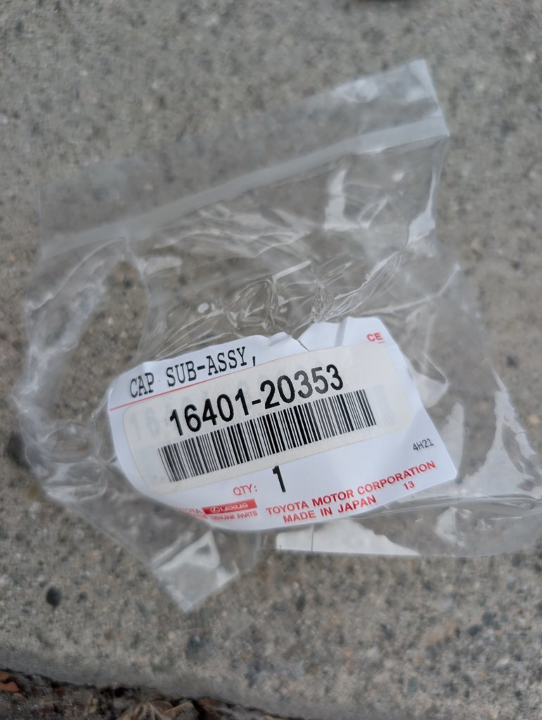

    I read this thread and I'd like to replace my radiator cap and thermostat also. I ordered the Denso radiator some time ago but no time to put that in (or have a shop do it).
    Does a radiator come with a thermostat and cap?
    If not, what are the Rockauto or Summit parts numbers?
    I looked on Rockauto and couldn't find the cap.

    Just go OEM on these parts. It's not worth the headache. A leaking radiator cap could be catastrophic.

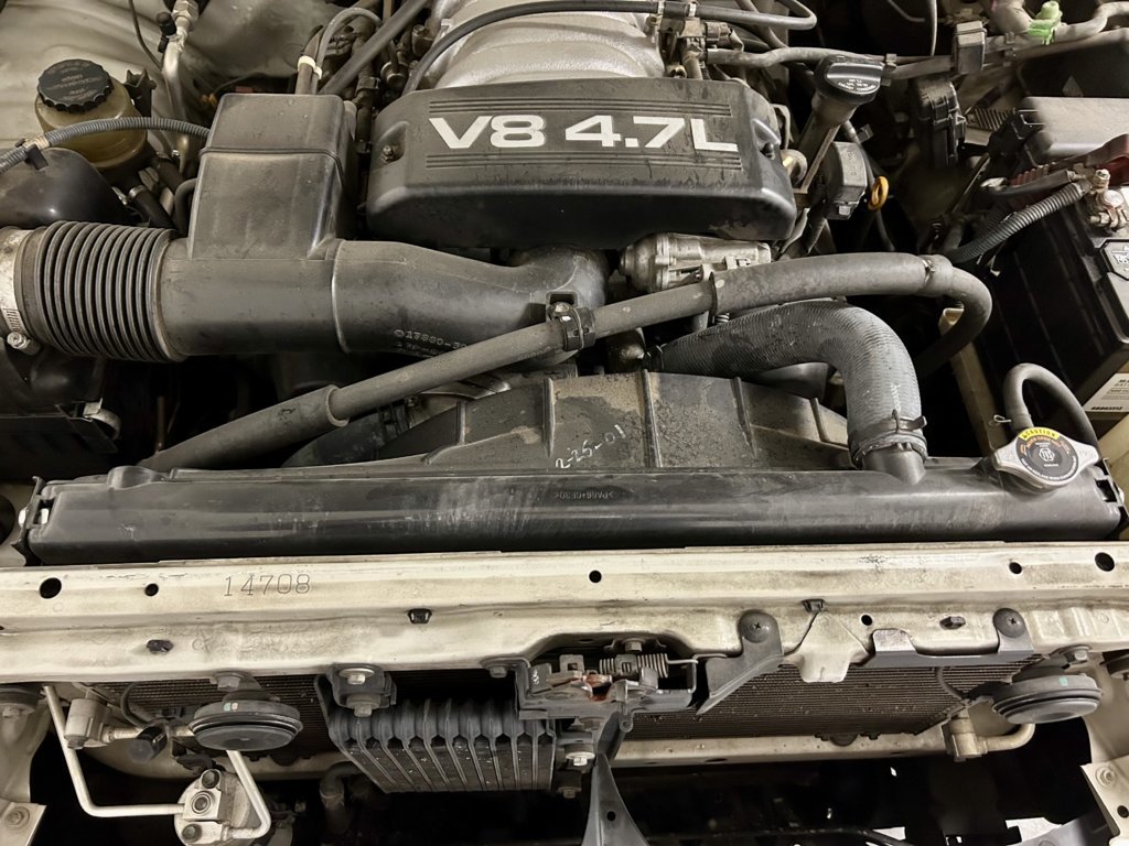

    No. You don’t need to remove the fan. Remove skid plate. Drain. Disconnect and remove the overflow. Remove the fan shroud bolts and slip the shroud over the fan toward the engine. Disconnect coolant lines. Disconnect transmission fluid lines and plug with golf tee to prevent fluid loss. Remove radiator and insert new one. That’s from memory but I think that’s all. I can’t remember if the brackets have to swapped.

  16. Jan 25, 2025 at 9:43 AM
    ToyotaDude
    ToyotaDude Member
    Jul 8, 2023
    #99955
    857
    2003 Tundra AC V8 4x4
    +1 on this procedure. Golf tees are a nice tip. Have used some other plastic plugs b4.
    IIRC swapping the brackets will allow the front apron mountung bolts to line up. Here's the start of a thread on Denso experience with bestgen and taco.
    https://www.tundras.com/threads/swapping-radiator.141348/#post-3756987
    IIRC modification of the top tank mounting nubs allows the rails to be swapped over. Here's deets on method used for swapping rails on the taco install but recall it applied to the bestgen too.
    https://www.tacomaworld.com/threads...t-gen-edition.138573/page-11086#post-29990439
    Others might try a faster route and wallow out the apron but not my preferred method.

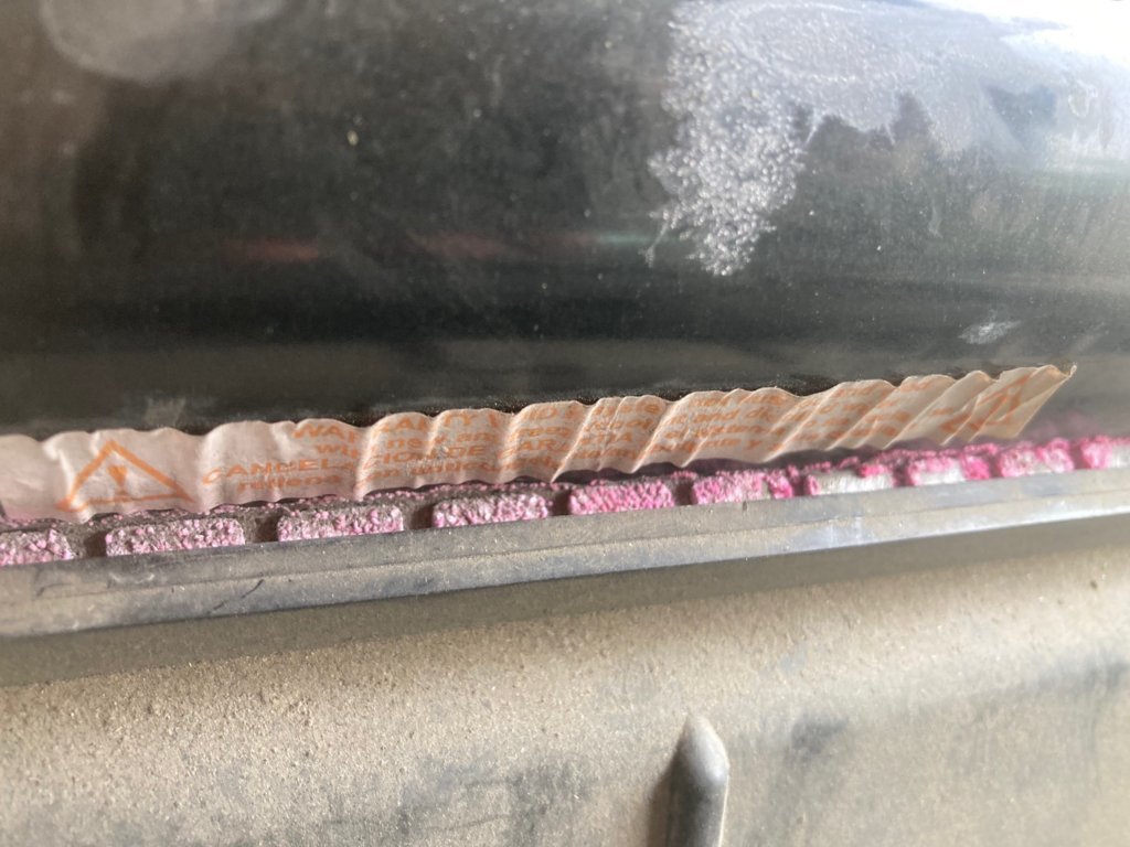

    I don't have any micro cracks in mine. I'm now leaning towards just splitting the difference with my timing belt and doing them all next winter. Then it'll just be my valve cover gasket leak I have left to deal with.

    How many miles do you have? IIRC my OE ran about 200k on bestgen before needing replaced and about 150k on taco and leaks at tank seams were visible as others mentioned with the red/pink crust. So @shifty` is about right on mileage IMHO.
    Have you tried just snugging the VC bolts (without overtorquing) until can swap the gaskets? Have found doesn't usually fix the issue but can slow the leak and smell and mess....
