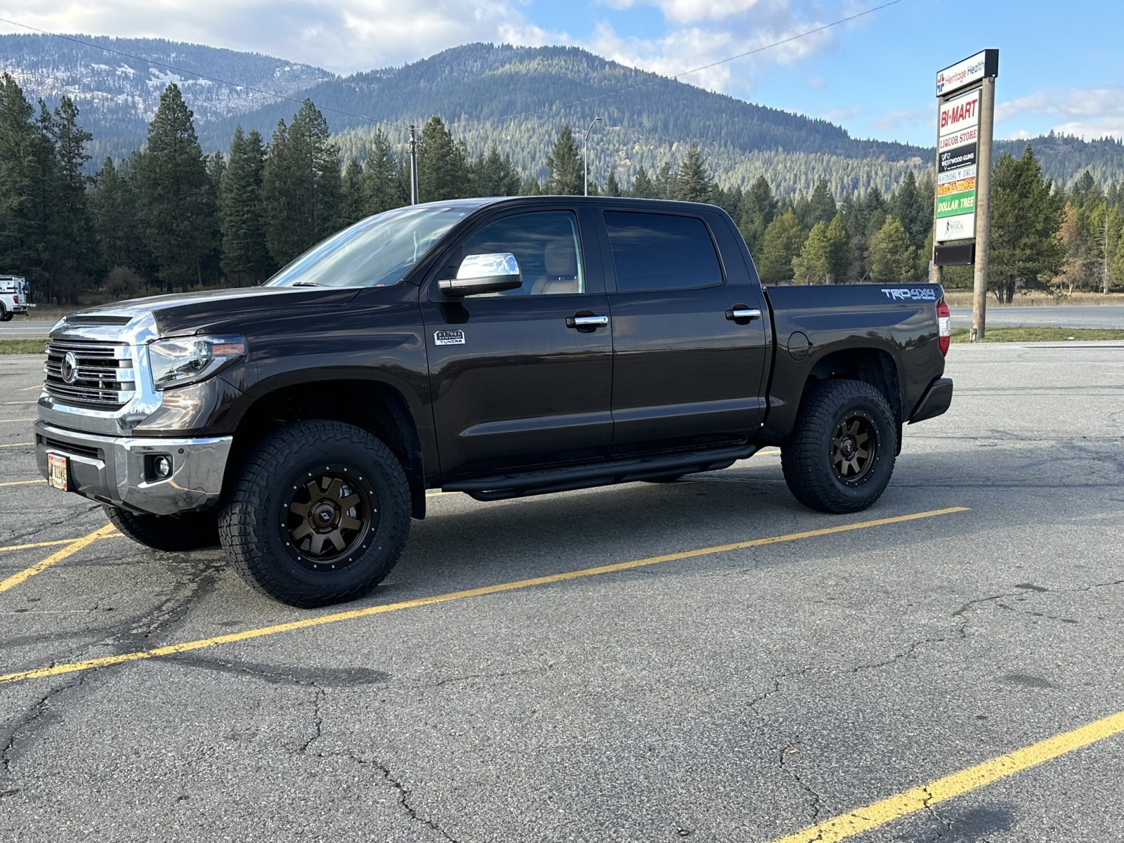

    SCS SR8, Falken Wildpeak AT3W 285/75R18

    looks great! lift specs?

    Thanks! Rough country 3/1 level.

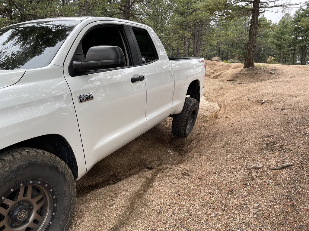

    Mind the poser flex shot, it's only pic I have that actually shows the color of the wheels. E8F06FB8-206D-4FEC-9896-BB97BA9B2F62_1_105_c.jpg

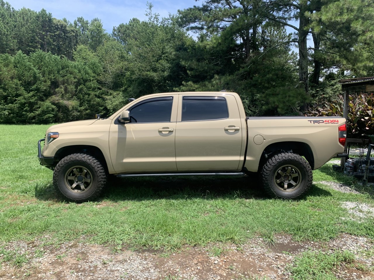

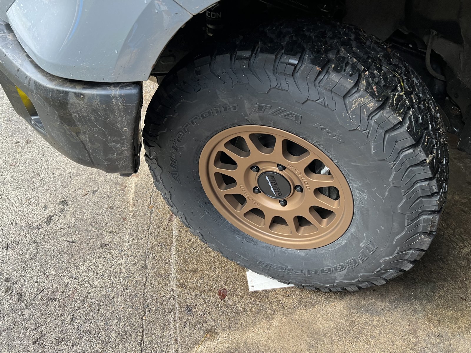

    Method 703 17x8.5 +35, BFG KO2 315/70r17 load range C

    hell yeah! Looks amazing. Been eyeing this exact setup for my MGM. Looks so good and such a nice offset for our trucks
    Have any more pics? Maybe a side profile and front to show poke?

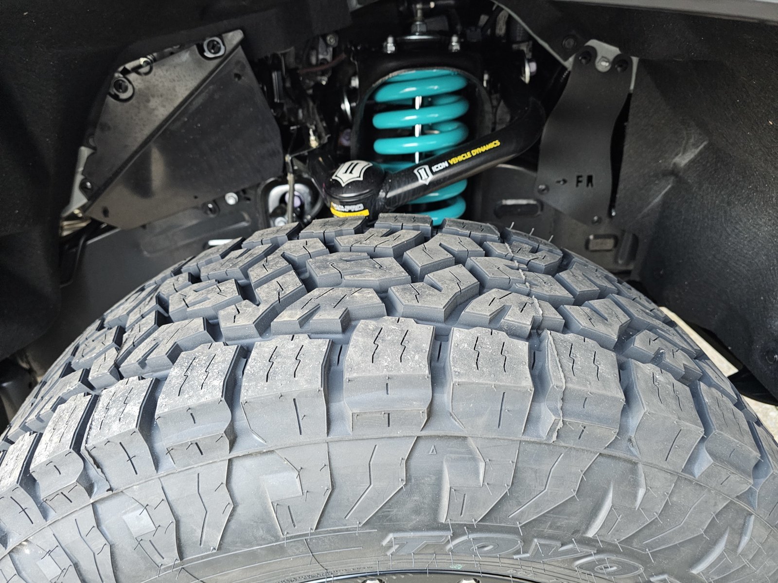

    24 Platinum Lunar rock
    18" Icon Rebound in bronze
    295/70/18 Toyo AT3
    Heritage grill swap
    Dobinson 2.25" lift Coilover w/standard spring
    Icon tubular UCA
    Dobinson 1" standard weight spring and shocks in rear
    Think it came out better than I expected. About 1" poke, and about ³/4 in rake.

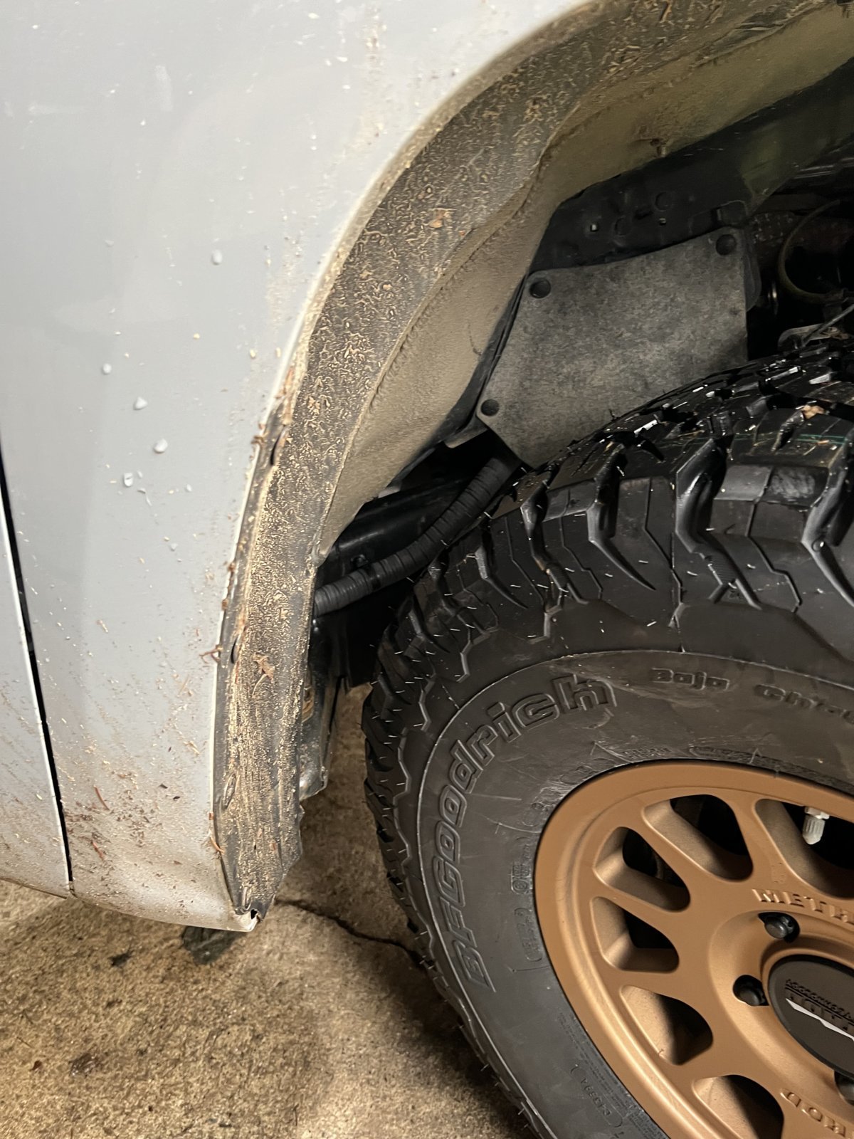

    Looks awesome! Do you have a lift kit? Any rubbing issues with those tires? I'd like a similar setup on my truck.

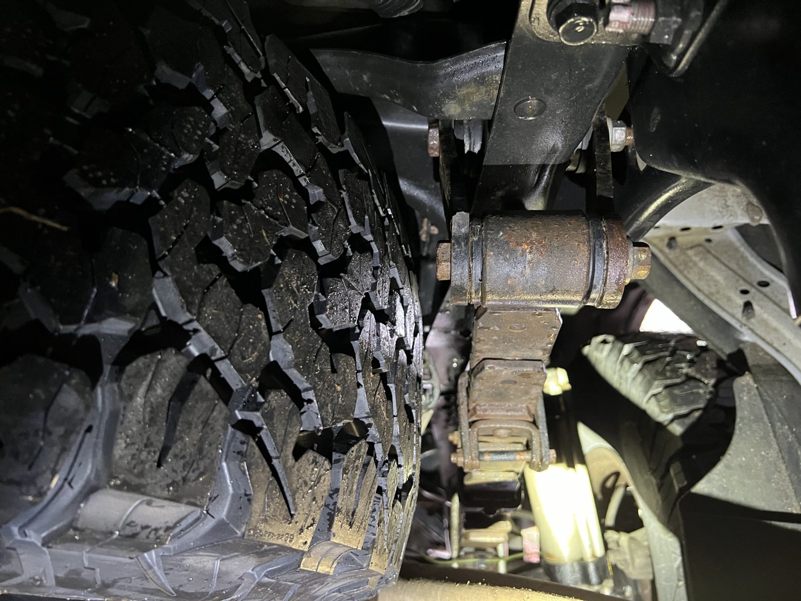

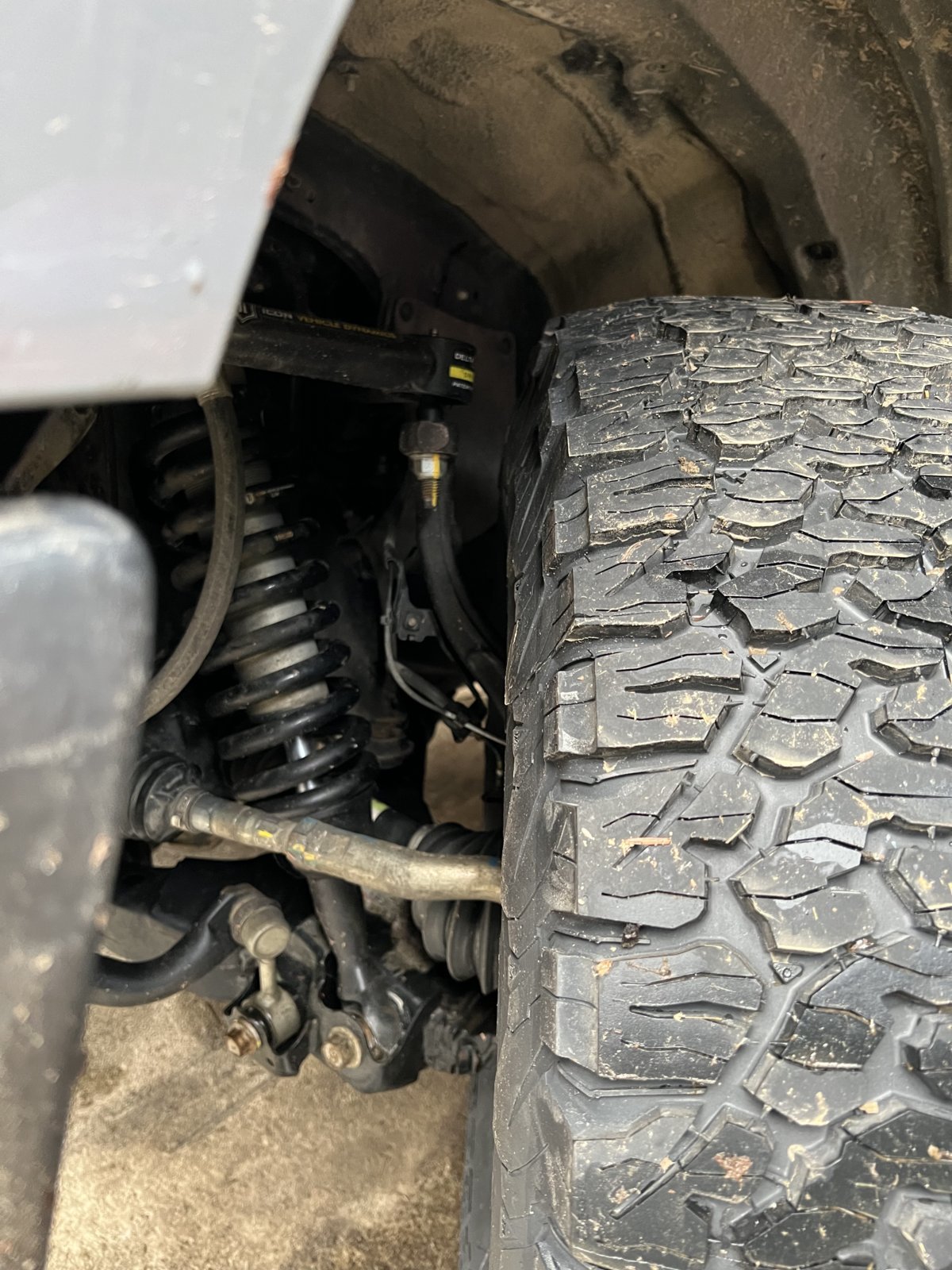

    I have a ~2 1/2” lift. I had to use shims to space the front bumper as well as moving some plastic on the wheel well liner, however there is plenty of clearance at the body mounts, ucas, and sway bar. I took it for a decent shake down run this weekend and didn’t encounter any rubbing driving over pretty rough terrain. To fit a full size spare under the bed you have to remove the riveted locator brackets and it is a very tight fit between the leaf springs. Overall I think this is a great wheel and tire combo for the tundra but definitely takes a little work to get them to fit properly.
