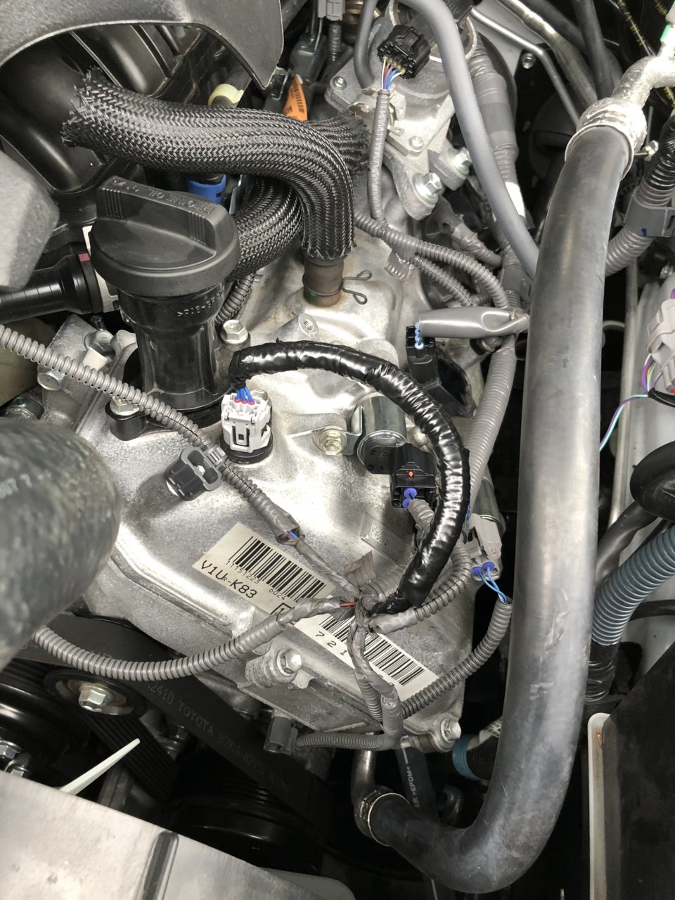

    Update, I got the truck back last night. So far on the ride home no problems, they said it was an oil control valve issue. Code was p0011. So after changing the OCV they stil had the issue. They then opened the valve cover and saw that the OCV cover gasket was not installed probperly and this is what cause the valve failure and is now not allow the new valve to build pressure. After replacing the gasket and reinstalling the valve cover and new OCV the tech accidentally broke the cam position sensor wire harnes. So they then had to get a harness and splice it into the truck, which looks like complete crap and I no doubt some day will have issues it’s it. Then after everything was back together and repaired and a fresh oil change they still had same issues. Finally they said the issue was the truck needed to build pressure with the new part and it was fine. They drove the truck like 40 miles before giving it back. I have driven it like 50 more and so far it’s good. This entire experience has really make me rethink this dealership. We shall see how this fix works as next week I’m driving 600 miles each way for vacation.

    Wow.... that's all i Have. Totally unexceptable IMO. It didn't come in with hacked up wiring so it shouldn't leave with one.

    So they didn’t replace the harness why?

    I have no idea, I asked the same question. I’m still undecided how I’m going to proceed

    My guess is that they couldn’t get that covered by Toyota since the dealer broke it.

    How many miles on your truck? I’d tell them they are the proud owner of your truck. Ask when your new one is coming in.

    Curious as to the miles as well. That engine bay pic doesn’t look like it should be of a 2018.....

    Not sure I would be too happy either with that roll of electrical tape wrapped around the wires on a new vehicle. Could they not at least put back on the stock loom? or is that under all the tape.

    Could someone with a 18 take a picture of the same area to compare. My 17 is almost 2 years old and the wiring doesn't look that butchered or raggady. I would raise a stink to get a proper wire harness installed. You are right, you WILL have problems later on with it. These computer systems in the trucks measure all kinds of voltage to make adjustments and they are very small volt changes. Introducing the extra resistance for a poor splice job is just asking for more issues.

    I would take that back asap and have them fix that because what they did just makes me speechless

    Guarantee whoever approved and performed that HACK job would not have that on their own new truck!

    My truck is a 2018 4.6 CM, bought it in early May and it has 4700 miles on it. Could someone post a pic of there engine in this location I’m curious to see what it should look like. I complained to Toyota today and emailed the head of the dealer service as well as the president of the dealership group. Awaiting there response.

    Well, the top guy from the service Dept contacted me back and stated that the harness should have been replaced. He has assigned the manager to look into why it was not replaced and stated that they are going to make things right. The harness is being ordered and they are going to call me to set everything up. Hopefully this is a positive experience and all is repaired correctly.

    Would have been fine if they would have told you they broke it and did a temp fix to keep you on the road while a new harness was ordered. But sounds like they were trying to be slick and got caught
