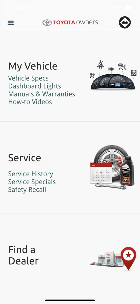

    Use the App.

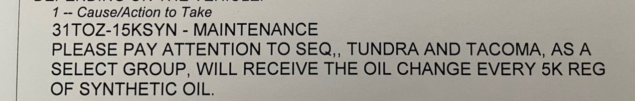

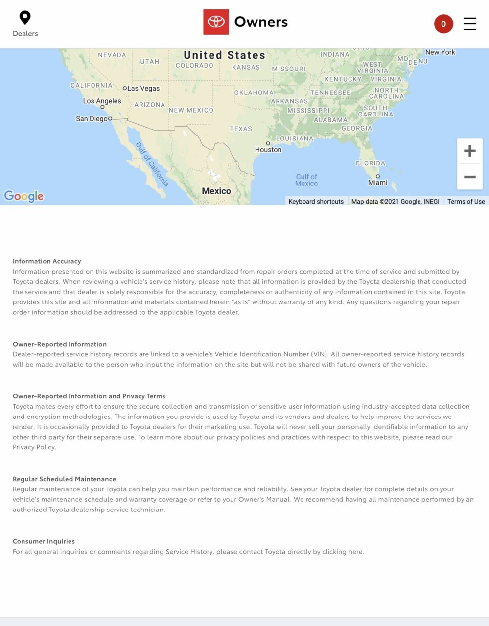

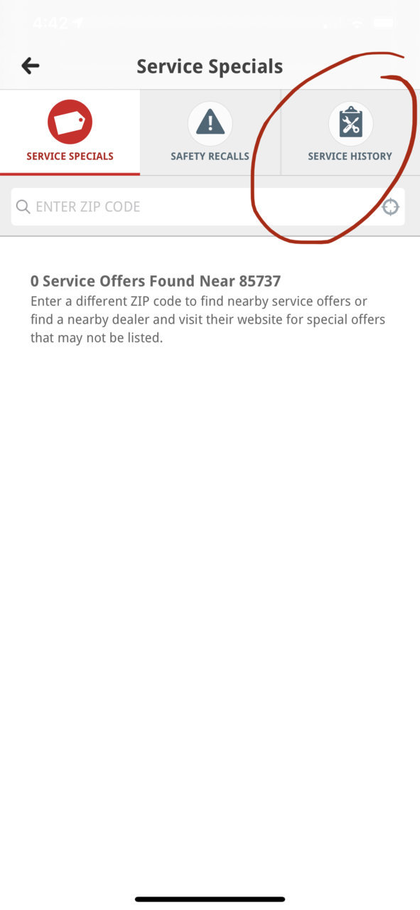

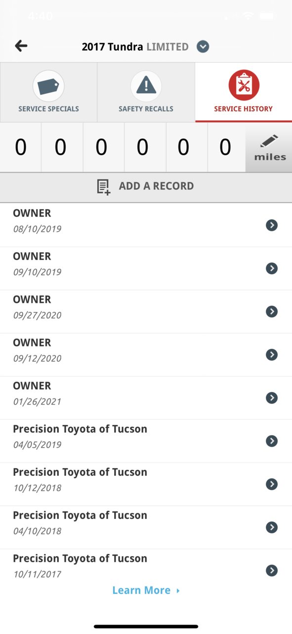

    The app worked as described, prior to that I tried the URL on a PC browser which did not work. Thanks guys

    This has actually changed. There was a special note on my last Toyota care interval ticket that the oil for Sequoia, Tacoma and Tundra should be changed every 5k miles. They have changed mine for the last 2 Toyota care stops.
    CallsignKodiak[OP] likes this.

    Can you please post a reference or a copy? I haven't seen anything like that.

    The maintenance manual in my 2021 still states 10k/12 months for normal operating conditions. My 2020 Tacoma said the same thing.

    Hmmm, the wording is interesting and maybe it was a mistake it was changed again. This wasn't on my 2 previous receipts. Oil was changed on the 2nd and 3rd Toyota care intervals based on date not mileage, which was 4100 and 7700 respectively. Others here (why I enjoy the board) indicated it could possibly be indicating a certain engine configuration. Anyway attachment included.
