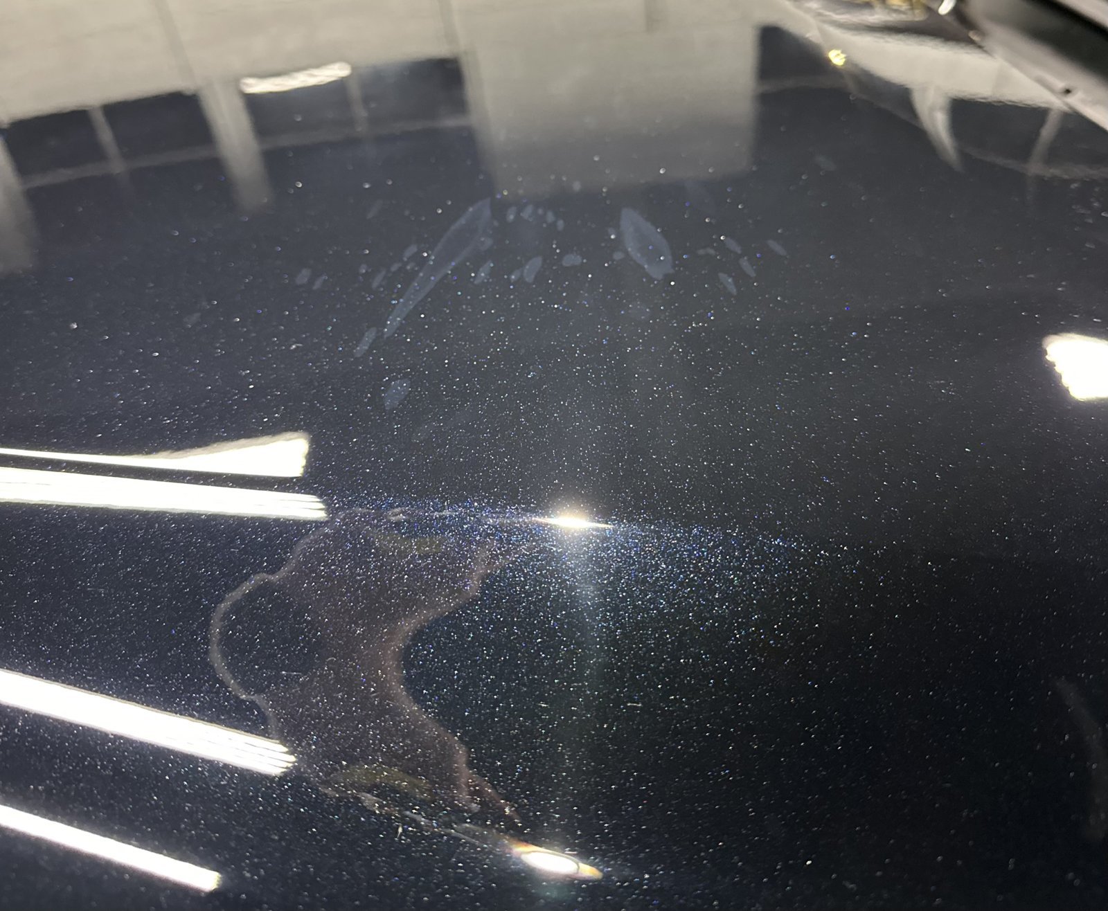

    There is a difference between clear coat separation or bubbles (both relatively uncommon) and cloudy/milky marks in the clear coat from the protective film (somewhat common). I believe it’s just absorbed moisture that will go away after sitting in the sun, never to return!

    These bubbles were only in areas that were covered by the factory applied shipping protectors on the hood, top of front fenders (but not on the sides of the front fenders). I've seen pictures of at least one more 2023 Tundra in Magnetic Grey that had bubbles in the same places and on a rectangular strip above the windshield. Service manager said that it's highly likely that this happened when they pulled the protectors off the truck, clear coat wasn't fully cured and was lifted off the paint. If it absorbed moisture like you say, it would absorb it randomly, not just in these areas but also on the lower part of the front fenders, doors, rear fenders, tailgate, but that was not the case. The areas where these bubble were, were also the most exposed to the sun so it should be the least prone to moisture bubbles than say tailgate or the sides.

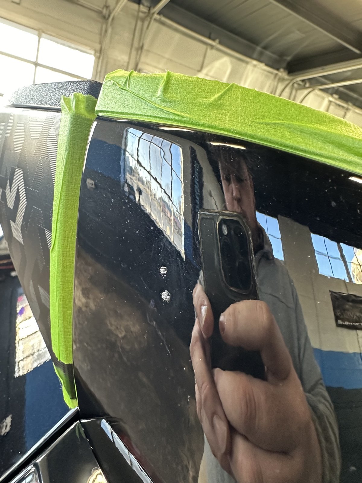

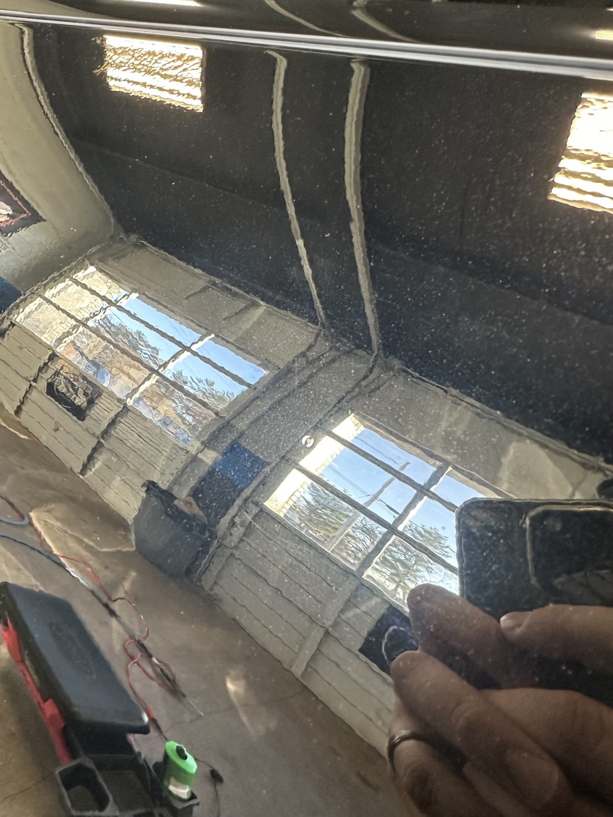

    Data point. My 24’ TRD PRO has it on the hood. See attached. My detailer found it after first wash. I only have 200 miles on the truck now it’s in for a warranty claim what a bummer. Said it could be a few weeks before I get it back if they need to reclear the hood. I didn’t want to heat gun the paint and get hung with that if something went wrong on my end, so off to the dealer she went.
    Also has a few popped paint bubbles. Nothing crazy but definitely not the fit and finish desired.

    Moisture might be gone but the clear coat did not bond to the paint in those spots even if they used a heat gun. My best guess is that because it's exposed to UV and it goes through hot/cold cycles on a daily basis, the clear coat is going expand/contract at different rates than the body panel and it will eventually crack and peel in those spots over the years.

    Yeah the dealer repainted the hood and rear quarter of my truck. It looks perfect now and honestly can't tell it was repainted. Even looking up close with a flash light you can't tell. They definitely didn't do the heat gun trick because I have receipts of all of the moldings they had to order once it was repainted. To be honest I don't think they were aware of the heat gun fix. Since mine is a 24 TRD PRO and outside of the 2022 window listed on the TSB.
