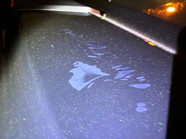

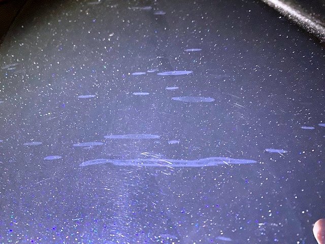

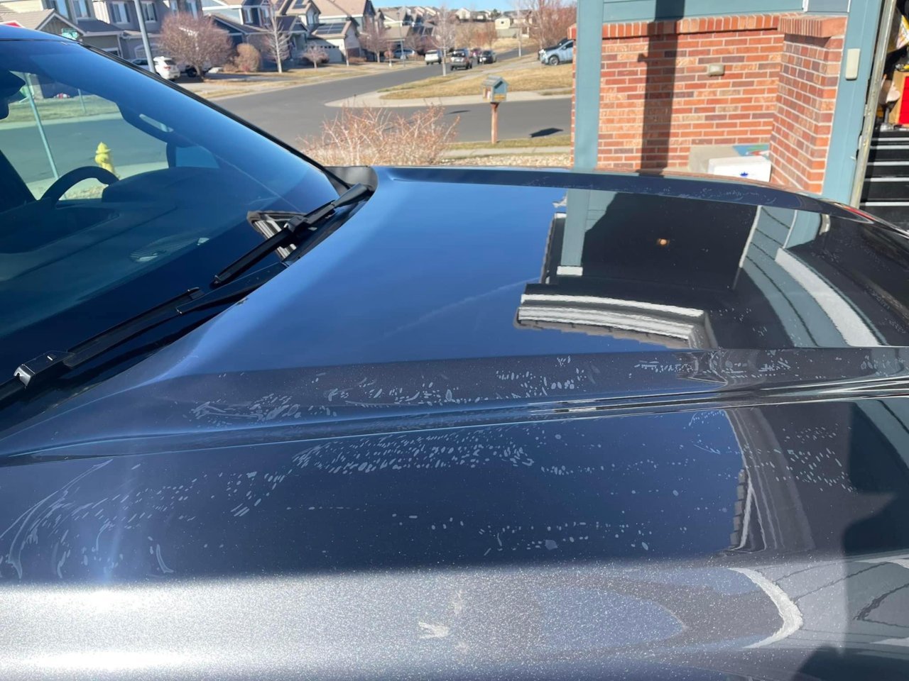

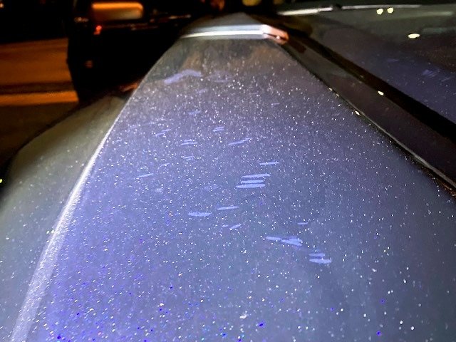

    I am going to have them repaint the damaged panels. I had a 22 TRD OR and this one; 23 TRD Pro is a just a better all around Tundra. The performance and ride is a huge improvement over the Off Road. (Of Course my opinion).
    I went through it inside and out and there is a big improvement in finish and fit (Exception the damaged Paint) Had a very good outcome with this Toyota Regional Body works facility repainting a 2014 Camry due to paint issues.
    I will try and coordinate having the work completed in the spring when winter ends.
    Edit: 12/12 added pictures. Truck is dirty. You can barely notice in bright sunlight. In off light conditions you can see.

    In your second pic it does look like you can see the edge of the ppf install
    I do alot of tinting but little to no ppf but a lot of my 4 runner customers ask me to remove the hood piece when they purchase new
    Road condom for road herpes…
    I hope they get a qualified installer to get ya straight & cover the bill!
