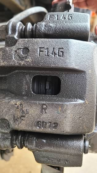

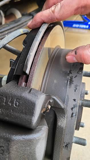

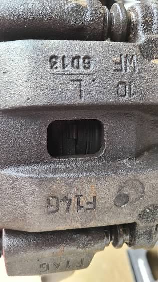

  21. Mar 10, 2022 at 4:50 AM
    #51
    Seafury
    Seafury Kickin names, and takin ass!
    Jan 22, 2020
    #41619
    603
    Agent K
    SC Low Country
    2014 White 1794 "SnowWhite aka the Frost Queen"
    Bilstein 6112/5160, 3 CB front shims, SPC UCA's, CB +3 rear Shackles, total 3/2 lift, Dif drop, CB Carrier bearing drop, Fortin Evo One remote start from Tech12volts PnP, AMP research Powersteps PnP, Vent shades, Tinted windows, Black/Red lined cupholder inserts, Proclip USA dash phone mount with Scosche Magic Mount wireless magnetic phone charger, Stock wheels/tires for now.
    Indeed hard to tell from pics, but looks like you are good for a ways still.
    Wear tabs look several millimeters from the rotors still.
    A really bright flashlight helps for these inspections a lot, makes it clear to see.
    Rotors look fine minus surface rust.
    I would definitely not bother with the extra work right now, but that's your call.
    Rears are also more of a pita with the inner parking brake shoes to deal with also.
