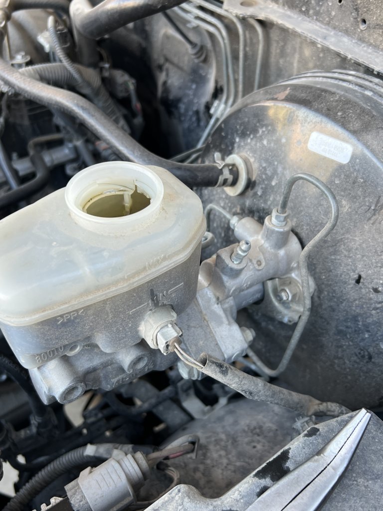

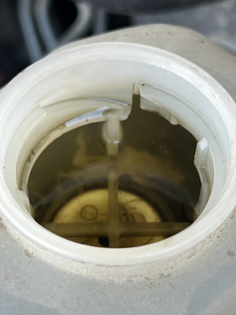

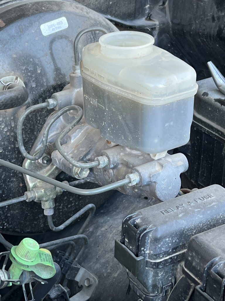

    Hello again! Went to flush my brake fluid, and I noticed there was a TON of debris in the reservoir, under the screen. Pictures attached. I'm thinking unscrewing the two lines (highlighted yellow) and then backing out the screws would allow me to pull the reservoir out to flush it out with brake clean and re-attaching. Then, doing a brake flush to get as much debris out as I can. Should I approach this a different way? Not seeing much on cleaning out a reservoir, or if it's even advised. I imagine there's an o-ring in there somewheres. Thanks!

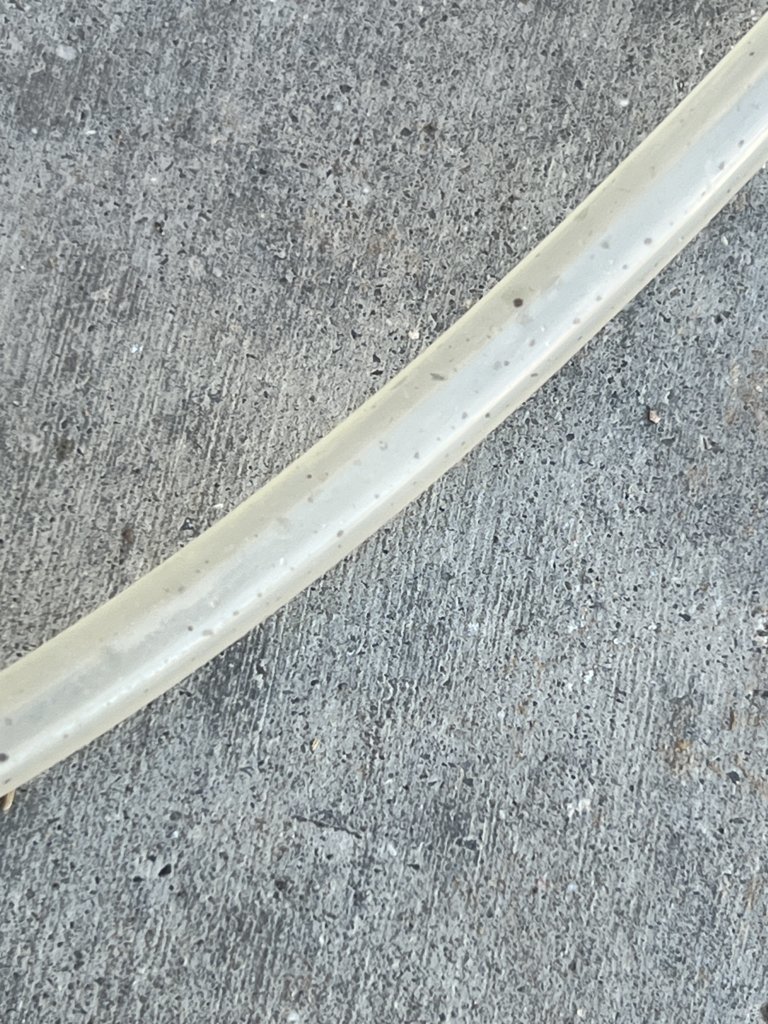

    I used a flexible tygon tubing on a hand operated suction bulb and sucked mine dry and ran a paper towel in it with a long screw driver to clean it out before refilling and then flushed my lines using a Snap-On vacuum pump attached to the bleeder screw to suck fluid thru each line one at a time. I ran about 3 bottles of fluid thru the whole system. I did about a half a bottle to each front wheel and a whole bottle to each rear wheel. I was doing that trying to make sure i got everything out and had all new in the lines and reservoir.
