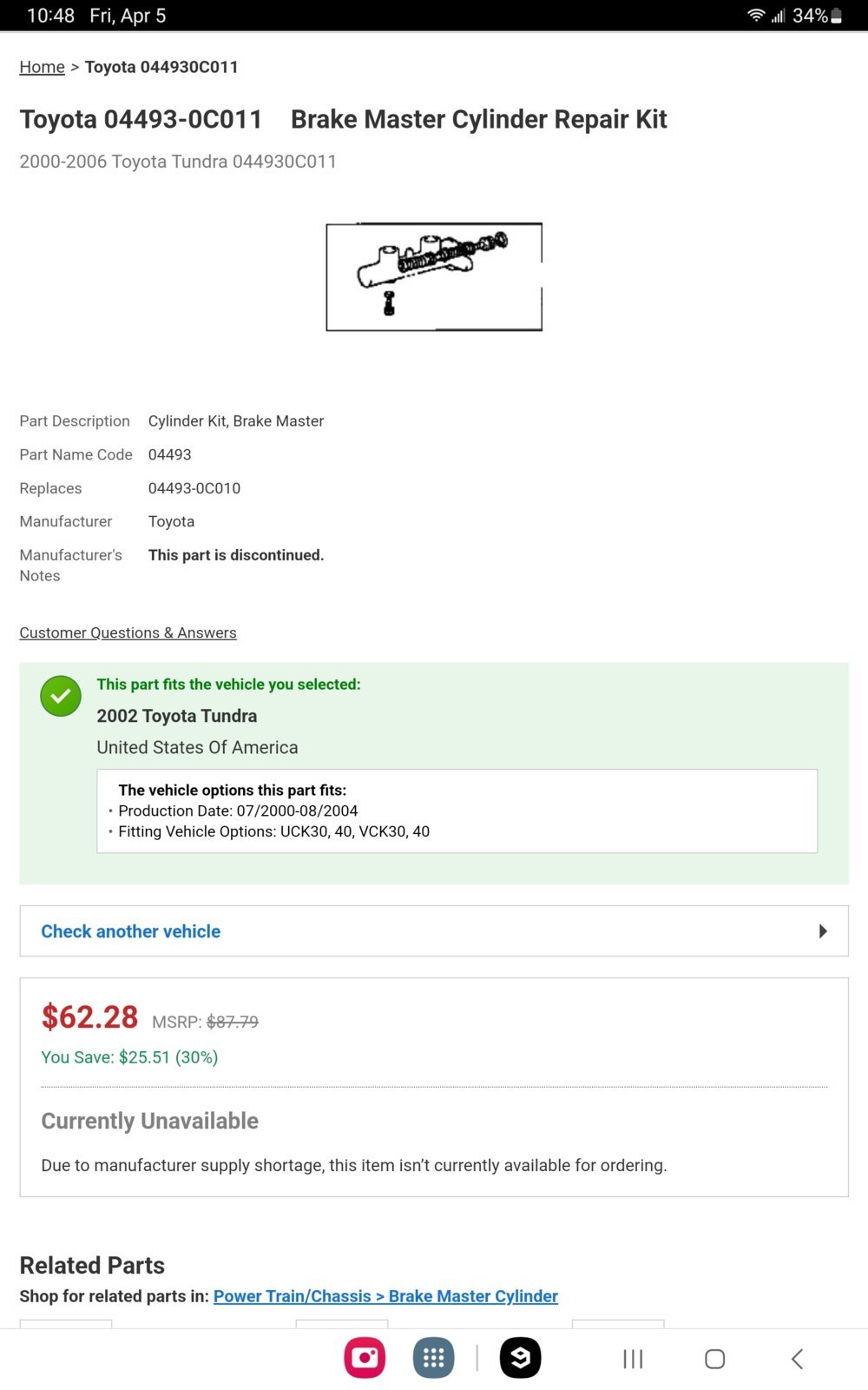

    Yeah, looks like there was one at one time, but now discontinued:

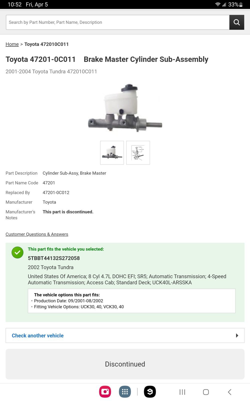

    So the other shitty thing, I was gonna go the @shifty` approved route and get an OEM replacement, but:

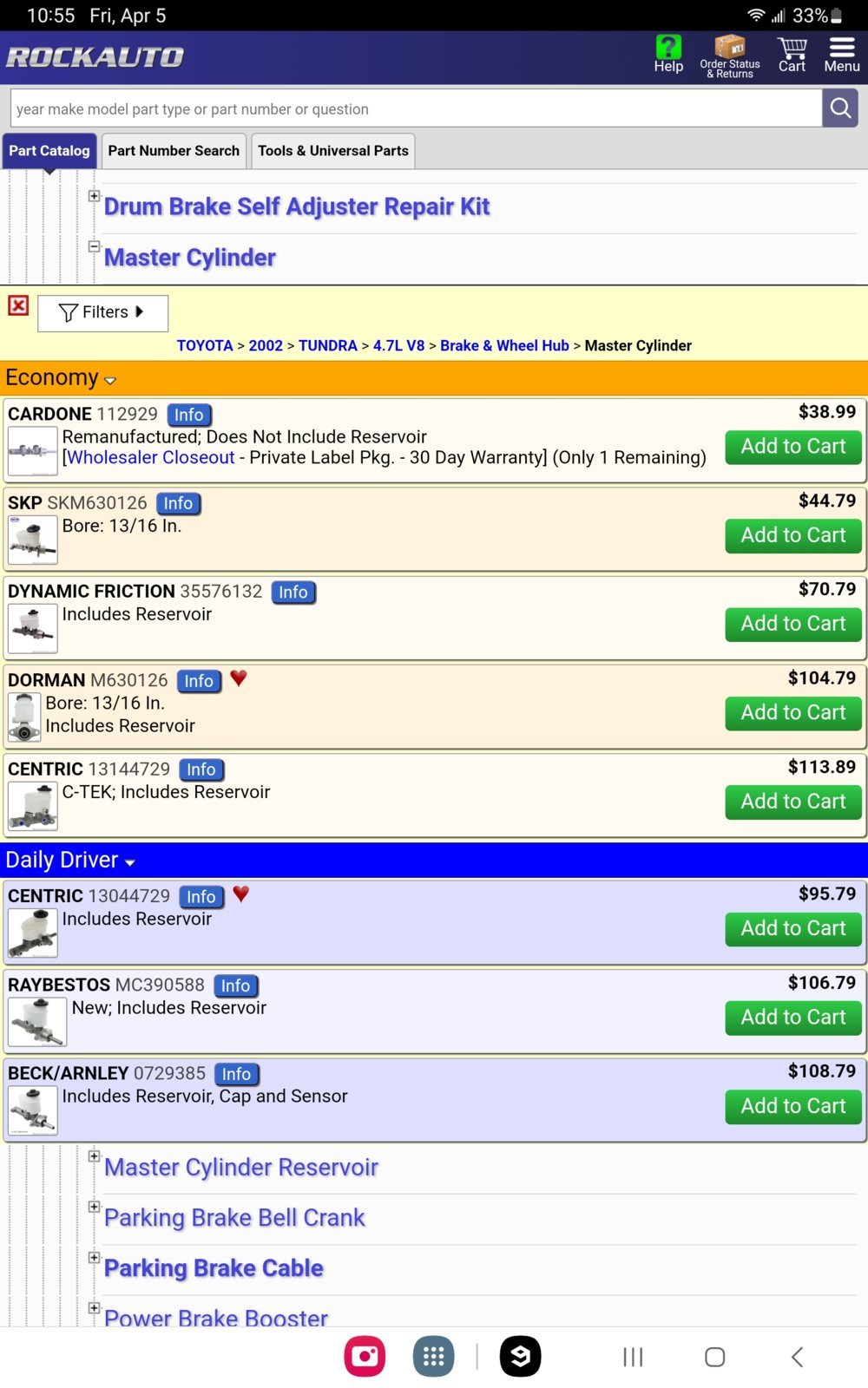

    Unless I'm not looking at the right part, it's d/c as well. I guess that leaves me with one of these:

    my raybestos MC has been working like a champ for 3 years now.
