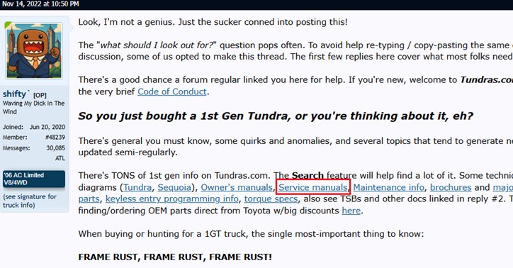

    Go here for FSM download, see pic below, link is near top.
