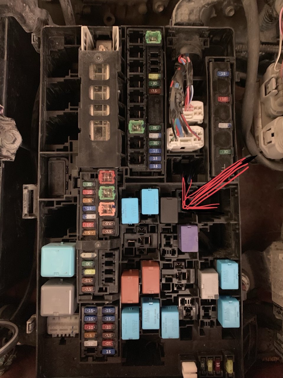

    iv checked "all" my fuses, brake lever switch, and a relayIMG_1052.jpgIMG_1052.jpgfrom napa the gray one, why because, thinking its the LED DRL relay

    Another possibility. When I was installing my LED bulbs, they were a tighter fit than the originals, and I accidentally pushed too hard, messing up the connector. Once I redid the connector averytjing was fine.

    found problem it was the 15 amp fuse labeled STOP it wasn't completely blown, weird

    Ahh, one of them fuses that become a resistor. It’s rare, thank goodness, but I’ve had a hell of a troubleshooting experience from one of them too. All to be fixed by a 25 cent fuse. :annoyed:

    Ok, now that it’s fixed....
    How does one break the fuse for the brakes without really breaking it, all the while thinking that your brakes are broke?
