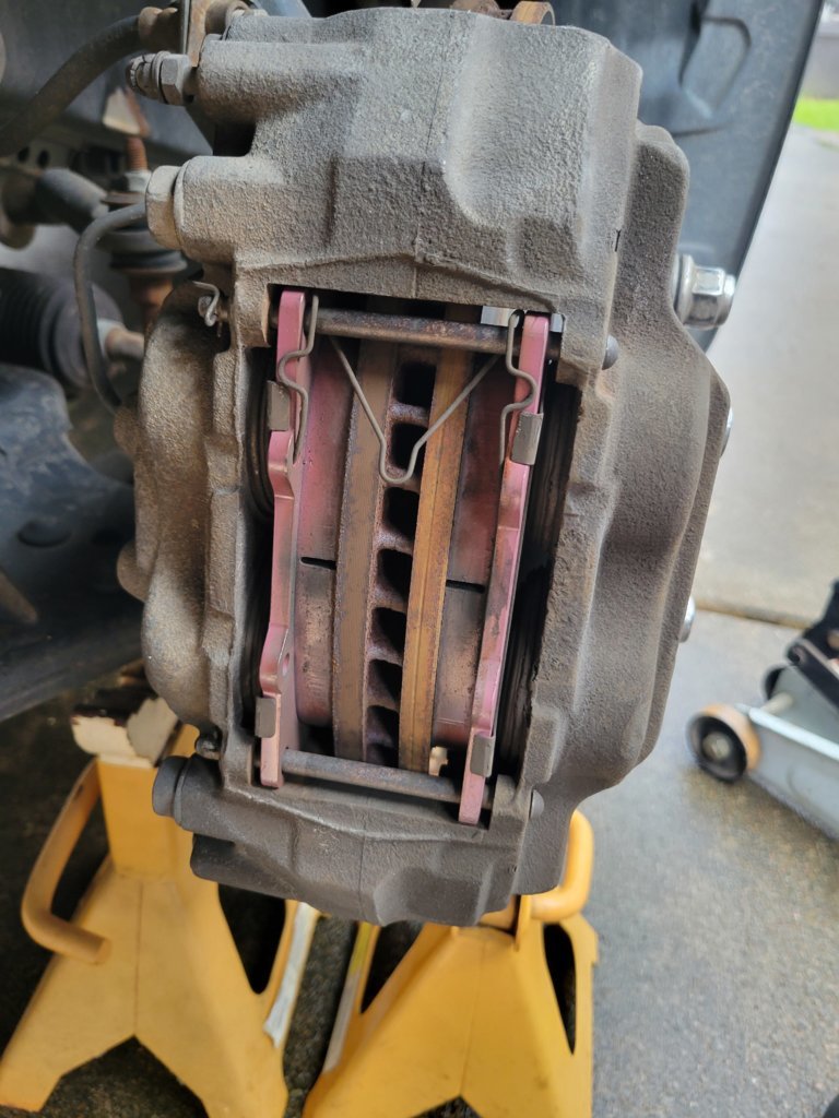

    OK guys, same issue as the OP, but on a 2007 Sequoia SR5, rwd. I didn't want to start a new post since the issue I'm having is exactly the same - imperceptible during soft braking, pulls left on hard braking but the steering wheel stays mostly straight, it just tracks left.
    For those who aren't familiar with the differences, Sequoia and Tundra brakes are essentially the same except Sequoia rear brakes are disk. Since the rears look perfect, and you guys haven't steered me wrong yet with my Tundra, help!
    To troubleshoot so far, I've changed pads to new oem, swapped front left and right tires, checked caliper pistons, lines, and suspension components for odd wear. The only thing I noticed was the OEM struts installed 30k miles ago have a very worn looking bushing where the shock mounts to the lower A-arm.
    Pics in the next post, Tia guys!

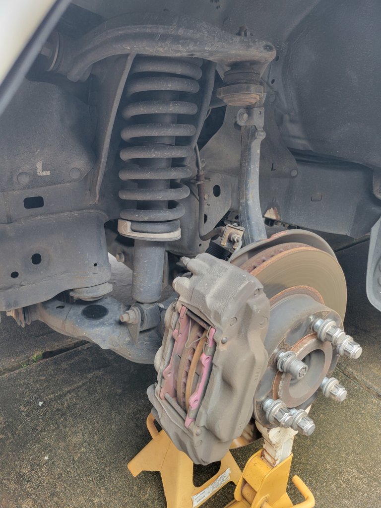

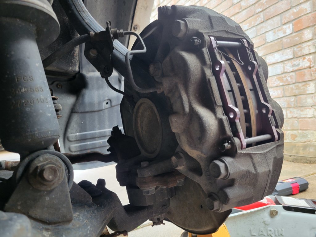

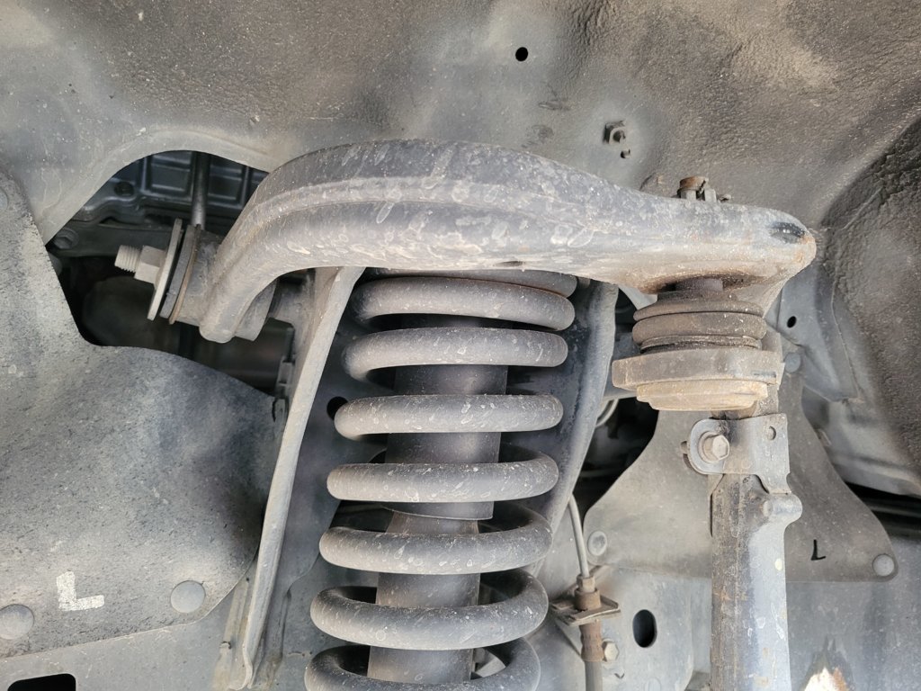

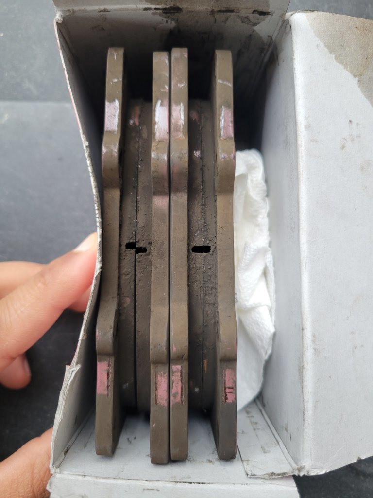

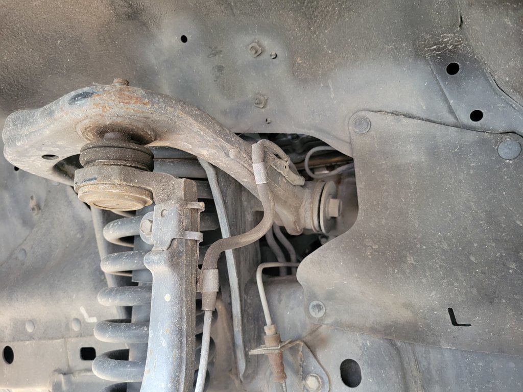

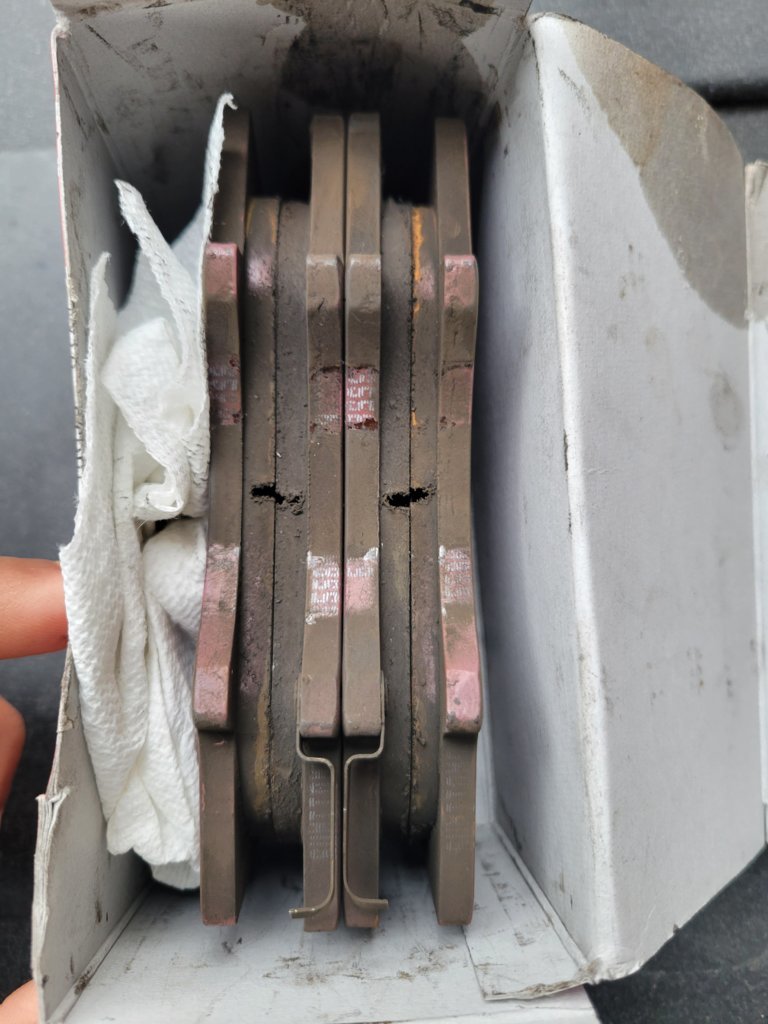

    Couple of pics of the pads as removed looking at the car from the front (so the right side pads came off the driver's side caliper).20250215_093746.jpg 20250215_093649.jpg
    And this is the receipt from 2021 for what was replaced - brake booster, front strut assys, rear shocks.

    This UBJ has seen better days. I think this is a part of the issue but not THE issue. Know what I'm saying?
    anyways, you said "check calipers" what does that exactly mean?
    The pull to either direction is almost always a stuck caliper or bad alignment.

    When I was installing the new pads, checking the pistons. They were all just fine, nothing stuck. I thought the upper and lower bjs looked fine but I can have another look, what specifically, Fish?

    I was just asking to see what you checked. Lol
    I would have a look see at tire wear and alignment specs now.
    Also if your suspension is just old or not up to par. The excess body roll can cause dives in different directions. Just shooting from the hip though.
