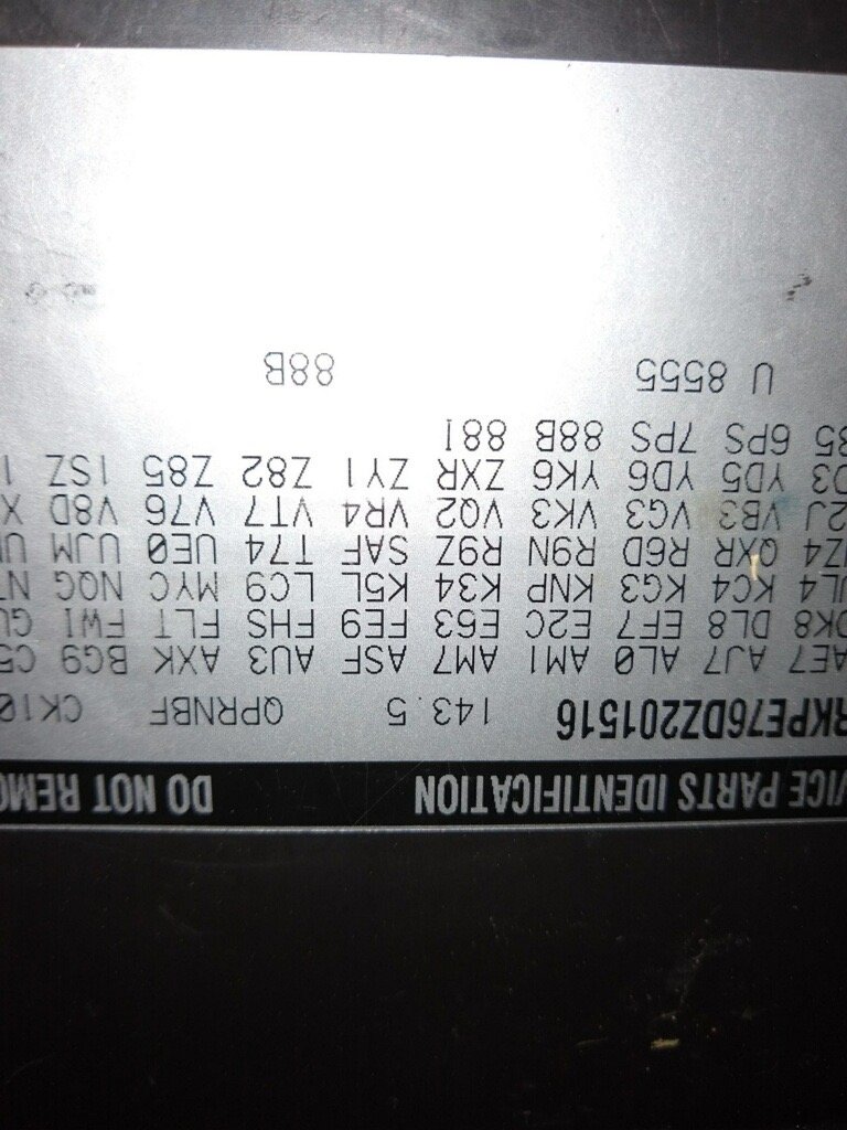

    Hi, we purchased our 2014 Tundra TRD SR5 new and have done no modifications thus far. We need to install a brake controller and are having trouble determining if ours comes pre-wired for this. The TRD is an off-road upgrade, but not specifically a towing upgrade. I called corporate and they ran my vin and provided a package description, however it isn’t the codes page (see attached) that I was hoping for to confirm that it is or isn’t pre wired.

    On my 2015 the connector for the in cab end is just sitting there in the dash behind the panel that Ron just mentioned waiting to be plugged into a controller,I know this because I installed mine this week.
    Just take a look behind the dash panels on both sides of the wheel and see if there is a connector there and I will bet it is ready to go.
    If you have the hitch and tow haul mode switch I would think you have the dash connector there too but also I looked up my VIN on the Toyota Owners Site and it said that I had the Tow Package from there,I have never even seen tose codes anywhere on my truck that you pictured,where are they?
