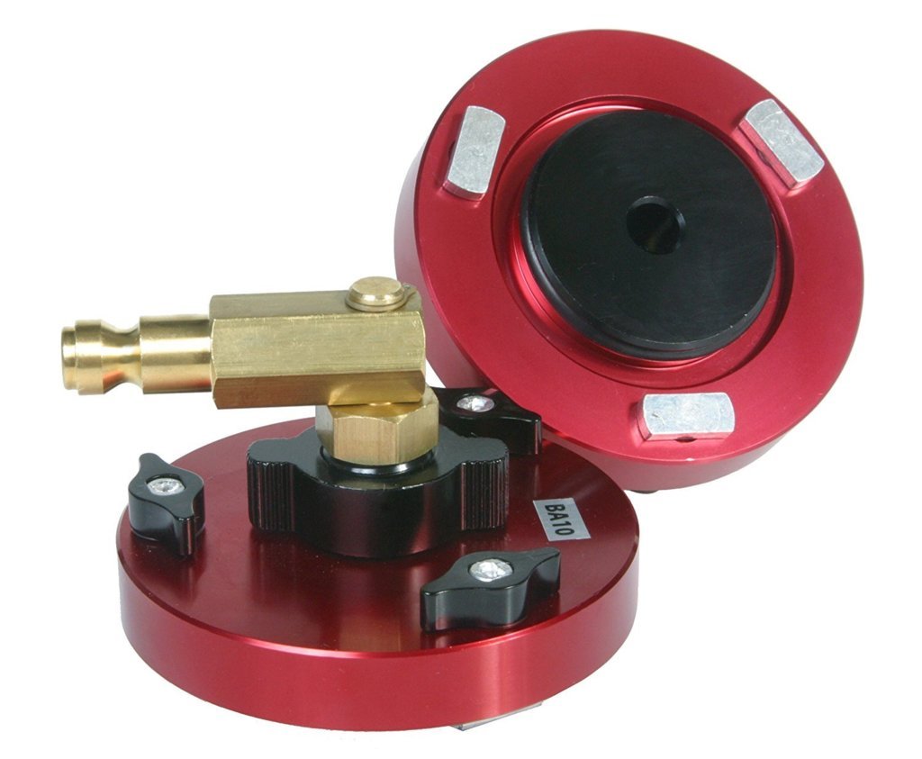

    Bought the aluminum bleeder cap ($30-40) and used a 1 gal garden sprayer ($10). A couple feet of clear hose, two npt fittings and a hose disconnect. (Pre insanity/inflation pricing.)

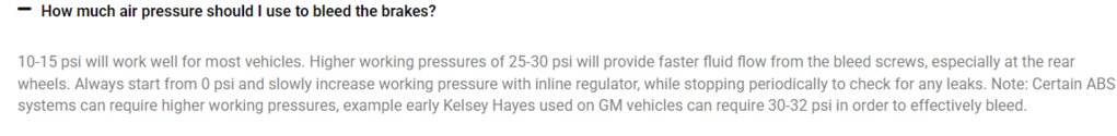

    Mine works great. Pumped the Motive it up to 25psi and let it sit for several minutes -- the needle didn't move off 25.
    In my experience, auto feeding fluid is overrated. I've had my Motive for about 25 years. I used it's auto feed feature a couple of times when I first got it -- it ends up making a mess and leaves fluid behind which needs to be cleaned out so it's spotless for the next time I use it... which for me could be a year from now. It was just more hassle than it's worth. I just use the Motive as a pressure vessel and fill directly to the reservoir.

    25 PSI?! I was told not to exceed 15 PSI...

    The pressurized container also acts as a fluid reservoir, yes.
    I pulled this from the Speedibleed FAQ
    w666[QUOTED] likes this.

    I think 25 is fine. But I was intentionally going a little high to see if it would hold pressure steady. (it did)

    Well…..too much pressure and you might blow up the brake fluid reservoir……have to admit though, before I realized the lspv needed to be full open, I tried as much as 20 psi.

    I suppose it's possible. I usually have it between 15 and 20 psi when bleeding brakes. I wonder if those tools that use the tire as a pressure source regulate the pressure. If not, that would be some really high pressure: 50+ psi in some instances.

    I'd think you'd be blowing seals before you pop the master cylinder housing from pressure. Real bad day if you blow all the seals in your brake system.

    To your point, it's a hydraulic system, and one directly linked to human safety which is responsible for stopping ton(s) of weight from moving. I'd expect it to be able to sustain 30-40psi without fatigue.
    Should someone run that much pressure against it for periods at a time to test that? I wouldn't, not on potentially 25 year old calipers and their equally old piston seals. But if I needed to test something briefly, I guess?

    I wouldn't worry one bit about anything beyond the MC. The MC reservoir is the only part of the system not designed to withstand 800-2000psi of pressure during braking. The system itself will laugh at a measly 30-45 psi. The MC might have issues though....
