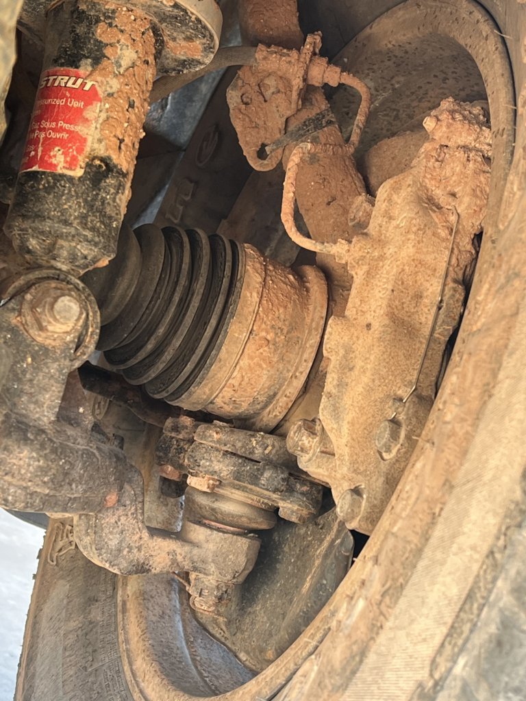

    So he claims he changed the LBJs at 170,000 miles. He doesn’t know if it was oem. Is there a way to tell oem from aftermarket while it’s attached to the car?

    Based on that aftermarket shock,.I'm going to say it's likely safe to assume the LBJ is also aftermarket

    Crap, probably will plan on changing them out then

    Not sure if your year had OEM dust cover, but the grease boot looks more round, and the casting looks definitely different than OEM.
    Do they have grease zerks?
