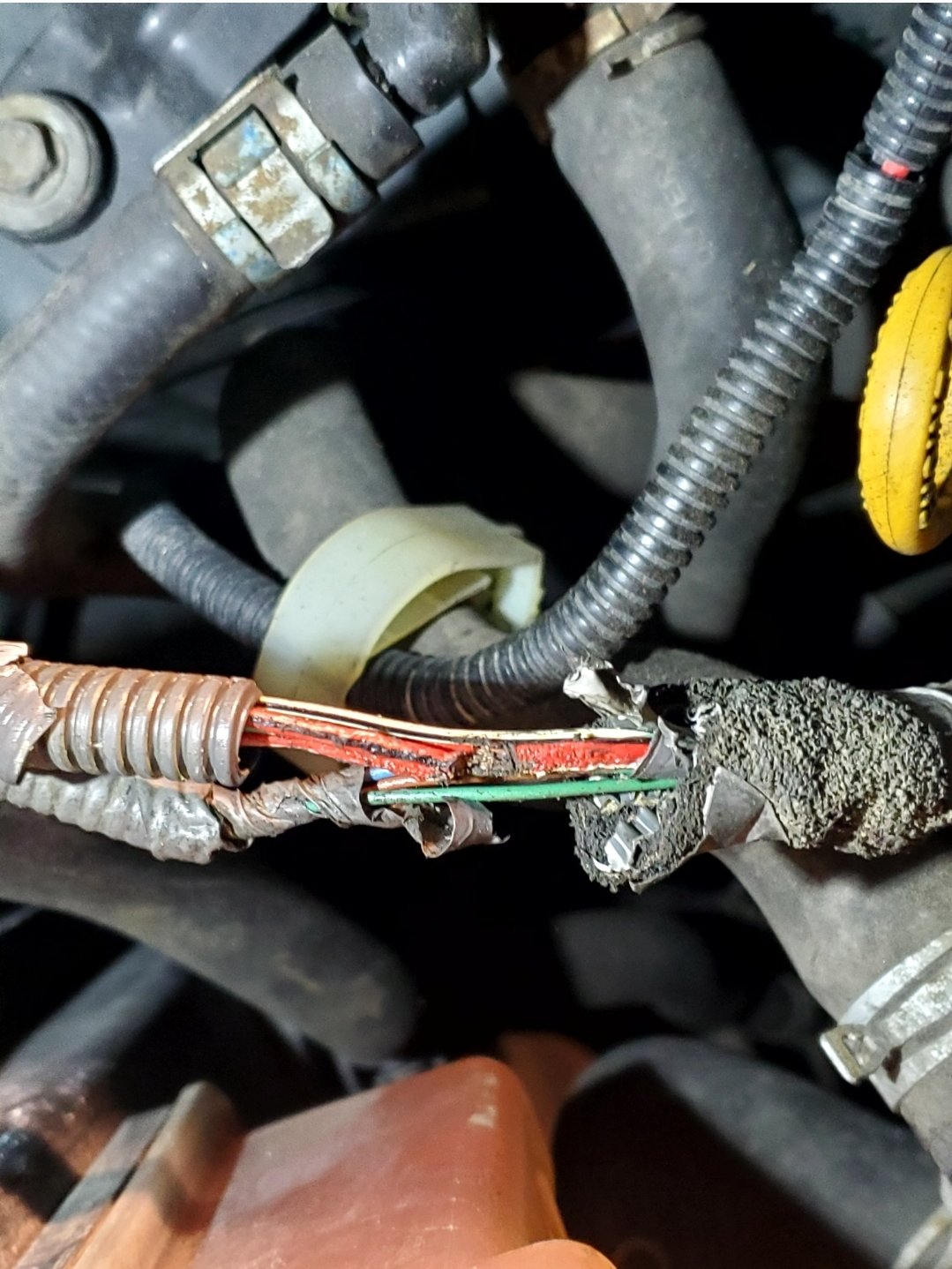

    Found another gremlin wires for the powersteering I believe, was rubbing on one of the belt pulleys was chasing that issue for a few hours tonight

    Is the power wire not fused or what? Seems like there could still be a little more diagnostics to be done. Maybe there is some rodent damage to the wires at some other point?? Just seems to me that a dead short should be blowing out a fuse. Good luck and keep reporting what you find as it's great information for the next person(s).

    Heres the root cause of my problem, harness was rubbing on my accessory belt and this is for my 4wd, goes down to the front diff sifter
