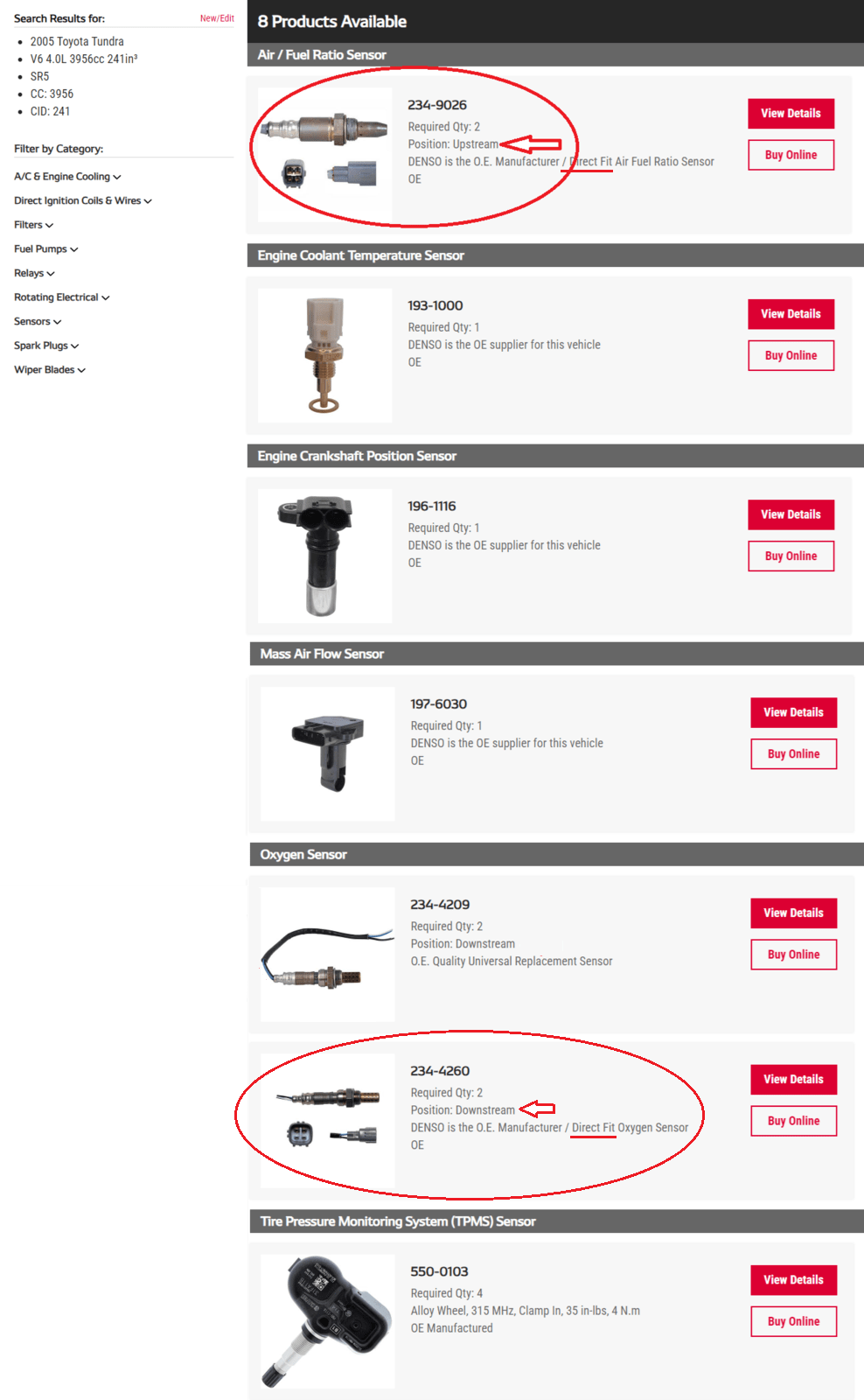

    Are those part numbers for your 2020, or his 2005? www.densoautoparts.com is showing totally different numbers when I plug in his truck details. Important we're giving OP valid info so he doesn't blow his $$ on parts that won't fit.

    Sorry Shifty, those part numbers are for my 04 4R -- I was trying to highlight that the upstream and downstream are different, and right/left downstream were different (not four of the same thing). I found the same AFR you did, but came up with a different part for the 02. I chose a 2005 Toyota Tundra Base, 4.0L V6 on Denso's site. I get these part numbers on RockAuto as well looking up that vehicle.
    Upstream AFR (both sides) is Denso 237-9026 (https://www.densoproducts.com/denso-234-9026-oe-identical-afr-sensor)
    Downstream O2 (both sides) is Denso 234-4260 (https://www.densoproducts.com/denso-234-4260-oe-identical-oxygen-sensor)
    Both parts are available for slightly less at RockAuto (I mention them because I've had good experiences there. I have never received counterfeit parts.)

    Denso's part lookup tool (screenshot above) disagrees with the numbers you pulled from RockAuto.
    Are you sure you were looking up for the V6, and not the V8?
    EDIT: Shit, you're right, I accidentally circled the universal, which OP should not use. I'll mark up that pic so I don't confuse anyone. Fuck!

    Hitachi is OEM for the V8 / 2UZ-FE on MAF.
    Denso appears to be OEM for MAF on the V6 that OP has in his truck.
