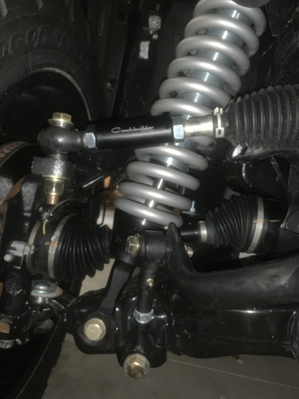

    Good morning. Nice looking Tundra! I had a very similar size tundra with the 7” pro comp , coilovers, 37” x12.5” tires, 22x12” Rim’s and a -51 offset. I did have the carrier drop for the driveshaft, coach builder shims, coach builder steering ends and a body chop mount installed. The body shop mount was a must otherwise the tires rubbed.
    So heres my questions on your setup. Did you have a body mount cut yet for clearance? What’s your rim size & offset? Where is the tire rubbing at the moment? Did they move or trim your front inner fenders yet? Any pictures would be a great help. Hopefully we can figure out a solution on here.
    Here’s a photo of my front suspension when it was installed. Did you replace your UCAs?

    Did you get aftermarket Upper Control Arms installed on your lift? This makes a big difference on the geometry of the suspension!

    I put just over 90k miles on my previous tundra with the suspension and wheels done from day one. I had no issues with the CV angles. My truck drove very smooth. Only issue I had was the body mounts, so I had them cut to remove the rub at full crank.

    Btw did u do the tie rod ends at the same time as ur lift, or were they added on after? (Wondering if they made a noticeable difference)
