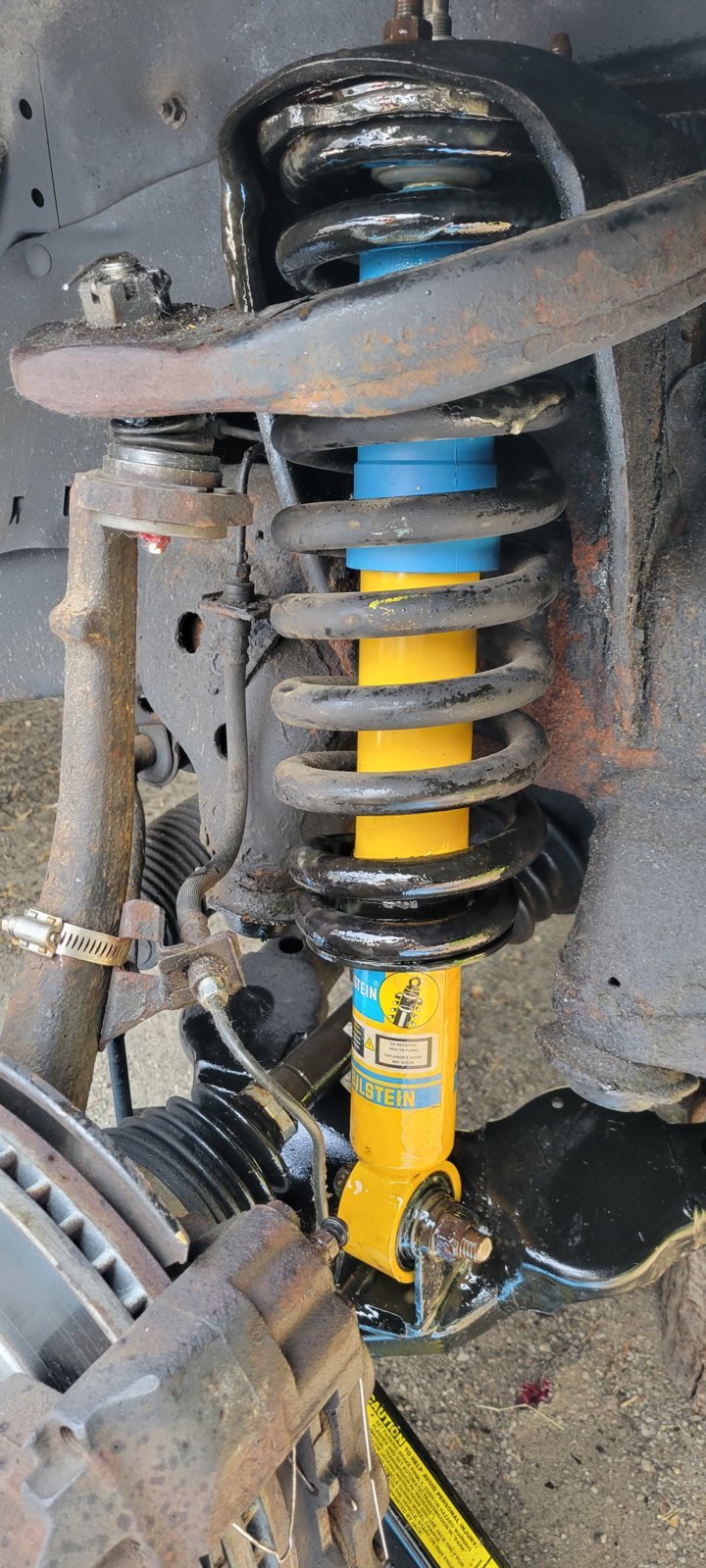

    Yup, me, Jake, and Dale got the brake lines in. Replaced the hard and soft lines in the front, and the soft line in the rear. Went braided SS for the soft lines. Had to put a little heat on the pass side line, and the drivers side rear bleeder. Got the new bleeders in for the rear. Speed bleeders are pretty neat once you figure out how they work. As @shifty` says, RTFM. Replaced the battery as well. 6 years old with 2 years pushing 1200 watts of amps.
    We bled it 2-3 times and I took it around the block. Pedal did not feel good and braking sucked. Bled again. Drove again. Beld again and adjusted the prop valve up. Drove again. Did a final bleed and called it good.
    My brakes sucked before, and they're still not good, hence Jake's post above. I'm sure they're out of whack, and full of diff juice. But, Ironman is road worthy, and 2 15s still hit hard as fuck.
