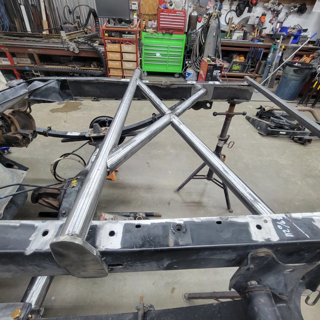

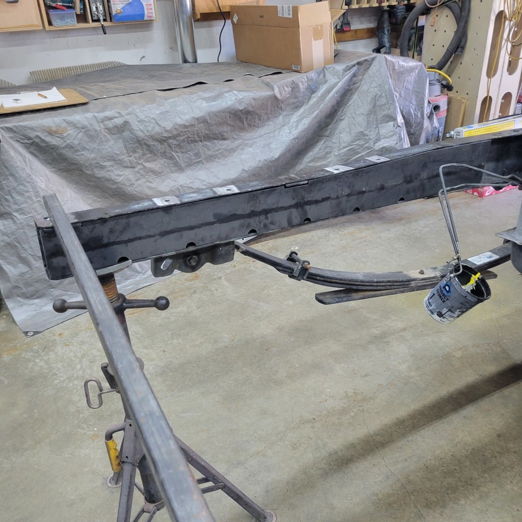

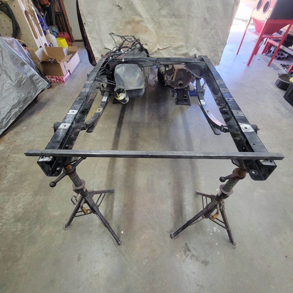

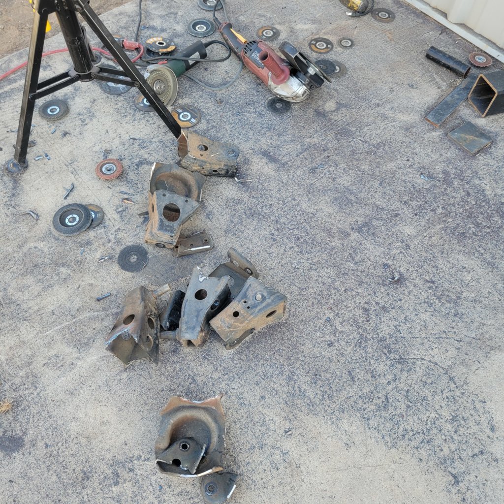

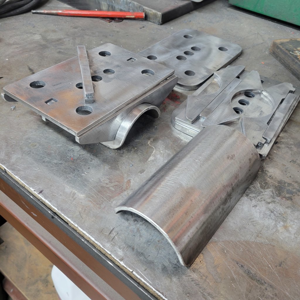

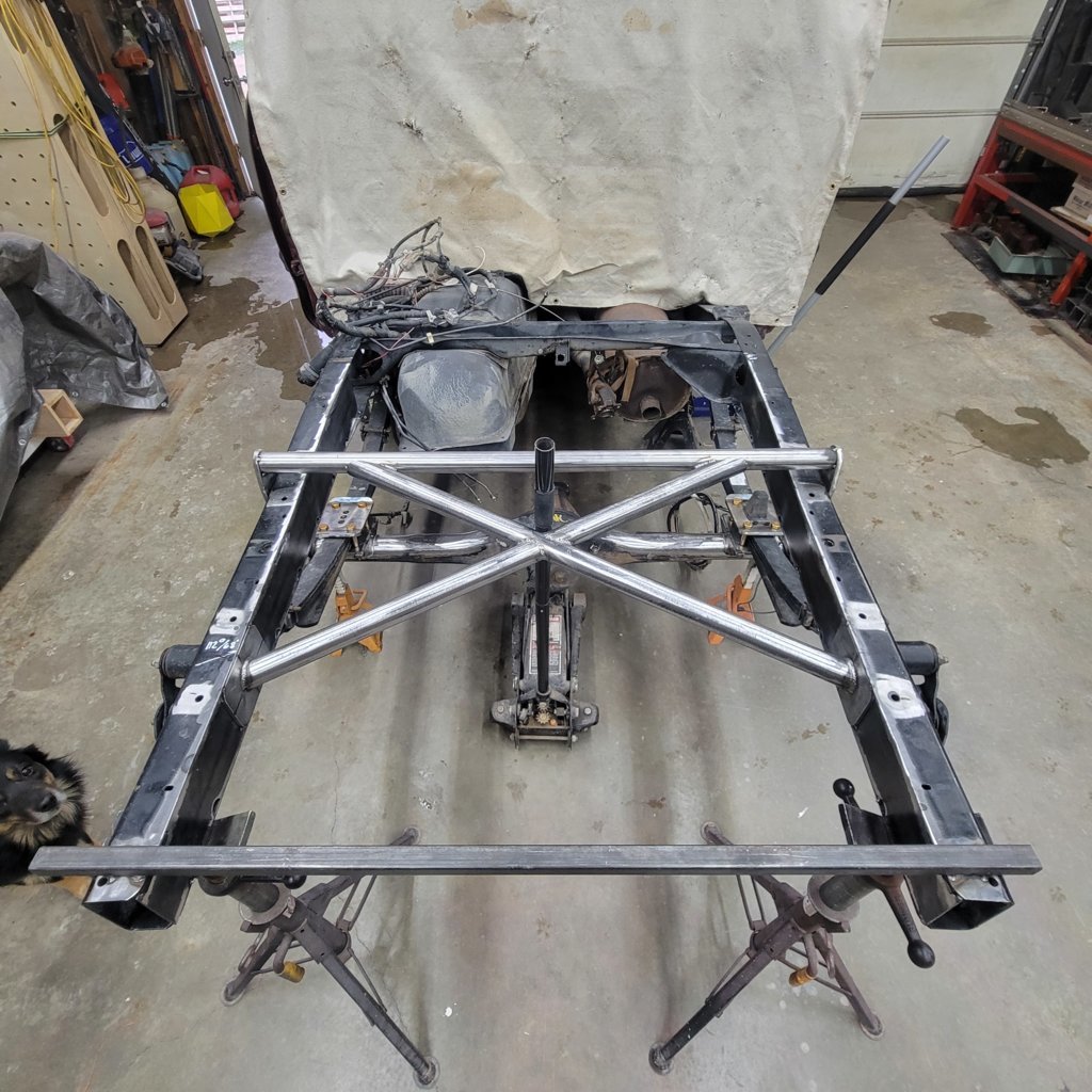

    Started the day by tacking in a temporary brace, and removing the spare tire carrier.
    Put together a drawing for these frame boxing plates, and cut a pair.
    So many brackets
    The aftermath
    Ready to start going back together.

    Bone stock
    I’m slow/special, why wouldn’t the oem cross brace work? Or just because beeftown?
  5. Mar 1, 2025 at 5:33 PM
    #215
    JakeJake
    JakeJake Slippery Snake
    Jul 19, 2023
    #100515
    1,467
    2000 Tundra AC 4X4
    Option 3: Tube is light/strong/sexy.

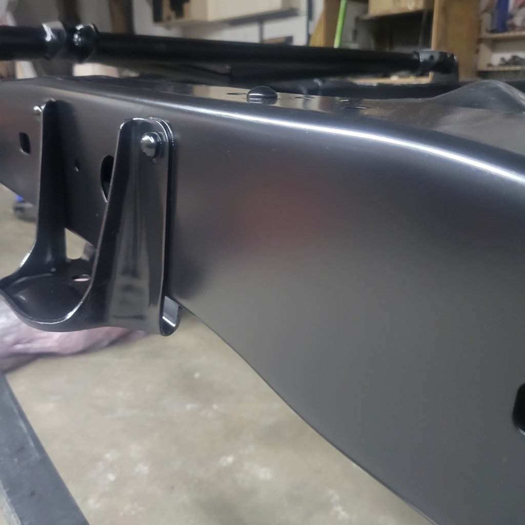

    Not only is this taking the frame to the next level beef town, but that fitment is fkn level 10. Color me impressed. Nice work Jake.
    I like what you did with the weep holes too, and for northern salties like me, a place to apply rust inhibitor through :thumbsup:

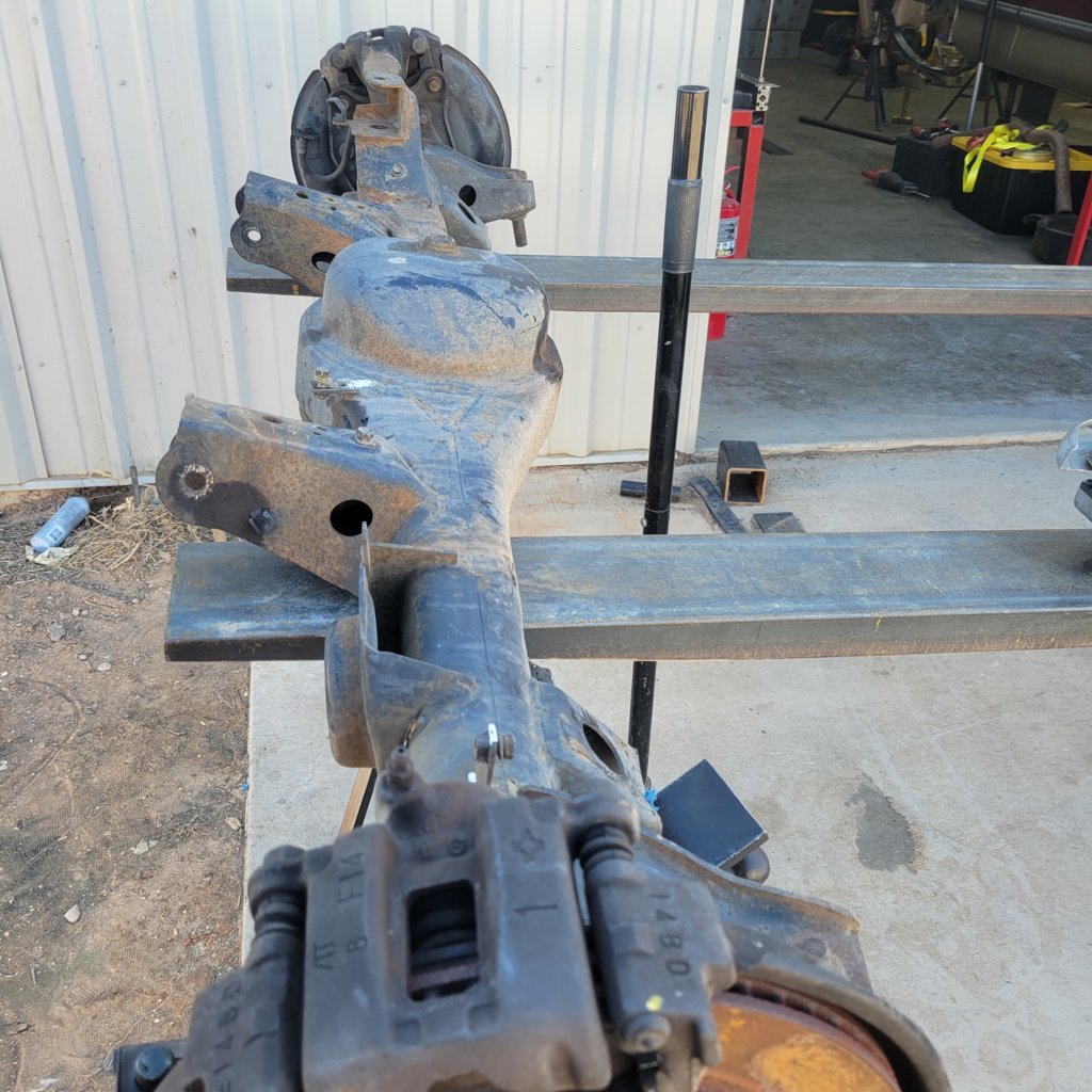

    So are y'all keeping the leaf packs as is, or planning a bastad pack, or what?
    The u-bolt eliminaters are pretty neat. What advantages do they provide over a u-bolt flip? Less likely to have axle wrap?

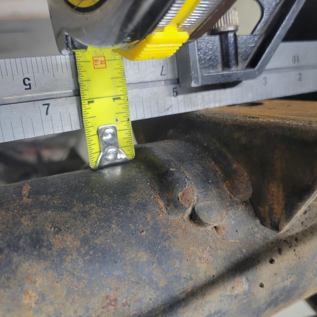

    There's several advantages to a u-bolt eliminator:
    Better clamping/control of the spring pack
    Better control of axle wrap-related to the above ^
    Way more beef/weld/size than the oem perch
    uses standard off the shelf bolts-easy to source replacements- easy to impact in and out
    this design allows for wheelbase adjustment + or - 1 inch
    Smooth bottom of the axle tube without anything to hang up on
    opportunity to add lift without springs/blocks etc. I setup Beau's truck using the factory tundra offsets so no added lift on this one, but any tundra leaf will bolt right in at its advertised measurements (+1.5" for his TG progressive AAL for example).

    How do you add lift without spring or blocks? Weld in a thicker base?
  16. Mar 5, 2025 at 7:14 AM
    #226
    JakeJake
    Jul 19, 2023
    #100515
    1,467
    2000 Tundra AC 4X4
    Changing this offset between the axle tube and the spring perch will adjust ride height.

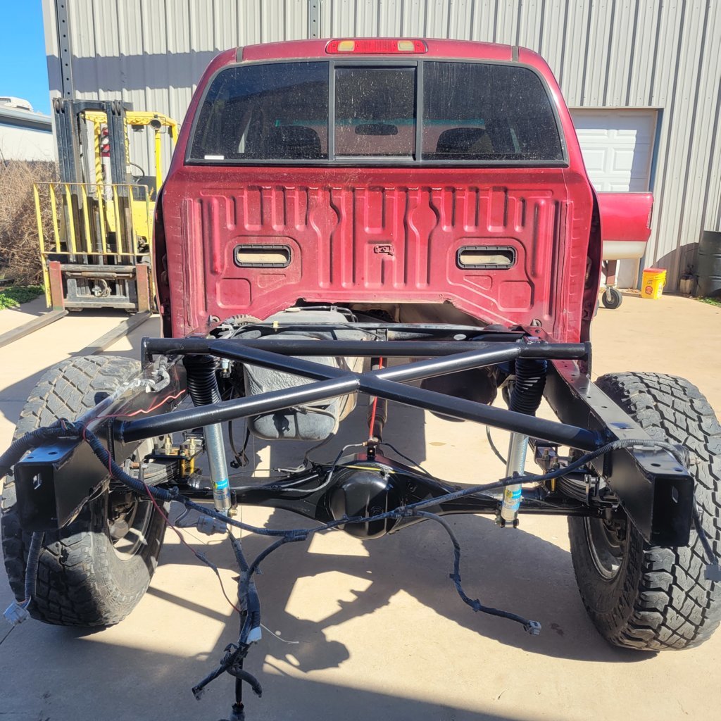

    Jake got Ironman all wrapped up today. Holy hell I actually have brakes now. A few pics I grabbed today.
    Truck feels great. Looks amazing under there! I was able to crawl on my hands and knees under there. There's still some work to be done, but it's out of surgery and driving.
    Needs new wheel bearings.

    So is the rear axle any wider than before?
    I'm jealous of that shock relocation

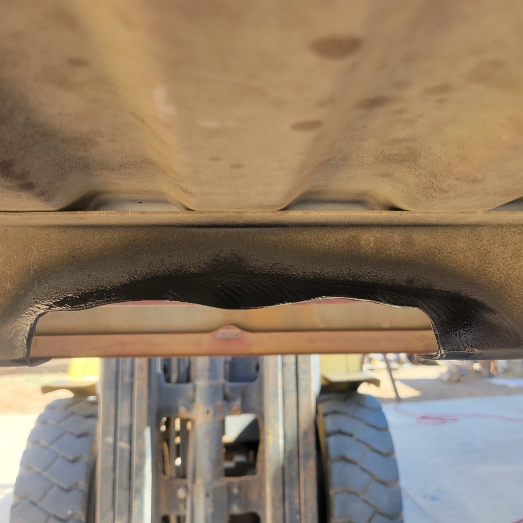

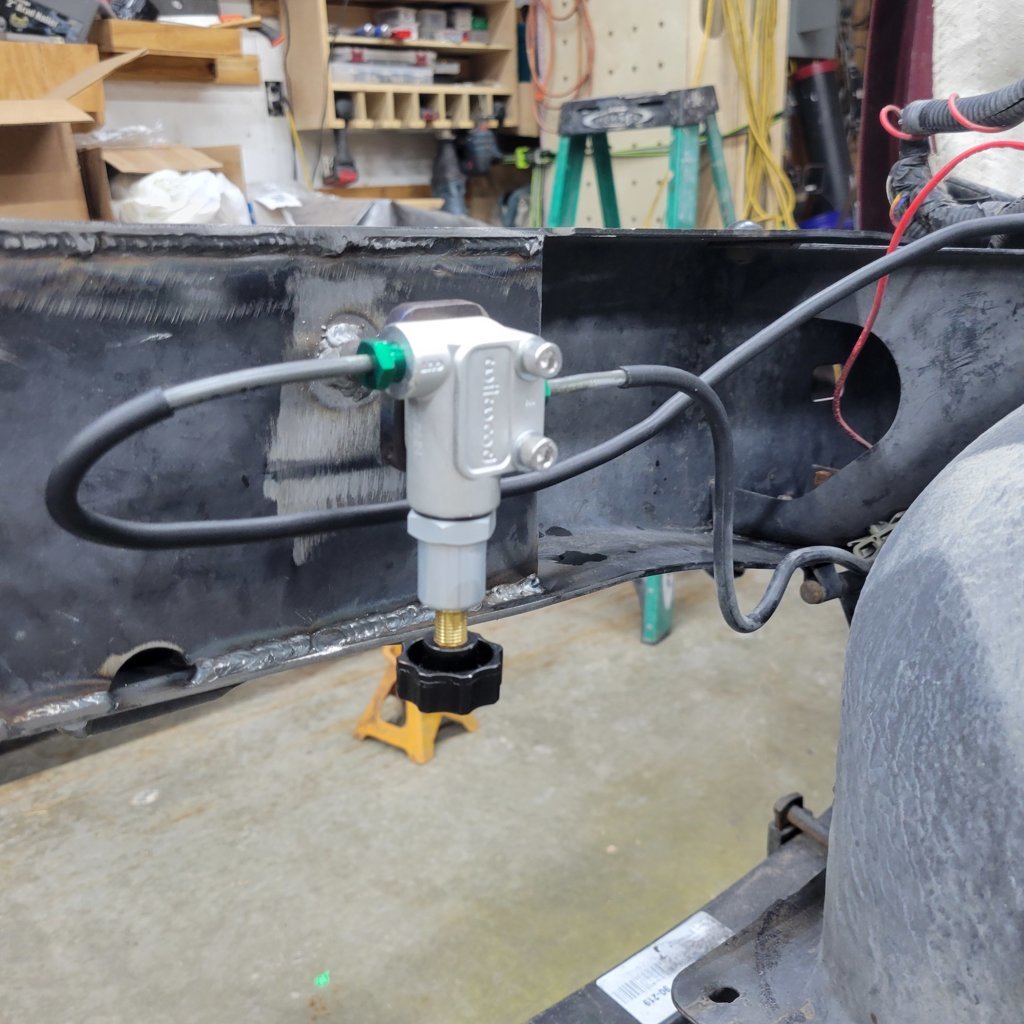

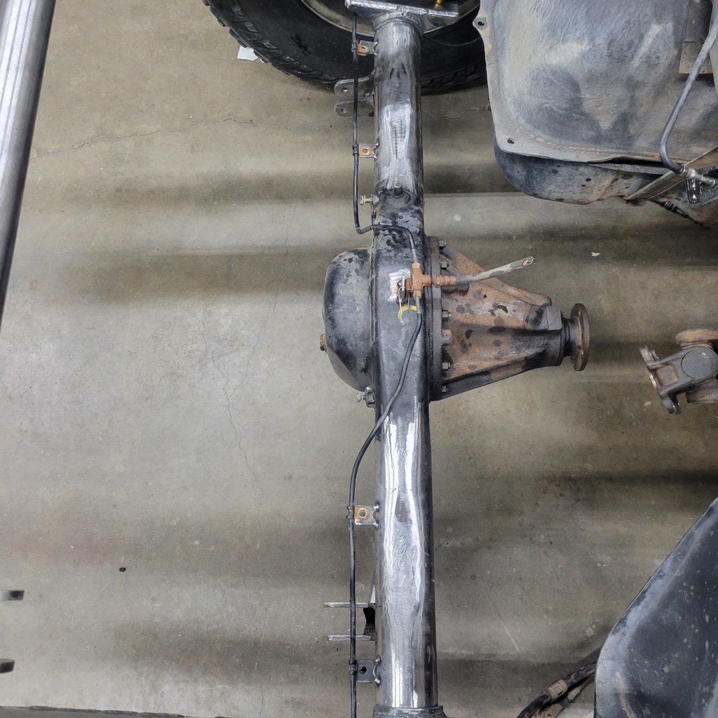

    I have a ton of pictures. Unfortunately most of them are terrible mix of greasy camera lens, bad lighting, and Dale blocking the subject matter. Here's a few of the best of the worst for your viewing pleasure.

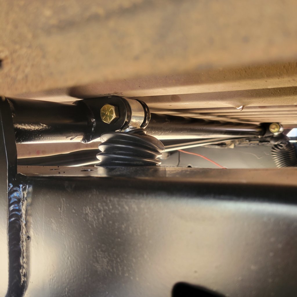

    Prop Valve- Plumbed with re-bent and re-flared factory lines
    Rear axle hardline- This is the OEM tundra line re-bent. Mounting provisions added to the axle housing.
    Butta'
    Painted and re-re-reassembled. Out in the sun for the first time in 10 days.
    The tightest of fit between the upper mounts and the bed floor. Not ideal, and not what I was planning for, but the way she goes sometimes.

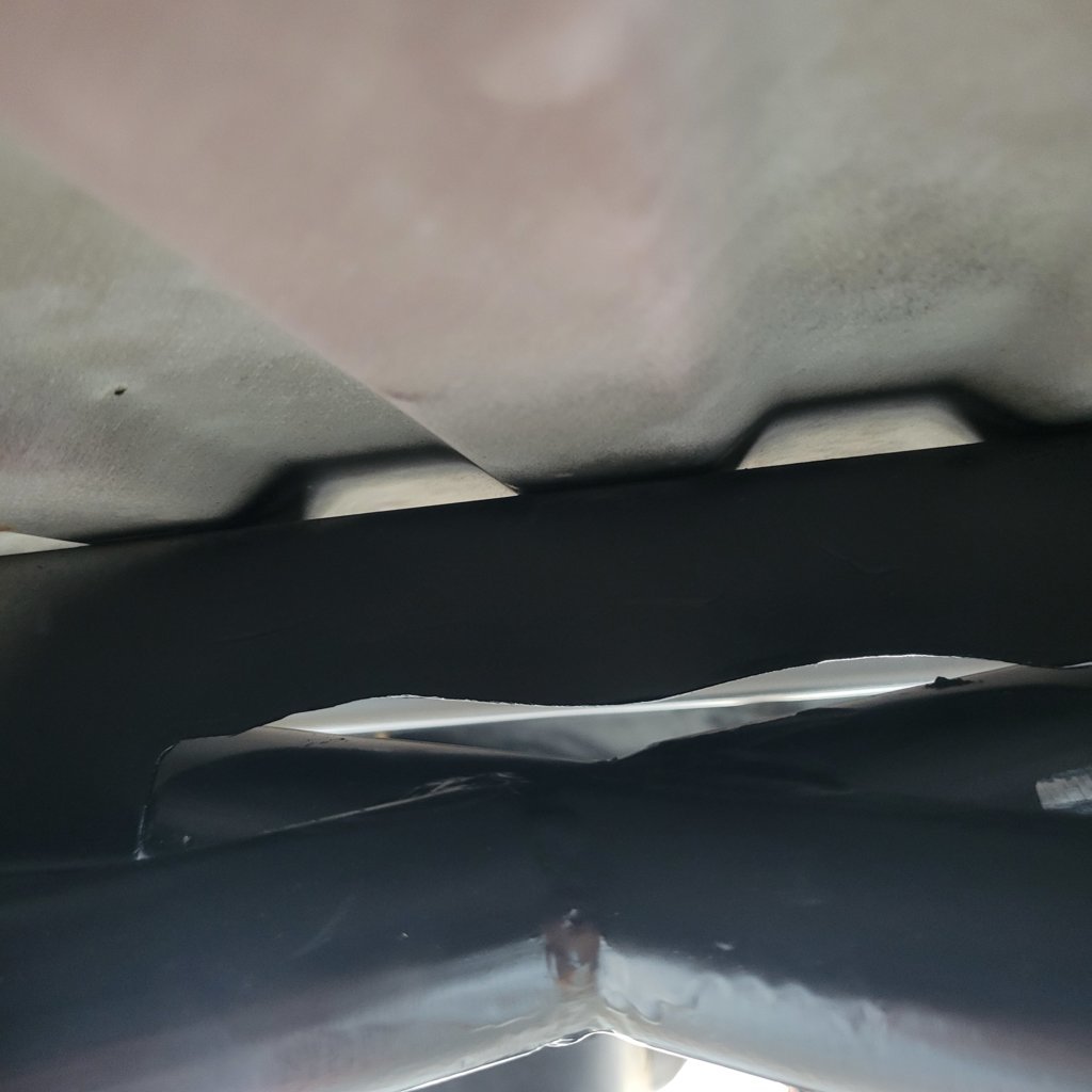

    My other big oopsie, and biggest regurt on this whole project. Somehow I missed the interference between the new x-brace and one of the bed crossmembers. Should have plasma cut a gusset to reinforce the area that I removed while I had the bed off. Notch is about 1" or 1/3 of the crossmembers original height. Definitely weakened to some degree, but for Beau's intended use it'll be just fine.
    All in this was about 80 hours of work over a 10 day period, and realistically needs another ~10ish in finishing some of the details. Definitely learned a few things, And have a better idea of the process/pricing/nuance of working on someone else's project. Im pooped and the shop is a mess.
    Overall a cool way to get rear discs on a tundra, and Im stoked on the breaking performance.

    Why does it look like the shocks will bottom out before it reaches the bumpstops?
    that smooth shave axle is hawt.

    What bumpstops? :rofl:
    Thats still on the list. The factory bumps will be just about perfect when compressed.
