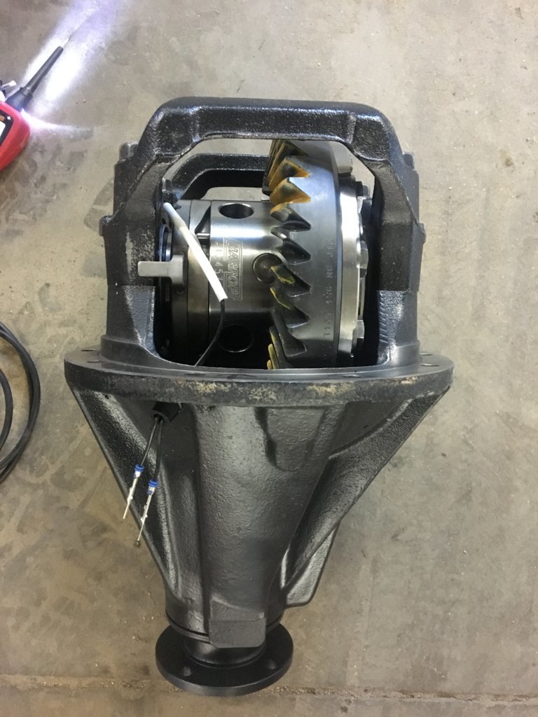

    When i swapped a junkyard sequoia 4.10 3rd members into my tundra, i didn’t have to swap the pinion flanges. That being said, i sold my existing tundra 3.90 3rd member to a random guy on craigslist, and he ended up having to swap his drive flange onto the 3rd member that he had just bought from me.

    This here exactly. In addition, the 8" elocker uses smaller 10mm studs, while the 8.4" uses larger 12mm studs if memory serves right. Regardless, the 8.4 has a larger mounting footprint, and is stronger with the bridged carrier caps and larger bearings, gears and carrier. To get an 8" in, you'd be looking at a custom housing which I think negates the entire idea. Not worth the money or time involved.

    Might as well just buy an Eaton e-locker. I love mine.

    Exactly. I did a Harrop way back when they first came over to the US. Cruiser Brothers, the company I bought it though, was originally the only company importing them at that time, and they gave me a discount on the locker in exchange for photos for advertising. According to them, I got the first Harrop in the US. I can't find the ad they used my truck in anymore unfortunately. I love mine though, never had an issue with it.

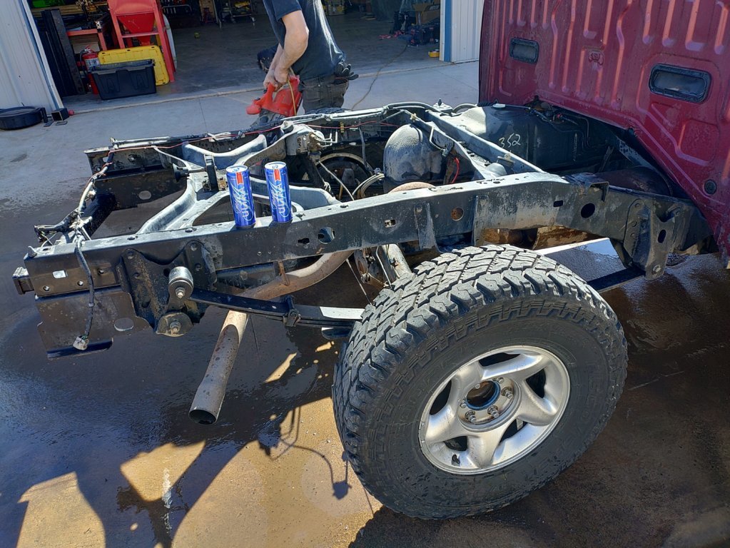

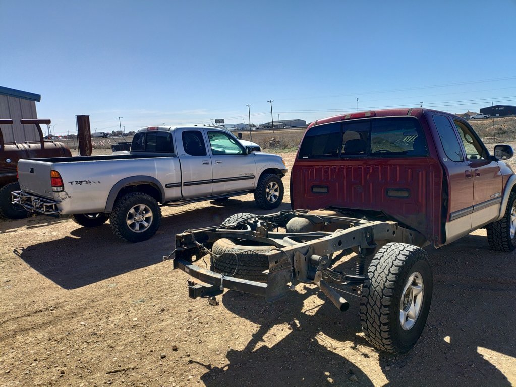

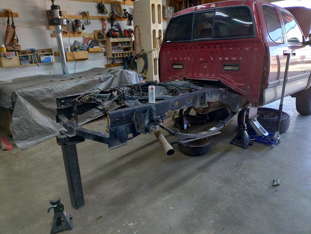

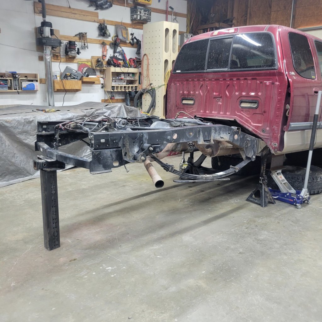

    75 and sunny today, a great day for @bmf4069 and I to get this project kicked off.
    Todays plan is to get Ironman cleaned up and stripped to a bare rear frame.
    -Measure pinion angle
    -remove rear bumper
    -Remove bed
    -drop spare tire
    -Pressure wash
    -remove axle/springs/shocks
    -remove brake lines to LSPV and LSPV
    -tack in temporary x member
    -remove factory spare tire crossmember
    Should look something like this
    LETS GO!

    Who’s the ahole that put those spring shackle bolts on backwards? :D

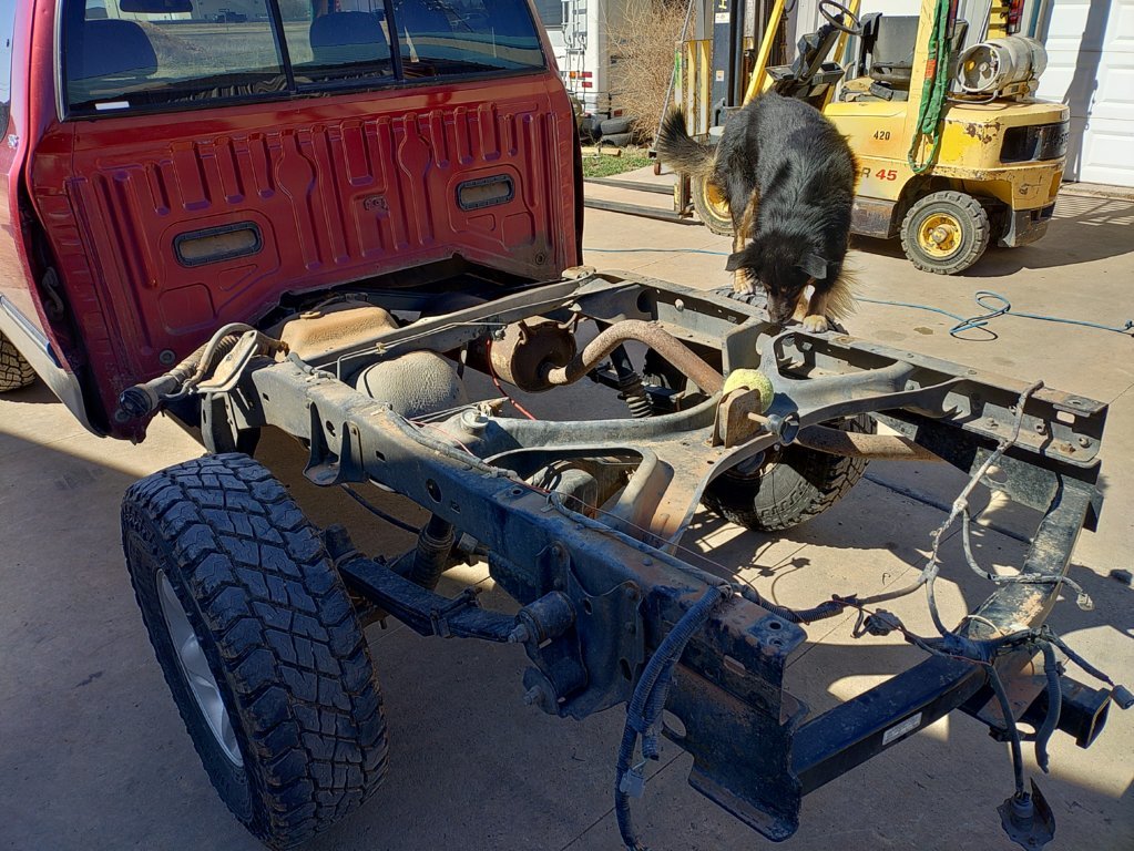

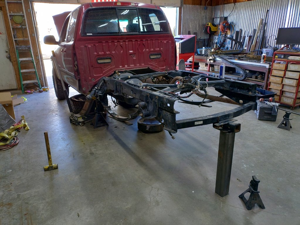

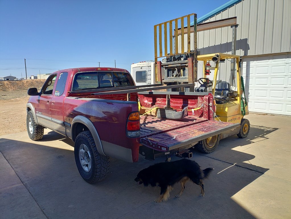

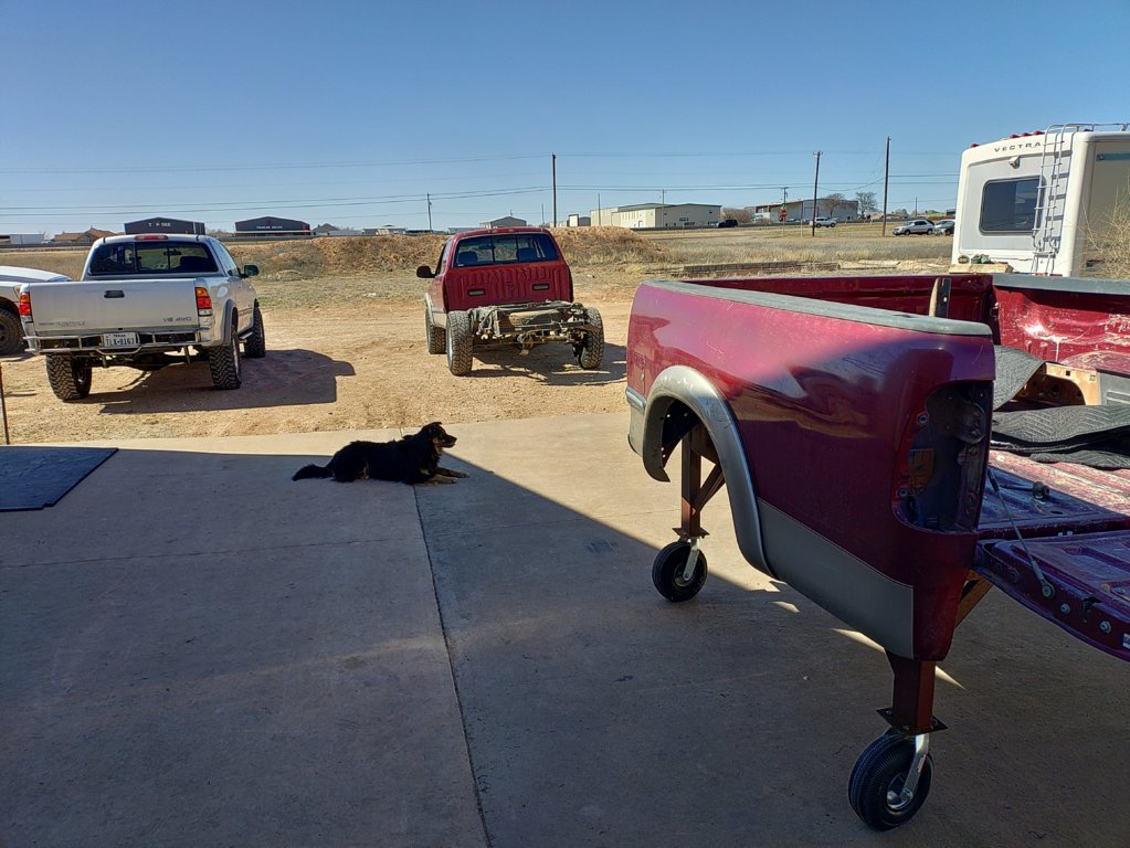

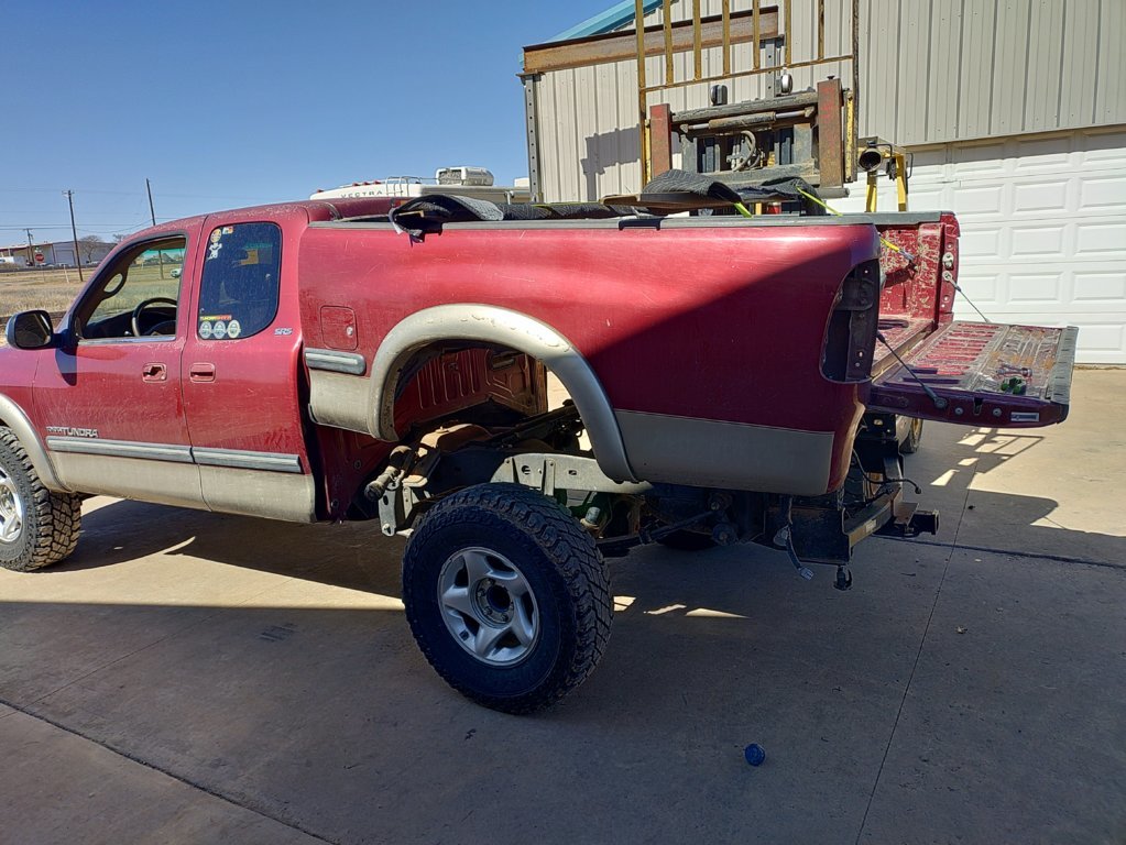

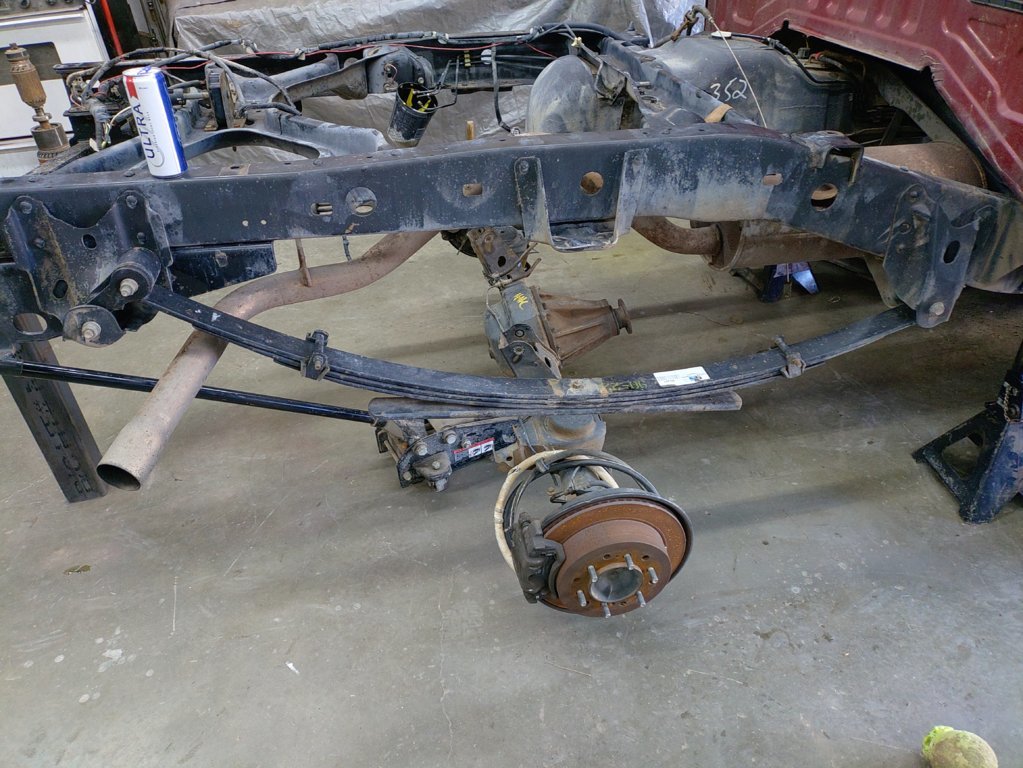

    SUrgery started today with @JakeJake and Dale. Everything went smooth as butter, thanks to Jake. Having done this before and having a shop with a forklift, pressure washer, and air compressor helped a shit load. I think start to finish was maybe 2-2 1/2 hours. I've done what I can; the rest is in Jake's hands. PICTURE TIME!
    Fork that bed!
    Fork that bed again!
    Bed removed. QC checker Dale approves.
    Two tundras tundraing.
    Our QC expert got distracted, probably a squirrel or something.
    A little cleaning.
    QC Dale checking the cleaning.
    Axle out. 30 minute job w/o the bed.
    Sequoia axle in place
    Sequoia axle top view.
