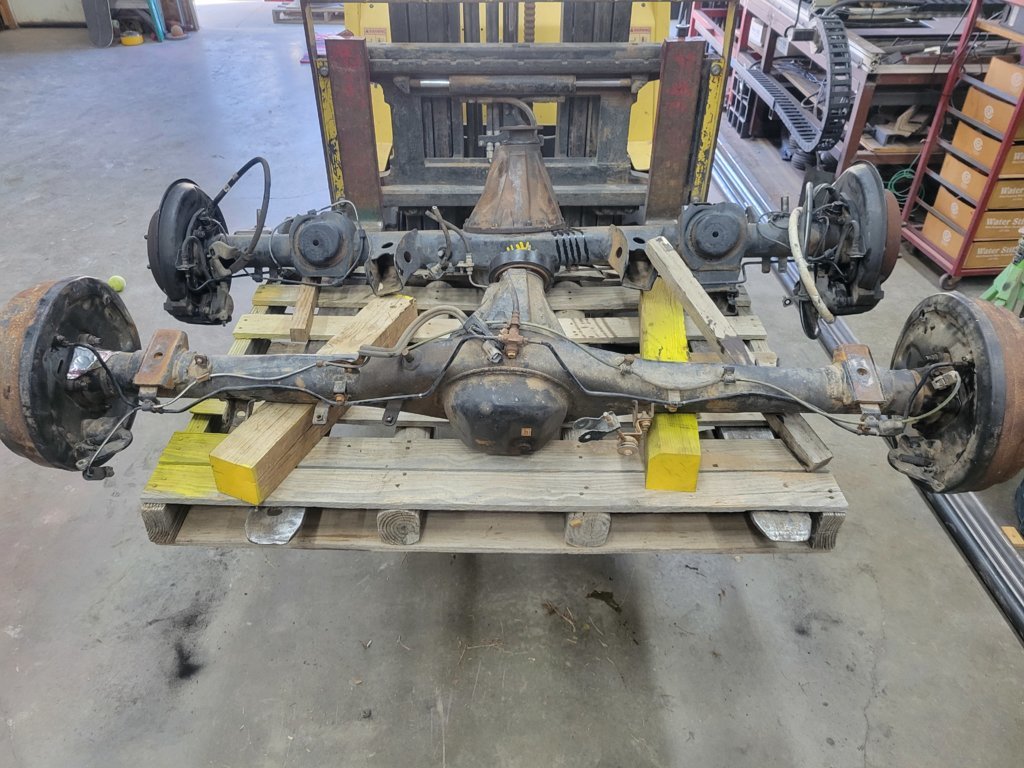

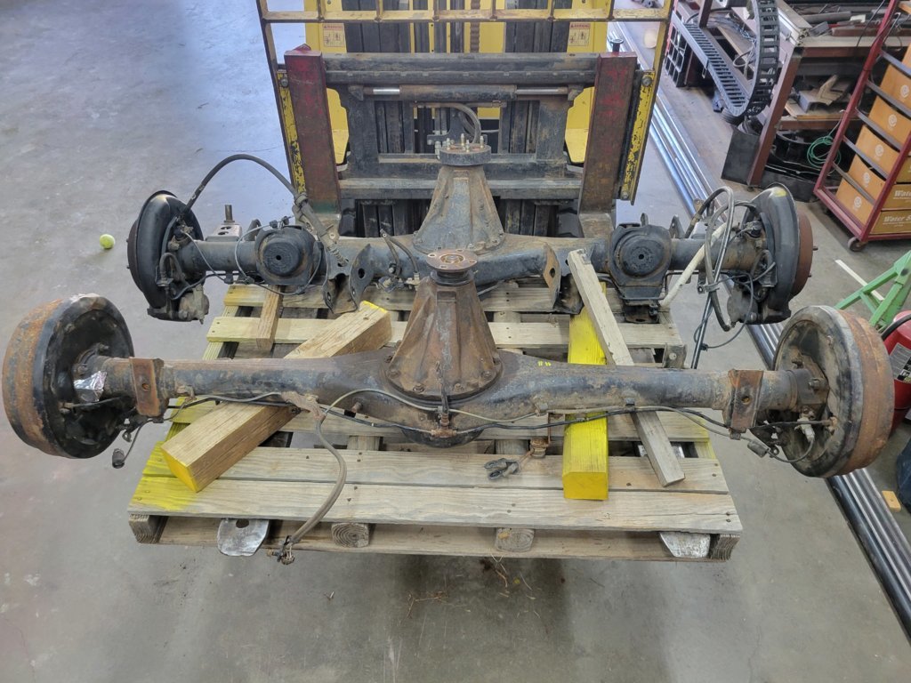

  7. Feb 2, 2025 at 3:54 PM
    #157
    JakeJake
    JakeJake Slippery Snake
    Jul 19, 2023
    #100515
    1,467
    2000 Tundra AC 4X4
    Haters will say its fake :rofl:
    Swapped the diff's just to verify everything was kosher. Can confirm.
    The Sequoia backing plates are way beefier. Housings are identical except for total length and the backing plate mounts.
    The ABS sensor bore is the same size, and the tone rings appear to be identical. ABS may be as easy as swapping over the tundra sensors.

    Wait. Did I read this correctly, that the diff housing is identical between DC/Seq and the AC/RC?
    If yes, what year Seq diff housing is that? I swear I saw pictures showing the axle length is different, and measurements showing the length is different by around 1".
  14. Feb 2, 2025 at 5:46 PM
    #164
    JakeJake
    Jul 19, 2023
    #100515
    1,467
    2000 Tundra AC 4X4
    I'm not sure if we ever looked into what year the donor was, we should probably do that on the next trip.
    I definatly misspoke/typed there. The housings are identical *except for length. :hattip: Going back to edit that now.
    I'll pull all the numbers at some point and compile them here. I didn't want to get in to deep today, just verify that we could re use Beau's diff.

  19. Feb 2, 2025 at 5:58 PM
    #169
    JakeJake
    Jul 19, 2023
    #100515
    1,467
    2000 Tundra AC 4X4
    Just measured them both at 60mm, the Sequoia flange has studs where the Tundra flange has through holes. We will be reusing his existing diff, so none of that is of real concern.
    Now I really want to know what year that Sequoia is. Its either an 02 or 04.

  28. Feb 2, 2025 at 10:04 PM
    #178
    bmf4069
    bmf4069 [OP] Captain wtf
    Sep 1, 2018
    #18880
    9,984
    Beau
    TX
    02 AC sr5 4wd v8
    The sequoia axle is 1.5" wider.
    It was an 02. Well, that's what the windshield said anyways.
    Got a text from memario. I'll order the shocks and prop valve tomorrow. I don't remember if I posted in here, but I ordered new brakes for the sequoia axle.
