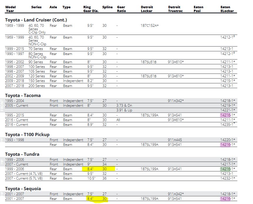

    Not to throw wrenches, but according to rock auto sequoias have 30 spline axles, and tundras have 32 spline axles. I dont know, just dipped my toe into this rabbithole.

    I don't think that's right from what I remember. My Eaton is 30 spline.

    but you have a sequoia sport trac. I didnt check DC’s. I’ll poke around a little more tomorrow when i can write stuff down.

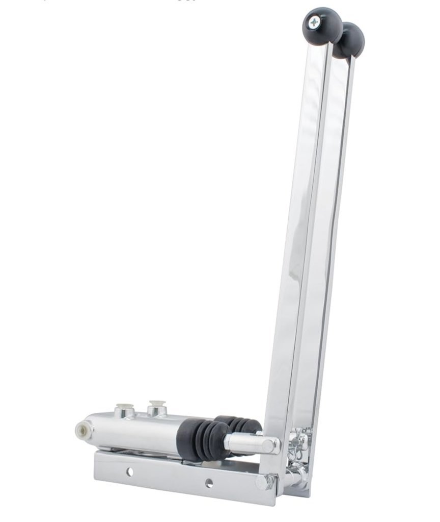

    Add those two masters to the pile of parts to to put up in a sale thread.
    A hydro handbrake would be fucking siiiiick though. Add a line lock and now your calipers are a parking brake instead of the factory setup...

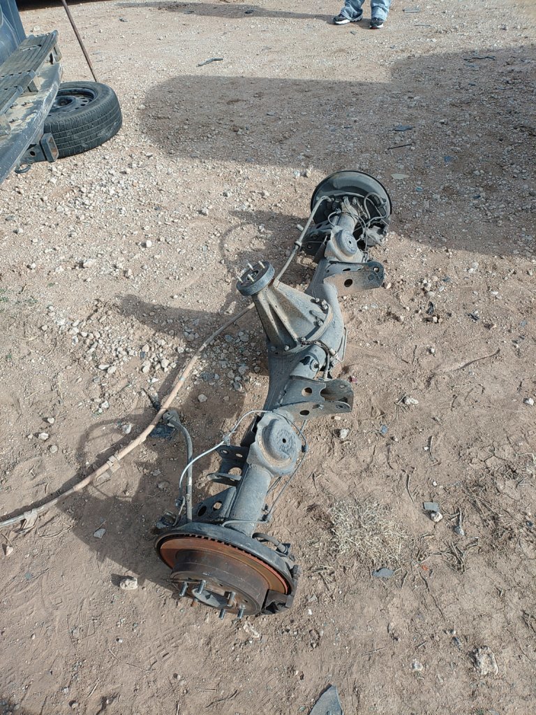

    As far as I saw the 1st gen tundra and the 1st gen sequoia diffs are interchangeable. I'll pull the sequoia diff tomorrow and drop in my spare tundra unit to make sure we don't have any square peg round hole action going on.

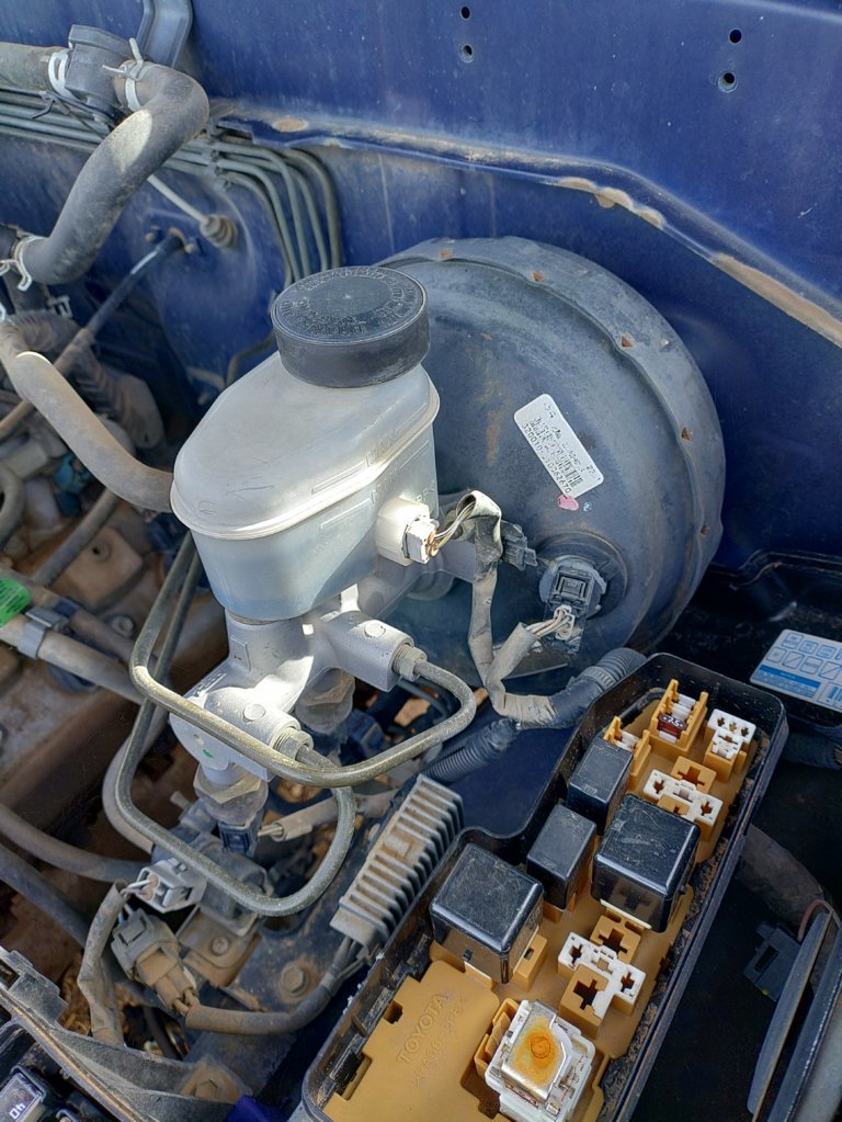

    Yeah I'm going to have to study the brake systems on the abs side. You definitely don't want that pump though, all that extra wiring, different ecu etc. Wishfully thinking that we can fool all the tundra stuff to think nothing has changed in the rear, but that's a bunch of tone ring/sensor values/wiring diagrams that I haven't dug into yet.
    Me? I'd just delete all that mess :rofl:Im up to give it a hard effort to make it work though.

    To be on the safe side, i’d grab both the booster and MC. Plug all the ports that don’t pertain to your tundra. (it’s par for the course to swap out a disc/drum MC for a disc/disc MC when converting over to rear disc brakes). Then install an adjustable prop valve. And no rule that you have to install that valve under the tail end of the truck (if you don’t want to). I have an adjustable prop valve located under the dash on my ford highboy, and an adjustable prop valve located under the hood on my jeep cj7.

    Re: parking brake. @bmf4069 have you ever used yours? :rofl: because I only hit mine when I think about it to keep the rear drums adjusted.
    Fell down the rabbit hole of line locks last night, and I do see a great off-roading use for one.
    An electronic solenoid style would be awesome on trail if you need to get out of the truck in a precarious position. Pump the brakes twice and hit the button to have all four wheels locked up tight. Great for recovery, or just to run around back to get refreshments out of the cooler.
    A manual valve could be used in place of the mechanical parking brake, but there's some room for error there with loss of pressure etc. I wouldn't rely on that say parked on sloped terrain on the street unattended.
    https://www.summitracing.com/parts/tci-861200
    455h0le_dachshund likes this.

    Is that where it meets the diff?
    Keep in mind I've got Sequoia 4.10 gears in mine now
    Sirfive[QUOTED] likes this.

    Yes the axle shafts are splined on the carrier side. I'll snag you a picture today.

    the almighty rockauto was wrong?
    Wait. You have a tru-trac or something. But yea, looks like everything is 30 spline. Even ‘95-‘15 tacos.
