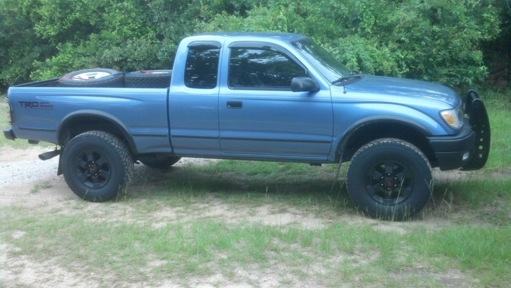

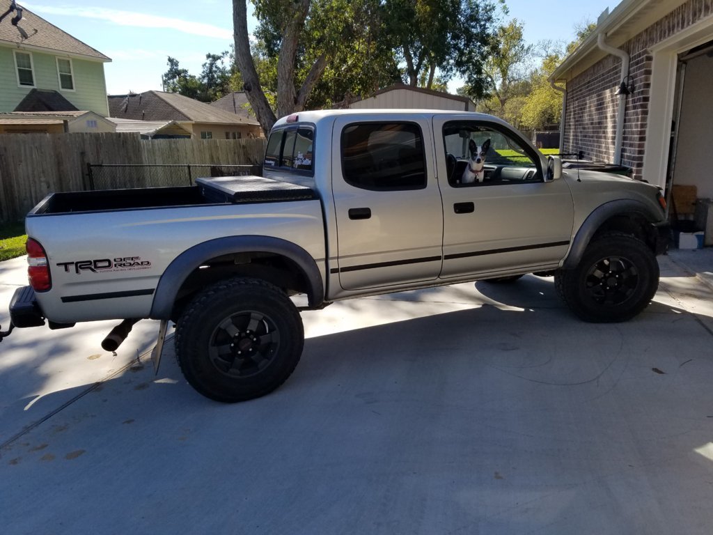

    Trail Teams FTW. I wish I had swapped em from my Taco to the Tundra when I traded it.
    I miss Pearl the 99 XC.
    I don't miss Misti the 03 DC, but I do miss Benni, in the passenger seat.
