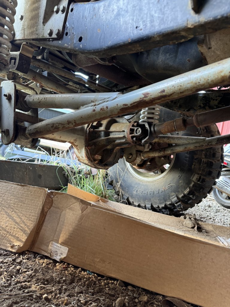

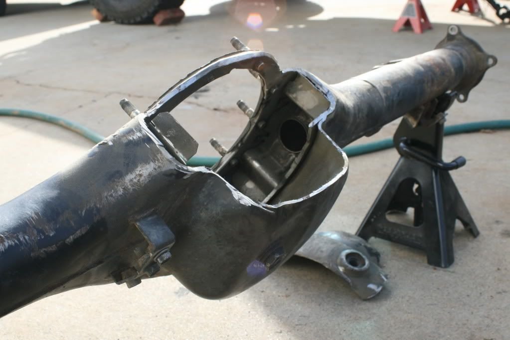

    Just looked at my spare axle for a while. A 3rd member shave would only get you 1" of extra clearance at most.
  6. Jan 24, 2025 at 2:33 PM
    #36
    KNABORES
    KNABORES Sarcasm incoming
    Jan 1, 2020
    #40572
    15,163
    Arkansas
    What can you shave on the axle that creates clearance?

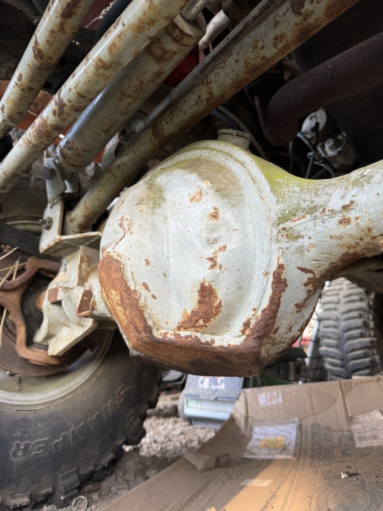

    lots of dents
    I’d say that’s more of a manscaping on the tubes

    shaved pumpkin housing on a Currie high pinion 9” front axle. It’s inexpensive to do, but the labor is fairly involved. IMG_1645.jpg IMG_1646.jpg

    That doesn’t fuck up the oil splashing?
  12. Jan 24, 2025 at 5:36 PM
    #42
    whodatschrome
    whodatschrome New Member
    Sep 13, 2023
    #103882
    1,949
    North of North Plains, Oregon
    lots of dents
    Shaving down the pumpkin has been a long time mod. I haven't ever heard of any oiling issues. Yes, there is a little bit less oil in the axle, but the oil level will still come up to the same height on the ring gear (as it did before a high clearance shave).

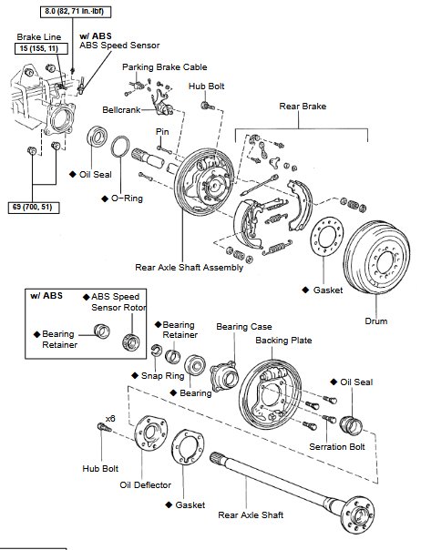

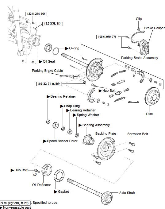

    Dumb questions:
    You say fuck the rear axle seals and rear brakes...
    A disc conversion kit would net you the same Sequoia rear brakes? Or am I missing something..
    Are the axle seals different on a Sequoia?
  17. Jan 25, 2025 at 8:39 AM
    #47
    des2mtn
    Jul 1, 2020
    #48721
    4,733
    Shady Grove
    2004 Black DC Limited 4x4
    Tonto cover
    Wheel bearing is a little bit different on the Sequoia, it's an assembly with the bearing in the case unlike the Tundra, where you have to press the bearing in the case. Still kind of a bitch to do since you'll still need a press, but I think it'll be a little easier to get everything where you need it to be. The annoying inner axle seals will still be the same.
    Sequoia axle shaft/ wheel bearing:
    Tundra axle shaft/ wheel bearing:
    The Sequoia parking brake will be weaker than the Tundras, but it might be much easier to tie into the stock parking brake system. The parking brake in the SOS rear conversion kit is very lack-luster and took a lot of customization for me to get right. I had to switch the calipers where they were in front of the axle to get a better parking brake.

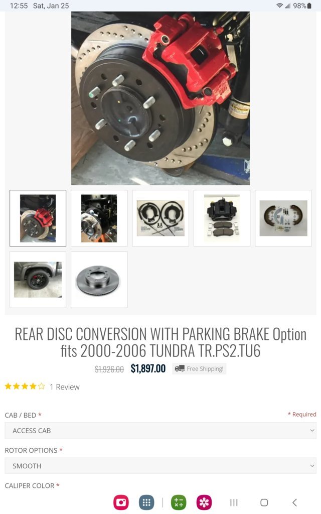

    The SOS kit des mentioned is close to 2k. I'm betting we can come in cheaper than that. Plus, I don't think anybody has done this before. I could be wrong though.
    And yeah, I've done my axle seals 3 times and they still leak. Me and @Sirfive did them perfect last time so it's possible I have a fucked up axle. We adjusted the brakes perfect too and they're still shit. I hate drum brakes.

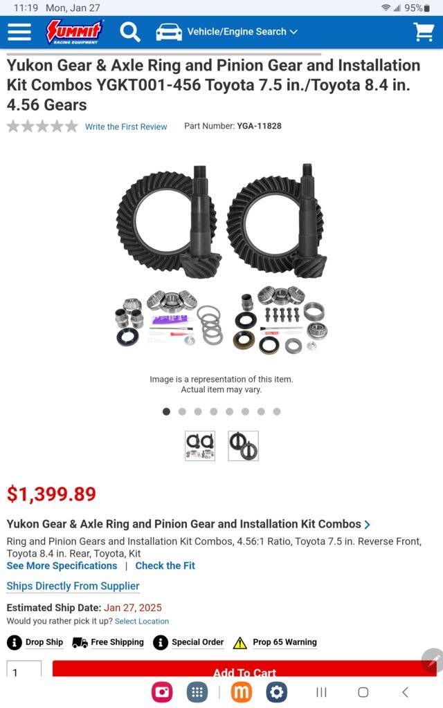

    That sounds good to me. I have no idea who does diff work in town. Also, it's roughly $1400 for f/r LSDs. Plus labor to build and your labor. I may just be regearing for now.
