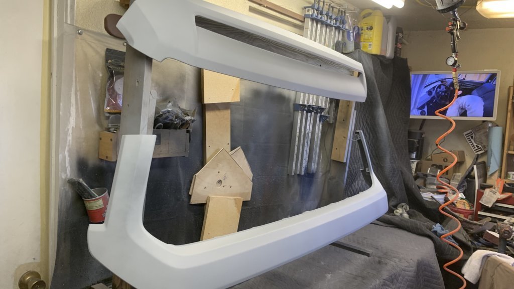

    Still has the sealer coat. I’m gonna do the underside first all the way through, then the fun will begin.

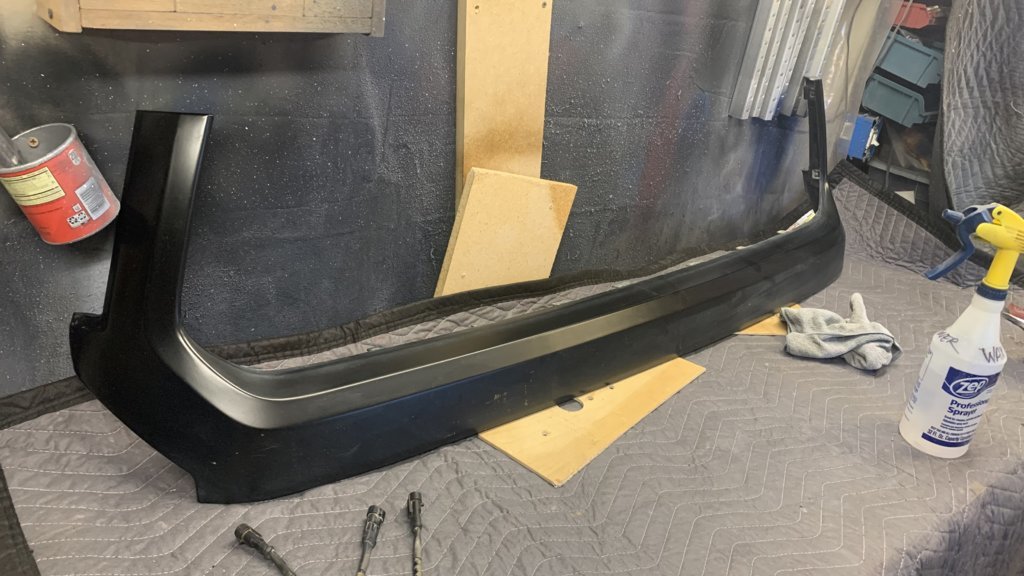

    Underside prepped. What a PIA with all those contours.

    Matte black down……now the fun begins.

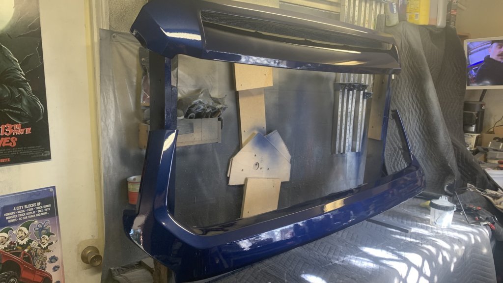

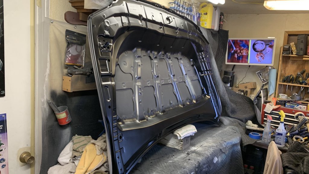

    Geno
    2015 Blue Ribbon 4x4

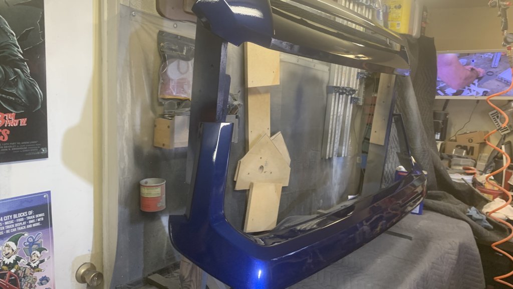

    Well the matte black underside just screamed “replacement primer hood” to me. Why not use what I’ve been practicing and have in the shop anyway? Candy blue pearl over black.

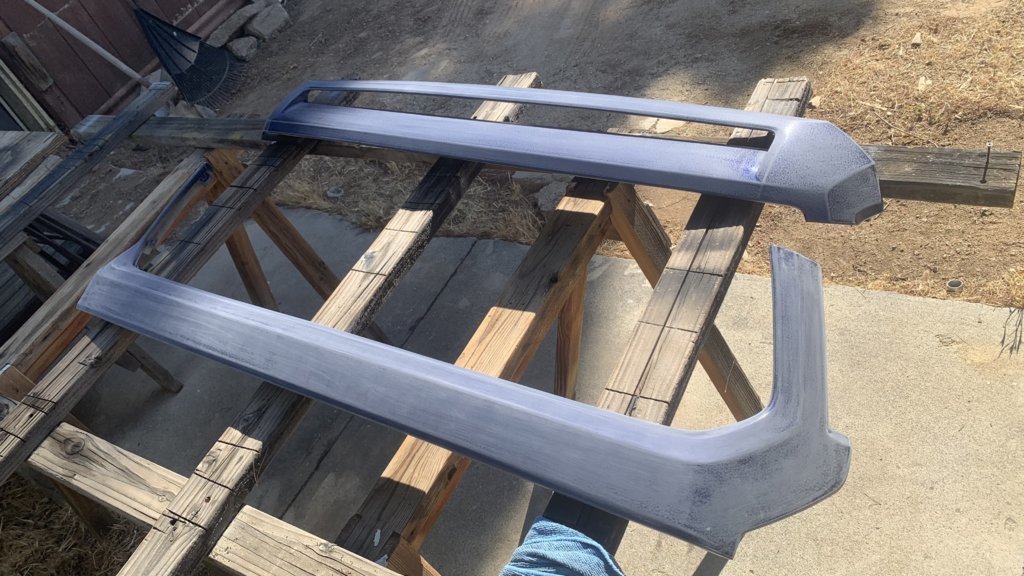

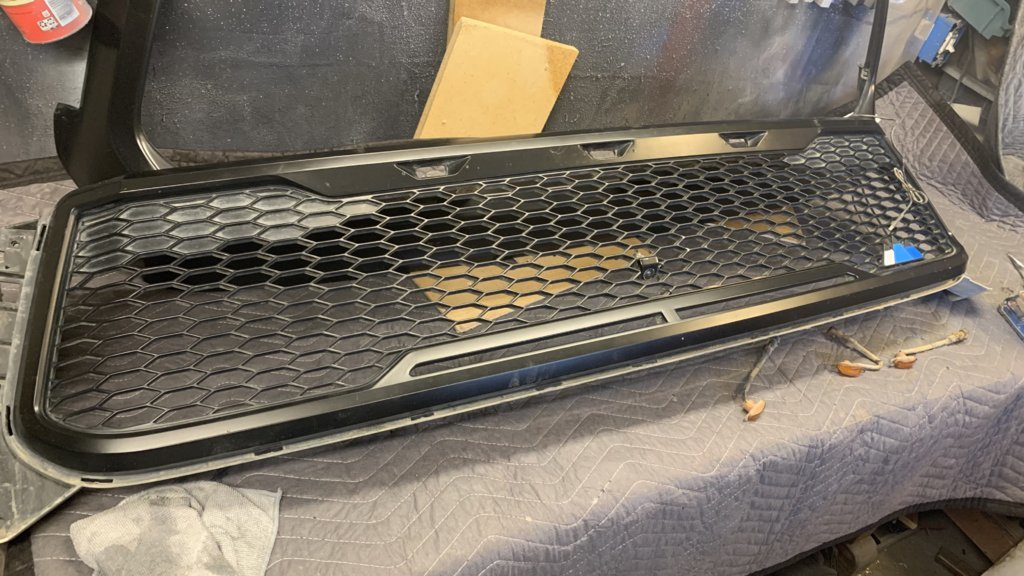

    Geno
    Ok. We’re going for it. Another decision to make though, of course. For the center insert for the grille- I’m thinking of giving it the blue candy over black on just the surround of the mesh. Then leaving the mesh the matte plastic black, but I’m wondering if it looks cleaner to just leave the whole insert matte black.

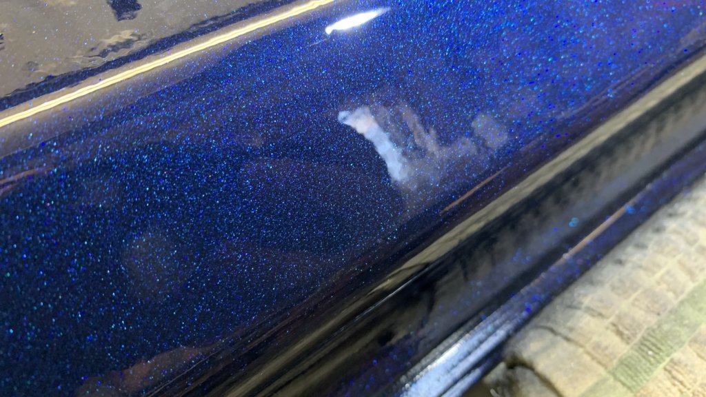

    #18204
    3,515
    Geno
    Welp. You know those full disclosure posts? This is one of them. My clear coat came out hazy/cloudy. A result of too much clear, too fast. And probably the hot temperature played a part. So I get to start over. I’m wet sanding down with 400 and I’ll spray again tomorrow or even Saturday morning. The wife leaves early tomorrow morning, so I may pop up early and get it done. It’s tough to get a picture of the haze. But you can get an idea of it if you zoom in to that pic.

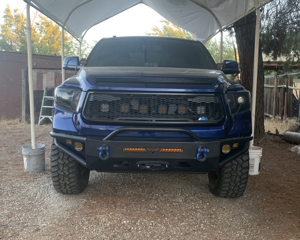

    Geno
    Color matched grille up and runnin. I really like it. The wife loves it. Very happy with this choice.
