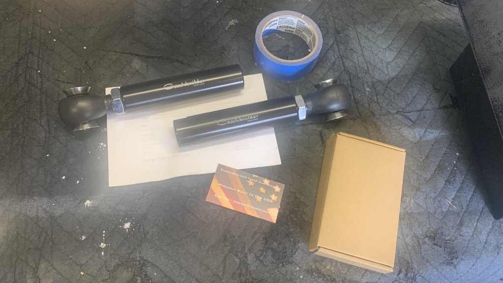

    Coachbuilder tie rod ends arrived and holy beefers. Never realized how big these were.

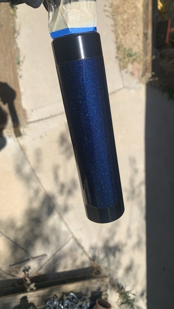

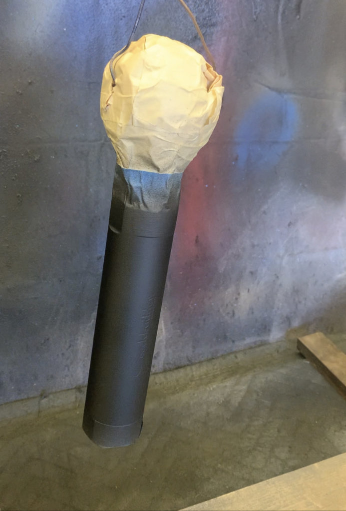

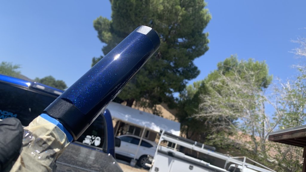

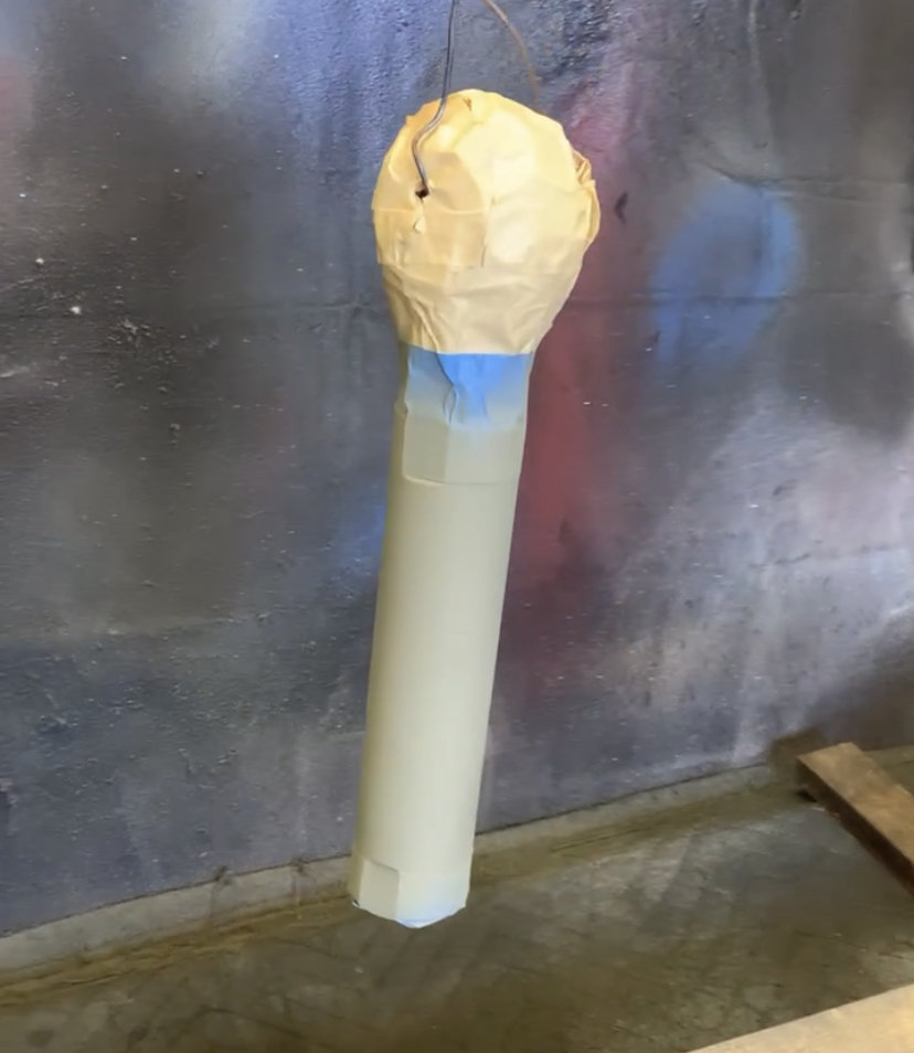

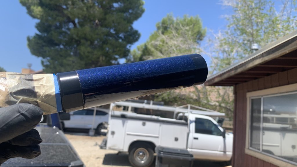

    Blue pearl over black going down today. Taped off the flattened area so a tech’s wrench doesn’t scratch (I’m sure they’ll find a way). Sanded, etching primer, flat black, and Nokon blue pearl clear. Fairly close to Blue Ribbon. Gotta cure then I can rub off the hard line.
    All of the color is mostly visible in the sun, I realize they’re under the truck. But the more I practice this technique, the better. And I think at the right angle and lighting, these will shine like crazy.

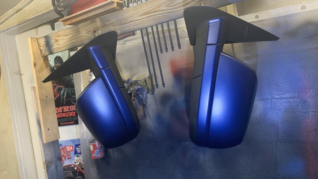

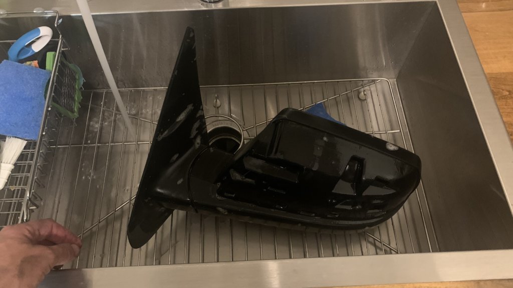

    After the Bulldog adhesion promoter, I had some leftover scratches and texture, so I tried some Upol sandable filler primer. Never used it before, but it really filled a lot after two coats. We’ll see how well it sands tomorrow morning.
    Also, the wife is out of town so that made washing the mirrors easy.

    The black is down and smooth. We’re ready for the candy Nokon blue. The Blue Ribbon will be last.

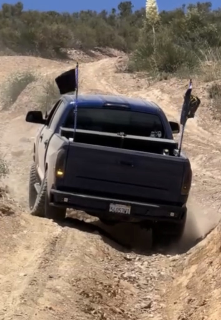

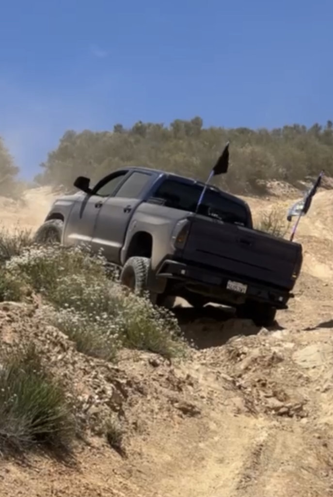

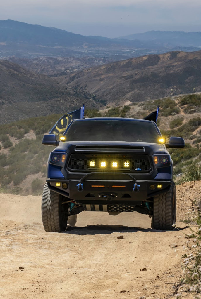

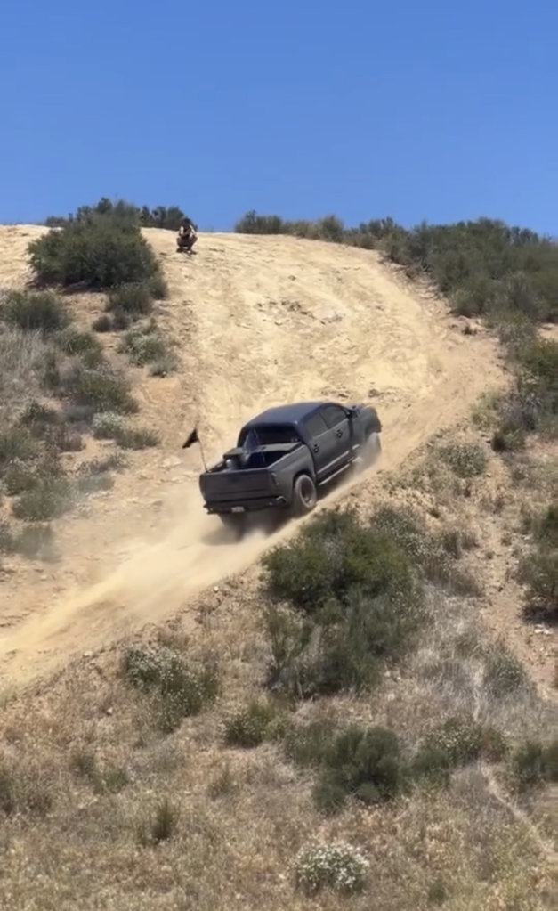

    Had an off-road run with the boys. Steep climbs and descent.
    IMG_3712.jpg BCF38564-D018-4DD7-A94E-097EE7E16034.jpg IMG_3711.jpg IMG_3693.jpg IMG_3689.jpg IMG_3657.jpg IMG_3594.jpg IMG_3606.jpg

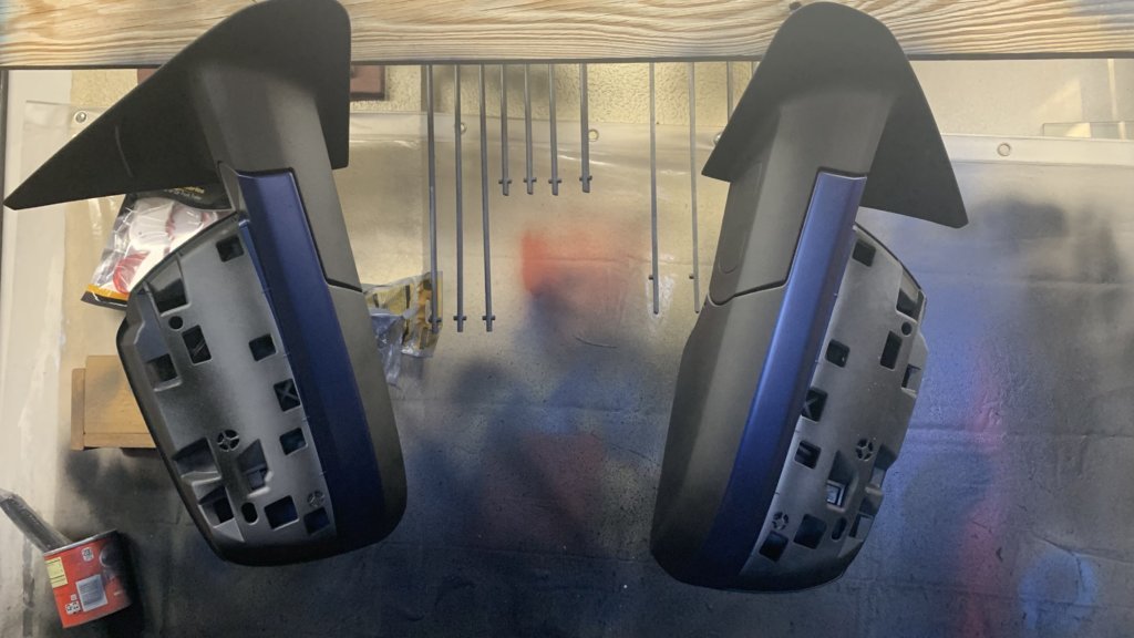

    Geno
    2015 Blue Ribbon 4x4

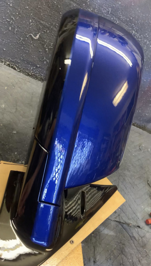

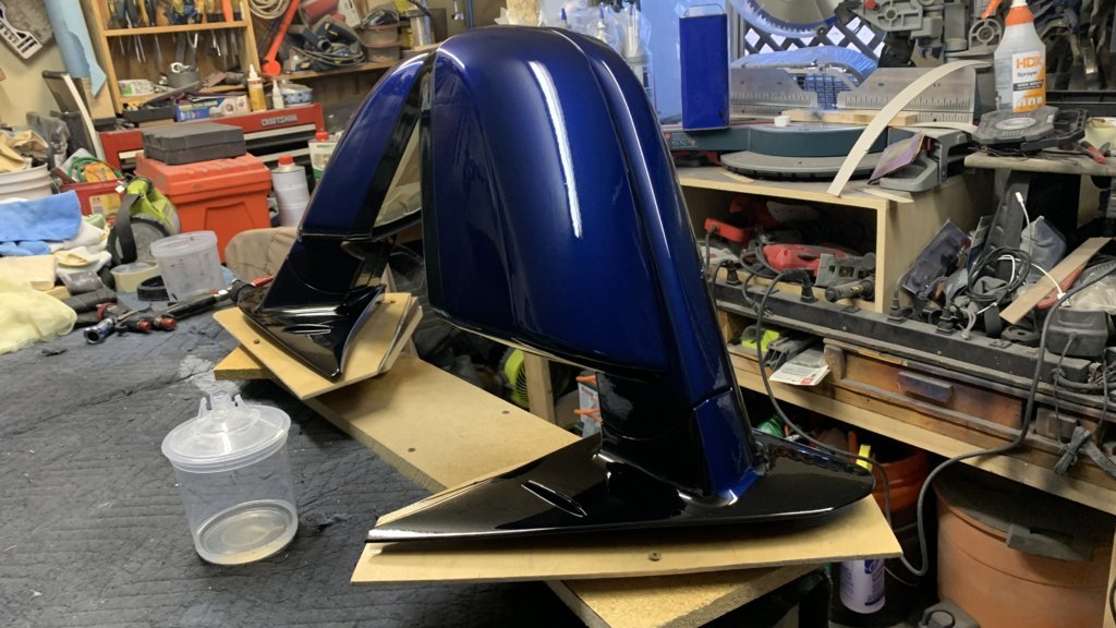

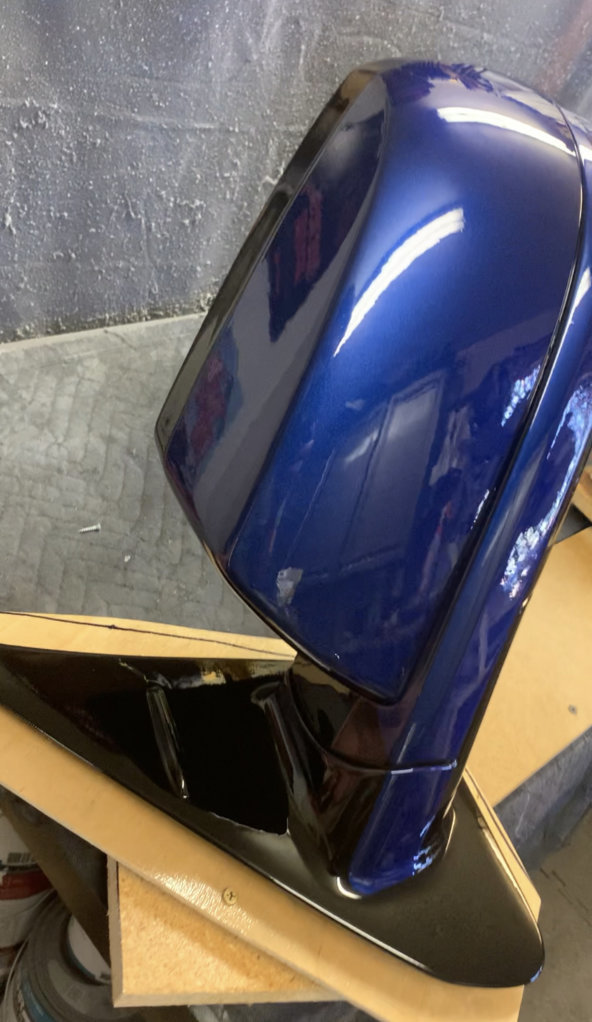

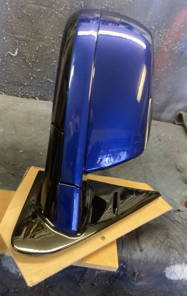

    Now that the mirrors are cured, I decided to flow coat them. Sand the clear coat smooth to get rid of the orange peel. I had a few fogged areas from overspray, so they needed to be smoothed, then recleared.
    Even built a double turntable so they were easier to paint.

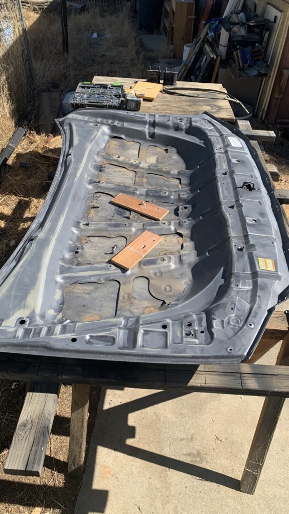

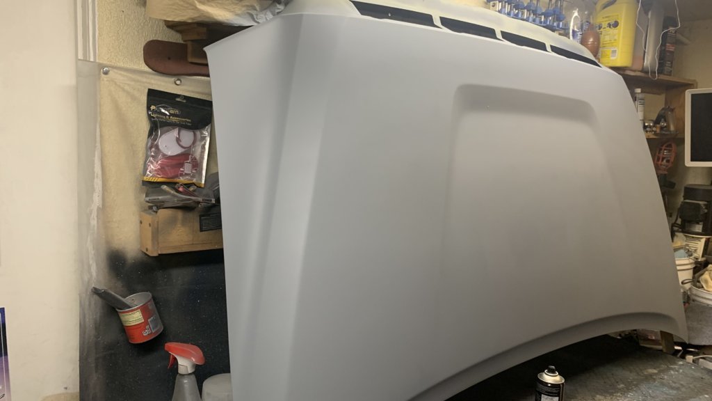

    Started work on the hood. Removed the vinyl wrap, knocked down the reverse dent, and sanded to 220g.
    Working on two different designs for paint. The design would depent on either leaving the grille surround and hood bulge black, or color matching those parts. One hood design would complement the black grille and hood bulge.
    The other design would be mostly blue, complementing the color matched grille surround and hood bulge. I haven’t decided, and it’s driving me nuts. :rofl:
    I made a couple crude examples, we’ll see as we get close to the hood finish.

    Got the bondo in the dent, sanded, self etching primer and high build primer. Sanding tomorrow.
