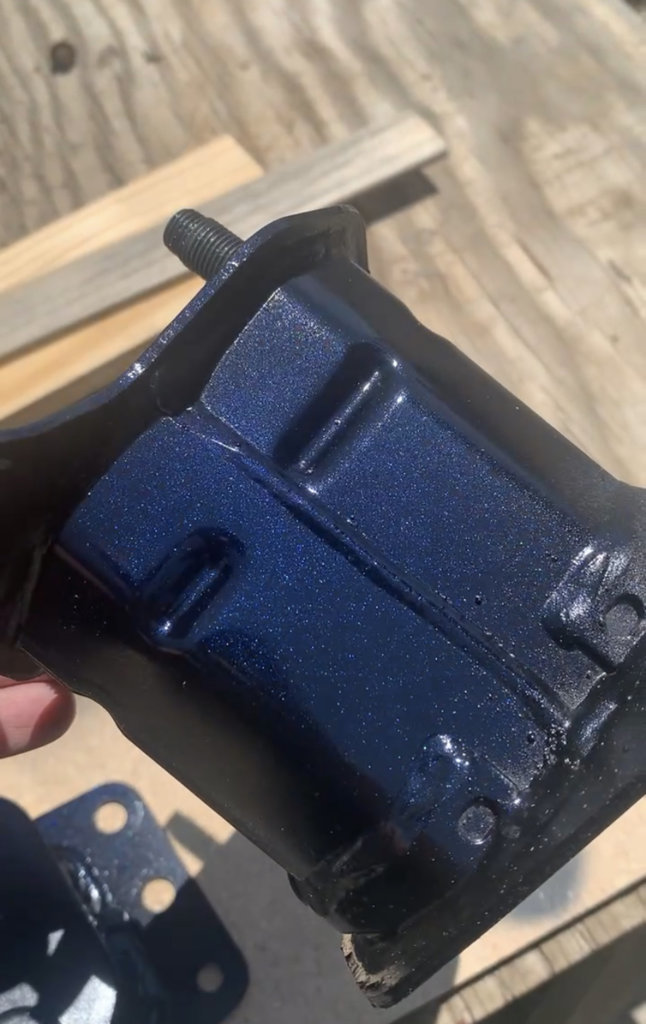

    Getting this pigment stuff down after a new understanding about the stuff. Laying a clear base over black base. The clear is mixed with a small amount of pigment. The desired color is achieved by multiple coats. With this project, I’ll be doing one coat with pigment.
    The first project will be the mirrors and a two tone paint
    1st coat of clear intercoat mixed with pigment.
    Two coats
    Three coats.

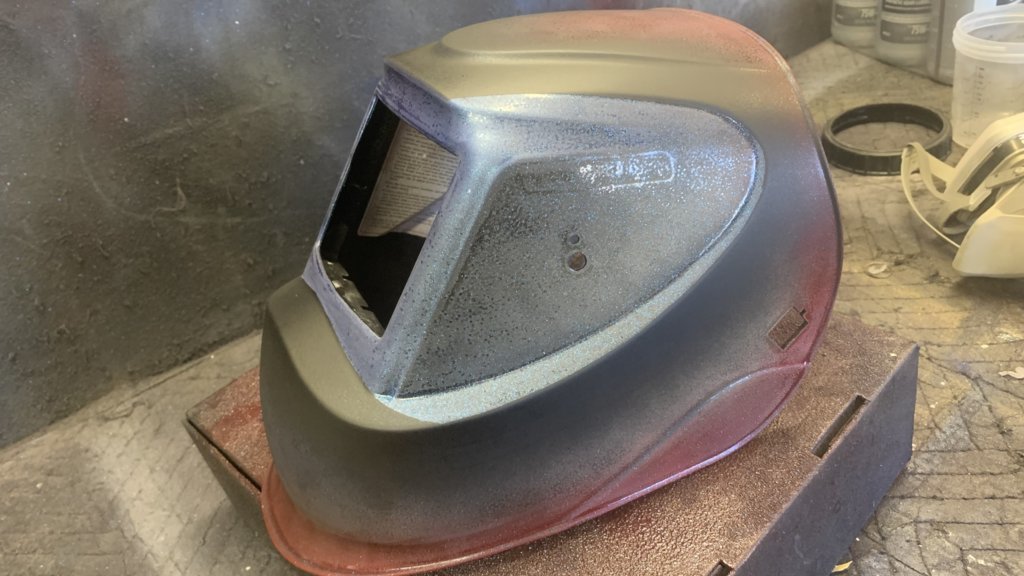

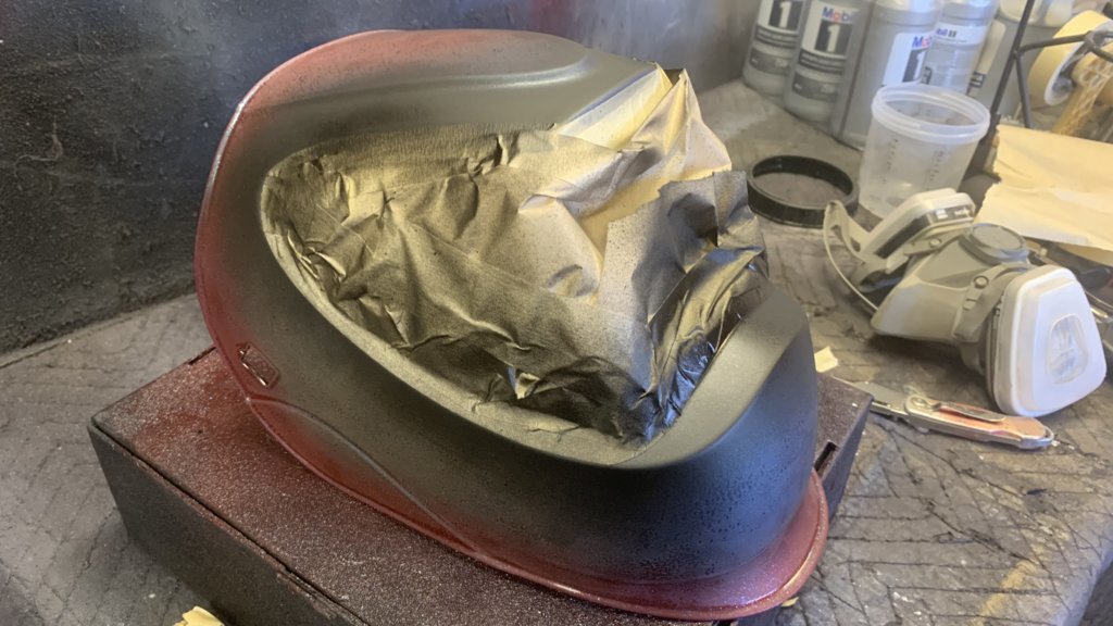

    Masking and practicing the hard line to black fade. Next up is one coat metallic blue pearl, then clear.

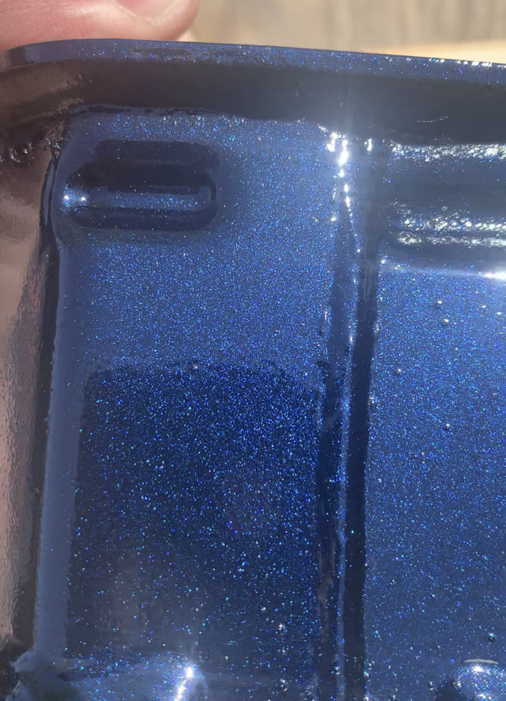

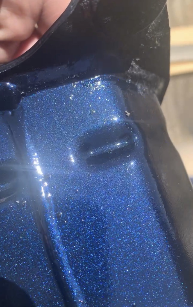

    Practicing, practicing…

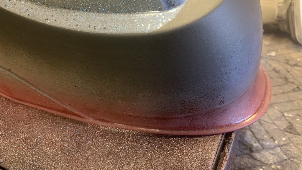

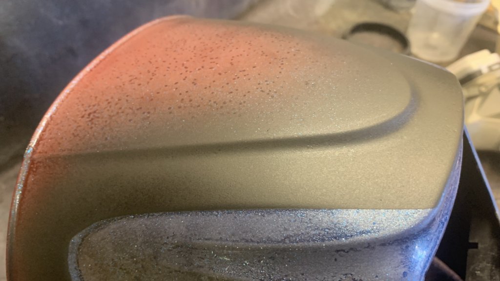

    I think I went a little too much on the pigment. That cheek transition should be more black- like the top of the head. It’s so easy to put too much. I need to triple check with a paint light every coat to get what I’m going for.
  9. May 20, 2025 at 5:09 PM
    #1479
    RobertD
    May 18, 2020
    #46765
    5,117
    Robert
    DFW, Texas
    Oooh!!!!
    The top and chin look really good. That one cheek does look a little off. But again, this is why you were practicing.
    Just incredible! Enjoy watching the things you do.

    Thanks Robert! I seriously appreciate the compliments and criticism! Really trying to smooth out the transition so it’s not so blotchy.

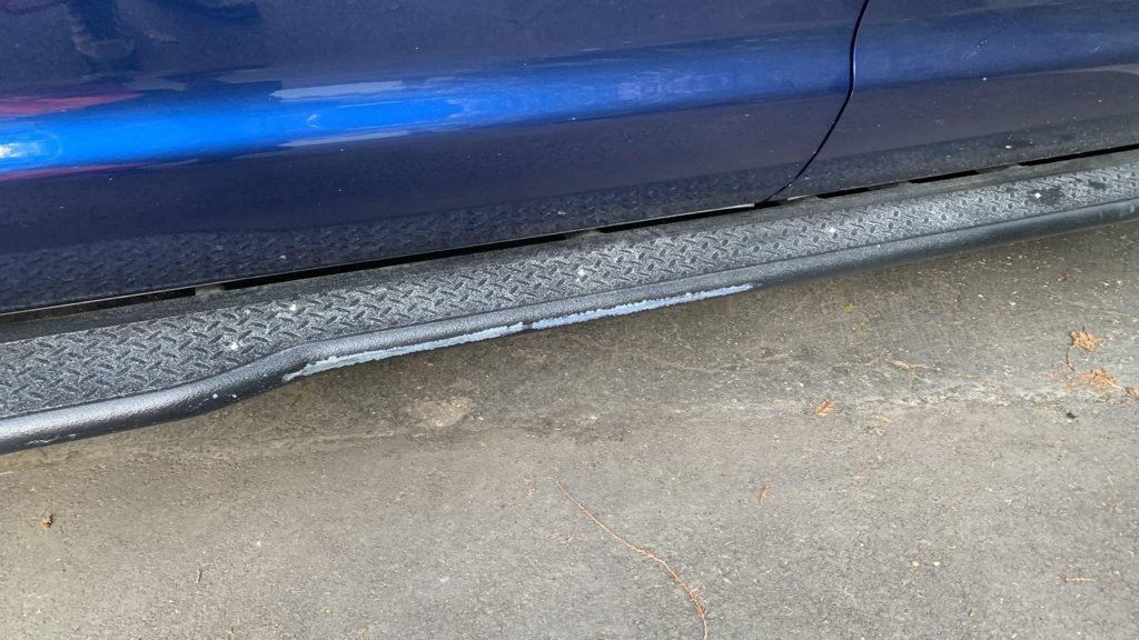

    Holy hell, White Knuckle slider to the rescue. I parked at a parking spot that was tight to a post. Forgot all about it and pulled out right against it, slider took 100% of the damage.

    Glad the truck is okay. Props to the sliders :muscleflexing:

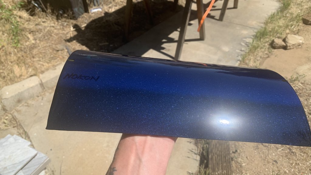

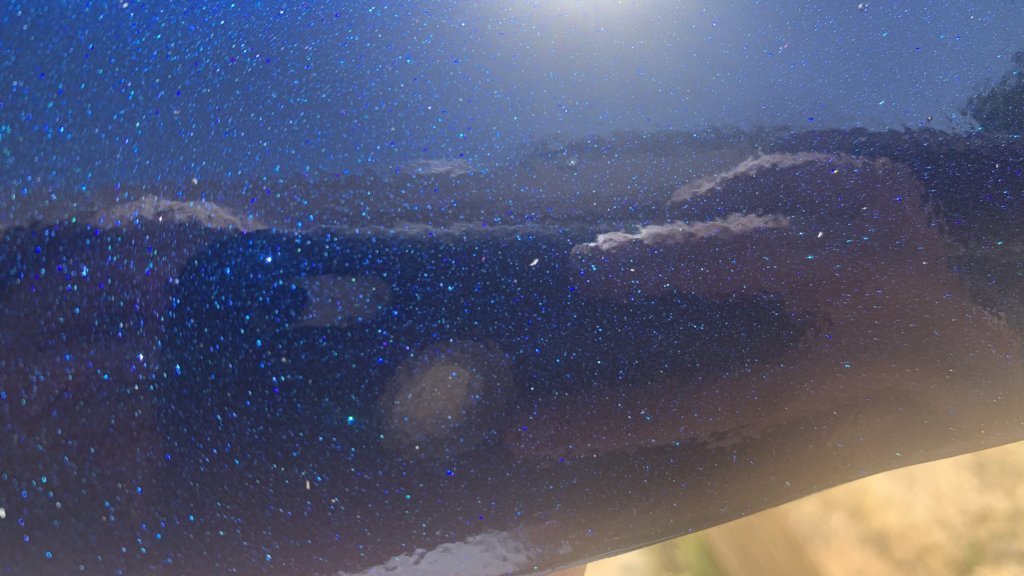

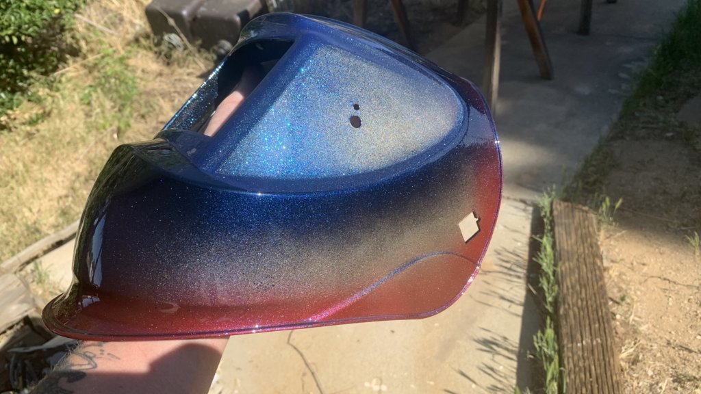

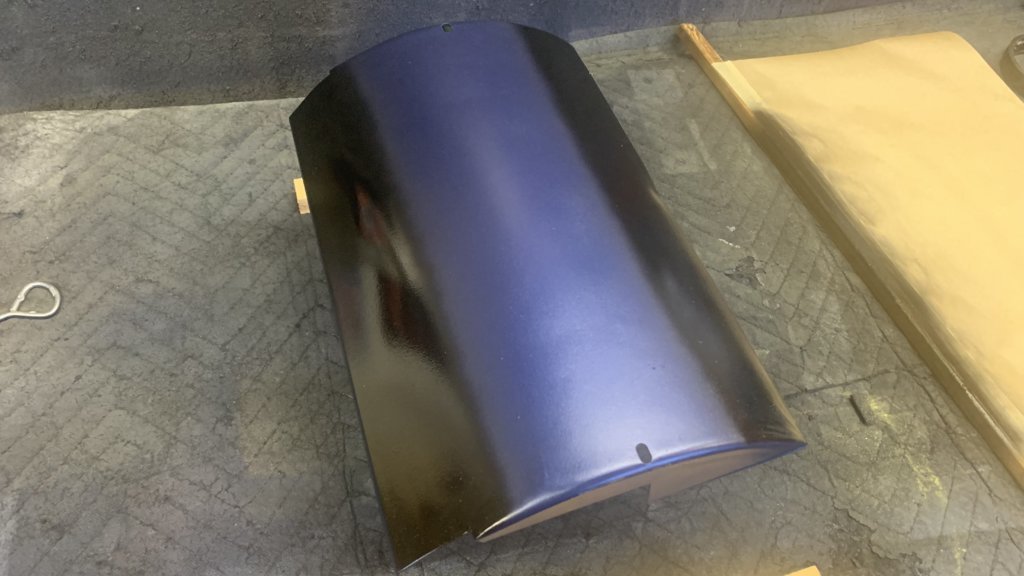

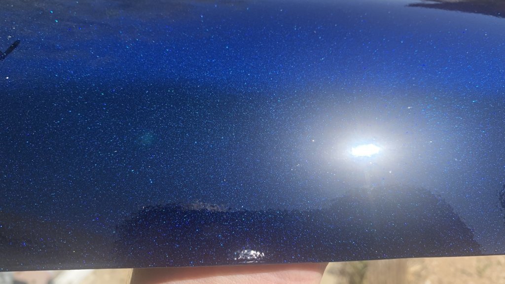

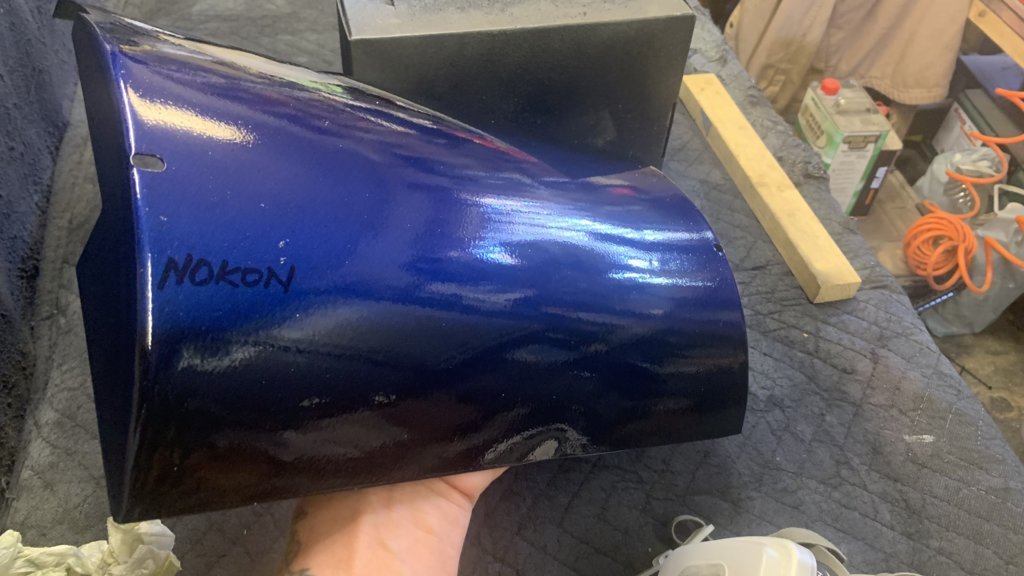

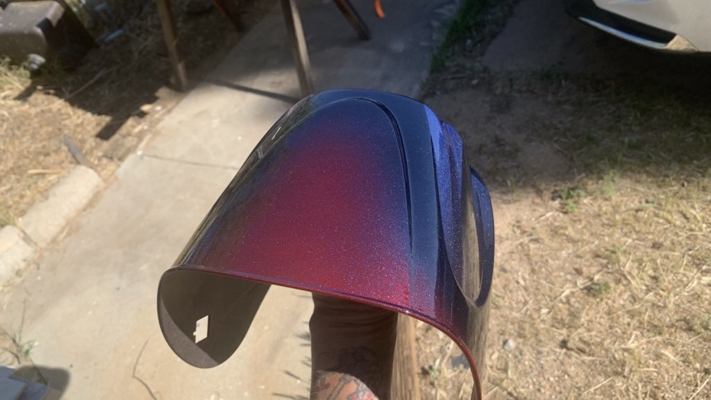

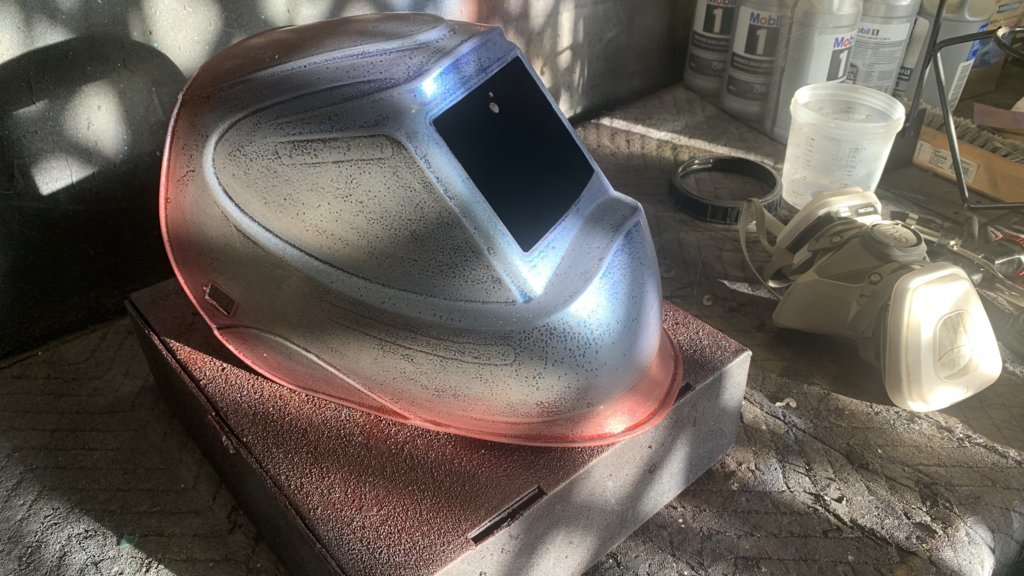

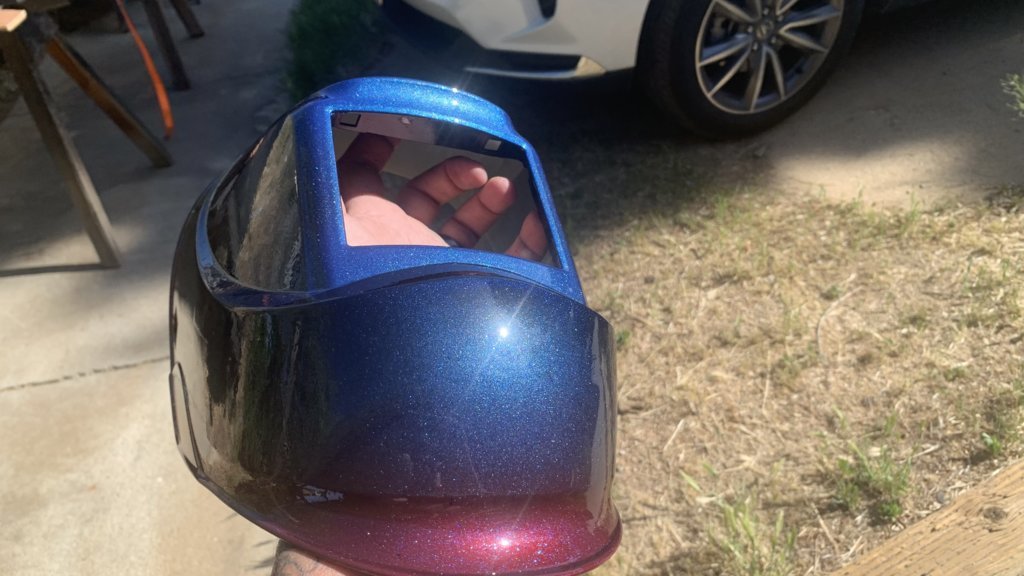

    Paint. Again.

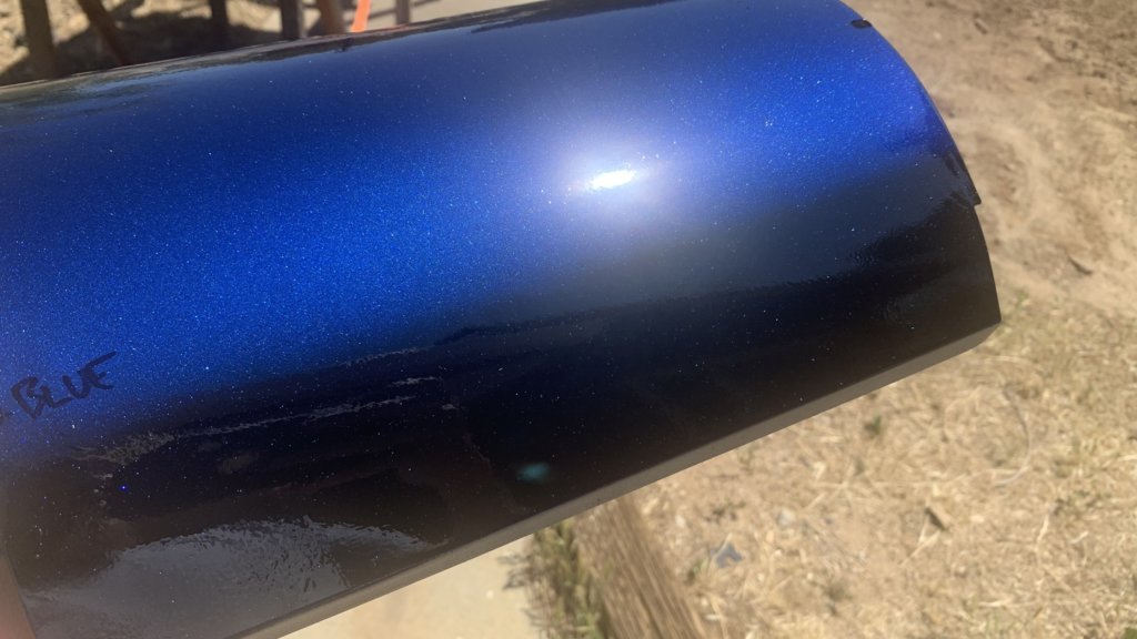

    Got two different blue pearls to try to match the Blue Ribbon.

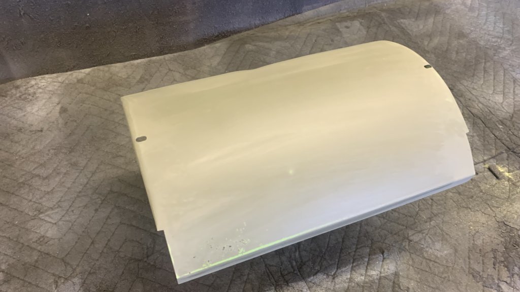

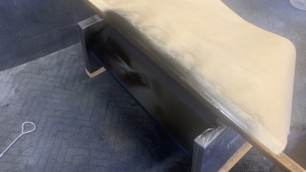

    I had an old planer shield I painted to get a good view on something contoured. Starting with a base coat of Blue Ribbon, I suspended a plank across the surface about an inch. This gave me a much more uniform blend once I sprayed the black on top.
    Each side got a light coat of opposing blues, then a full coat of clear.
    The result is extremely close to what I want. The Blue Ribbon blends to black evenly, and the blue pearl only shows through in the bright sun. It’s hard as hell to show in pictures.

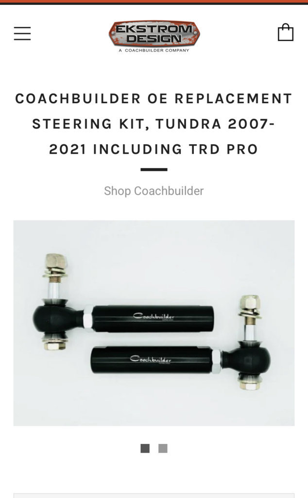

    My steering feels a little loose. Took it to a mechanic and got confirmation that the outer tie rods have lots of play, so ordered the coachbuilder outer tie rod kit.

    Paint them blue once received?
