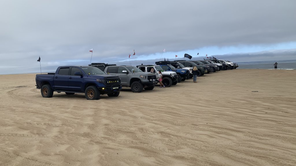

    Had a blast in Pismo! The Kings performed amazingly, I was smiling the whole time. Weather was pretty nice, and brought the pup for some beach fun.
    Got her home to wash all the salt off and hit her with some Turtle Wax Wax and Dry. And found a bottle of P&S Beadmaker. Man I forgot how that stuff makes the truck shine!

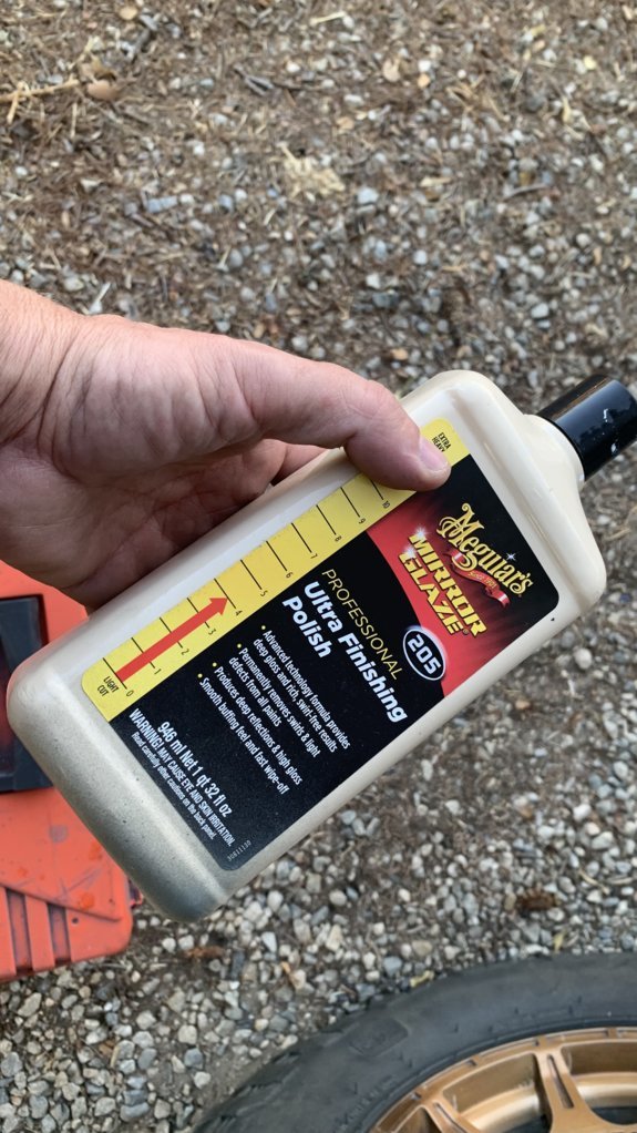

    Cut & buff on the headlights. I had some orange peel from my last coat of clear. Used 2500 grit wet sand, maybe could have gone a little heavier, but I was afraid of burning through the clear. Then polished with a DA polisher and Meguiars finishing polish.

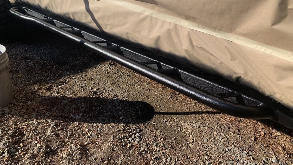

    Getting started on refinishing these sliders. O want the tubes black this time to match the front/rear bumpers. I only have black Raptor liner so that will be the tread as well. They are super faded and beat up underneath. IMG_1662.jpgIMG_1656.jpgIMG_1663.jpg
  17. Nov 2, 2024 at 3:29 PM
    #1367
    BlueRibbon4x4
    BlueRibbon4x4 [OP] Let’s color match it
    Aug 16, 2018
    #18204
    3,399
    Geno
    2015 Blue Ribbon 4x4
    Treads sanded and touched up with self etching primer. Sprayed three coats Raptor liner.
    Think I’ll go with satin black for the tubes. Easy to touch up when damaged again.

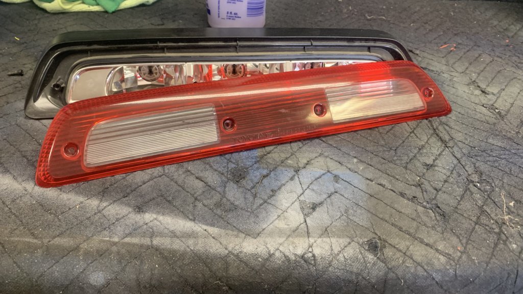

    What third brake light is that
  21. Nov 2, 2024 at 10:27 PM
    #1371
    BlueRibbon4x4
    Aug 16, 2018
    #18204
    3,399
    Geno
    I honestly don’t know. It’s new, I know that. I was going to make my own out of fiberglass. I found the picture on Instagram, and didn’t make note of the manufacturer.

    Slider tubes finished. Gonna let them dry and possibly reinstall the treads today.
  23. Nov 3, 2024 at 8:36 AM
    #1373
    33,533
    18" TRD Off Road Wheels
    Looking nice, Geno! Double check the joints/corners. When I got mine coated there were some thin spots around there.

    Yep, thanks!! Totally went heavier on the tips and inside corners. They were light in those areas from my first finish.
    Also, I really like the black. The appearance is more sleek. I guess more isn’t better sometimes when it comes to color match. SOMETIMES :rofl:

    Sliders finished. I wanted to get the treads back on before the liner fully cured, so hopefully it wouldn’t crack or flake under the heads of the bolts when tightened. I made sure to tighten from below as to not rotate the bolts and twist the liner. I really dig the black, it will be so much easier to touch up after damage now.
