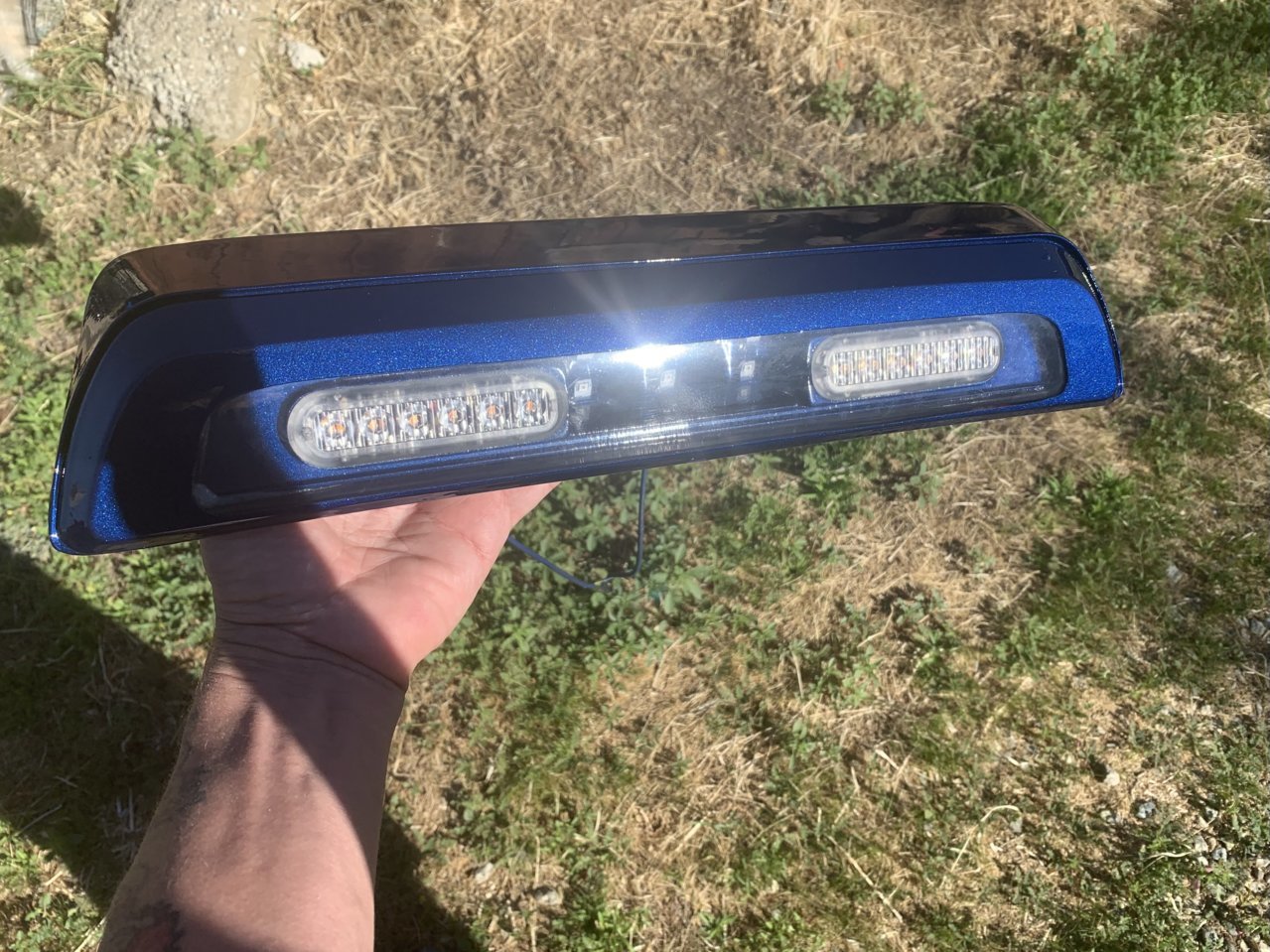

    Got her in and hooked up! Day shots tomorrow.

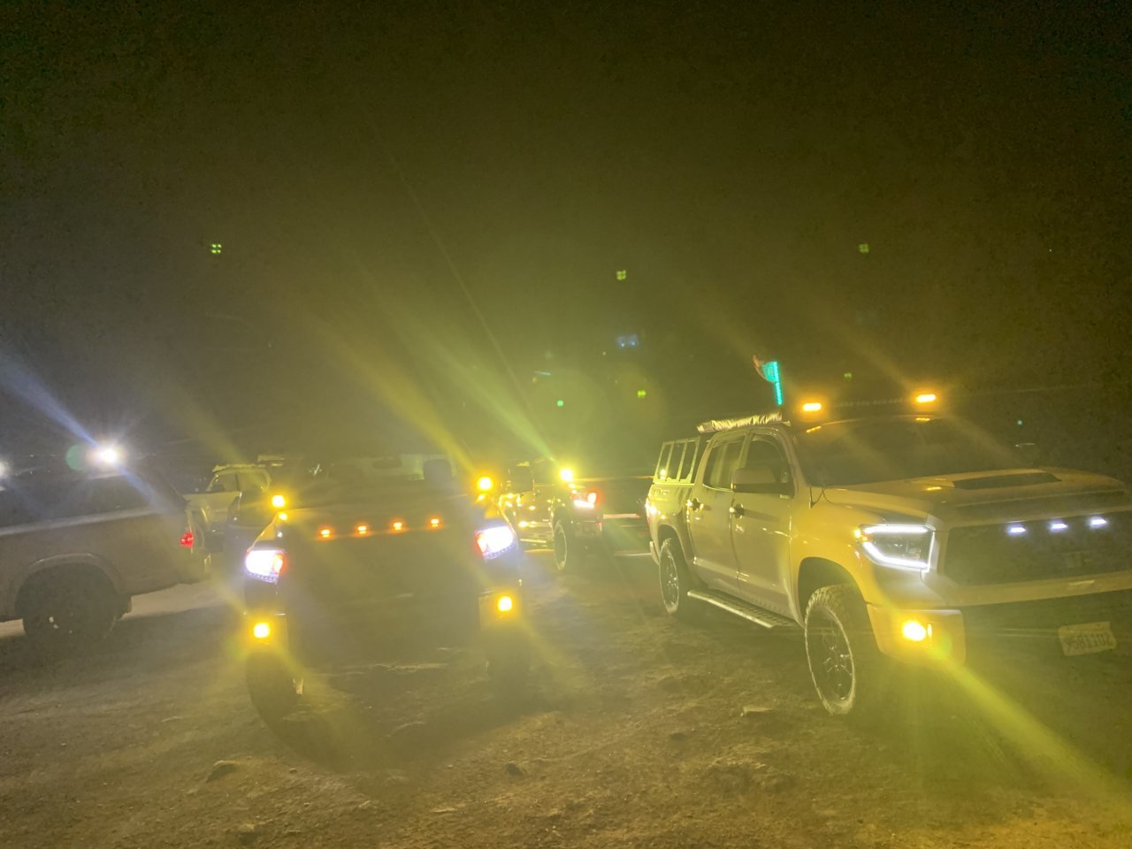

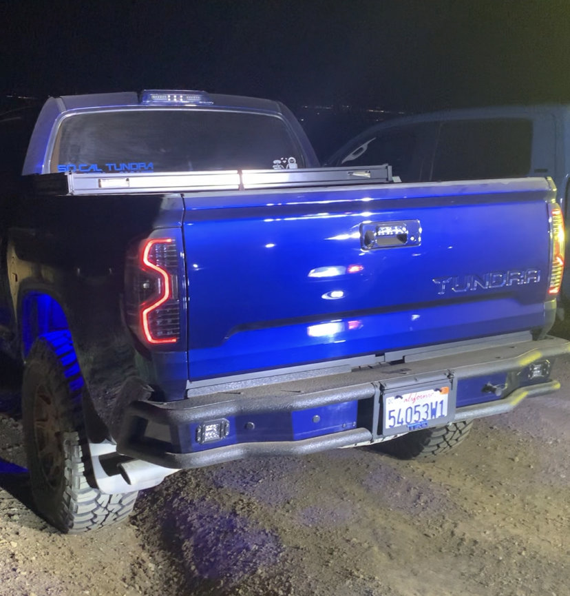

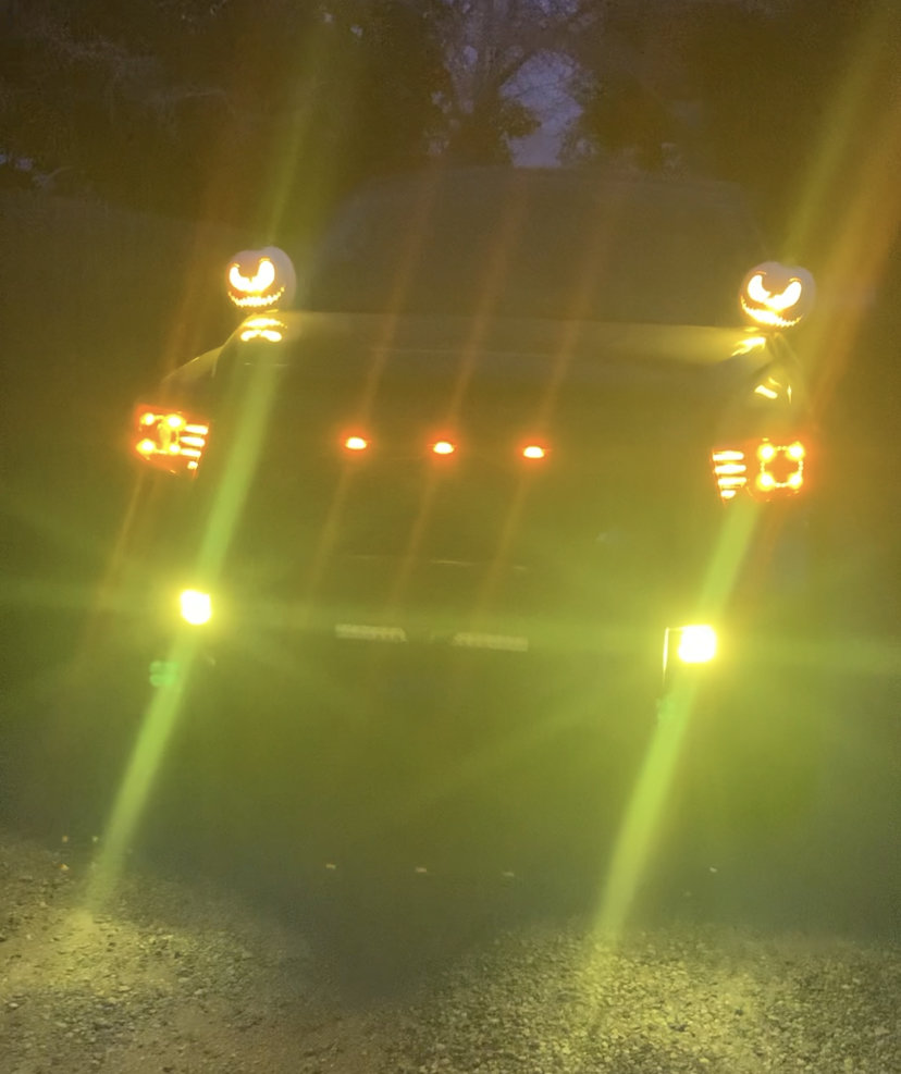

    Went on a night run with the boys last night. Just digging on the blue bumper, which is usually hard to see the vibrant color.

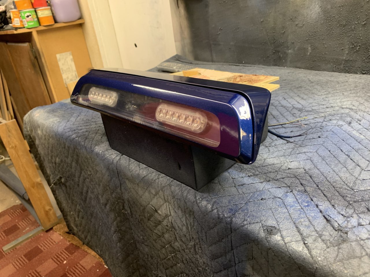

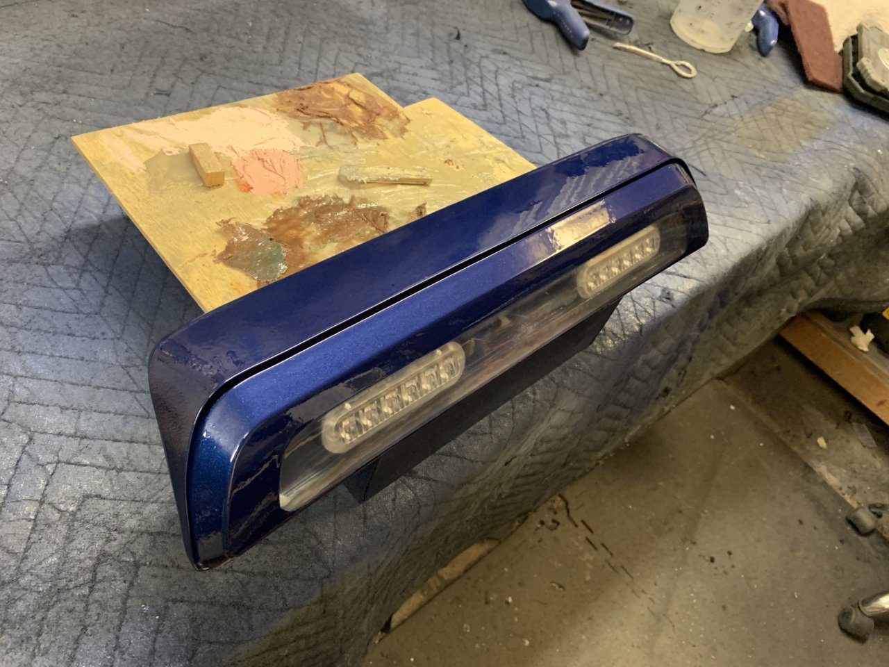

  11. Sep 23, 2023 at 5:02 PM
    #1121
    BlueRibbon4x4
    BlueRibbon4x4 [OP] Let’s color match it
    Aug 16, 2018
    #18204
    3,479
    Geno
    2015 Blue Ribbon 4x4
    @RobertD reminded me that I had these. Cleaned them up a bit and they still kick ass.IMG_9065.jpgIMG_9063.pngIMG_9062.jpgIMG_9064.jpg

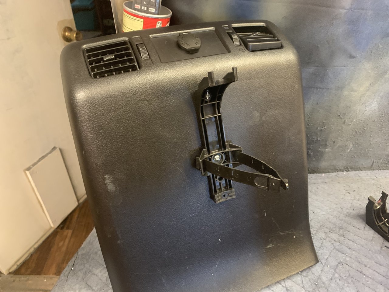

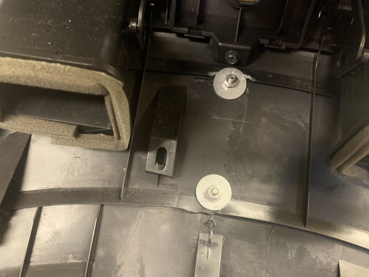

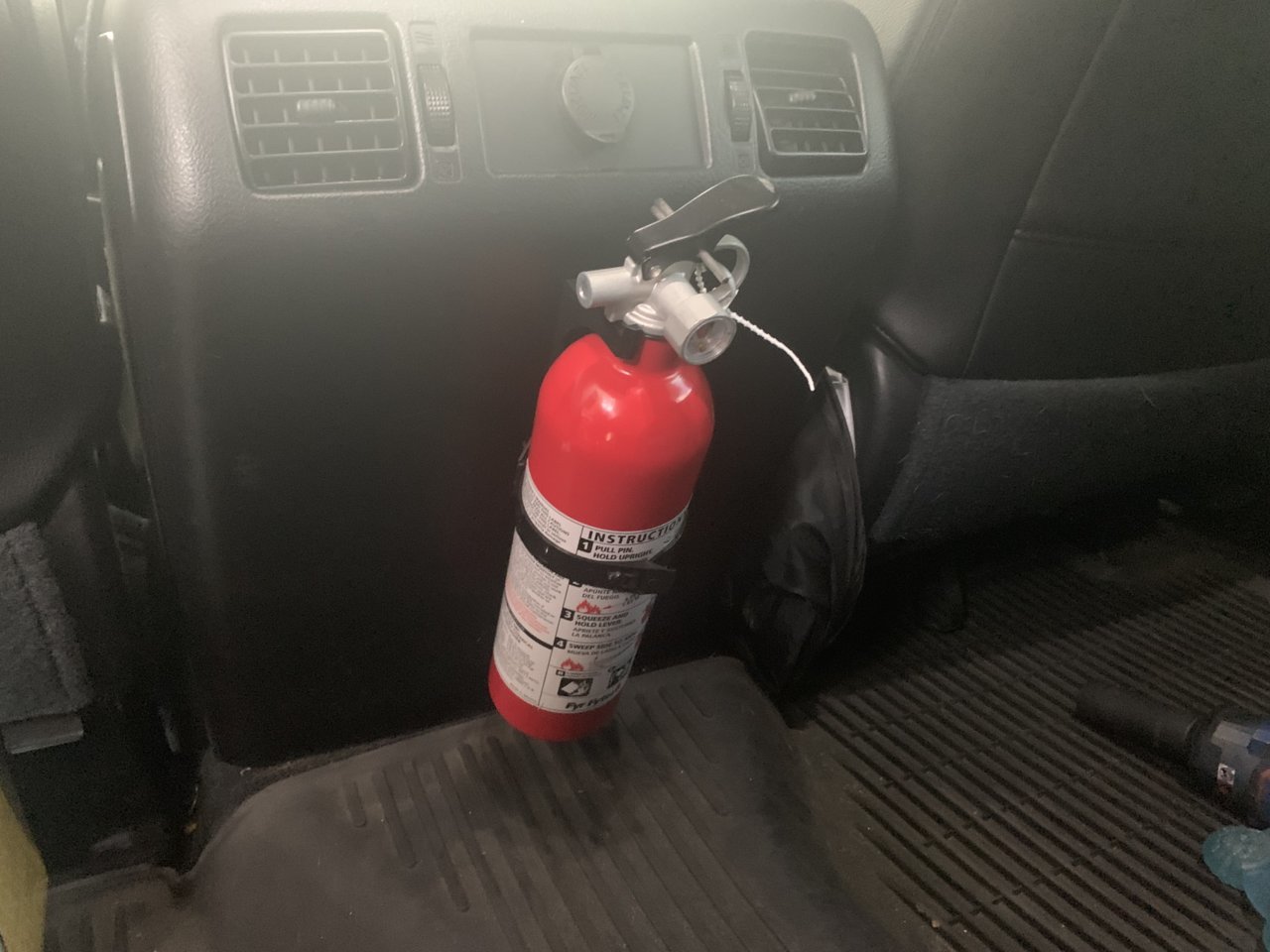

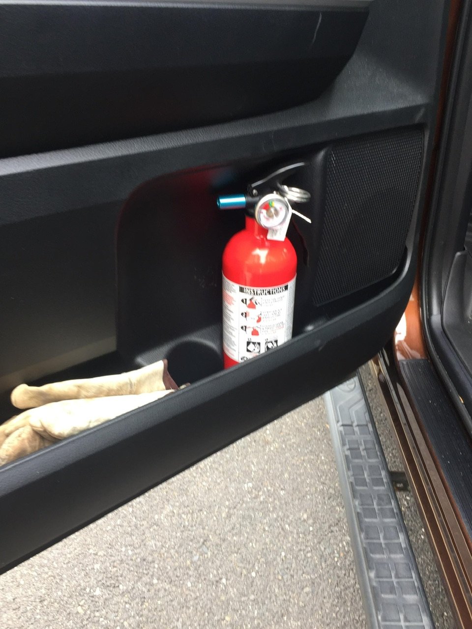

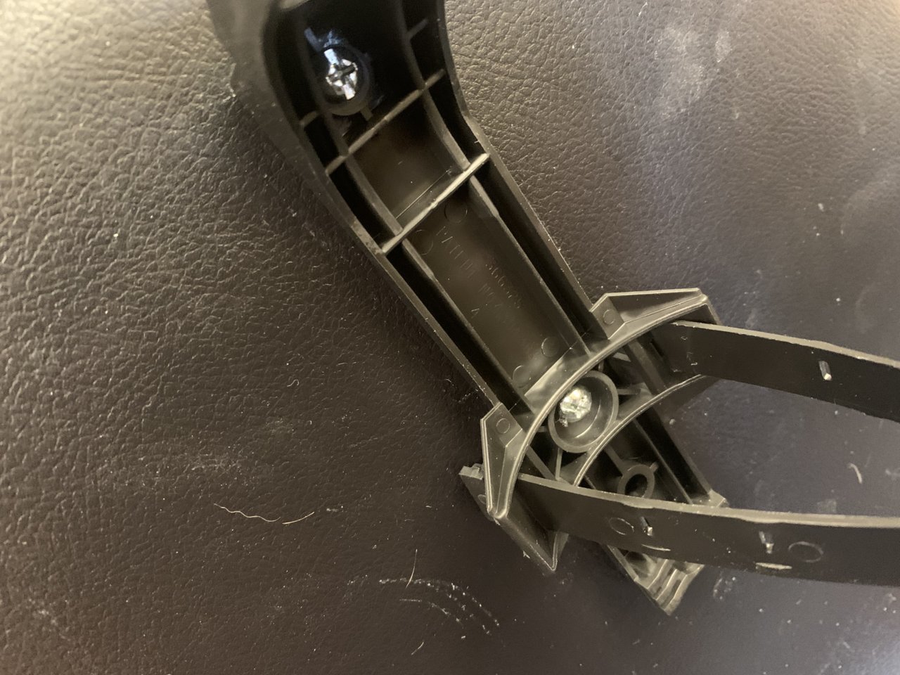

    Had to replace the fire extinguisher that someone took off with during an off-road trip. I had the new one in the truck, finally getting to installing it. The new mount had different hole placement, and the old mount was slightly different to hold the new extinguisher (of course).

    You know that size extinguisher fits in the rear door cupholders.
    I keep one on each side.
    Just a thought…
  15. Oct 8, 2023 at 1:44 PM
    #1125
    33,919
    18" TRD Off Road Wheels
    Well that's damn handy info. I'll have to look at the back doors in the Taco to see if it has a similar bottle holder.
  16. Oct 8, 2023 at 1:54 PM
    #1126
    biebs96
    Jul 30, 2019
    #33915
    3,346
    PA
    unless the door panels are different from a 17 Tacoma they should fit. My brother in law has them in the rear doors of his Tacoma (2017 DC).

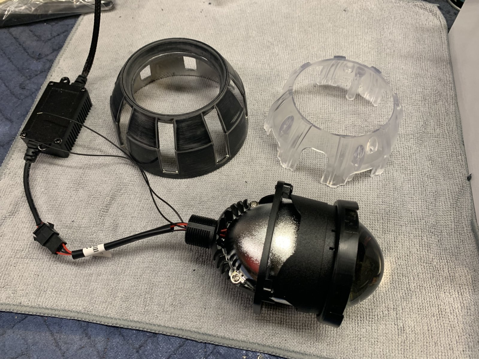

    So I ordered 3” projectors for the headlights. They’re too big. They’re going to hit the inside of the lens. Mostly because the LED driver is mounted on the butt of the projector, pushing it forward. I thought I could figure a way to sink them deeper in the reflector bowl, but it’s just going to complicate the install and interfere with the boot to cover the wiring. a 2-1/2” BiLed has been ordered, and I’ll keep the Bullet shrouds. Funny these projectors came in army green.

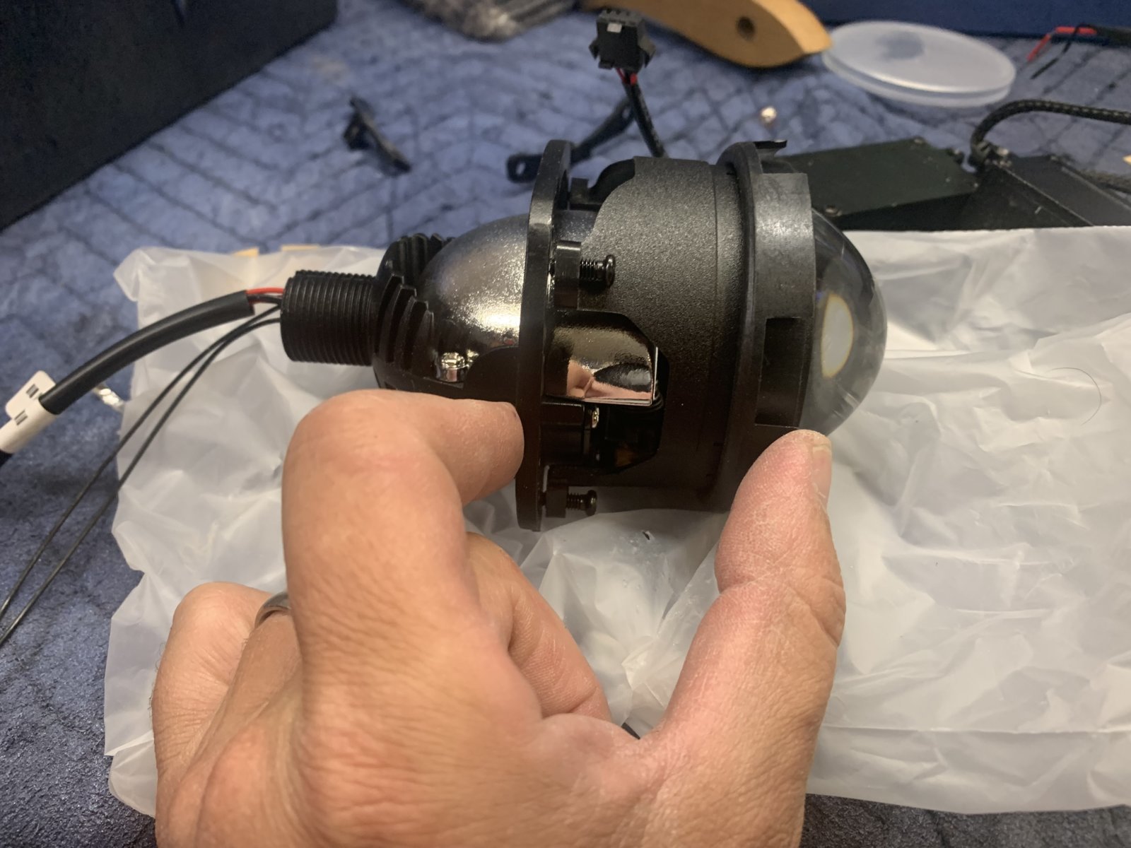

    Got the 2.5” projectors in. A little trimming needs to be done to get the shrouds to fit, but shouldn’t be too much of an issue. These didn’t come with blue lenses like the 3” projectors, but I decided on some old school blue demon eyes, on their way.

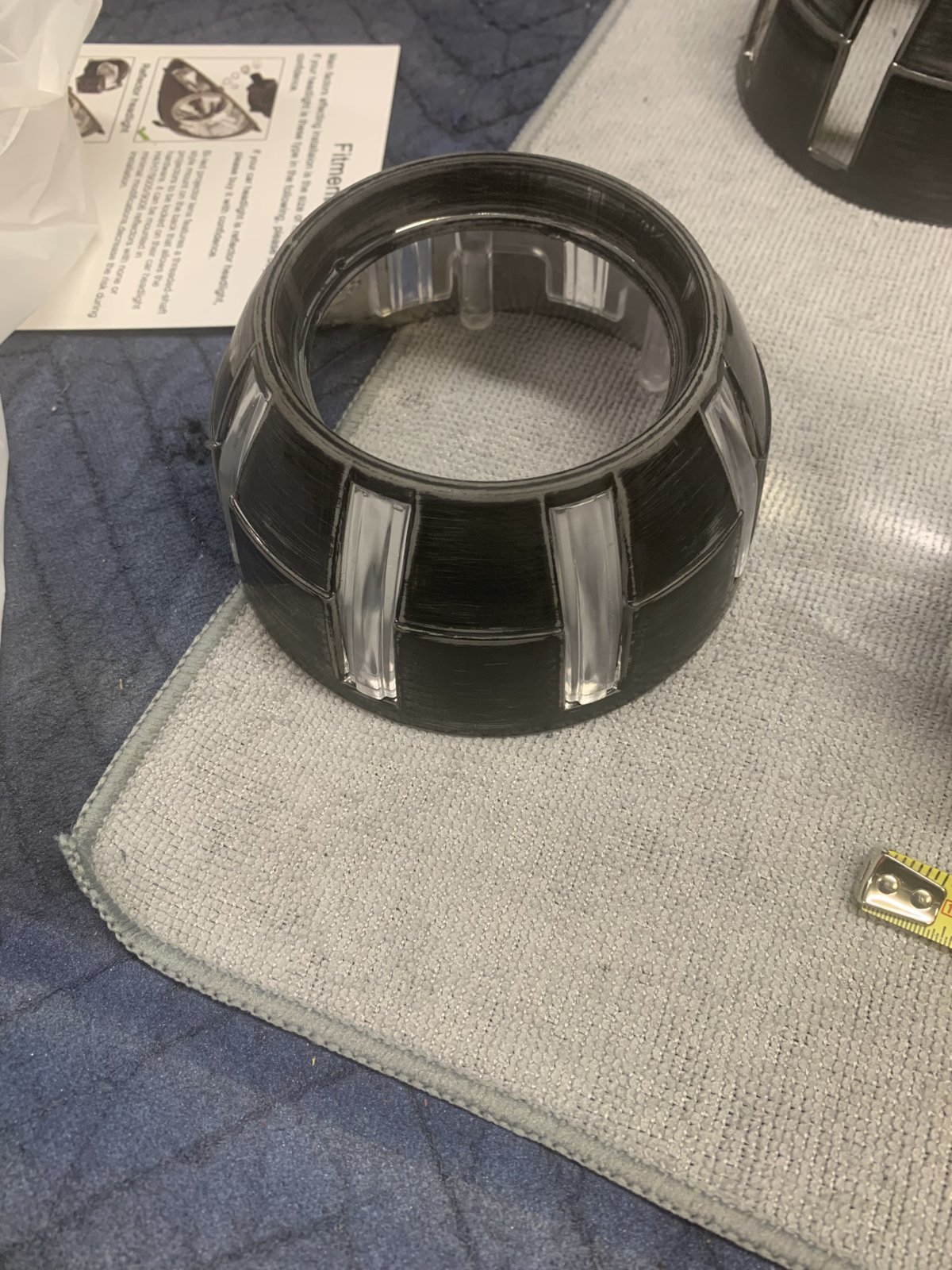

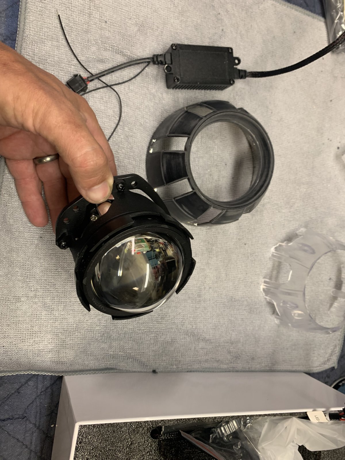

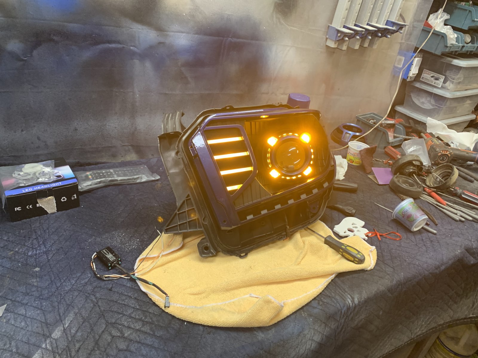

    Moving the build forward with parts so far.
    2.5” S8 BiLED projectors
    Morimoto Bullet 2.0 shrouds
    Profile Pivot turn halos (switchback won’t be used)
    Blue LED angel eyes.
    The angel eyes are old school retrofit stuff. I figured they’re old enough to bring them back to these retrofits.

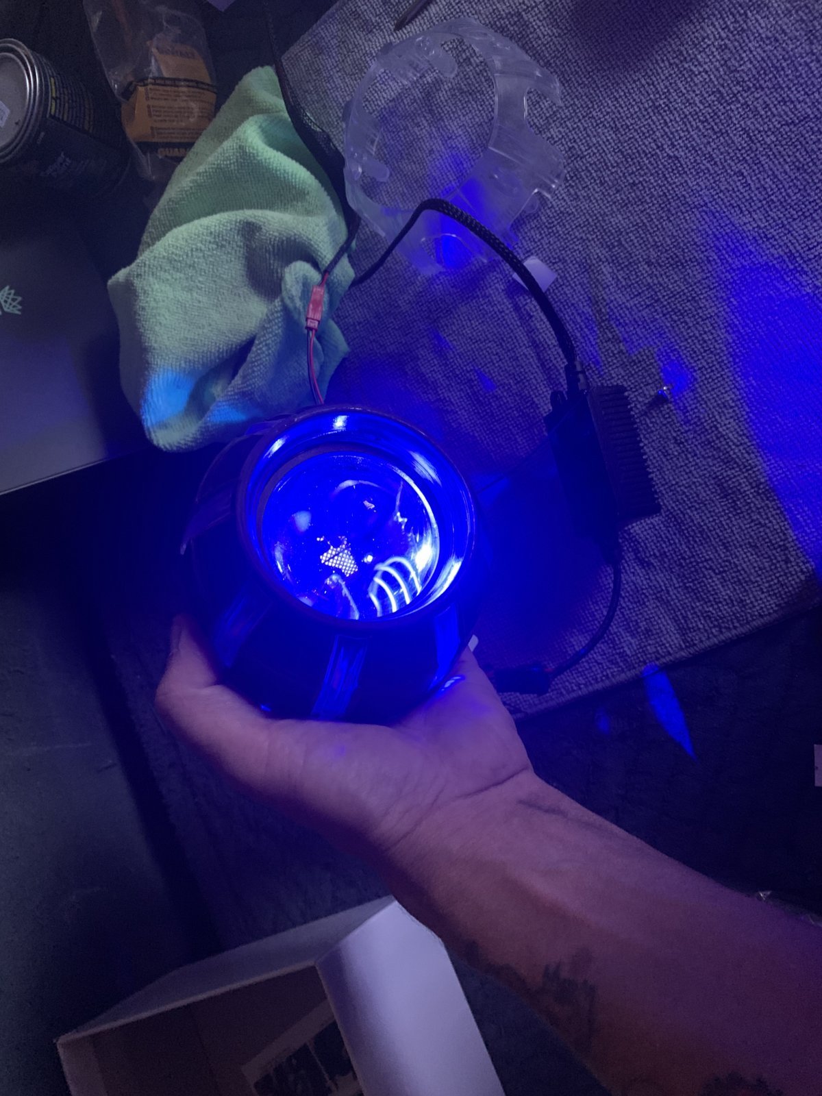

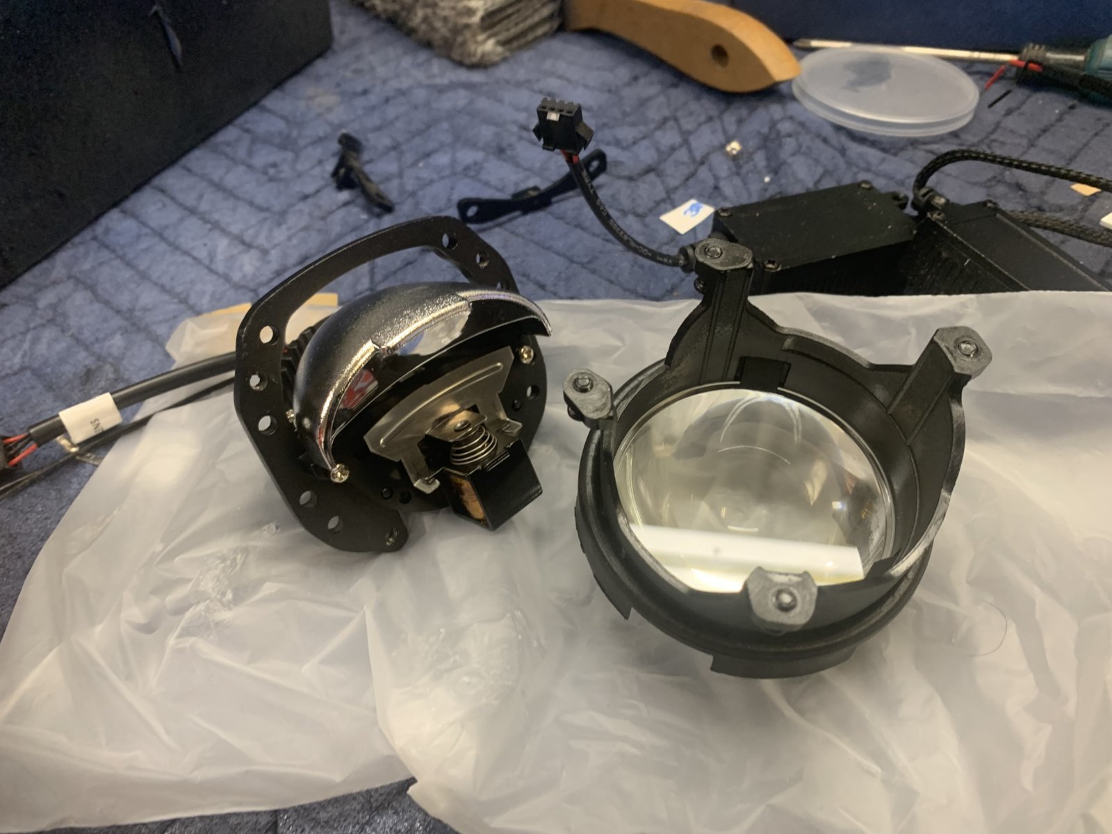

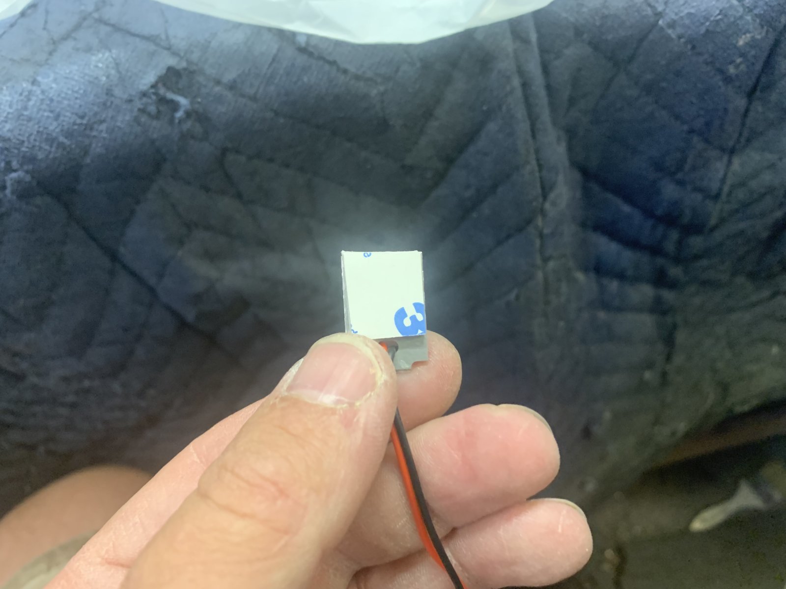

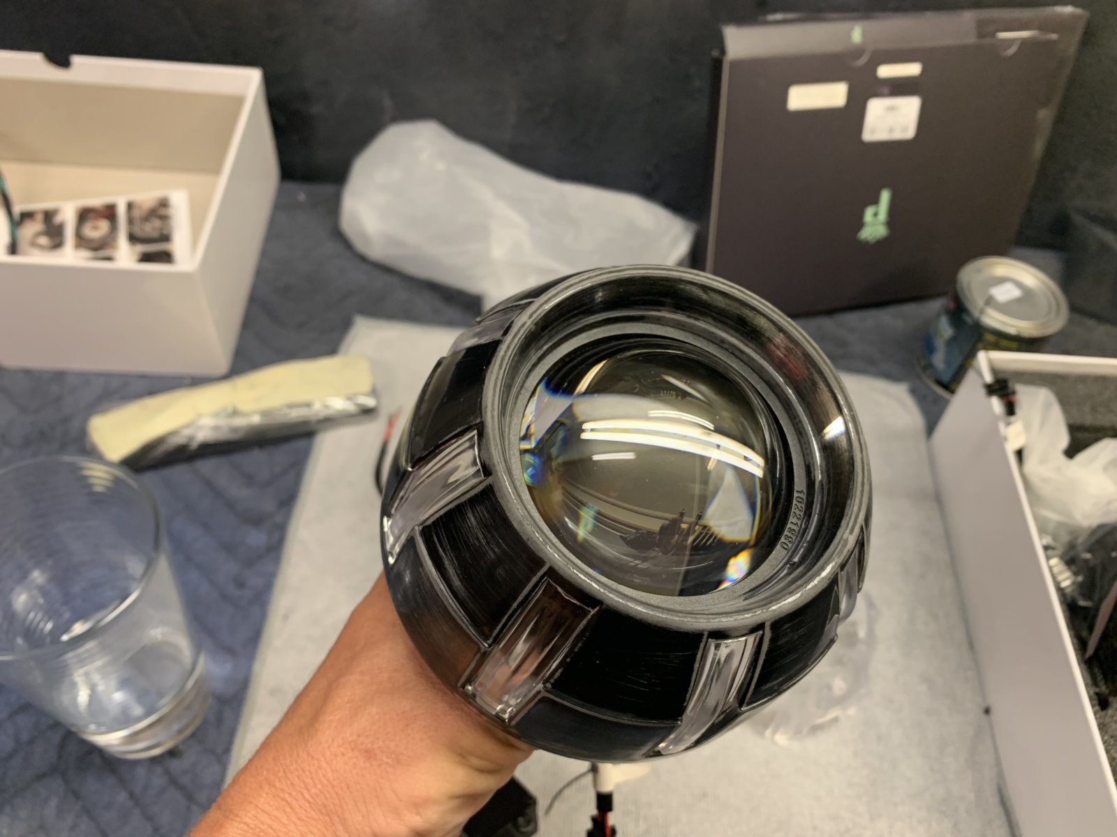

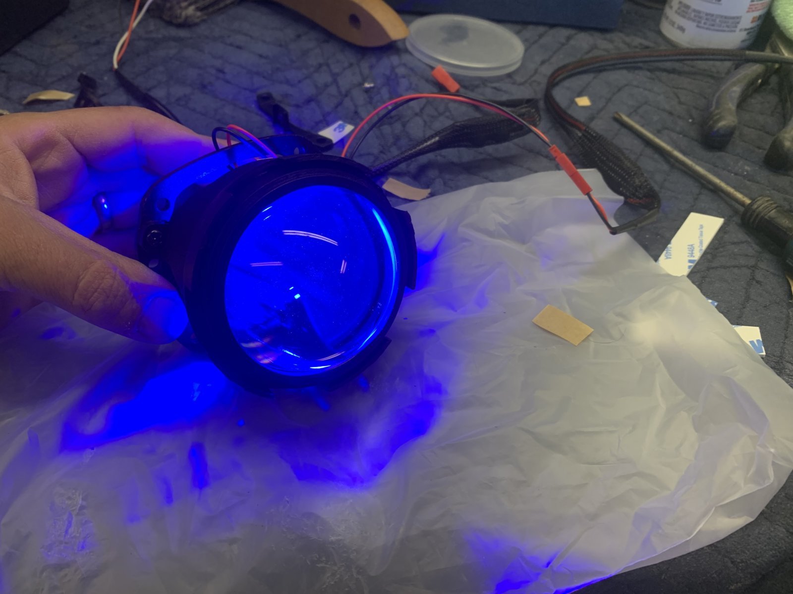

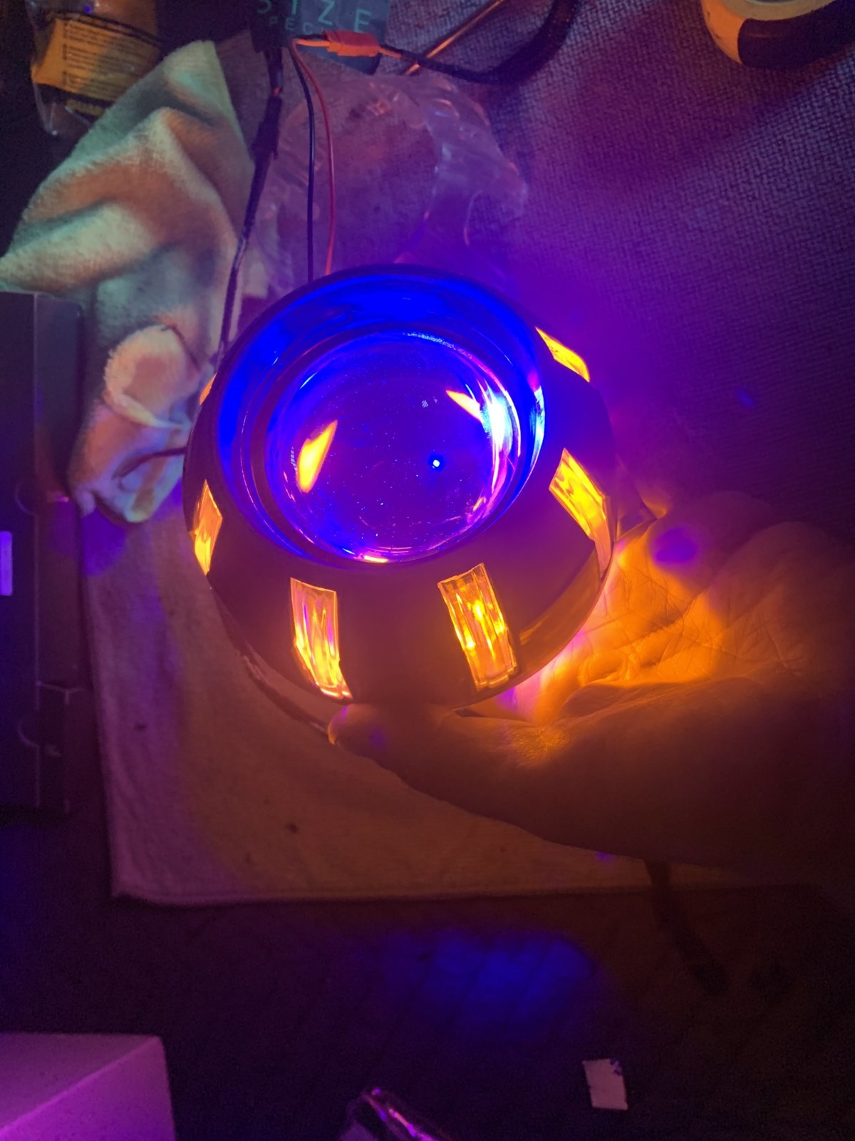

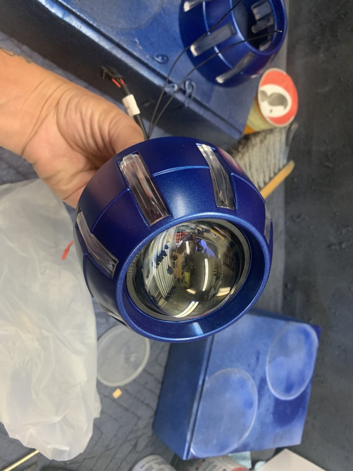

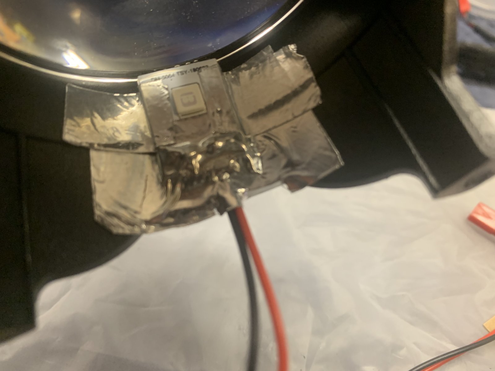

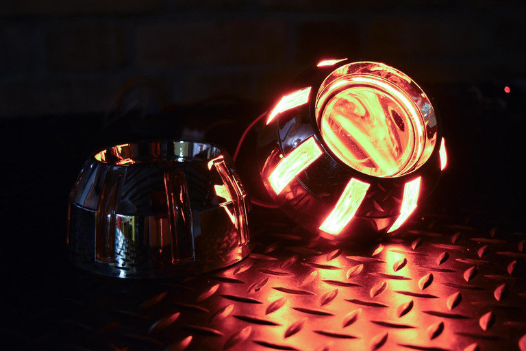

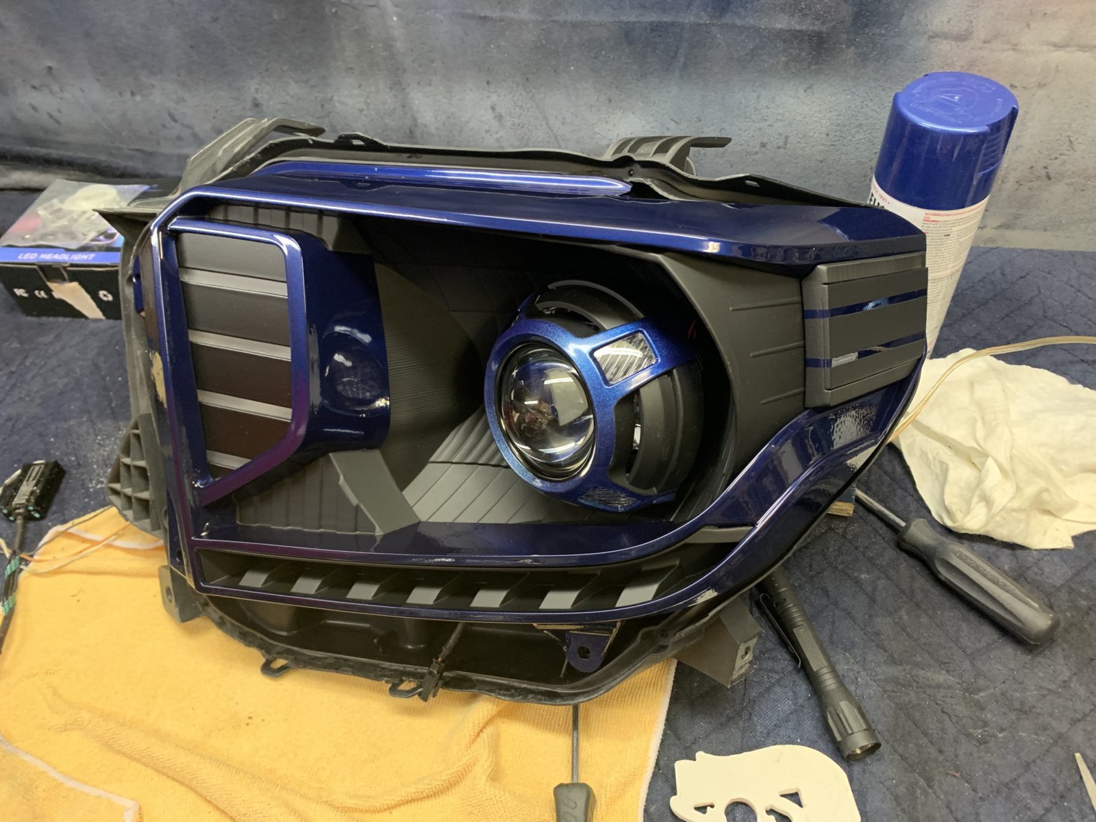

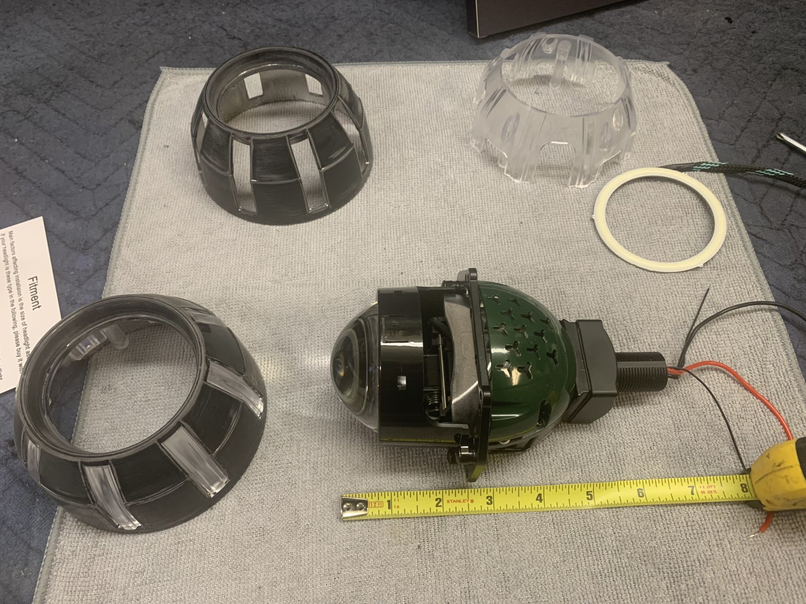

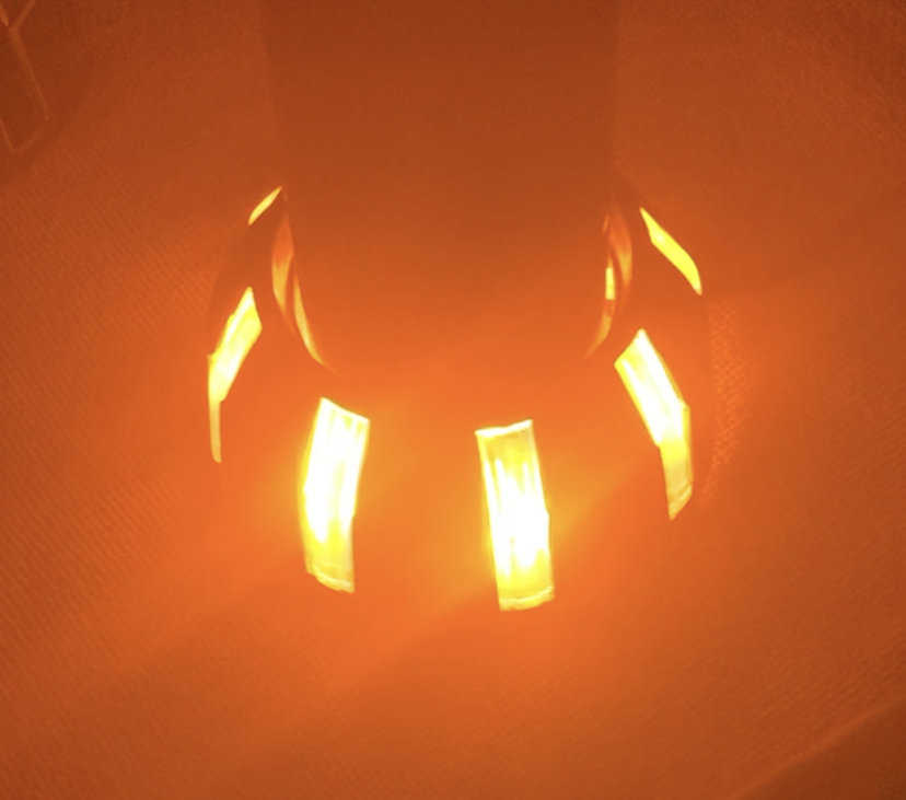

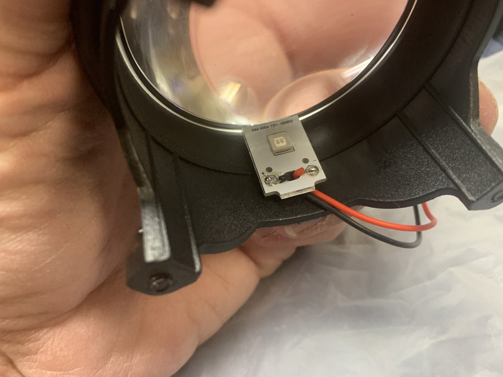

    Installing demon eyes and painting the shrouds.
    I painted the shrouds with the normal recipe of sanding the chrome off, painting with Bulldog plastic adhesion promoter, then color and clear.
    For the demon eyes, I took apart the projector from the lens bracket. I modified the demon eyes from the supplied bracket and used double sided tape for placement at the top of the lens. Then used foil tape (used for heating ducts) to hold the LED in place. The brackets provided would not work with the BiLED projectors.
    IMG_9199.jpg IMG_9191.jpg IMG_9192.jpg IMG_9194.jpg IMG_9195.jpg IMG_9196.jpg IMG_9197.jpg IMG_9198.jpg

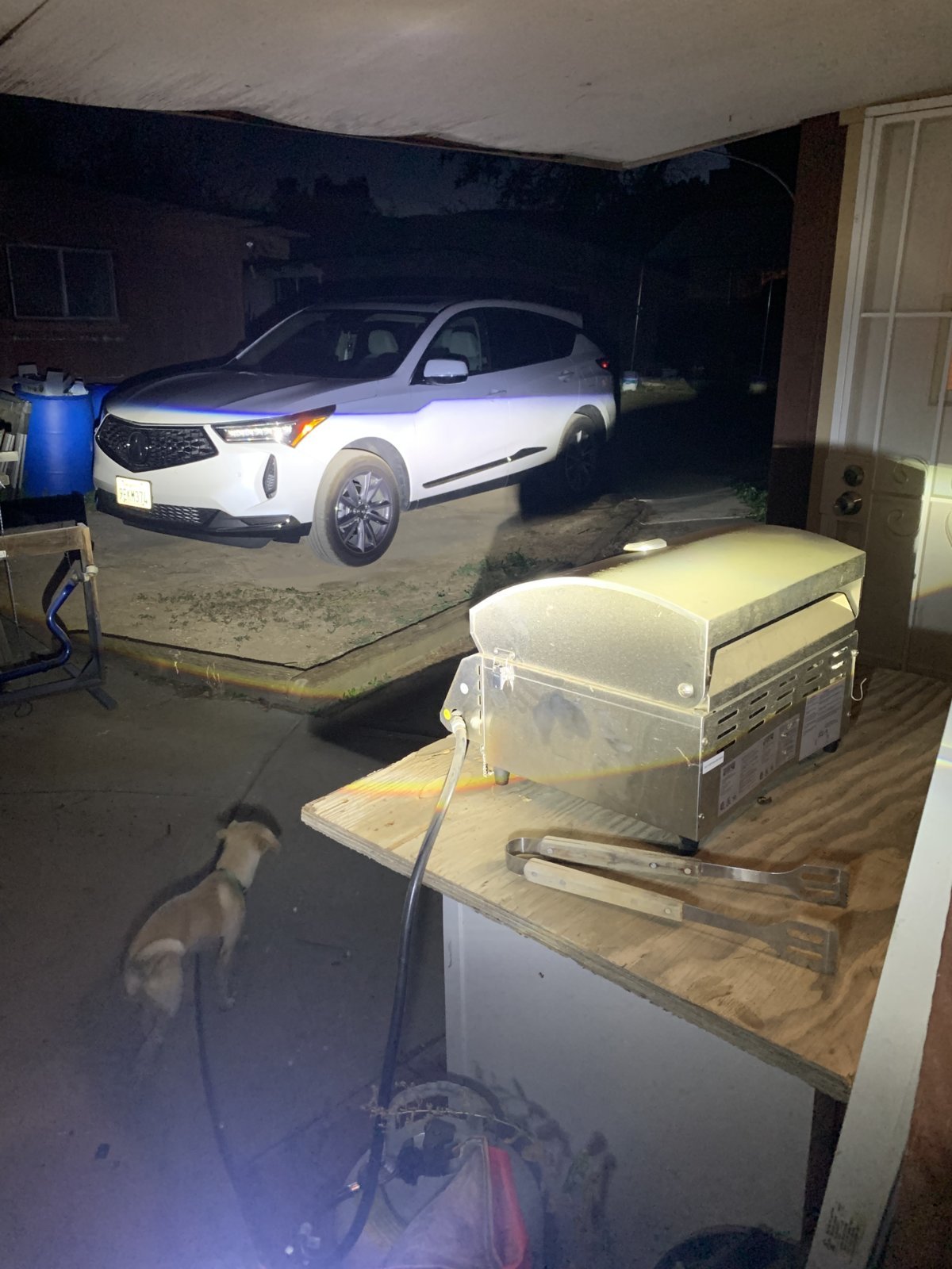

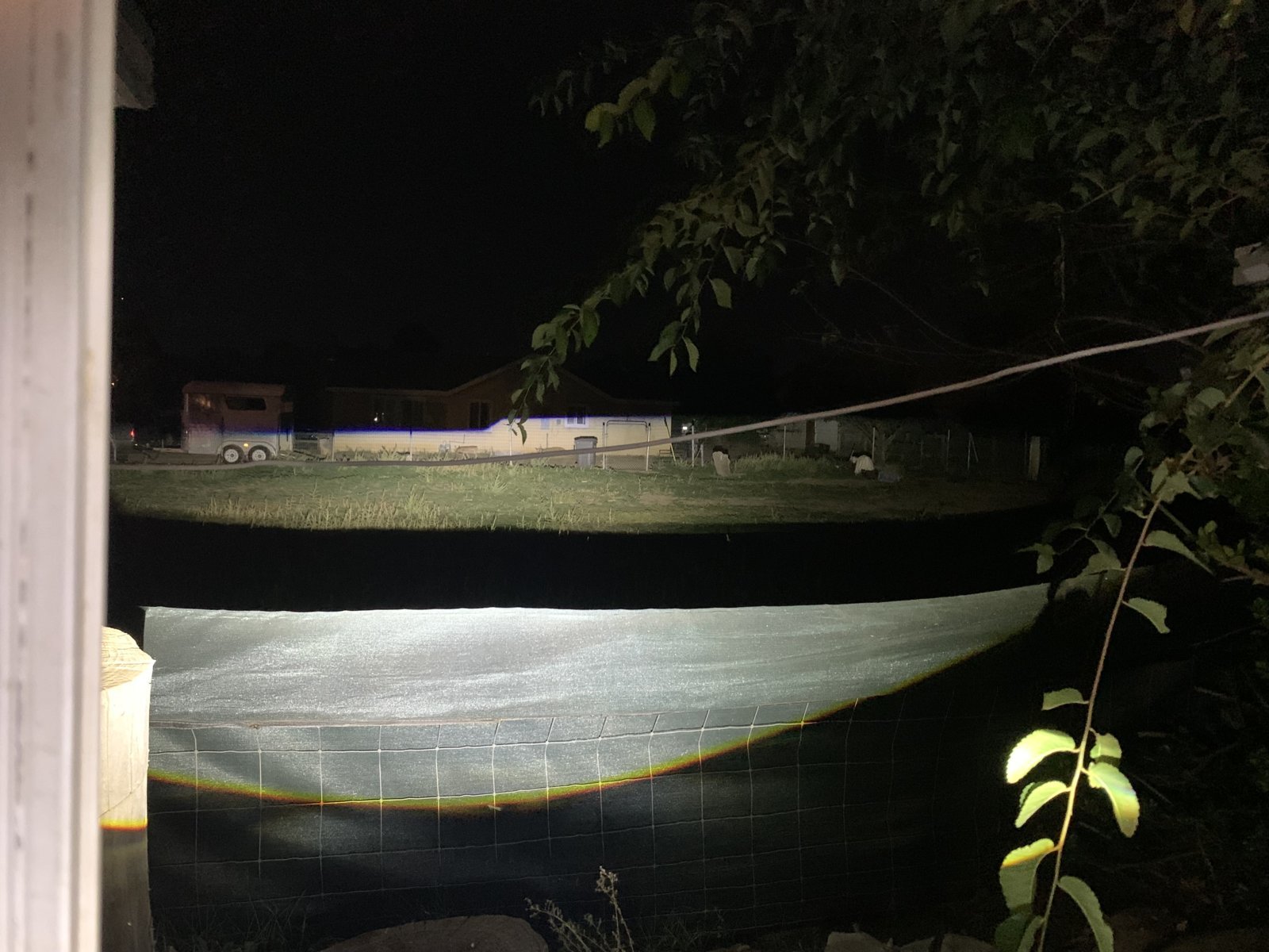

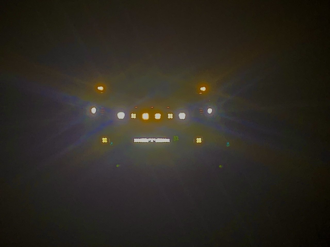

    2.5 projector output shot. This is my neighbor’s house (they’re not home). The house is about 200 ft from my position. The green tarp right in front of me is a wind block they put up for their chickens. This is also only one projector. Pretty psyched about these!!
  30. Oct 20, 2023 at 7:39 PM
    #1140
    33,919
    This is one?! Fuck their retinas, eh?
