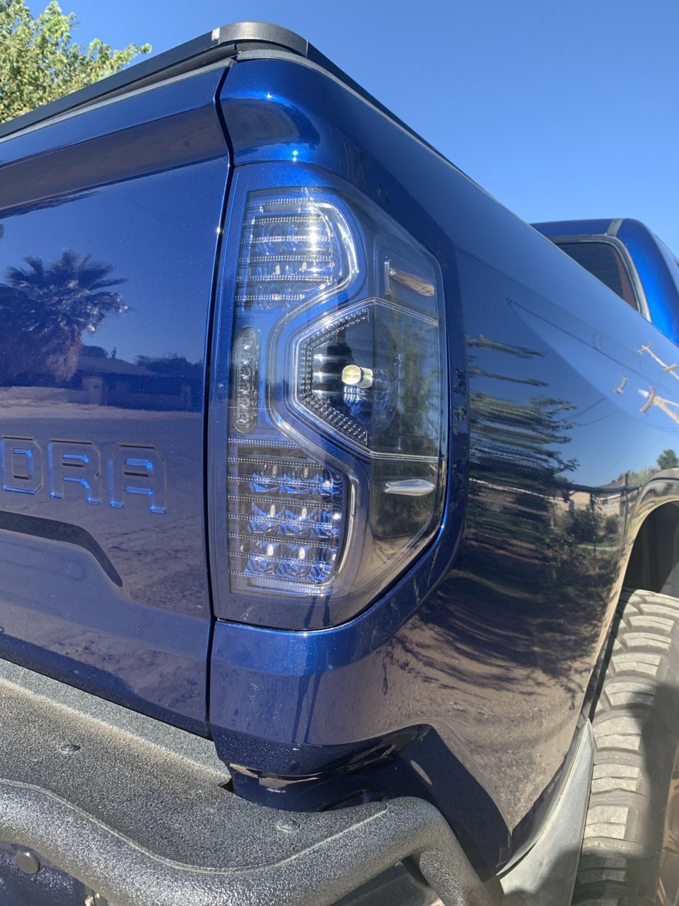

    Clear coat applied, almost there…

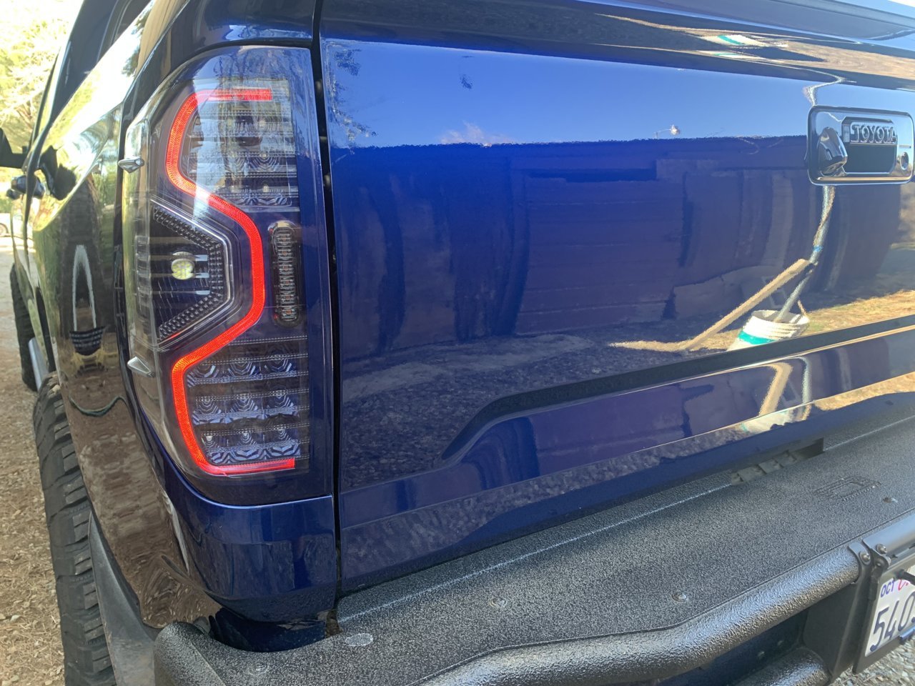

    Installed! We’ll wait till later for some night shots and video. Chase lights are up and running. Good to go!

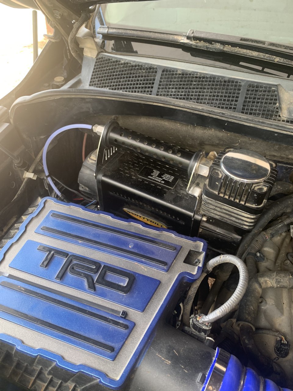

    I posted earlier about my compressor going out. After driving through a heavy rain storm the compressor wouldn’t turn off. I yanked the fuse and saved the problem for later.
    So my mistake this morning was not reinstalling the fuse and making sure it works. I uninstalled it, opened her up, and rewired everything that is inside the switch compartment. The compressor comes wired with a switch, and a circuit breaker. But inside the compartment, everything is connected with wire nuts. I just soldered and shrink tubed everything, tested it, and it works great. I didn’t take any damn pictures, but I redid the air lines under the hood to remedy the slow air leak I have. The compressor turns off at 75psi via an installed air pressure switch, it kicks on approximately every two minutes for a few seconds, letting me know there’s a small leak. Right now it’s holding tight, and I’m happy to have my air back in the truck.

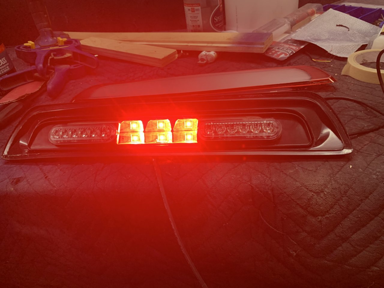

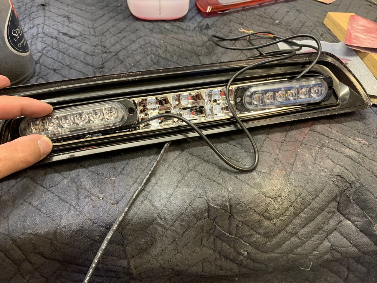

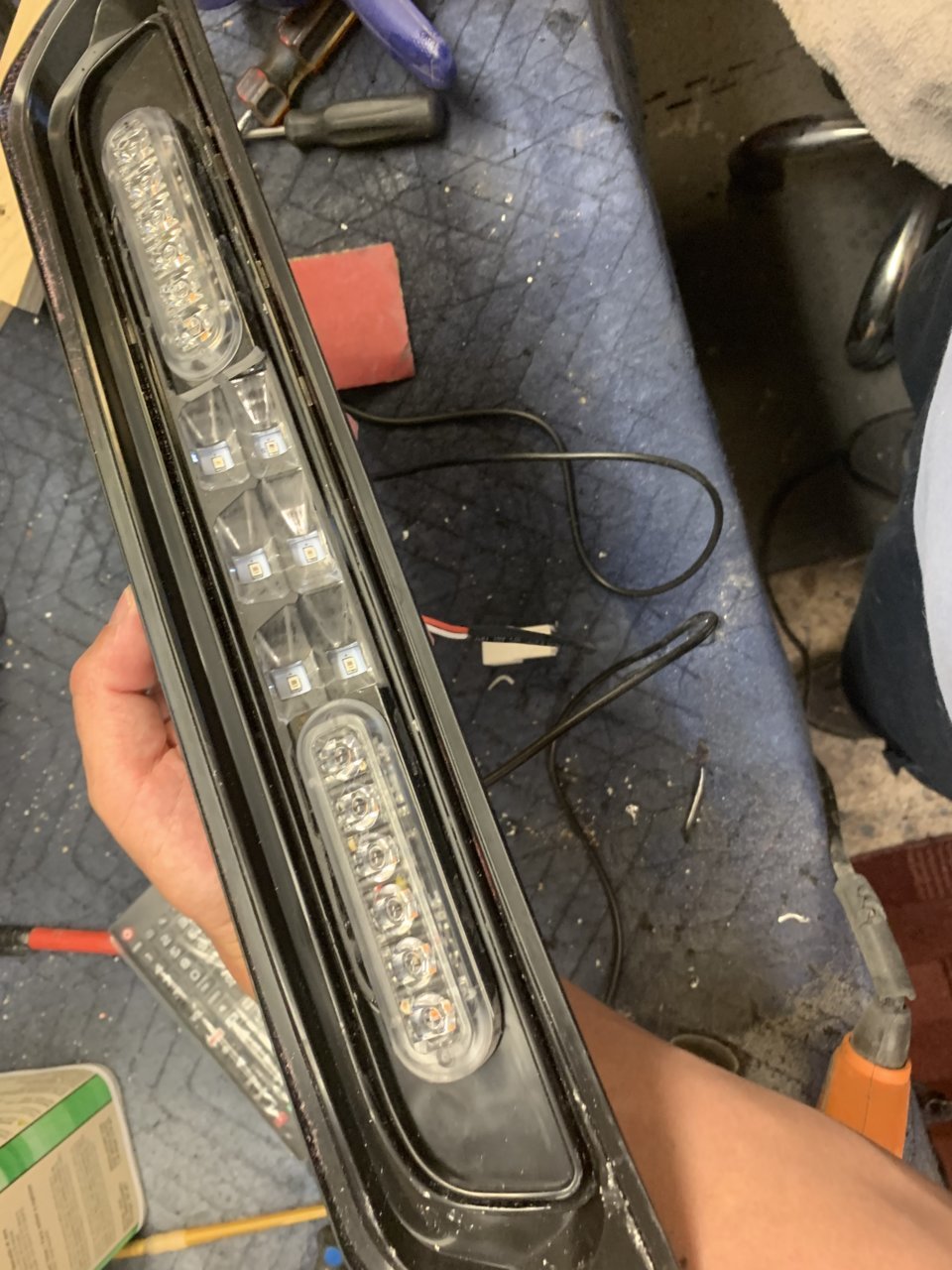

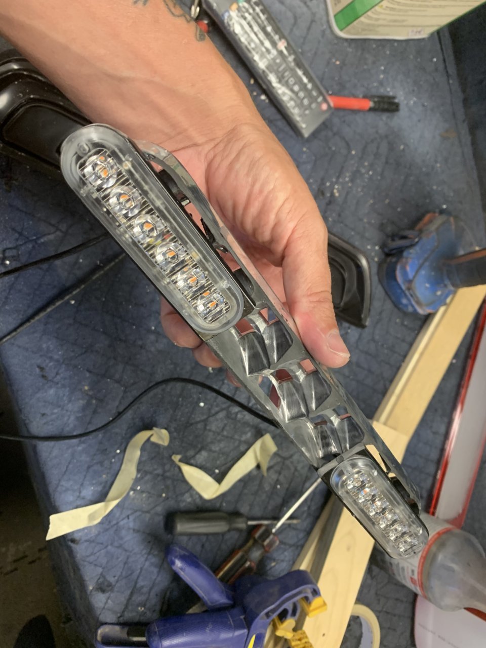

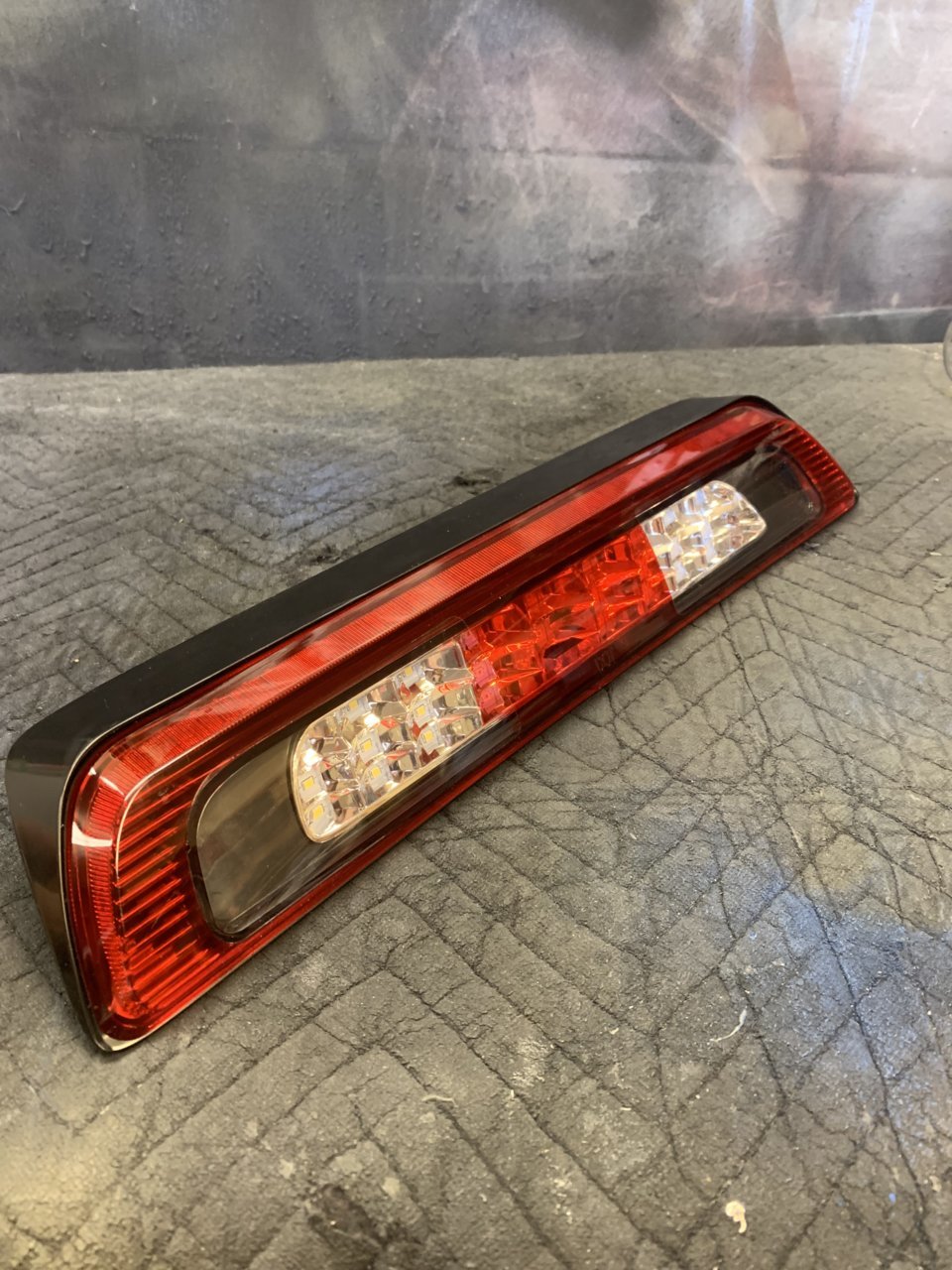

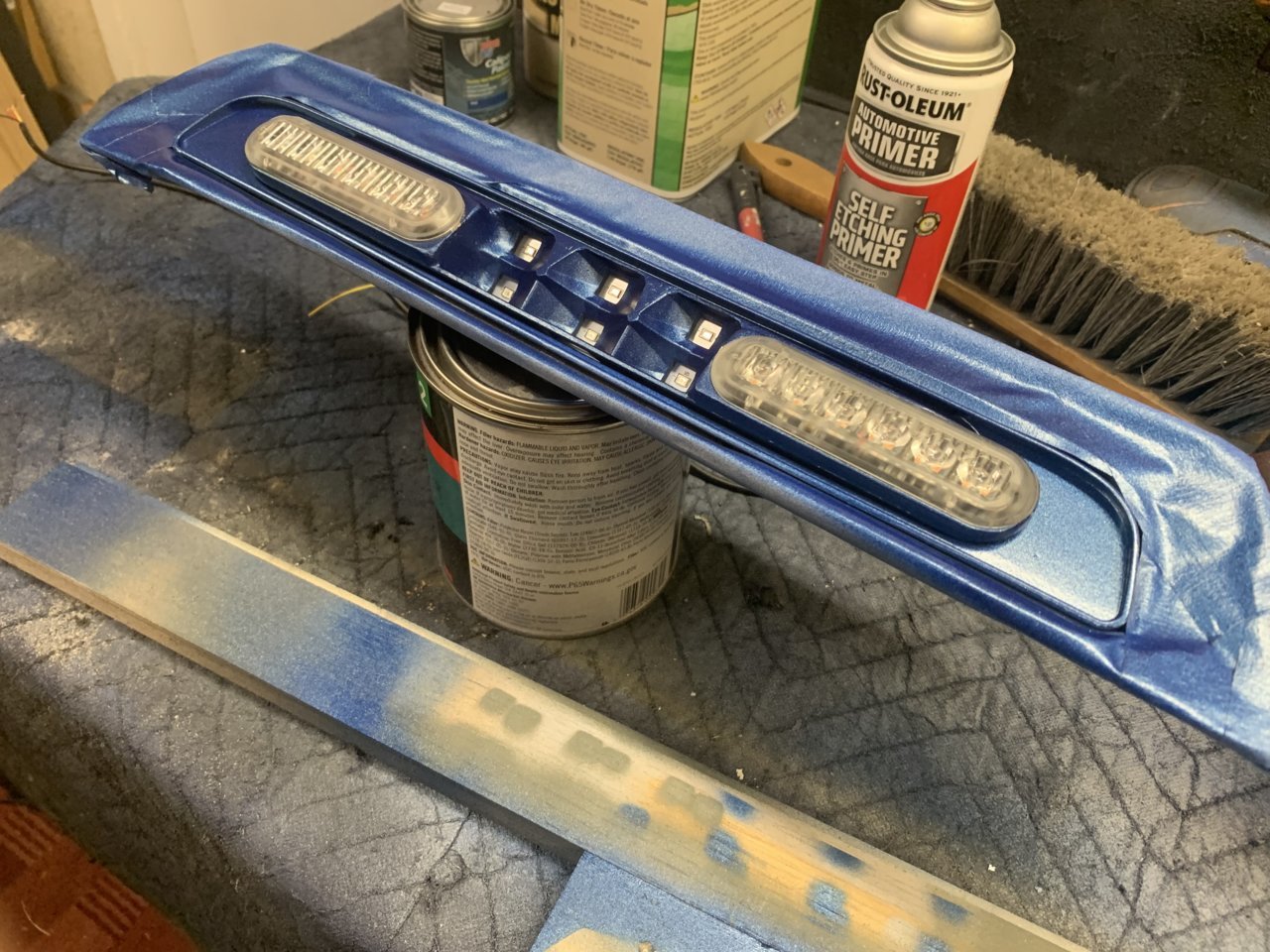

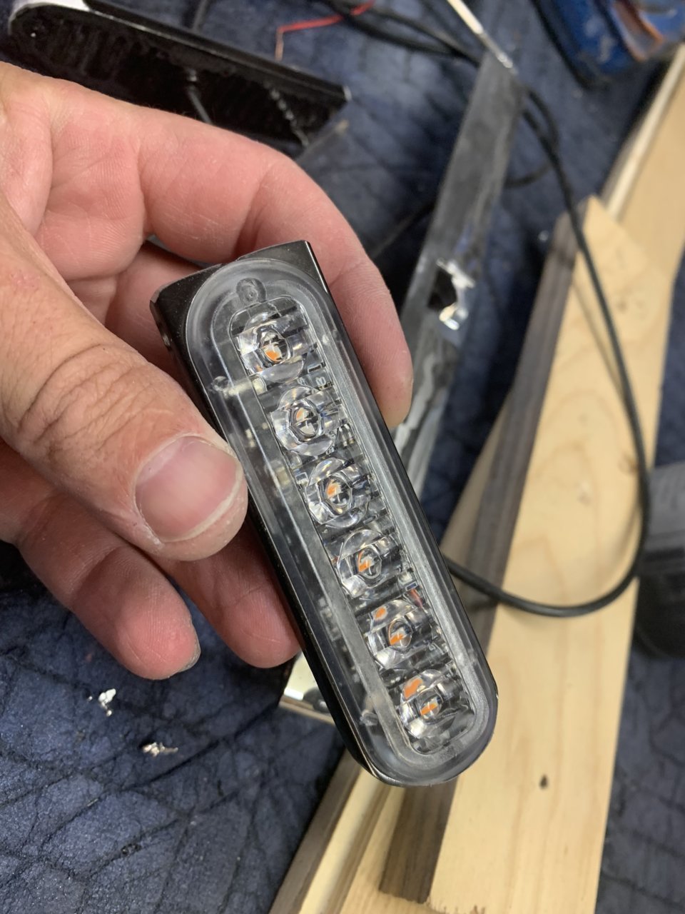

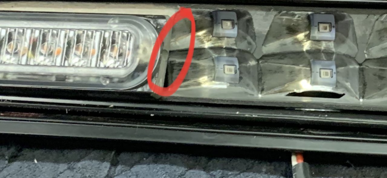

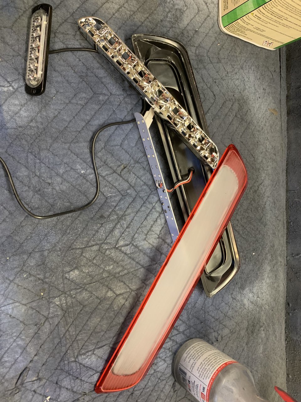

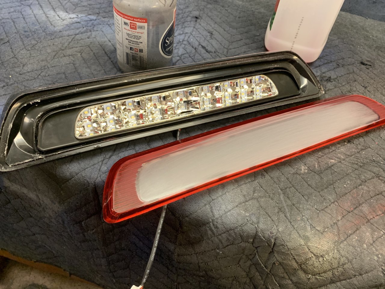

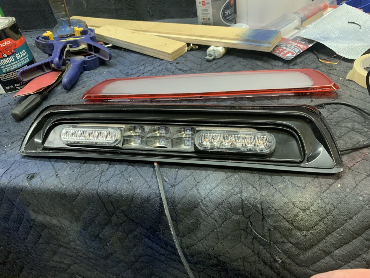

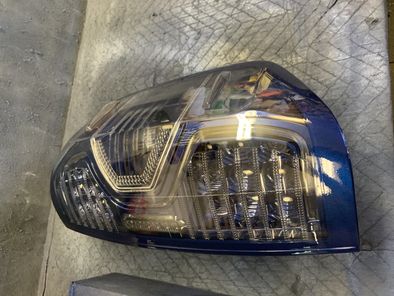

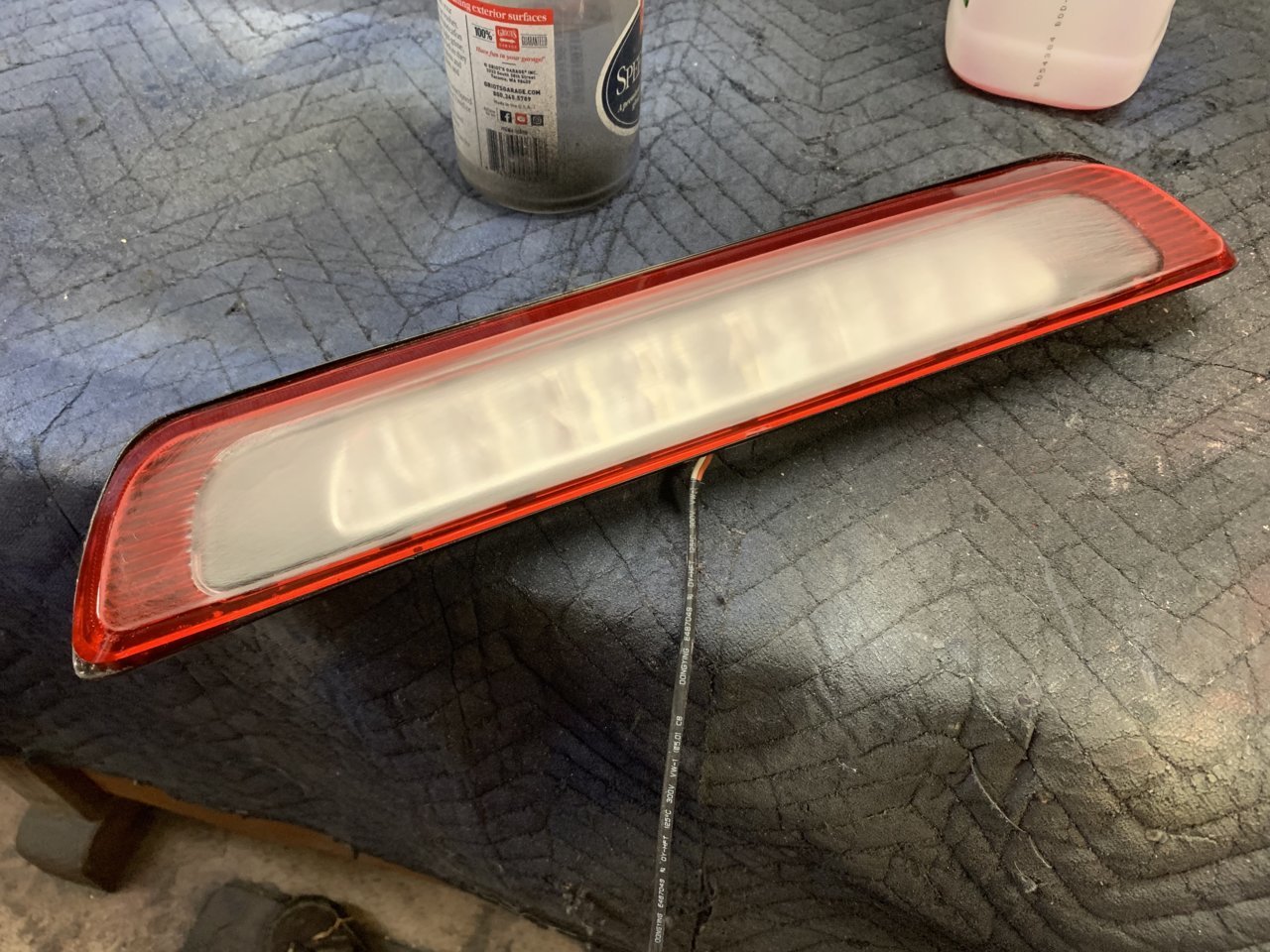

    Next project - match the tails. I grabbed a cheapo third taillight on Amazon, and with a little heat gun action, got it apart. You can really see why these leak. It came right apart. The one I wanted had an ugly red stripe down the middle, so it got sanded off and once the clear goes on it should be perfectly clear.
    Just a sneak peek of what they’re getting and we’re on our way.

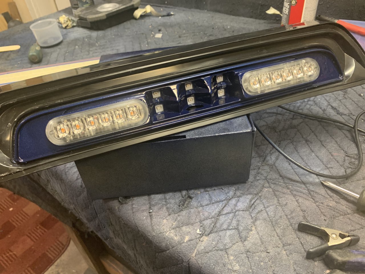

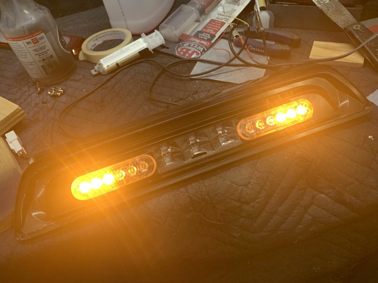

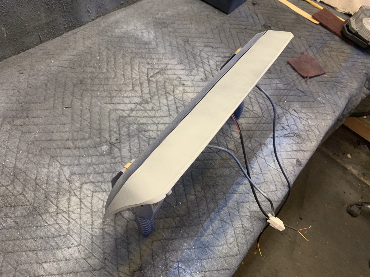

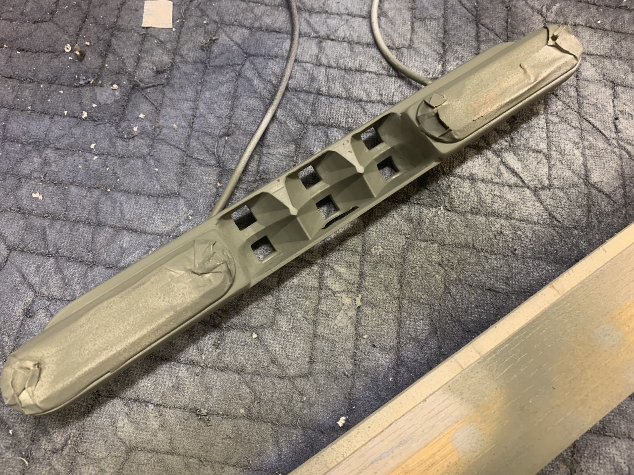

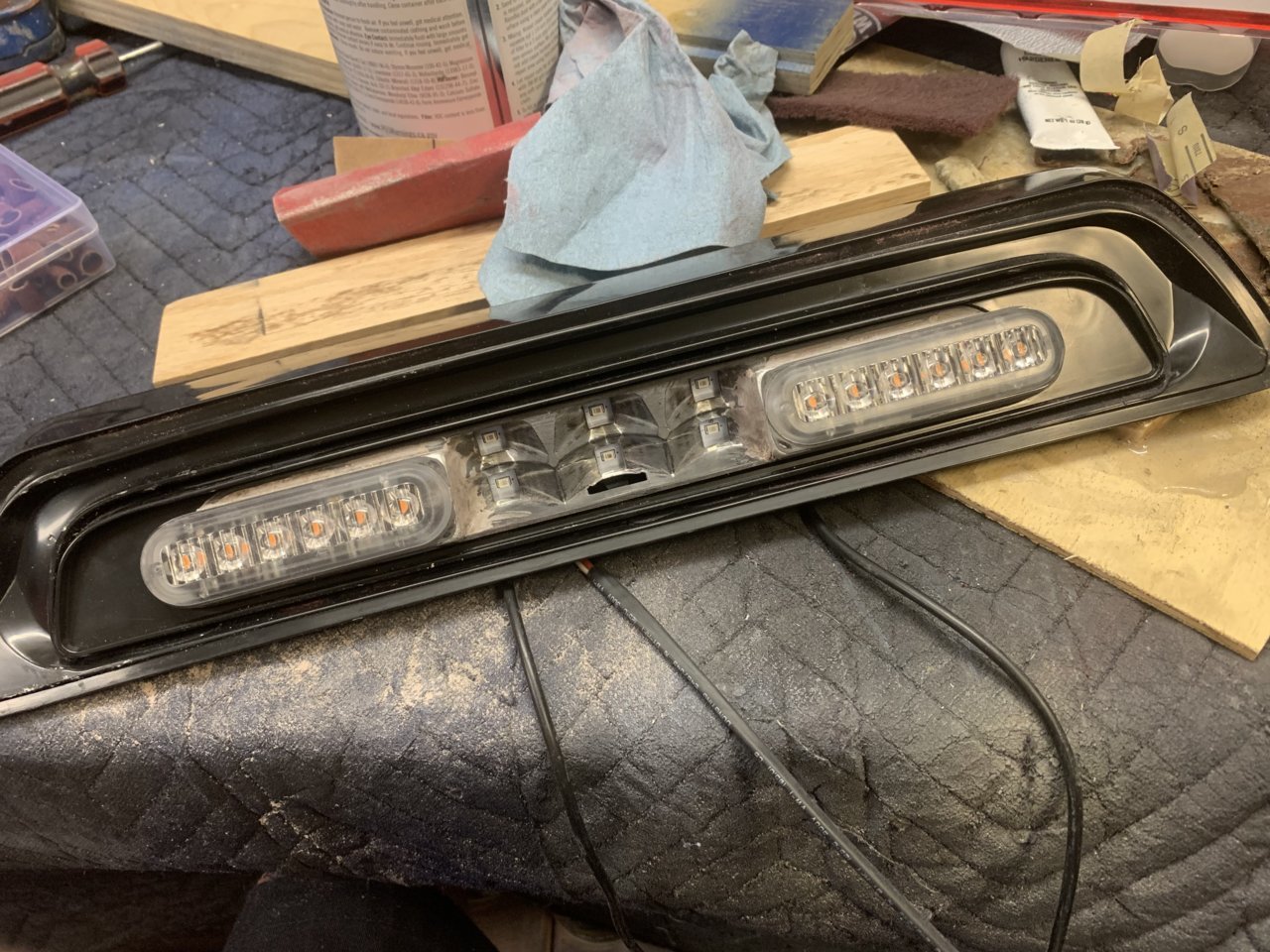

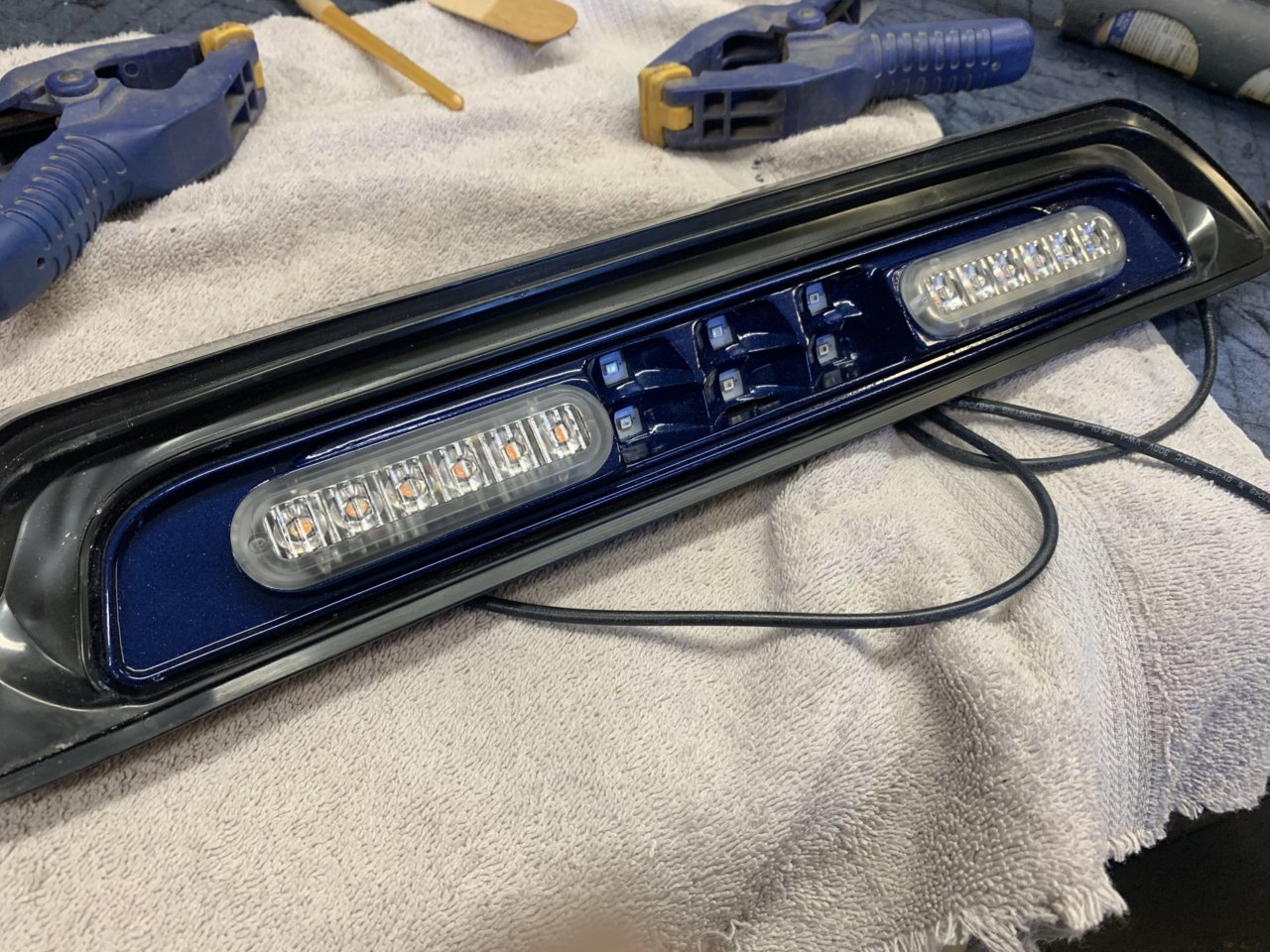

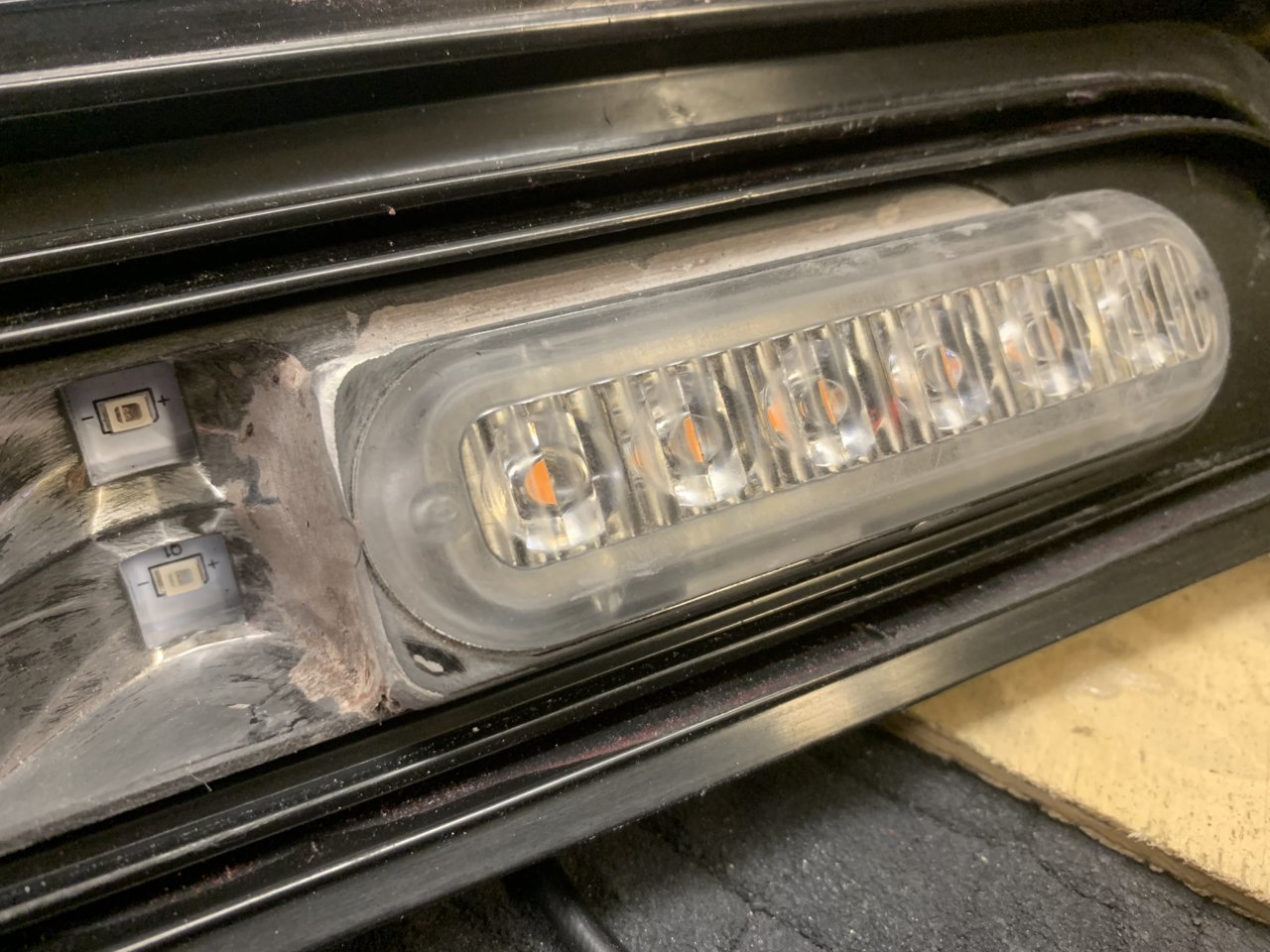

    Moving along on the third brake light. Drilled through the board to pass the chase light wires through, and shaped the chase light.
    Then I epoxied the lights to the bezel and filled the top area with fiberglass bondo.

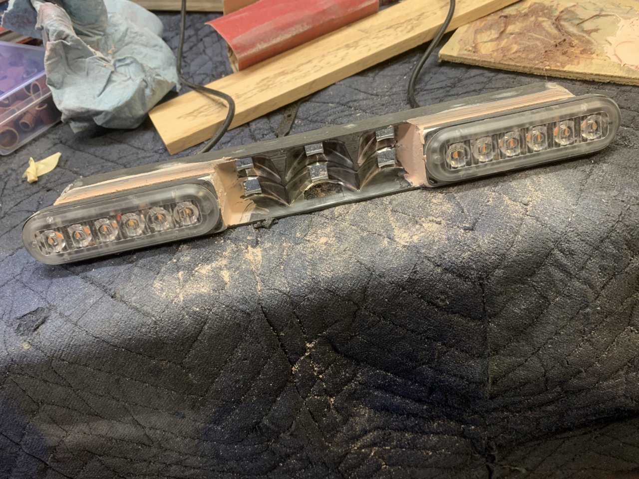

    Little more bondo to smooth out the chase lights. Needs another smooth coat, primer, them one more.

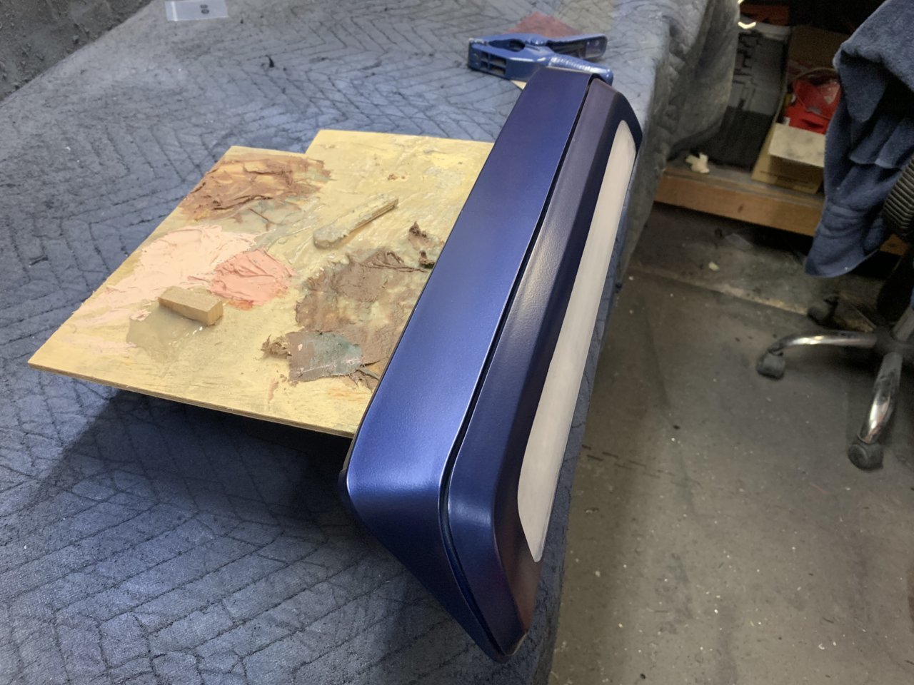

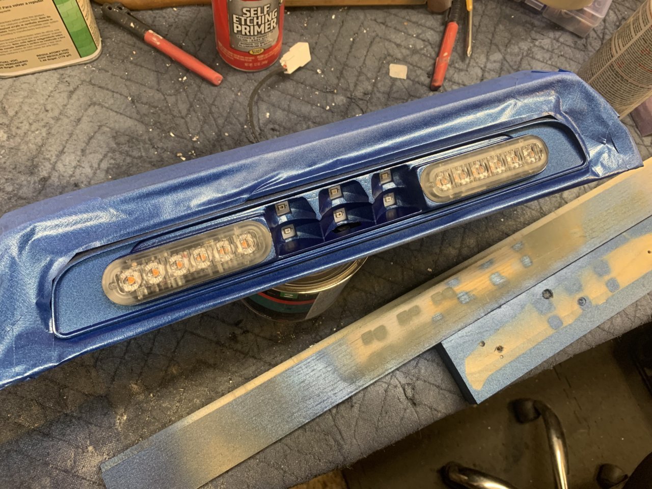

    Primer down. Actually doesn’t look like an afterthought. Still needs one more coat of body filler.

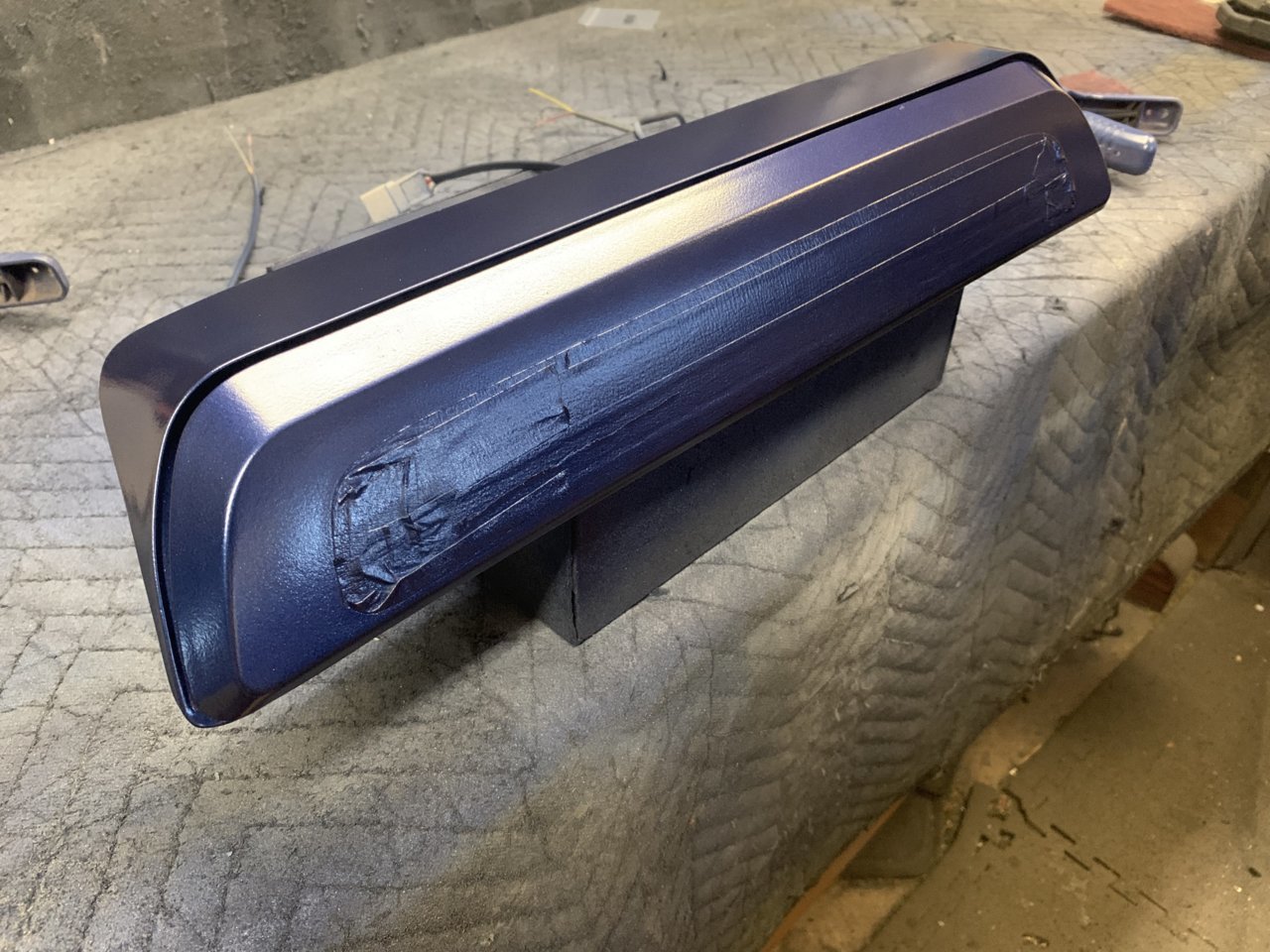

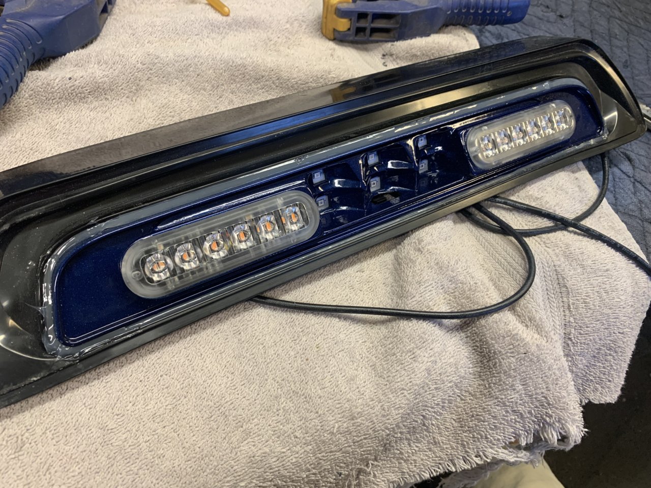

    Got the last coat of filler, primer, and a coat of bluuuuuue.

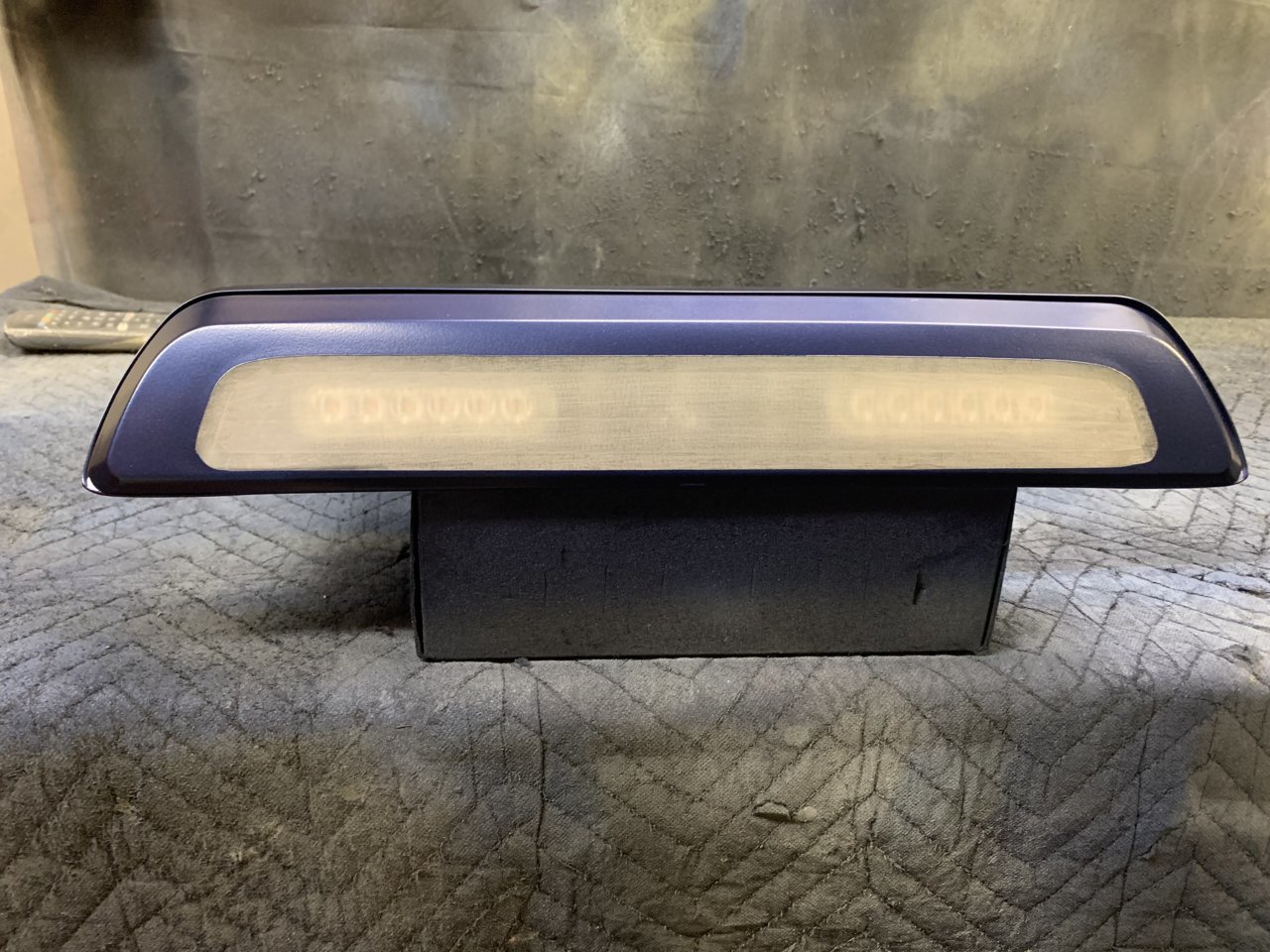

    Blue Ribbon and 2K clear. The lens is next, and will get attached in a few days when the clear is gassed off.

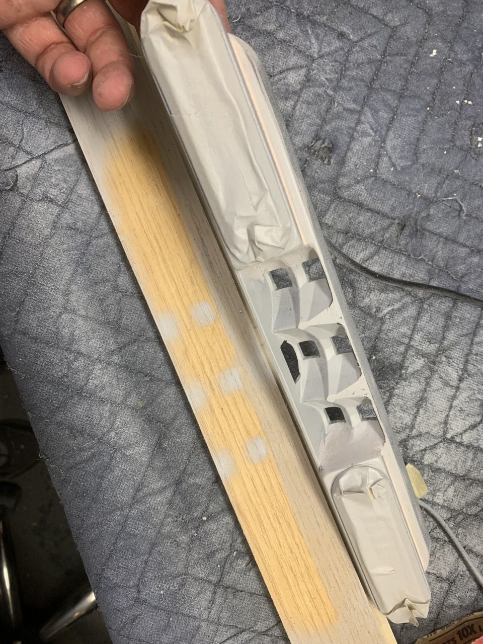

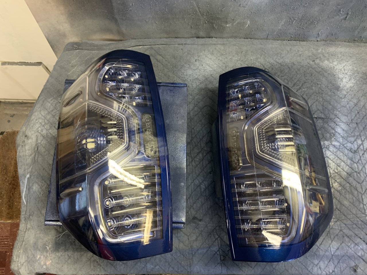

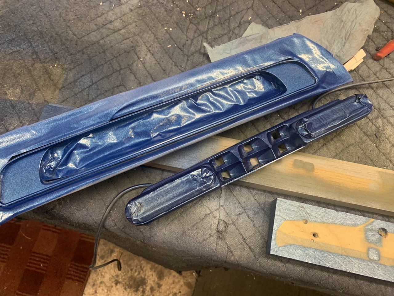

    Paint paint paint.
    Applied a smooth bead of silicone around the painted area into the channel.
    Taped off the inside area of the lens and clamped the lens onto the bezel.
    Sprayed the plastic adhesion promoter after scuffing with a 7447 red scotch brite.
    Sprayed with 8T5 Blue Ribbon
    2k clear is hopefully tonight.
