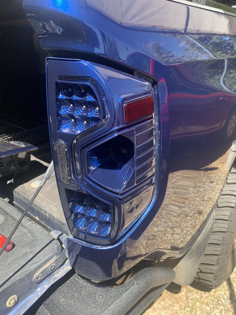

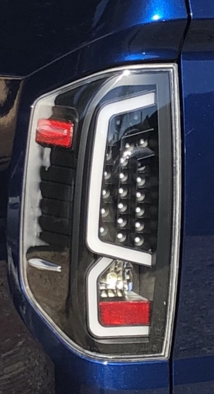

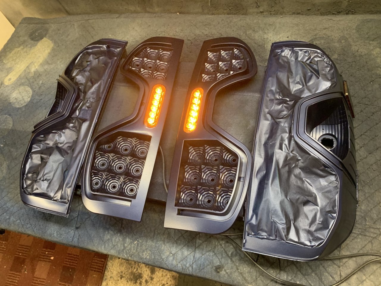

    No problem. You can see here on my old taillights, they arrived leaking. I had to fix them. IMG_8743.jpg

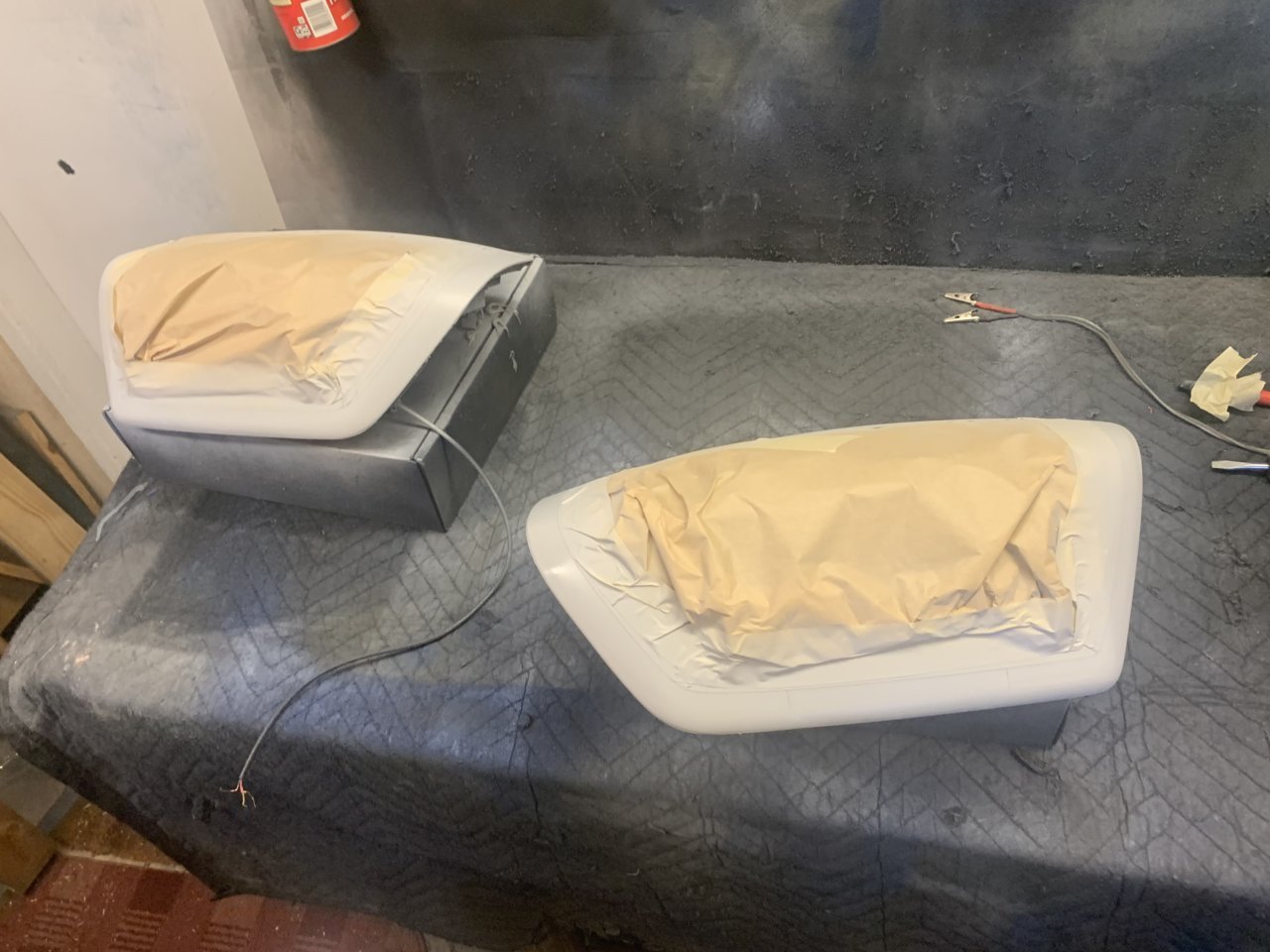

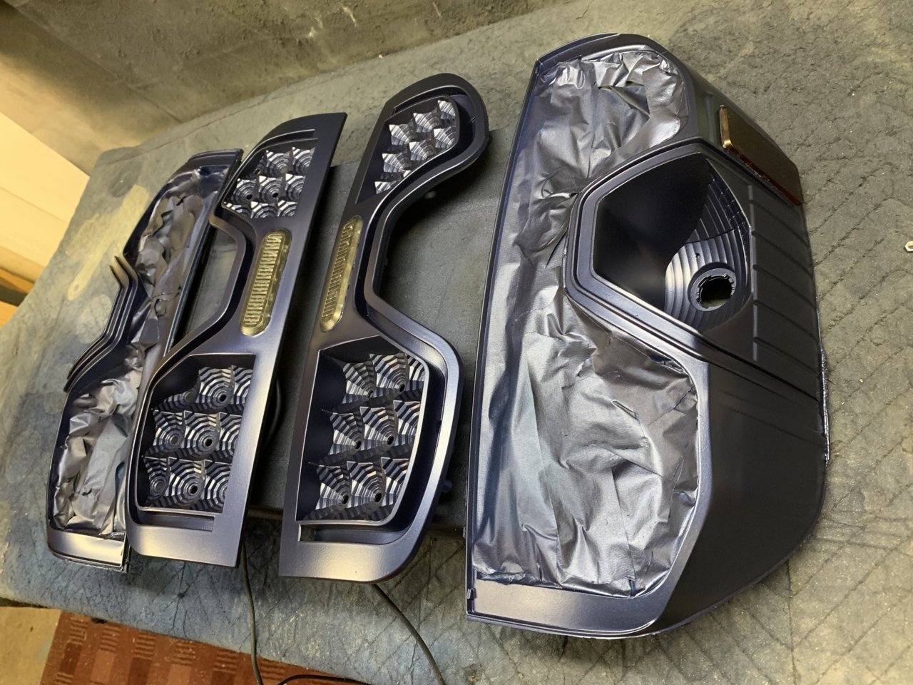

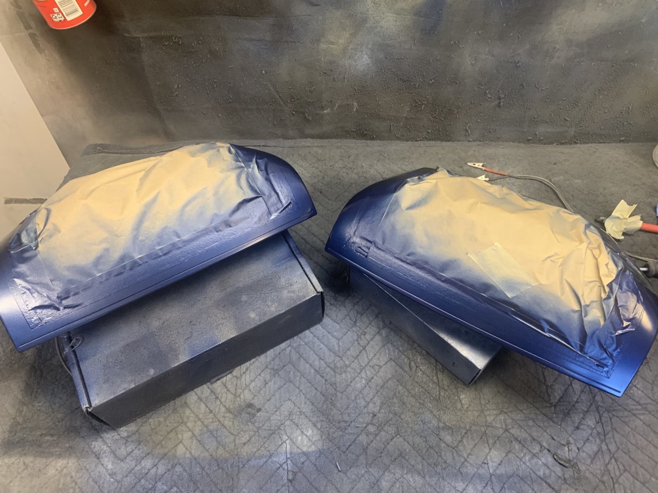

    8T5 Blue Ribbon is down. 2k clear goes on tomorrow, then a little matte black to break up the color (maybe).

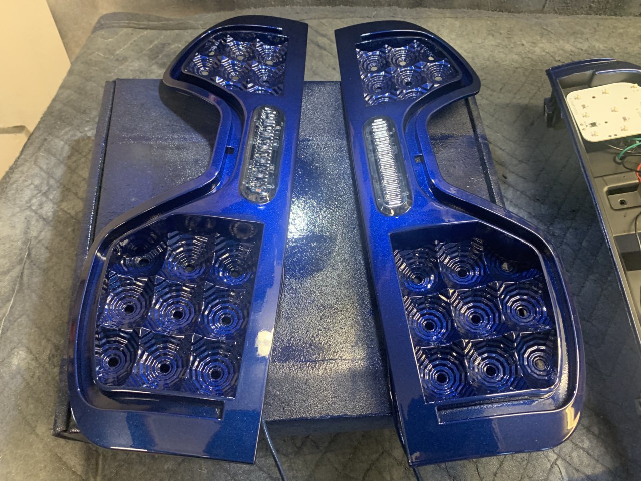

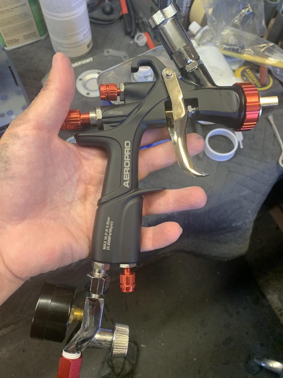

    We’re in business!! 2k clear coat is down, new spray gun works fantastically. The clear I purchased lays super flat and smooth. Couple days from now I can seal them up, after they gas off completely

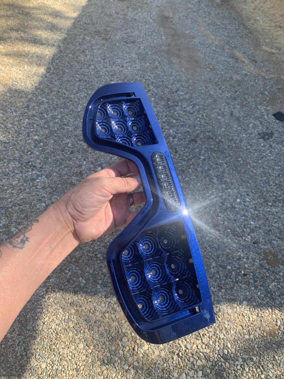

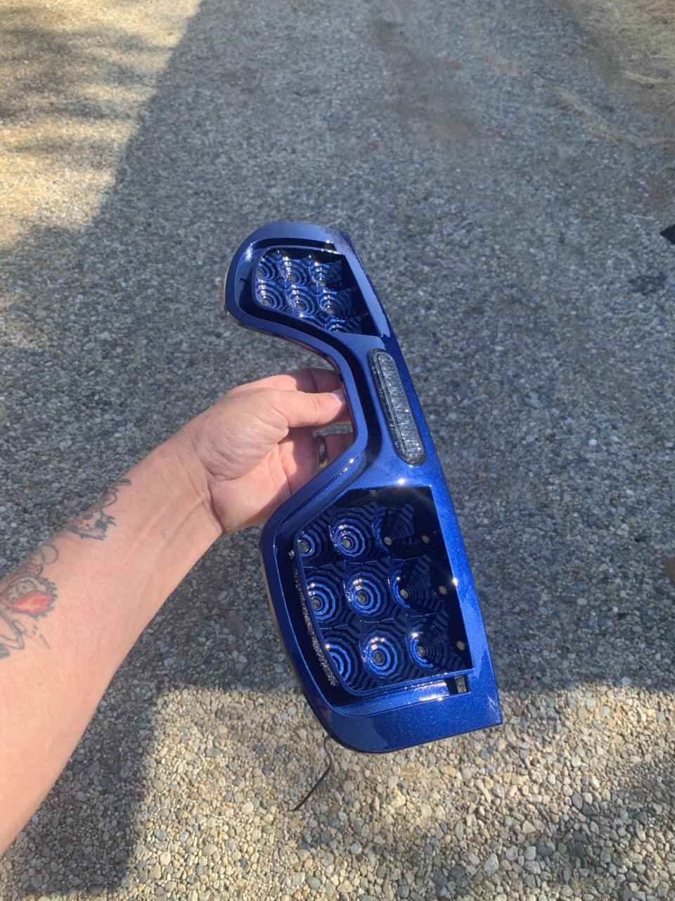

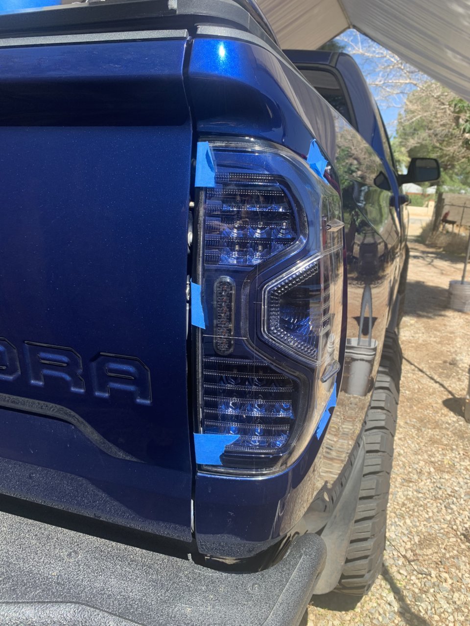

    The paint has gassed off, the light bezels have been assembled, just doing some test fits. After making a few tails, I’ve noticed to get the best fit results, it’s best to mount the bezel to the truck. I apply some adhesive, then place the lens over the bezel and tape to the truck. That way the reveals should be as good they can get.
    The lens surround is currently black. I’ll be painting it Blue Ribbon when everything is sealed up.

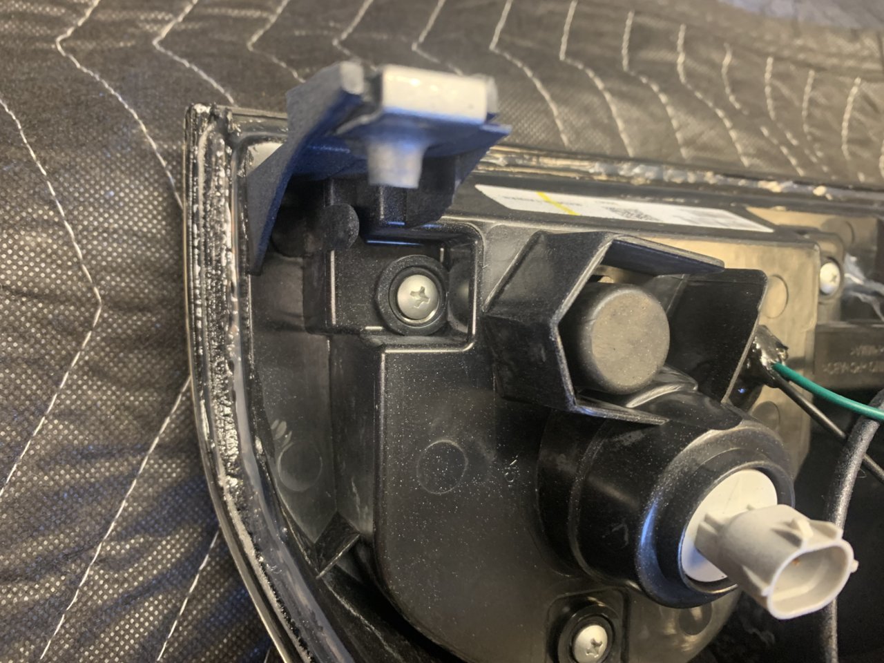

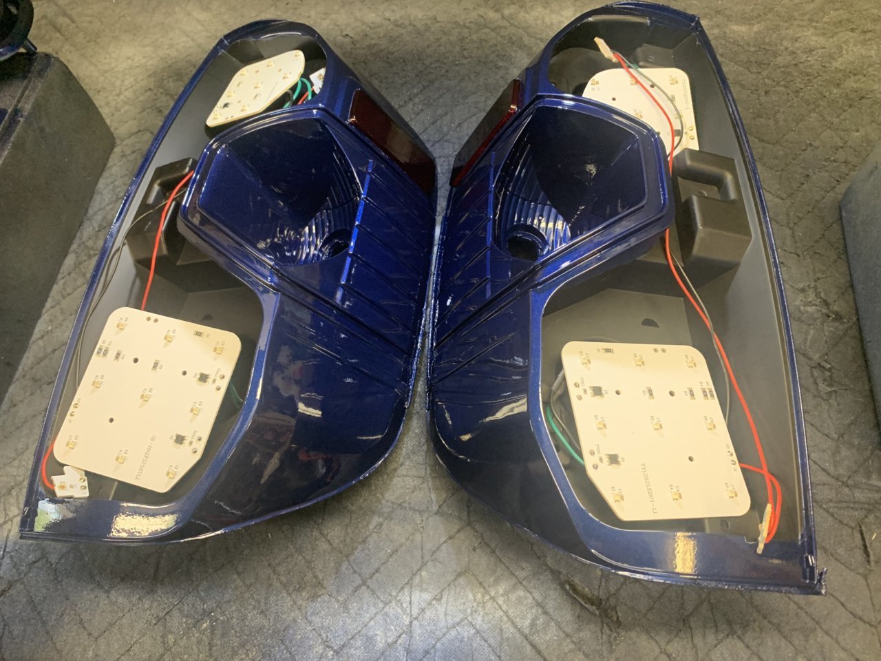

    Taillights are assembled, ready for the second paint stage.

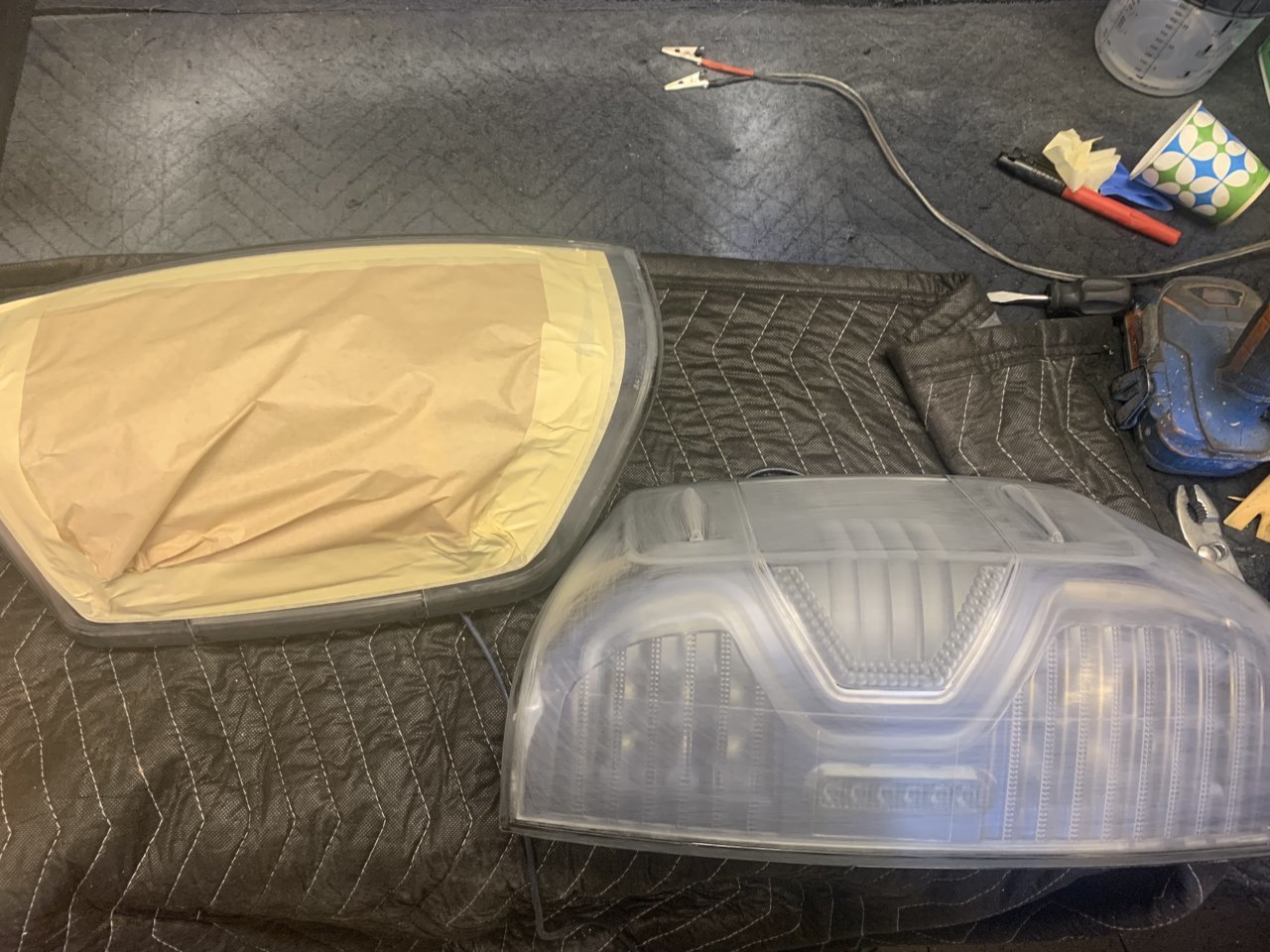

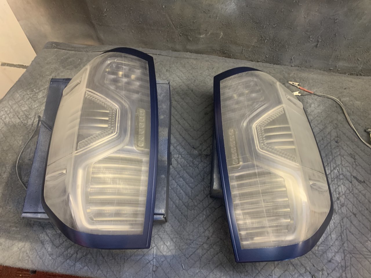

    The scary part. I sanded the lenses with 400 grit so the paint will stick. I masked the outer edge of the light, then painted. Later, the whole lens will get clear coat. IMG_8804.jpg IMG_8805.jpg IMG_8806.jpg IMG_8807.jpg
