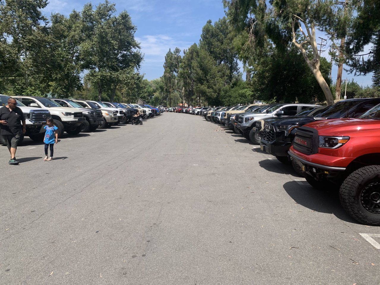

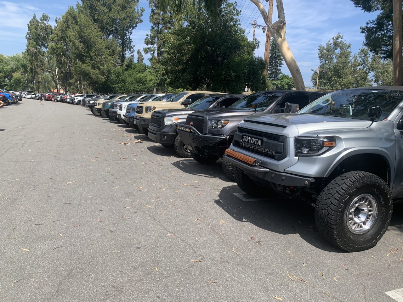

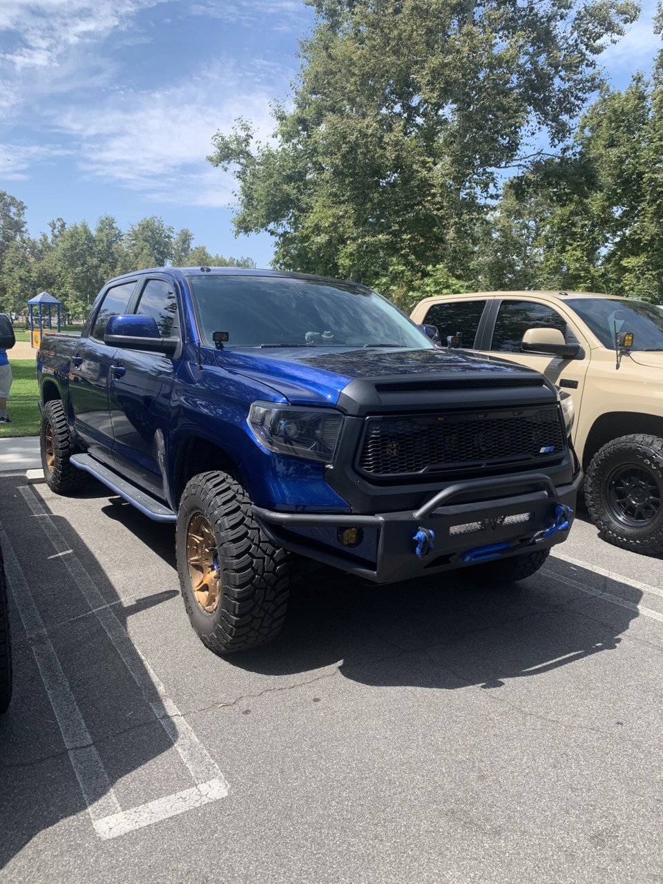

    At the SoCal Tundra Outlaws 5th Anniversary Meet. Tons of Tundras, awesome people and food. A bunch of vendors donated products to be raffled off and the cash given to The Ronald McDonald House charity in Los Angeles. Last year was $13,000. We’ll see what this year brings in. I won a raffle prize, Diode Dynamics SS3 Pros!

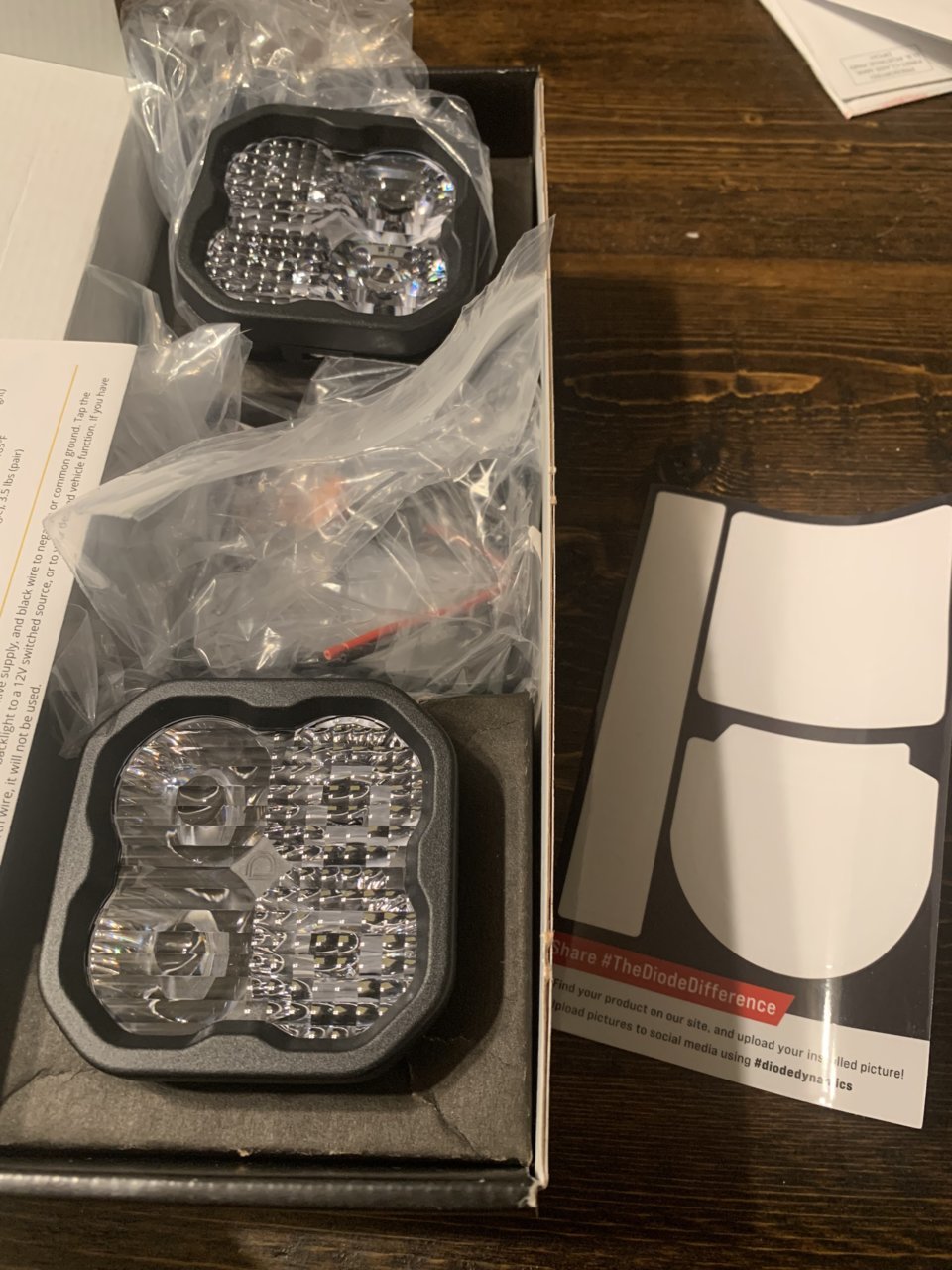

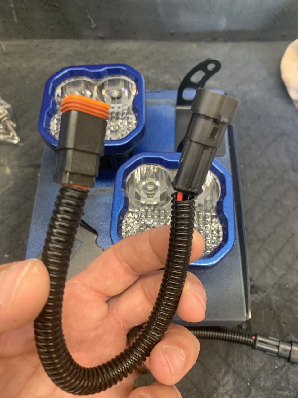

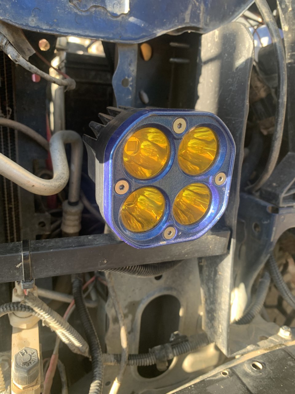

    Getting to those SS3 Pros. Sanded the bezels and hit them with self etching primer, then blue and clear. Took out the old cheapos and the SS3s plugged right in, I added a harness so everything is plug and play, no matter what I’m adding.

    I don't know man, I think you need more illumination and more things painted Blue Ribbon :rofl:
    Always awesome to see what you do. I'm sure you learned early on to make the harness universal so you didn't have to keep changing it out with new lights.

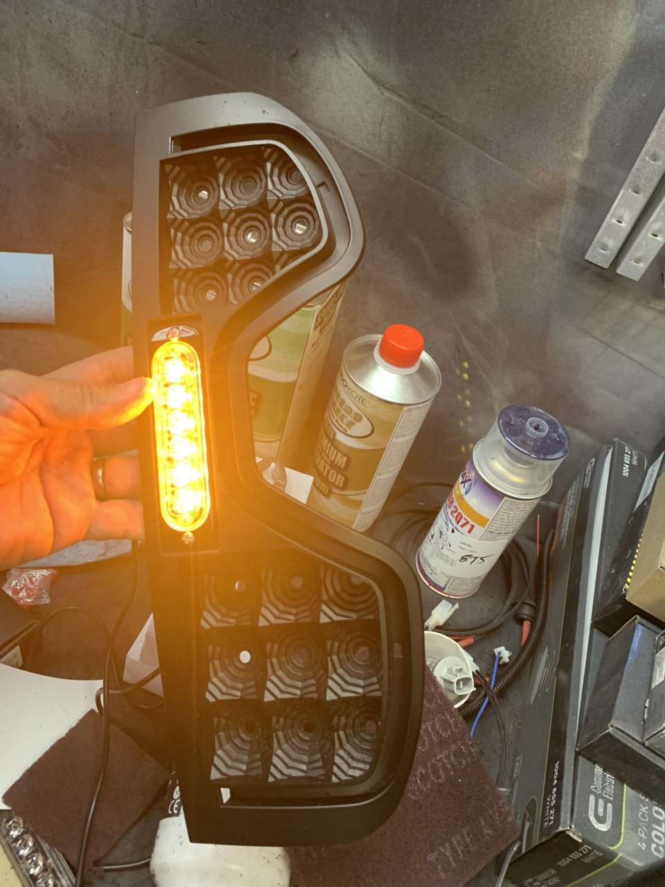

    Ready for another taillight build. My old ones cracked. I don’t know why, they’re just old? Maybe too many bumps and bruises offroad. Anyway, I got an excuse for new ones. So I finally got the lights I originally wanted. I ordered some chase lights to install in the housing, and then the color match will be under way. IMG_8712.jpg

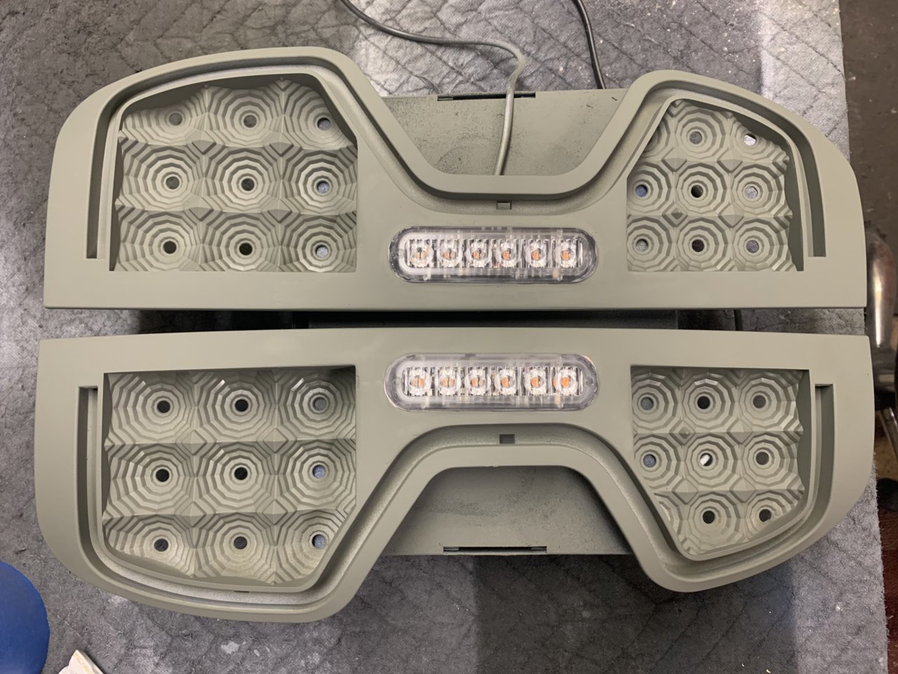

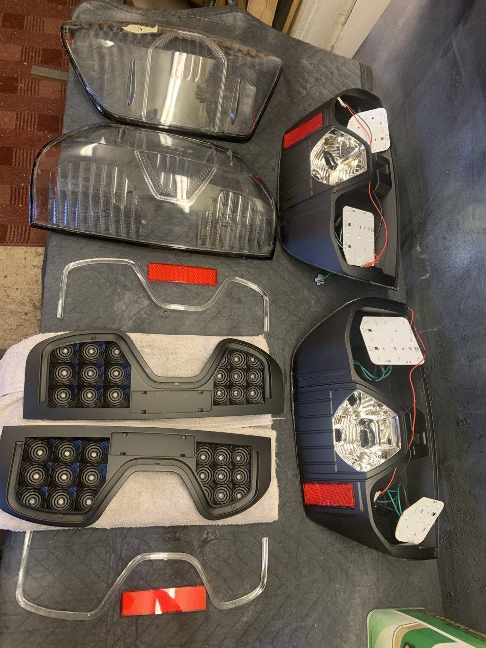

    Installed a water separator, received the California approved clear coat(ugh), got a new lvlp spray gun, and today got more 8T5.
    Cut the lights apart with the dremel, chase lights arrive tomorrow.

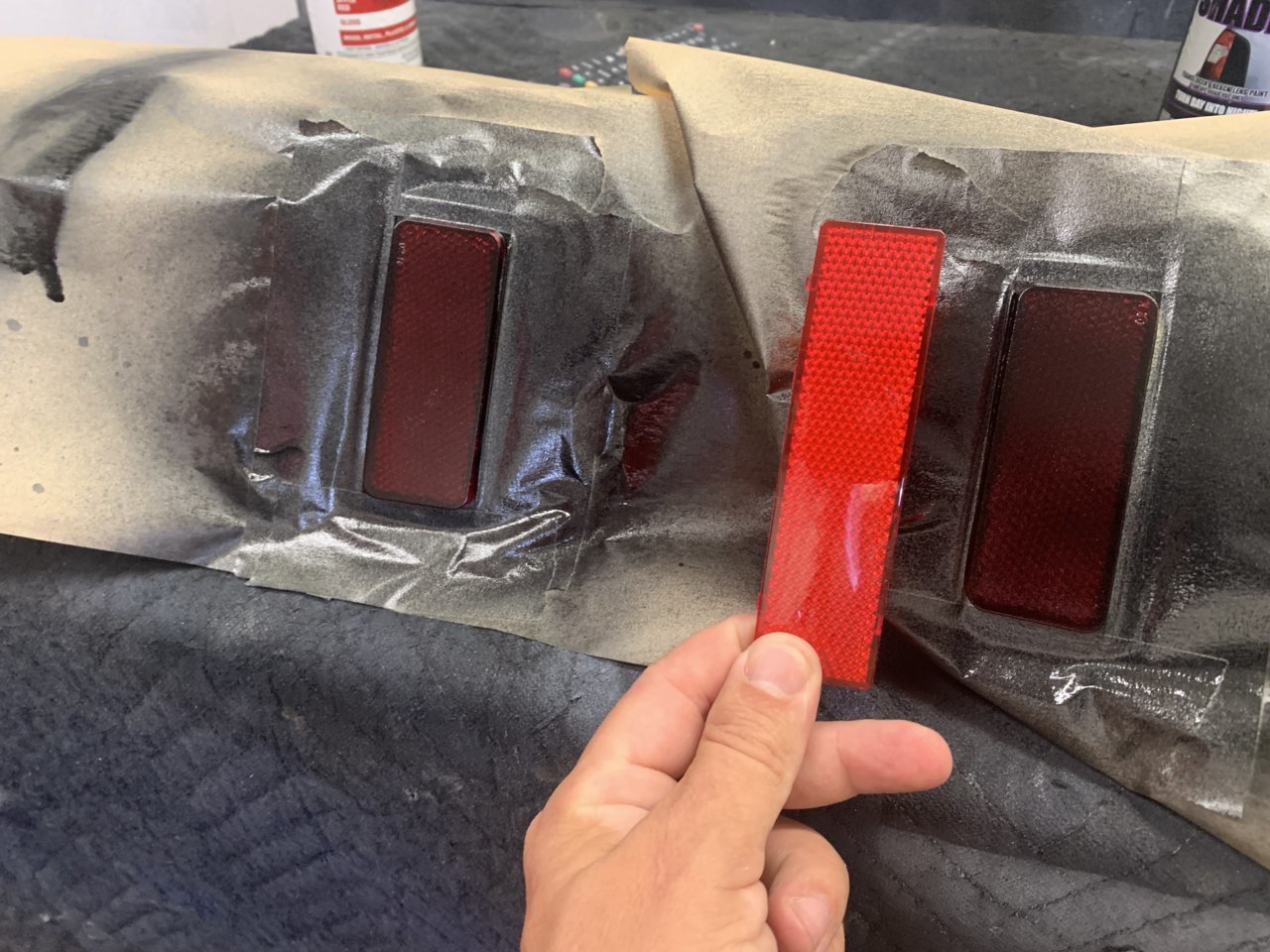

    Spraying the Niteshades on the side reflectors.
    If you haven’t followed my other lighting builds, plastic adhesion promoter is required to spray paint on the taillight housings. I have three plastic adhesion promoter cans.
    One is Bulldog grey (left), I bought this on sale when an auto parts store went out of business ($25).
    One is Bulldog clear (middle), I paid $50 at the paint shop last time I was there.
    Last is High Teck clear, from the paint shop because I forgot I had some. They let me know it’s the same as Bulldog, and I only paid $15. The paint shop clerk told me they’re a reputable company and it’s what they use, Bulldog is just a big, expensive company. I’ll be burning up the remainder of the Bulldog grey, so I’ll save the High Teck for later.
    Still waiting on the chase lights.

    The taillights are slightly bowed, so the flat chase lights rock back and forth. So I ground down the center of the plastic area that the chase light sits. After testing, I scuffed all the plastic with a red scotch brite, then masked and filled the voids with plastic epoxy.
