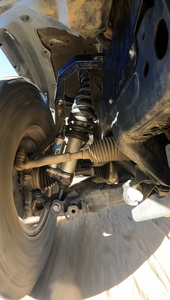

    2015 Blue Ribbon 4x4
    Yep! They eliminate a lot of the roll in the truck, and limit the travel. They’re great for on the road, twisty roads, and highway driving, especially with a trailer. But with them off, offroad becomes much smoother. I’m sure someone can articulate much better than I can.
    Wallygator, RobertD and TRDFerguson like this.
  3. Feb 9, 2023 at 7:24 PM
    #933
    BlueRibbon4x4
    BlueRibbon4x4 [OP] Let’s color match it
    Aug 16, 2018
    #18204
    3,476
    Geno

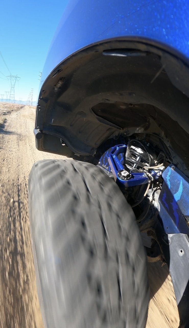

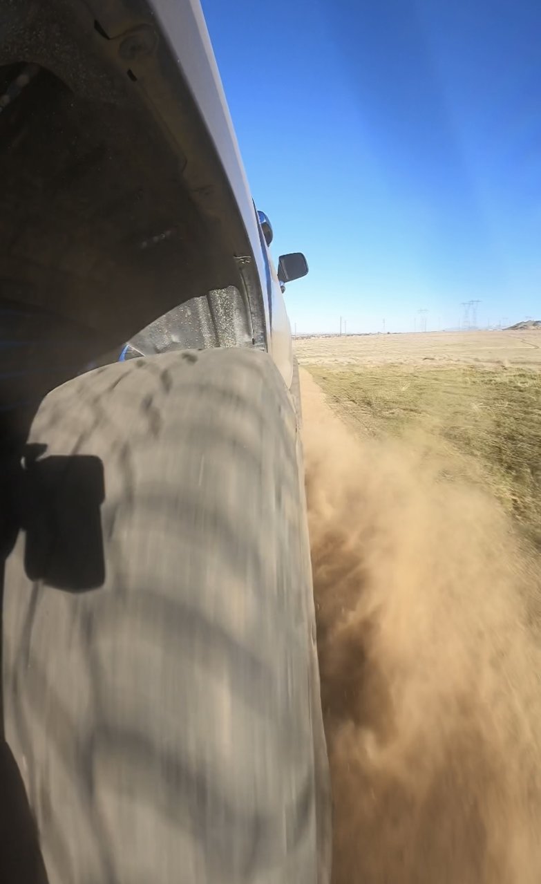

    Took her on a speed run and got some shots sans sway bars. Really bashed around, and the truck is so much more fun to drive.
    Also, 4LO is good to go!!!

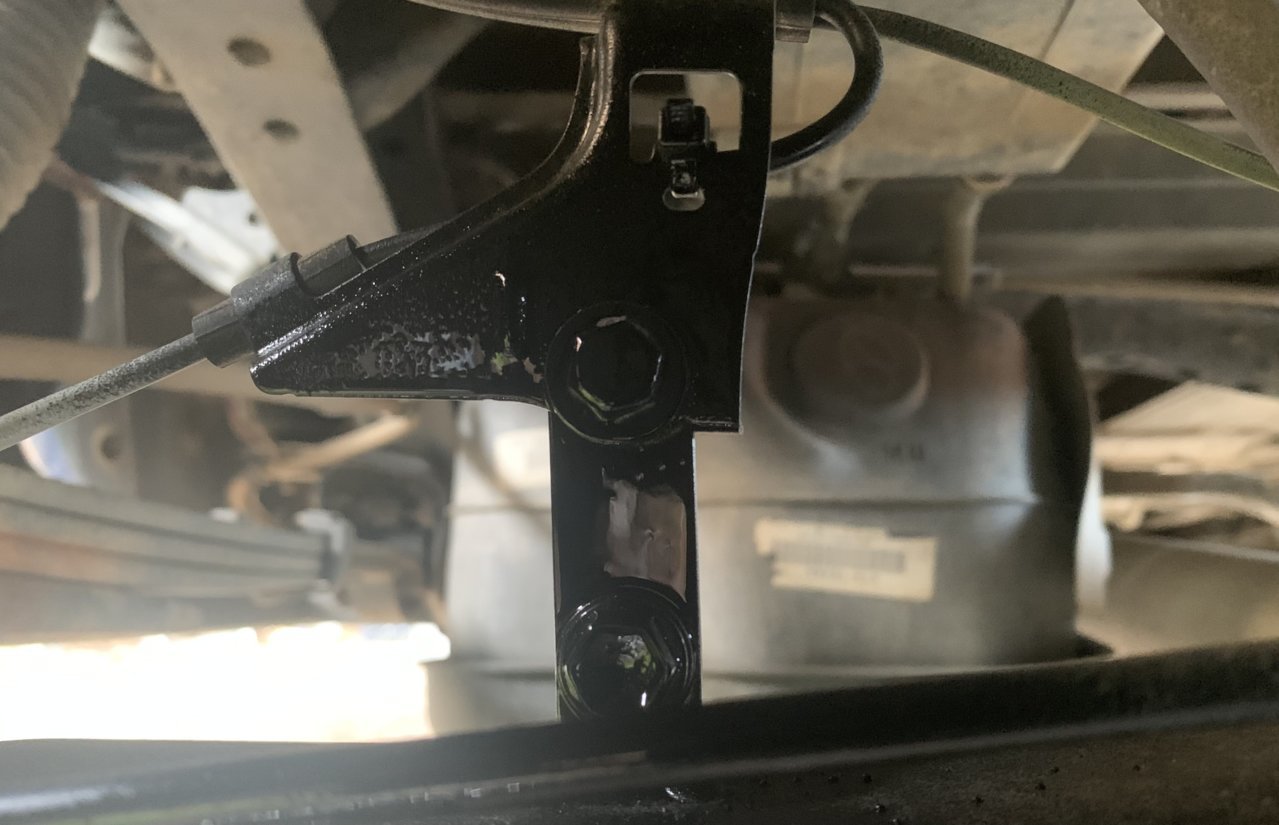

    15 minute peace of mind DIY. I never did the brake line/ABS extension kit. I just took some aluminum I had laying around and drilled some holes about 1-1/4” apart. Then flipped the two stock brake line brackets to the side.

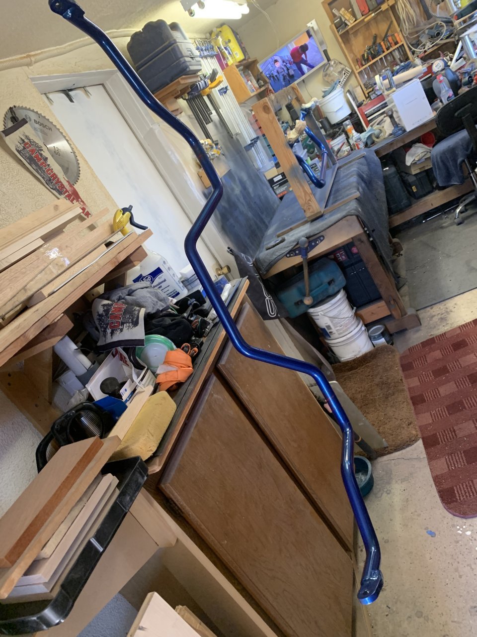

    Geno

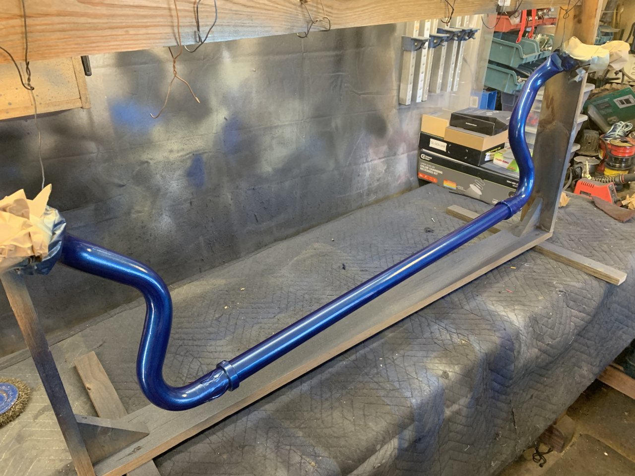

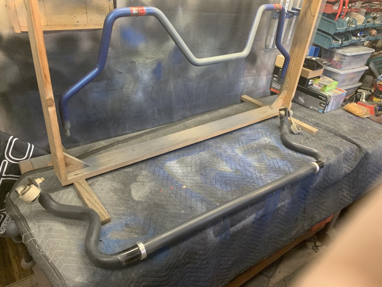

    Already getting to work. Had a list of things to do today, it’s nasty outside, so tomorrow the list gets done. Damn my shop is a mess.
    C24CAE29-179E-414C-9E7C-31B7FD0E8807.jpg 6F1152AE-7060-406B-976F-9E479CDC941D.jpg

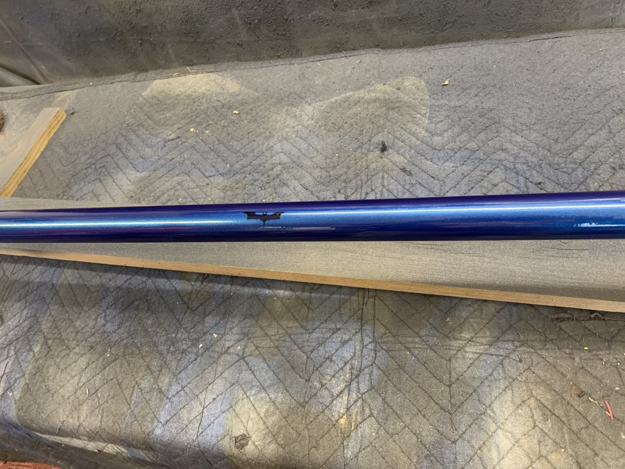

    Geno
    Not too upset that these are going back on.

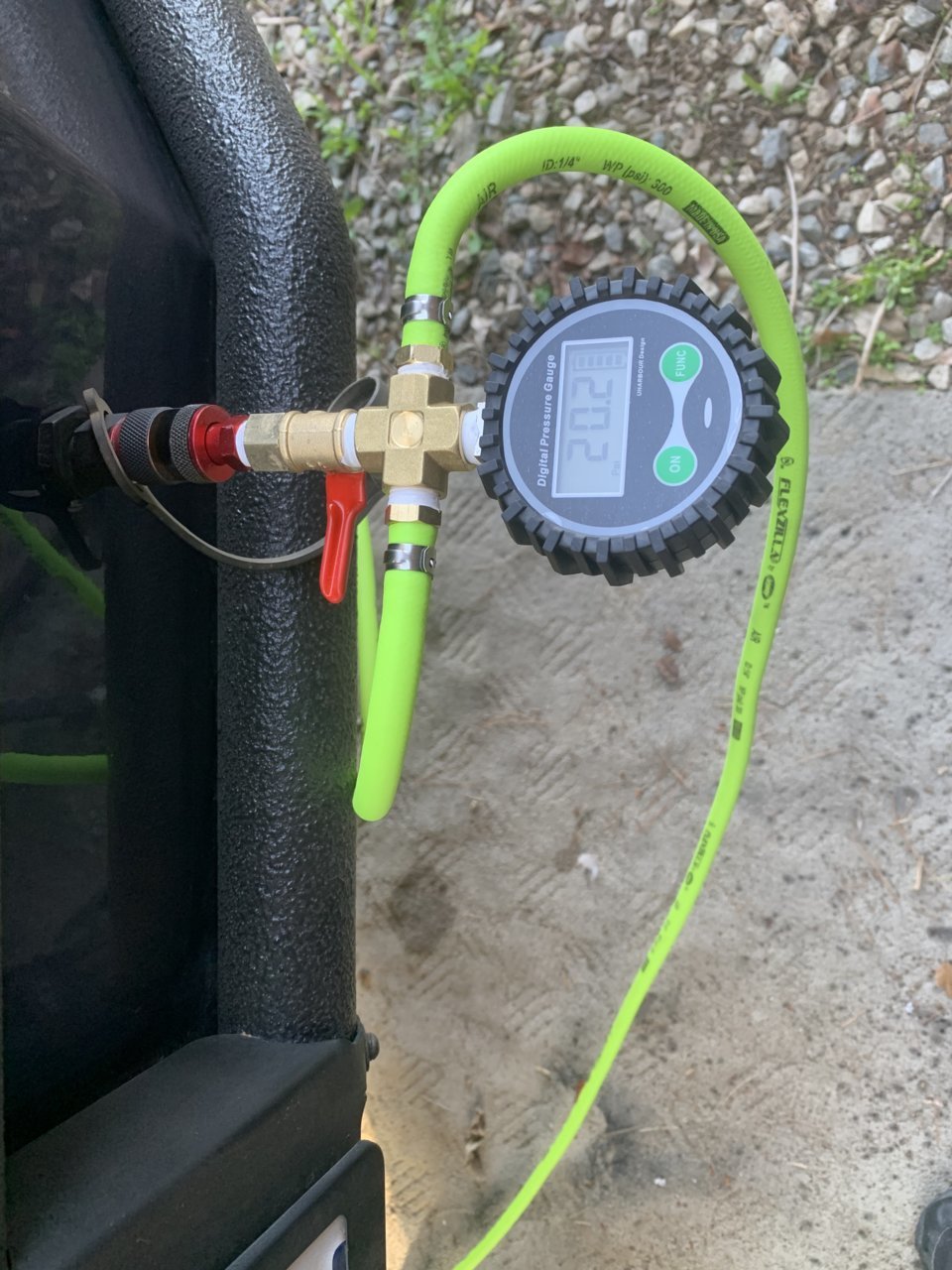

    Geno

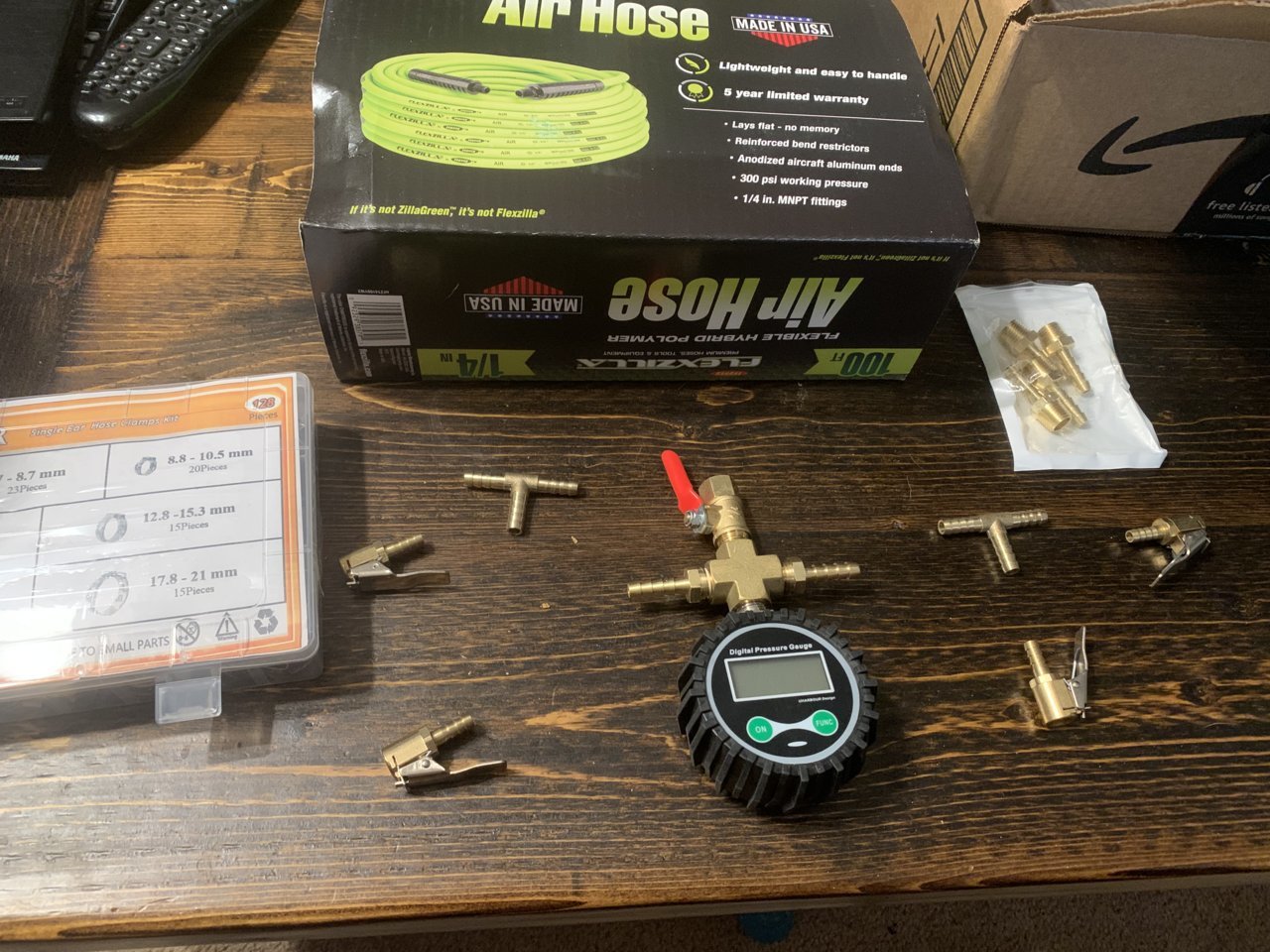

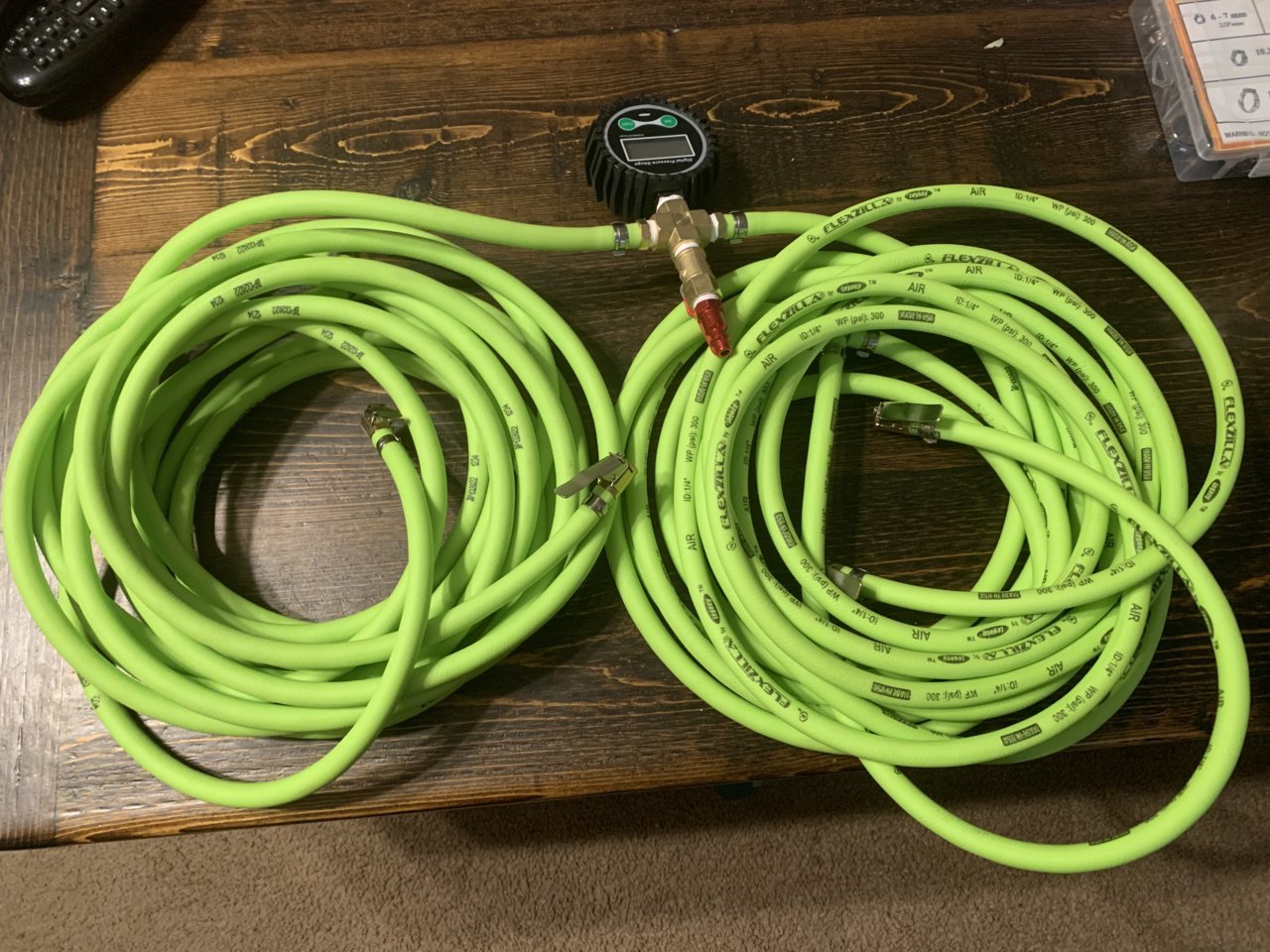

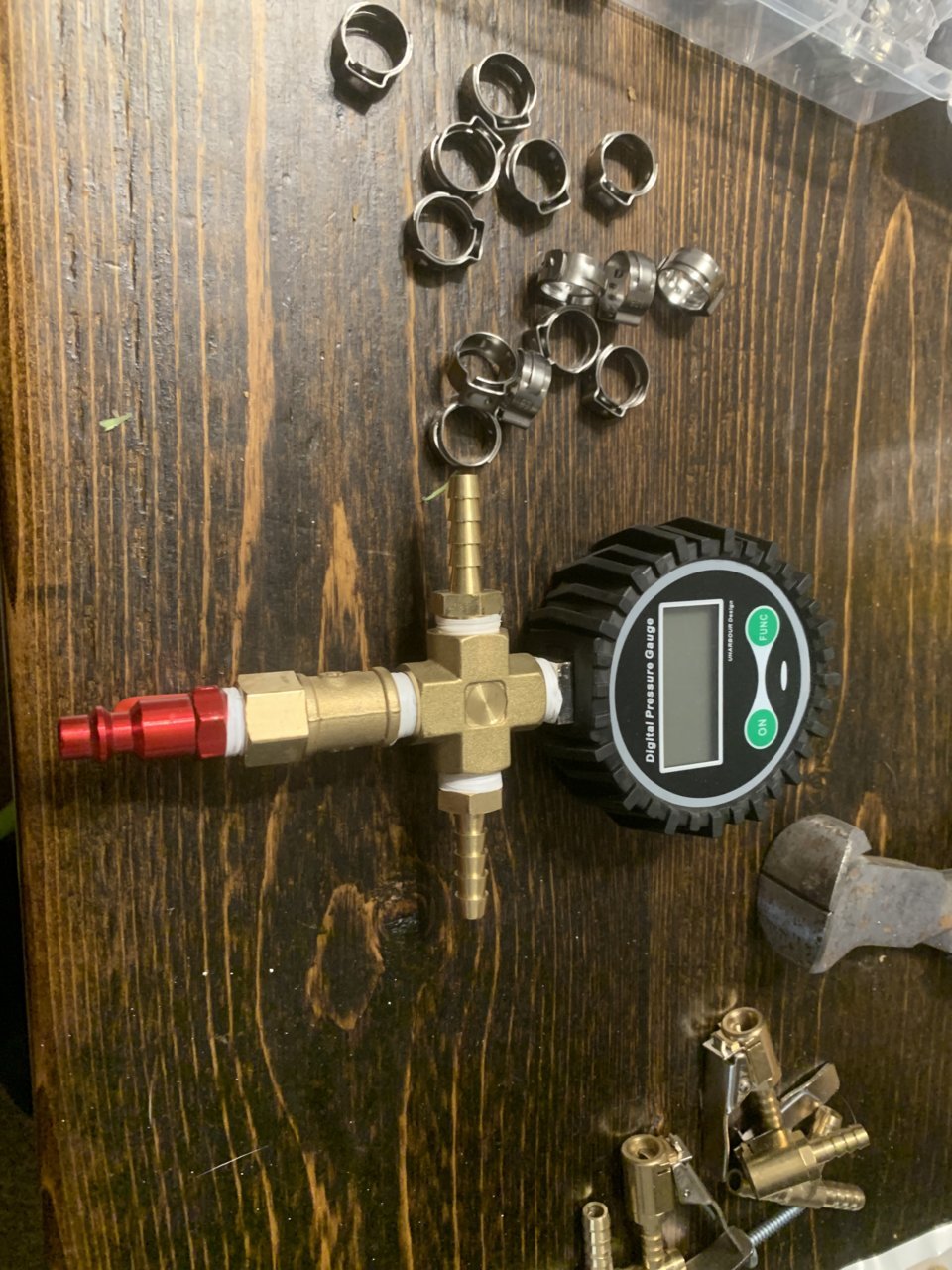

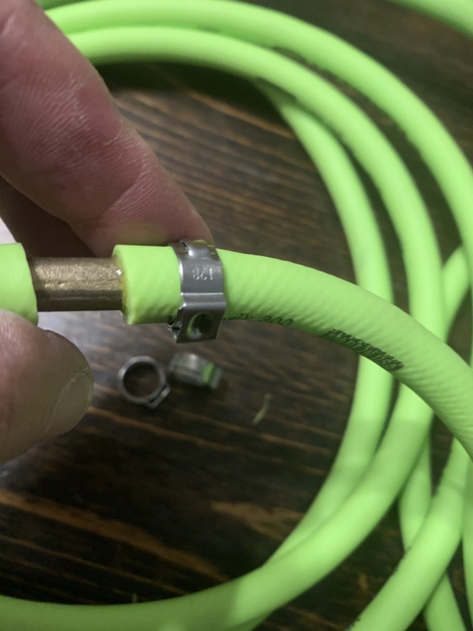

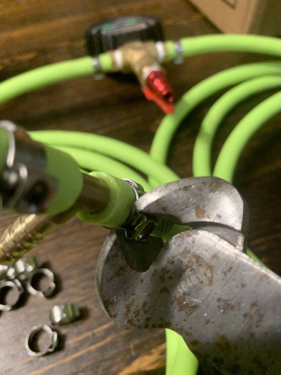

    Finally built a quick inflation system. Used a Flexzilla hose, a bunch of connections and clamps. This is the first time I’ve used these single ear hose clamps. They’re pretty awesome. Easy to install and won’t come loose. Just a simple valve to splitter, with an air gauge and air chucks. I filled all 4 tires from 18 psi to 38 psi in 7min, 50 sec. I used to do each tire separately and it would take around 3 minutes per tire, probably more. I never timed it. But now I don’t have to be out in the cold, or heat kneeling by a tire. Kinda dig it. Only issue is that I accidentally bought open valve air chucks, so the air comes out when they’re not all installed. So I’ll have to replace them with closed ones. But it works!!
    2777A577-D268-40C6-8485-15BD915ECE4D.jpg CE2C631D-F0B7-4419-A341-C80F000F5C11.jpg 93B752FB-63B8-40F4-A814-54D945B675B2.jpg 91059559-0ED0-46BA-9A82-3048E69D6CAD.jpg C52C4101-BD9B-4B6C-A258-A3FE9B9C4567.jpg C7C84AB3-CF94-447F-A1D7-80EA8DE407D7.jpg

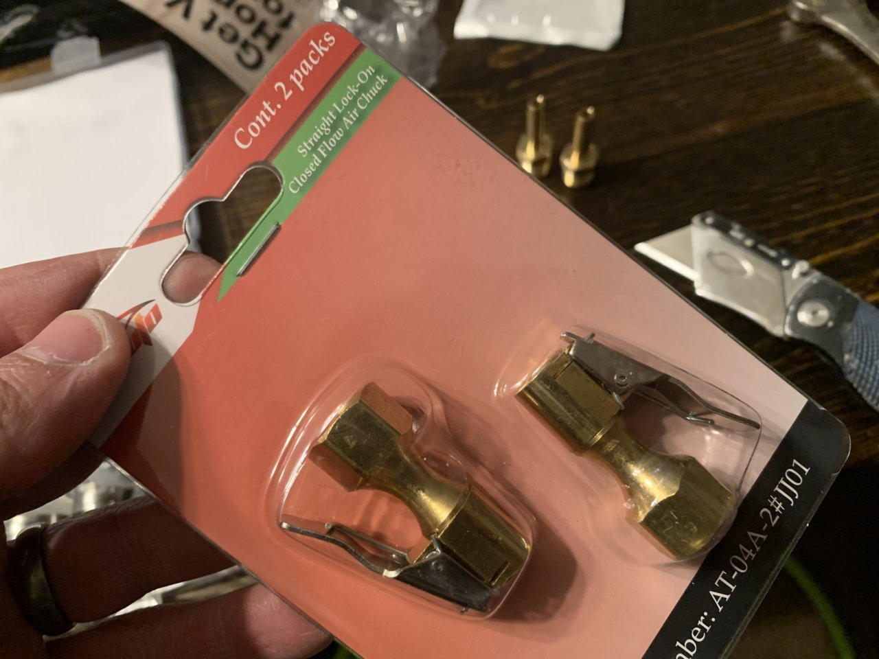

    Geno
    Replaced all the chucks with closed flow chucks. Didn’t even know they had open ones. 801B45C4-03B0-4A16-AB33-AAD15400534C.jpg54613424-251E-4702-A097-7E5943049DBA.jpg
    bulldog93, GAknight, GODZILLA and 3 others like this.
  20. Feb 16, 2023 at 5:16 PM
    #950
    TRDFerguson
    Oct 18, 2018
    #20730
    10,901
    Jake
    Southeast Greater Basin, AZ
    2018 MGM CrüeMax
    Definitely had to be careful when I was shopping for mine lol. I tried a different set first but they wouldn’t latch on the Toyota TPMS stems.

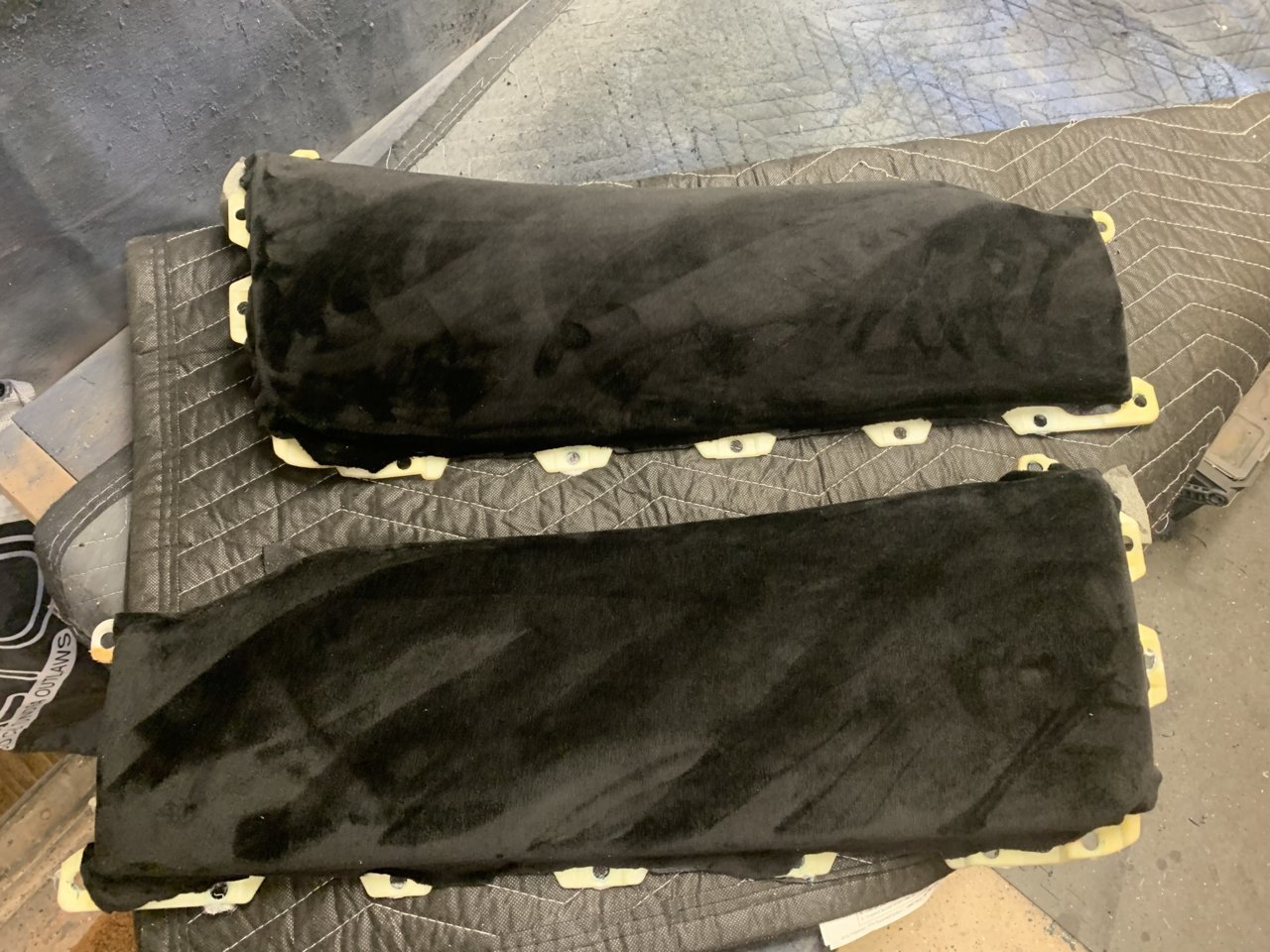

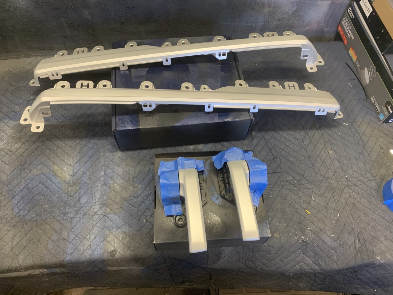

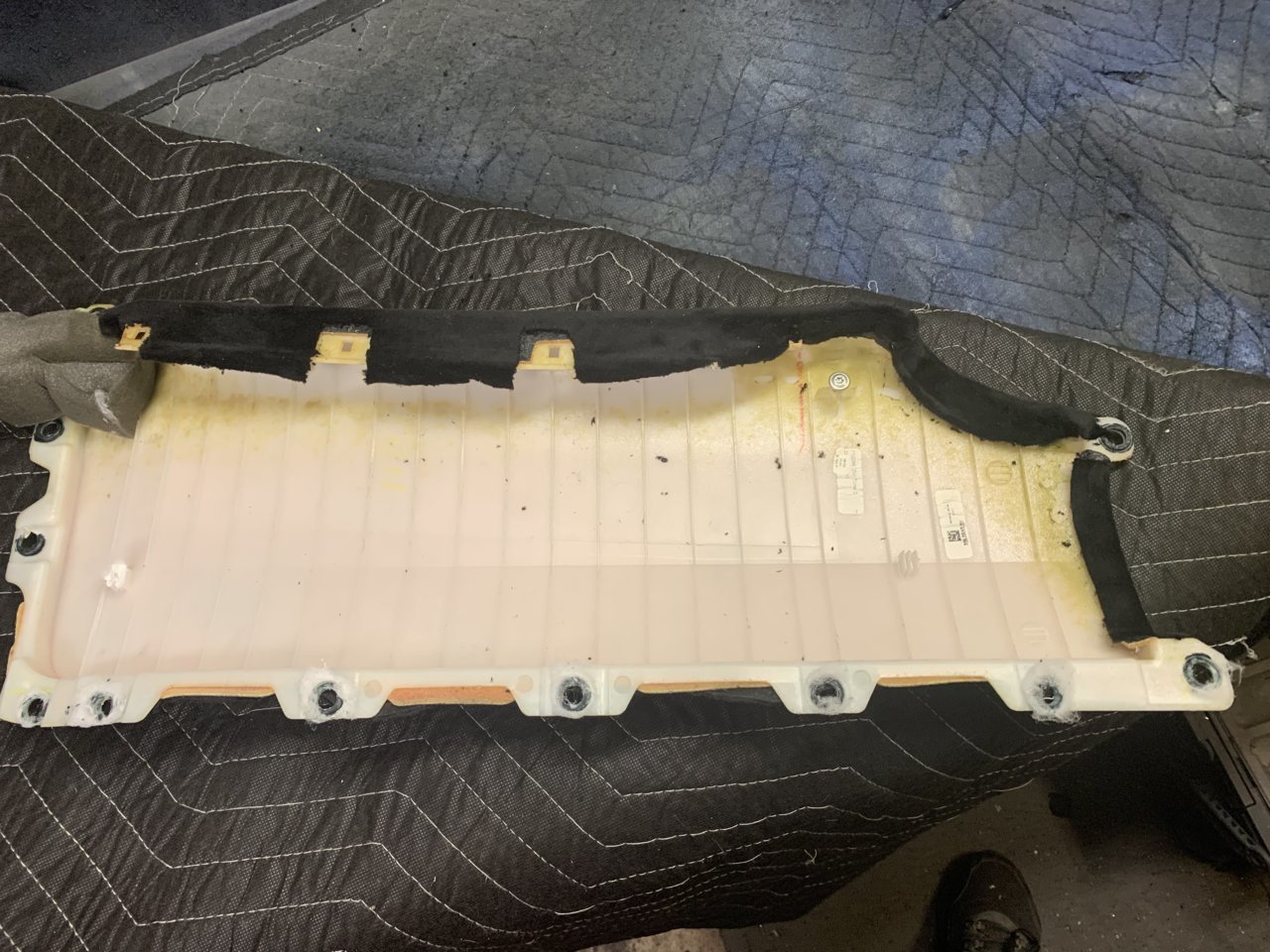

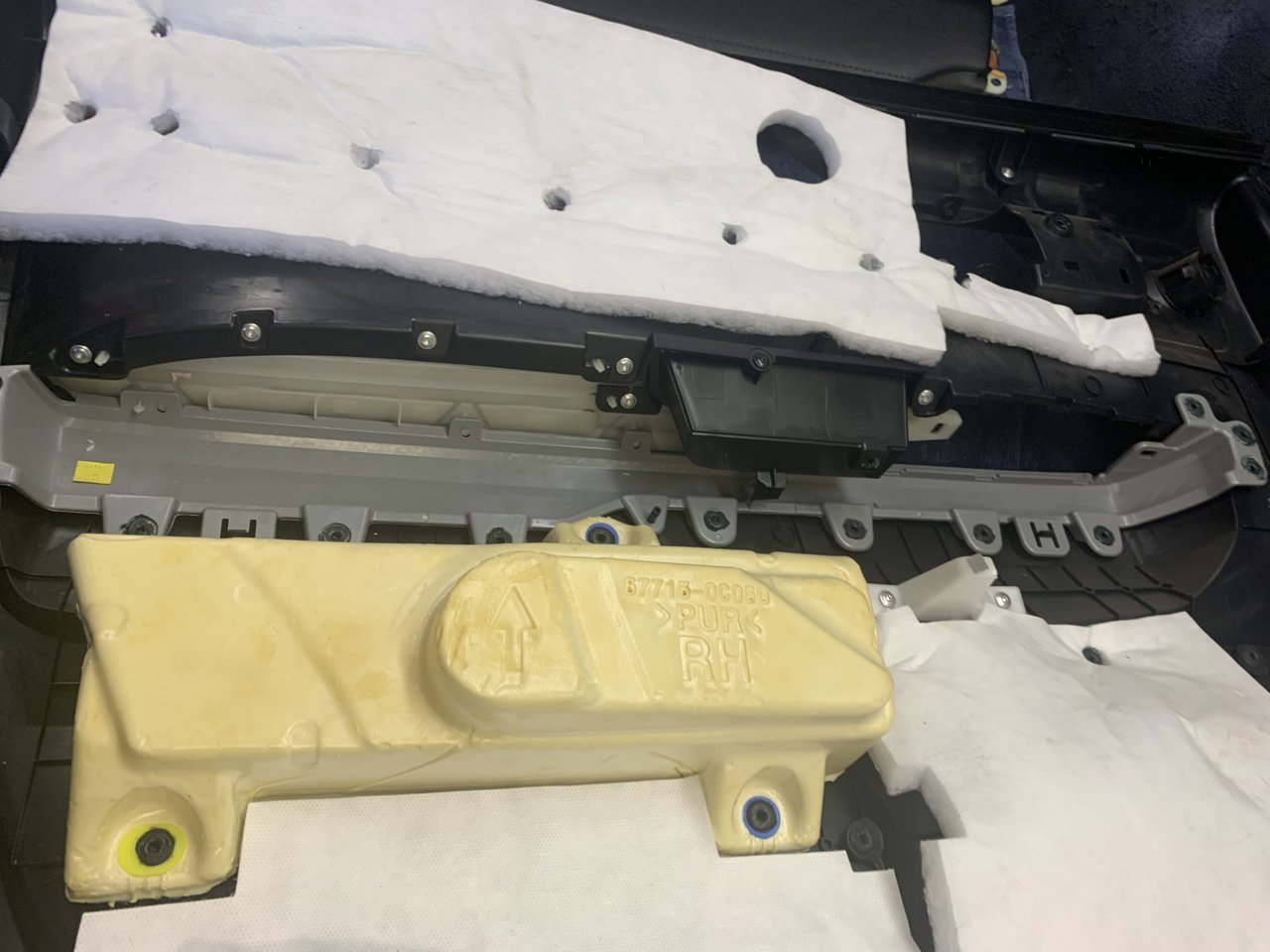

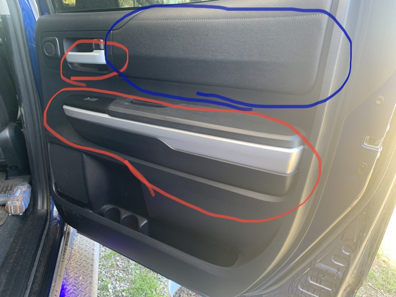

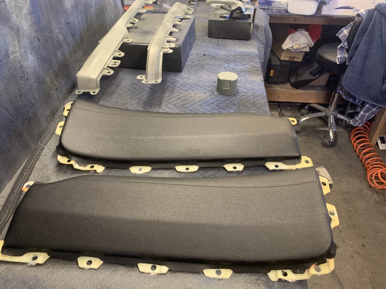

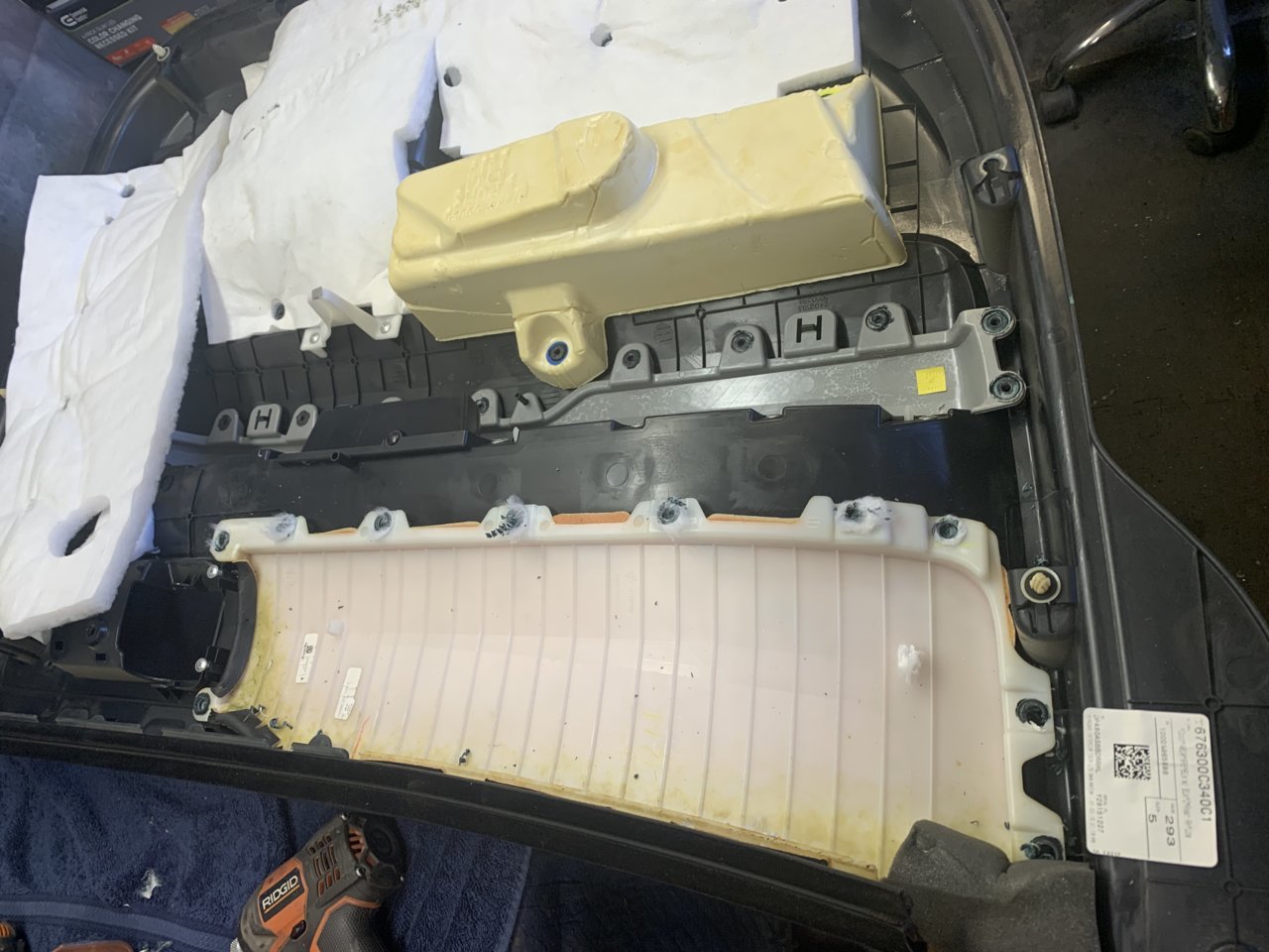

    Next project underway. The silver trim on the door panels still bother me. Just never enough to want to disassemble them and paint. But I saw a post where someone upholstered the soft panel as well. My plan is to later do something big with some faux black suede. This is just a precursor. The circles in red will be SEM black, and the blue circle will be black suede. I really considered blue, but on a large part I felt it would look cheap, so in tune with the rest of the interior, it stays black.
    I disassembled the rear door panels to release the silver strip and the upholstered panel. So far I’ve sanded down the sheen of the handles and strips, and sprayed with primer. The upholstered panels came out pretty much the same way, by drilling out the melted plastic rivets. My plan is to install the suede right over the faux leather, since the suede is so thin and the current stuff will act as padding. I used faux suede because real suede doesn’t stretch at all, and isn’t interior upholstery friendly. I think the best part of this so far is once my wife saw the suede, and I told her the plan, she’s on board. The change will be drastic later. The pictures so far are without suede on the panels.
    A6BA5789-68EF-4D5F-8D3C-72AE83576CCA.jpg 8393793D-8AD3-4CDC-B0FB-DDC36ADE42AD.jpg AB4D6B62-385E-4391-BB46-4D040A8F96EB.jpg 29388448-A585-4FBA-A65A-B4A0960CEC85.jpg 344E716F-1341-4E54-B138-0FCCE47BEB38.jpg 3AEDCA75-412C-4F14-9450-1BD32CDD480A.jpg 64F81B75-6C97-4256-9CDA-A30AE5050758.jpg

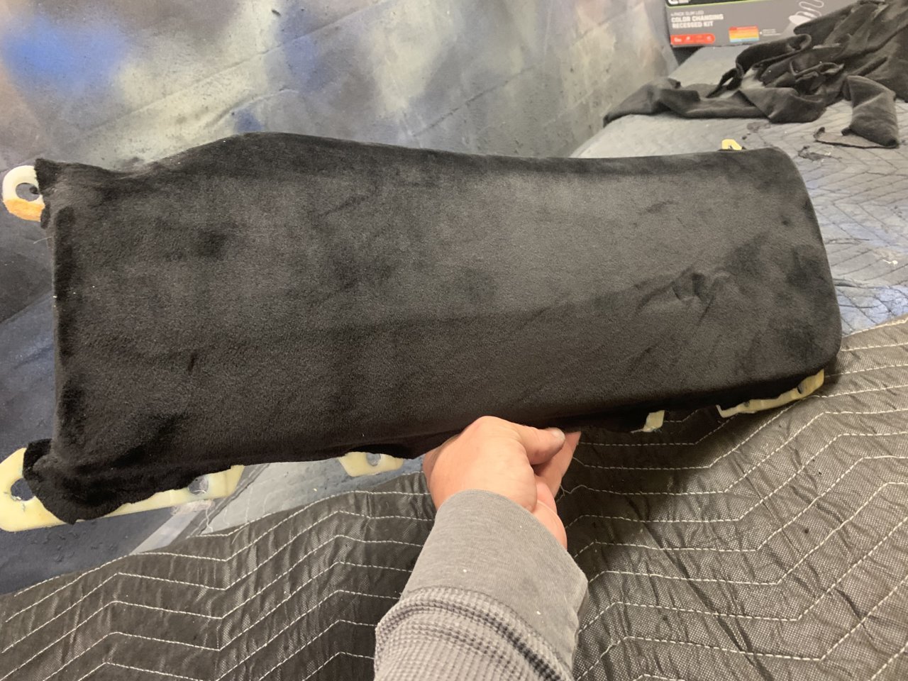

    SEM paint down, suede glued up. 6C4CDAB6-E9D4-44AE-A86C-FBC184DF2FC1.jpg04D5E305-F559-4253-83FA-6459409F27C0.jpgD1F0D30A-4C95-4417-B51F-860F5ED98A59.jpg0C15967B-3EA1-4F4F-A30C-D26C0575E53F.jpg11360D7B-FA97-4EAB-A2CF-50EC94380E32.jpg
