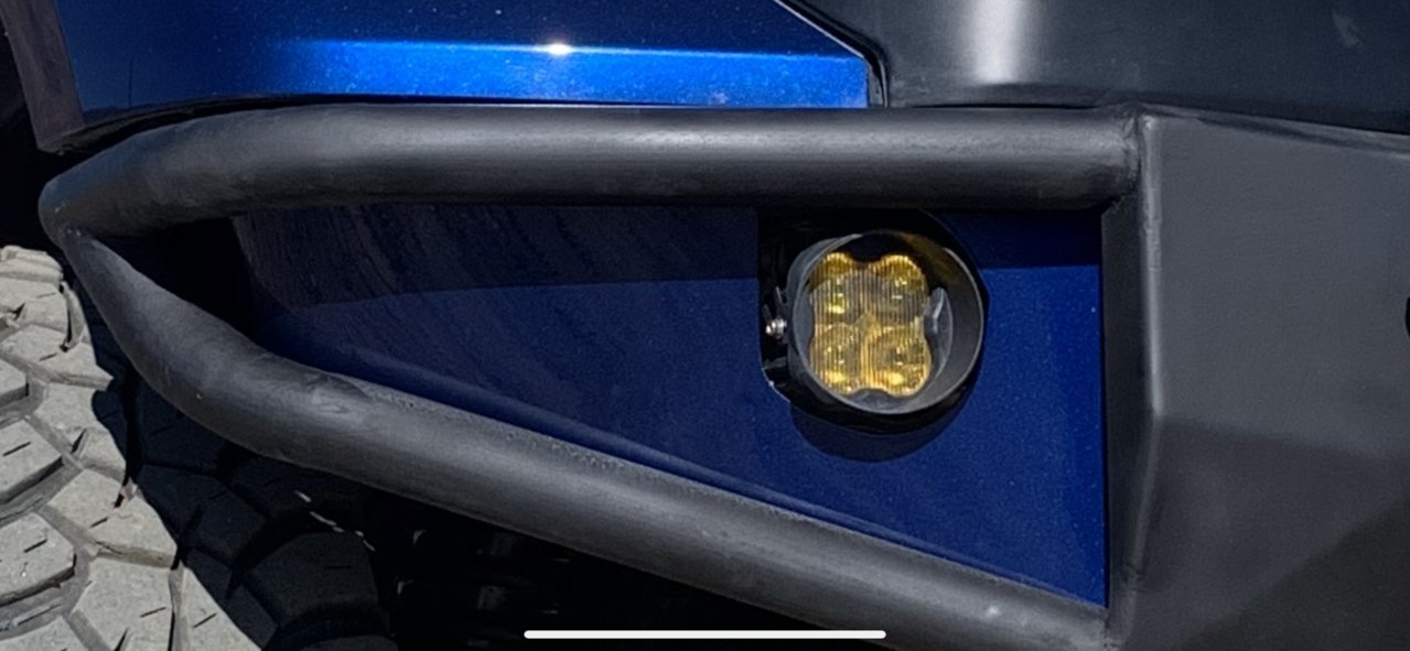

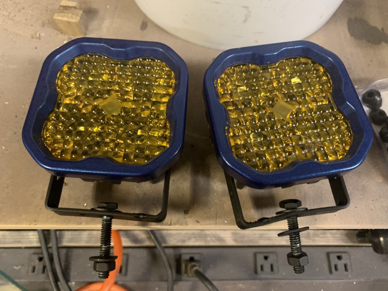

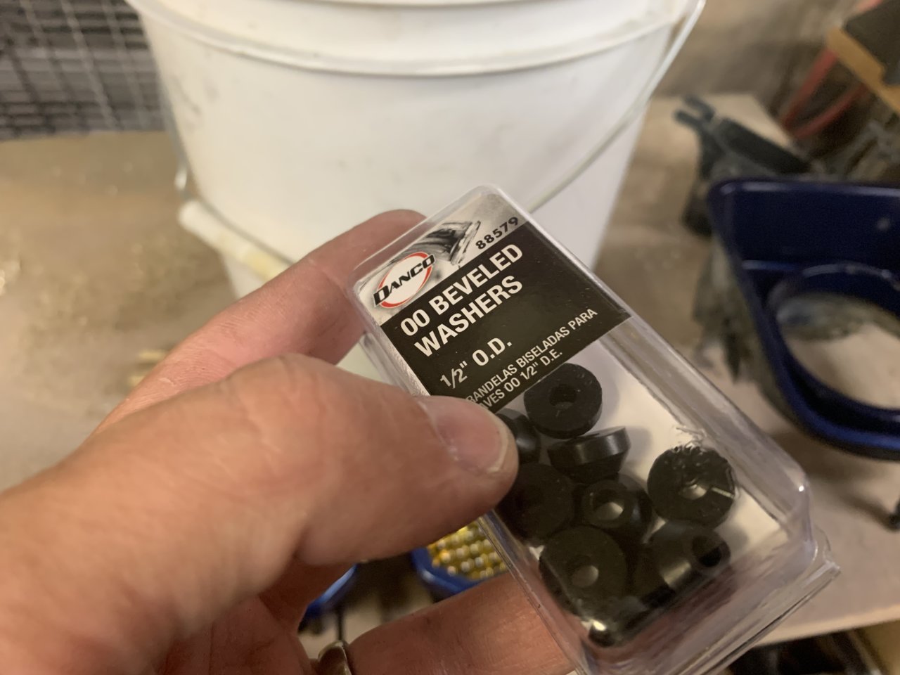

    Took a couple 2-1/2” angle brackets and trimmed and welded them back together for the SS3 mounts. Ended up almost the same height as the old ones. I almost bought some, they’re $40!! Alao, I used these faucet cartridge washers as spacers between the bumper tube and panels, so small dirt and grit can fall through.
