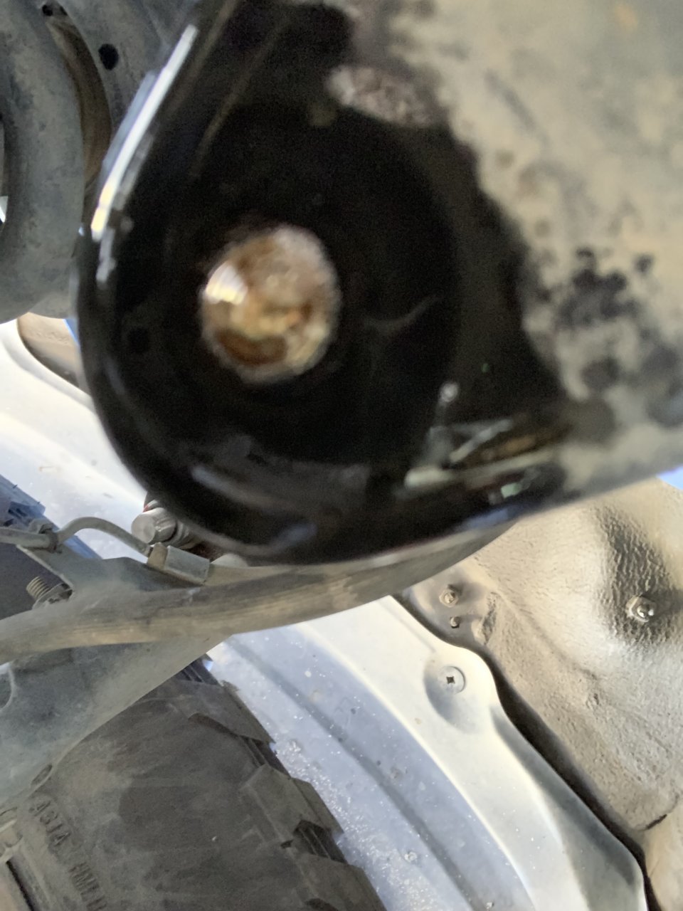

    Ordered up the Super Bumps, and tried removing the front bump stops in the rear. I used penetrating oil, and the driver’s side came off, but the passenger side just twisted right off the extension. Soft metal, I suppose. So I’ll drill it out and try an Ez out. If I can’t get that to bite and remove from the thread locker, I can always drill a bigger hole, weld a new nut in there and install the super bump. 795BD612-77BE-4393-B82B-3BAB758E2F2E.jpgD3E82856-5294-4A34-8633-DE2029417C47.jpg

    Well it took most of the day yesterday to try and get the broken stud out of the bump stop mount. I broke two EZ outs, and when I welded a bolt to the stud, I actually broke the bolt and had to cut it off. So I ended up drilling it out.
    Today I matched a 10mm x 1.25 pitch nut to the bump stop threads and welded the nut to a 10mm x 30mm washer, popped it inside the mount and welded the washer to the mount from underneath. Voila, back in business for when the Super Bumps arrive. 986AF3B9-9C69-44CA-BBA9-A3D1D7A72E34.jpg 2B198F5E-2D39-4E22-9AD8-568AF6D336EC.jpg F0994199-C2B7-4E5E-A373-26A5983D084B.jpg C1003067-8546-4652-A95F-81EC50068296.jpg 1842D8C7-92DD-4C9A-90E6-66EAD5FA3D35.jpg
