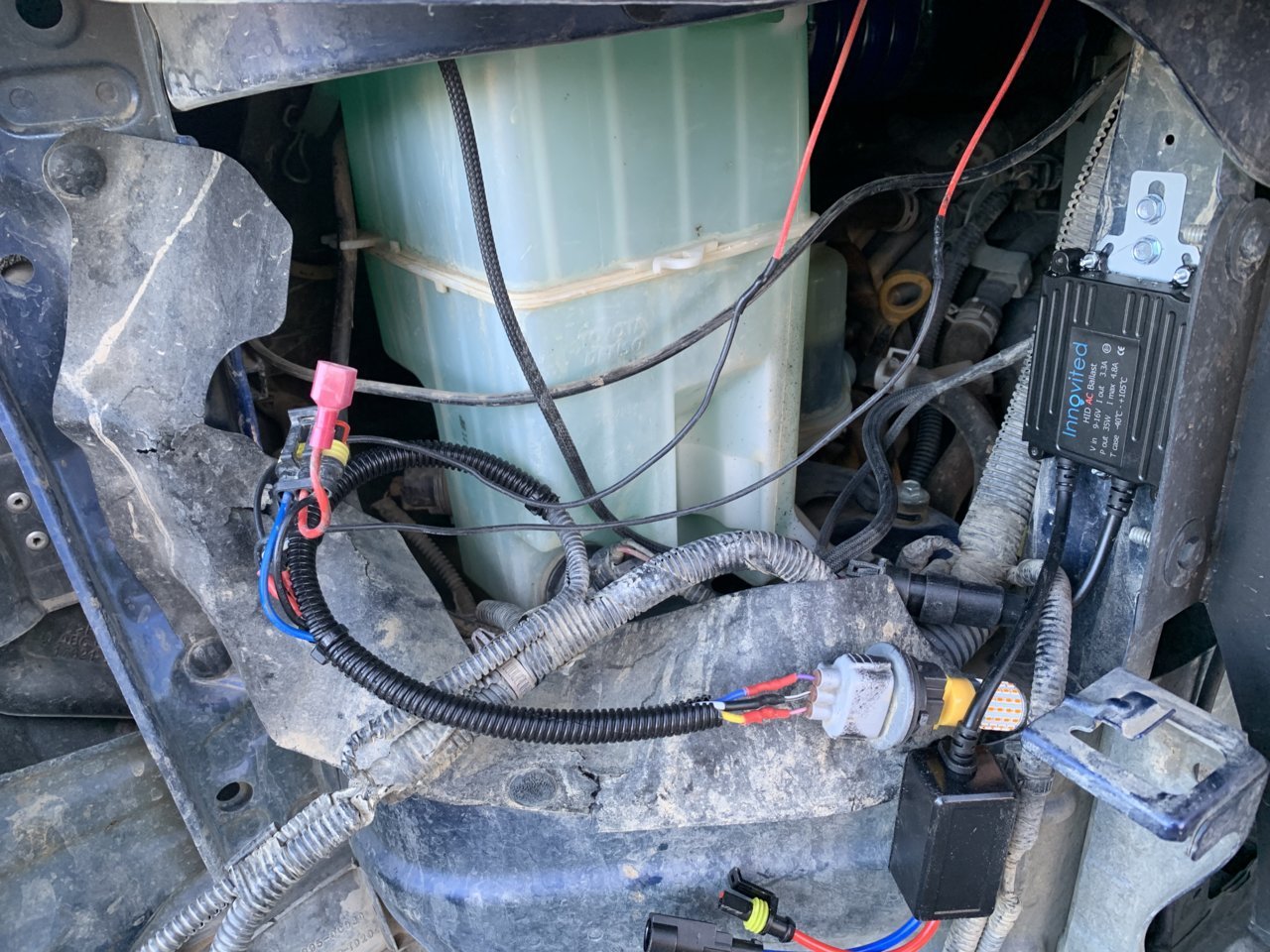

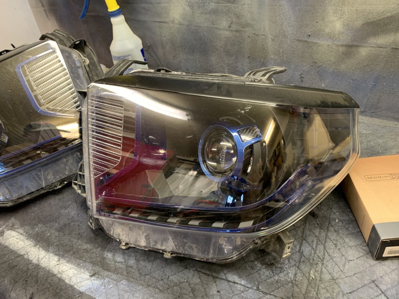

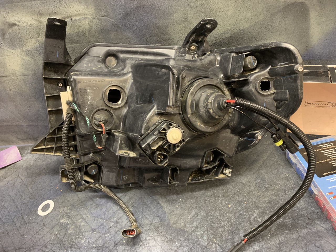

    New Morimoto HIDs going in. Got a pic of all my cleaned up wiring. No more T-taps, all soldered and shrink tubed. Looked like a ton of wire before. BE6C2002-C1E4-4718-8B59-42A0FEB58D96.jpgE6EF7540-4B80-4C2C-B0DD-3752AB71646B.jpg7FE0347A-BF76-4C13-9A59-44A265D17E5C.jpg

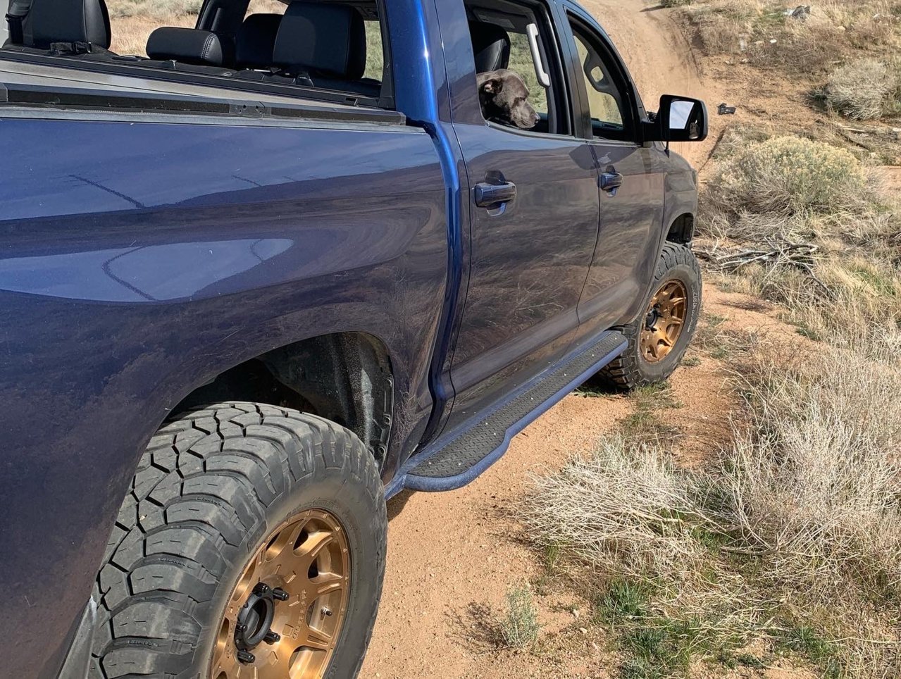

    Yep, @RobertD is correct. White Knuckle off-road steps, the larger DOM 1.88, and top step plates. Color matched Raptor liner.

    Got a supervisor watching over the solder joints. Check out the back of the retrofit headlights. No bare wire, all harnesses and loomed. No extra openings and headlight boot is in place. There’s no need for patches that let moisture in/out if everything is sealed correctly. The stock turn signal and side market get connected back on the truck.D1CEDBBC-51B0-4261-8FF8-0B1A2002E1CA.jpg2032604F-3742-40F6-A4AE-8024CC9CE96C.jpg39364CB6-D111-4A16-88A9-9AB3B1675321.jpg

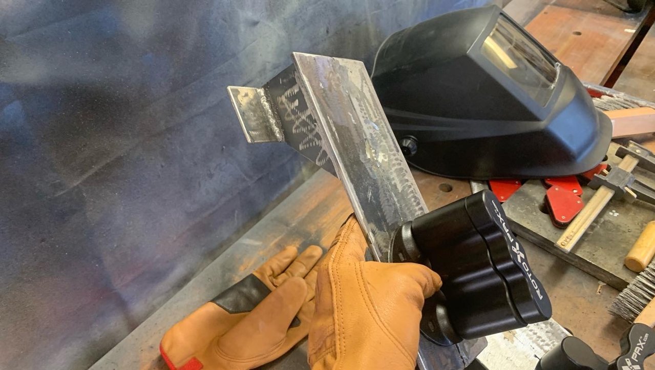

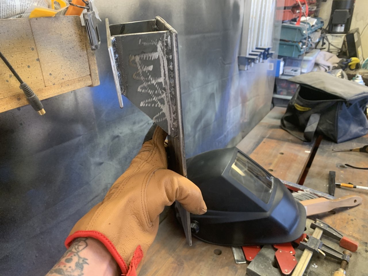

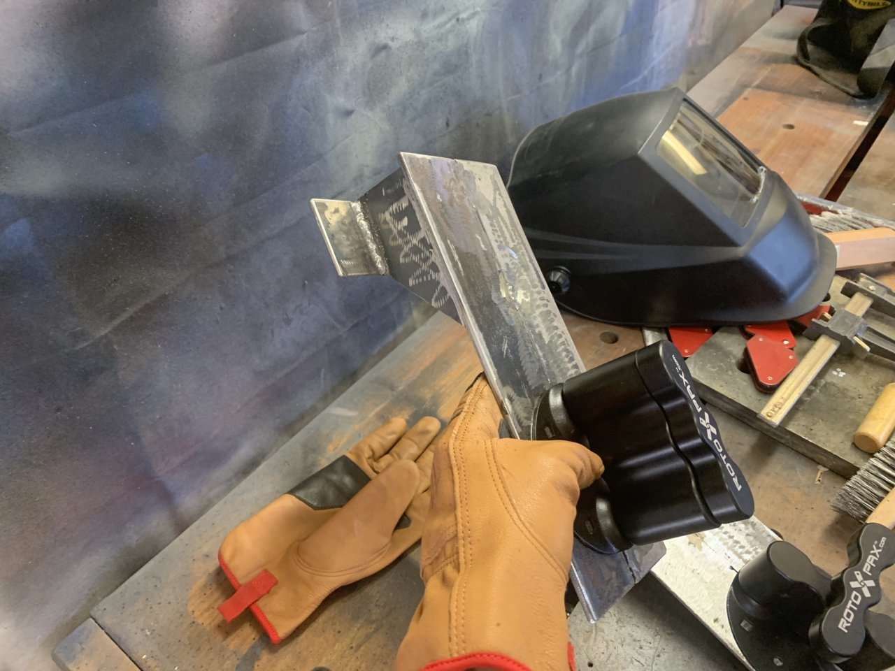

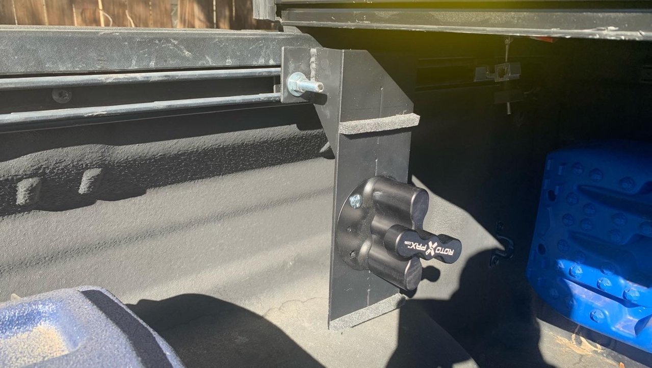

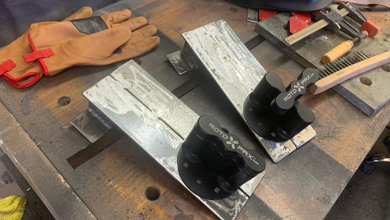

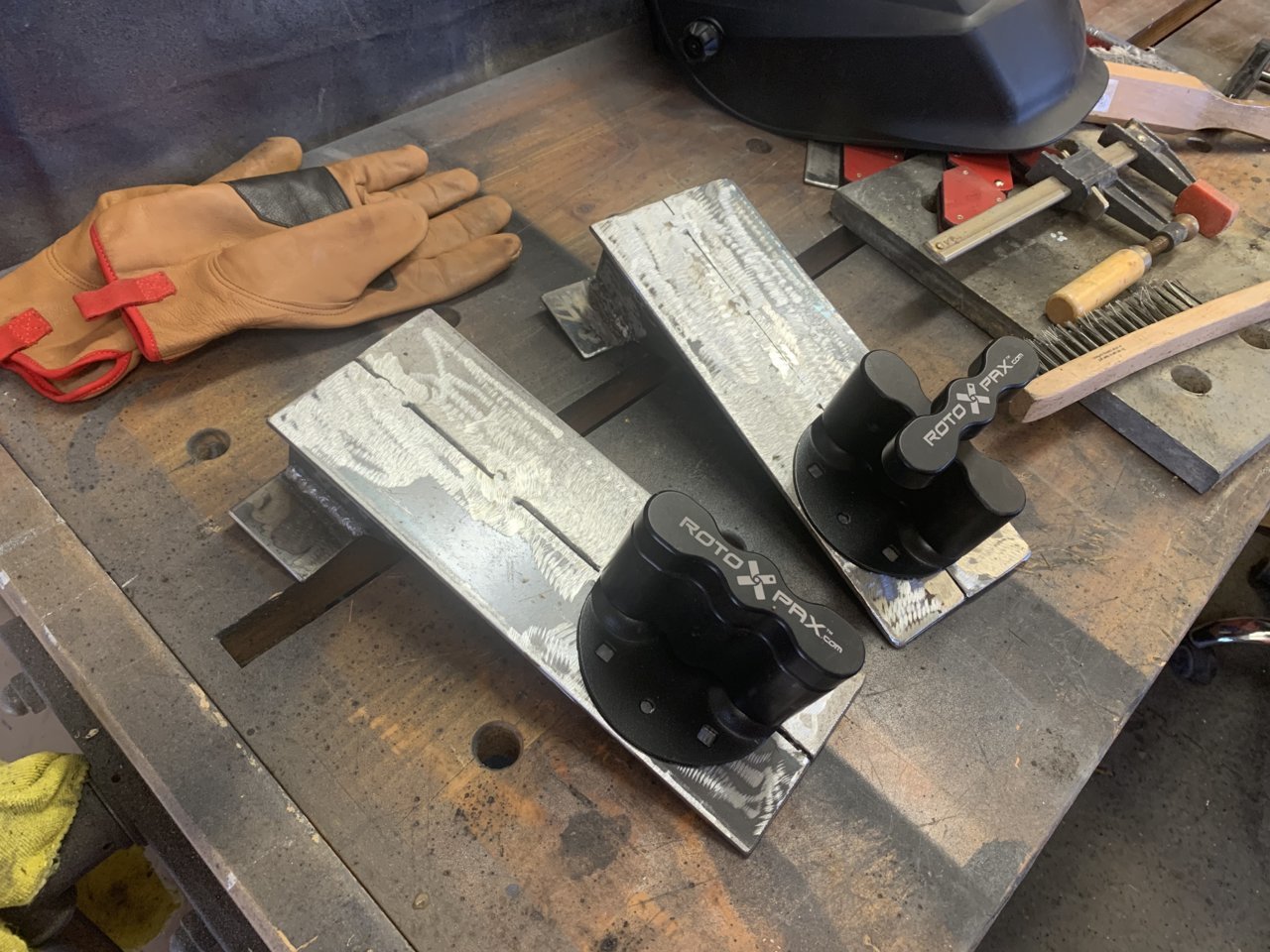

    Am I a welder? Hell no, but I think I’m getting better. Started on the mounts for the Rotopax canisters. They’ll get mounted to the deck rails. They have to be pushed out from the rails a bit to clear the brackets of the tonneau cover. D5BCBCCD-5163-476A-801B-E1CE67B2DD5F.jpg84F106A4-50B8-4A68-9AF7-D2F2B5801F99.jpg1D0BB100-7D08-4032-A5A2-3D0530CE3B62.jpg

    2015 Blue Ribbon 4x4

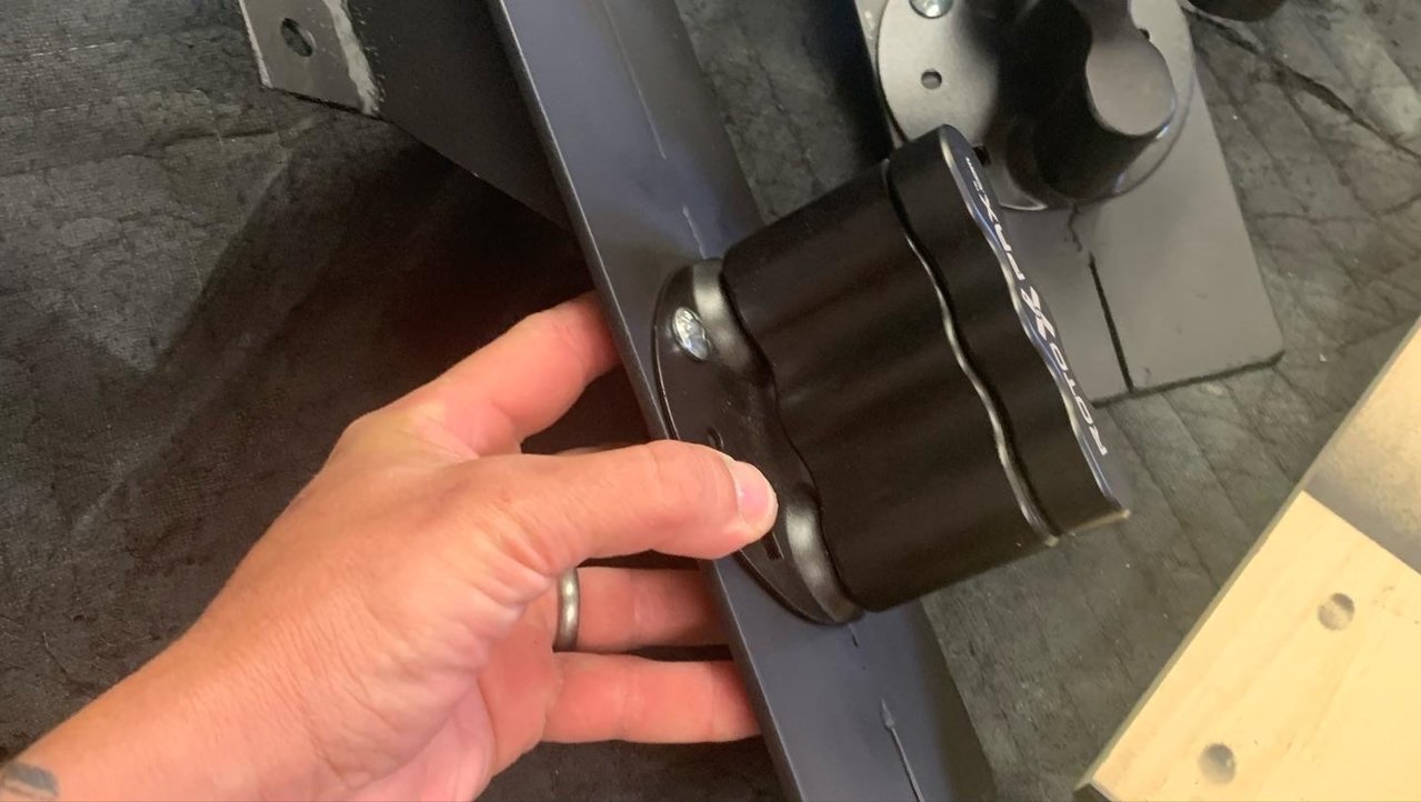

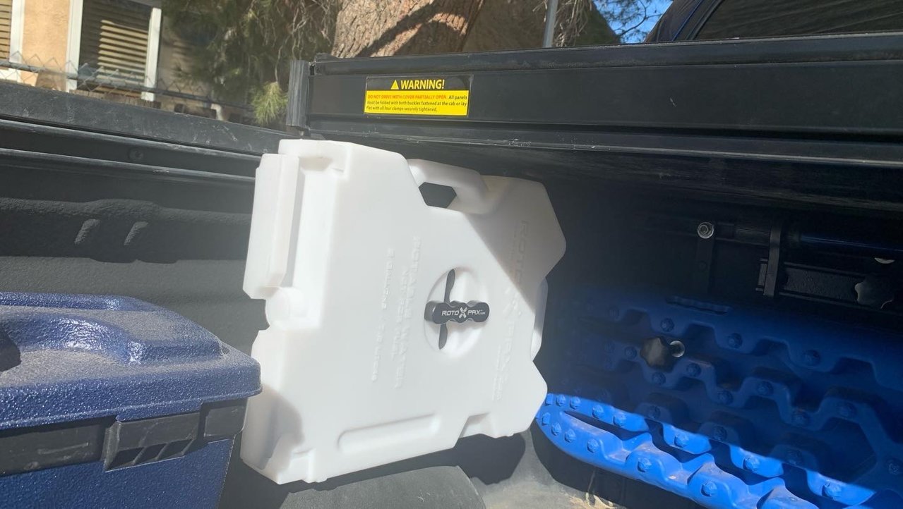

    Fabbed up some mounts for the Rotopax I got a while back. Had to be made to push past the tonneau brackets and wheel arches. 90BBC749-A17E-4120-8B61-4707E20A36BE.jpg 633C4B8D-C30D-4E78-8DC0-E62008622D8D.jpg 53EF576E-0783-4460-A5B3-EA7852F478D7.jpg 96E61CE3-D7D7-496B-BC23-97138B3F709F.jpg 116BACE3-2C49-465B-94F9-4D5DDC5D08B8.jpg 8EF42551-4299-4D4E-BB61-7DB9CE20E745.jpg

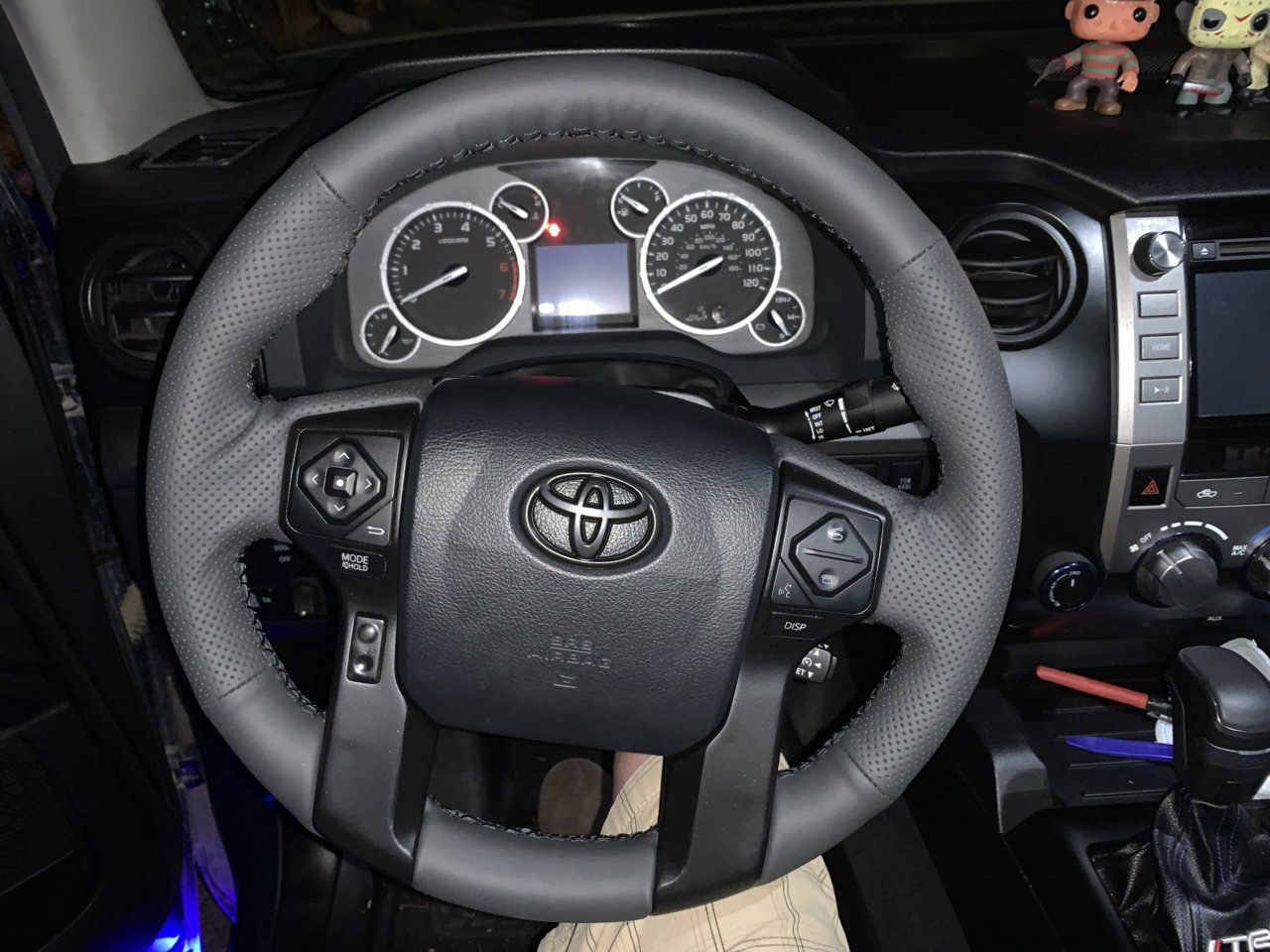

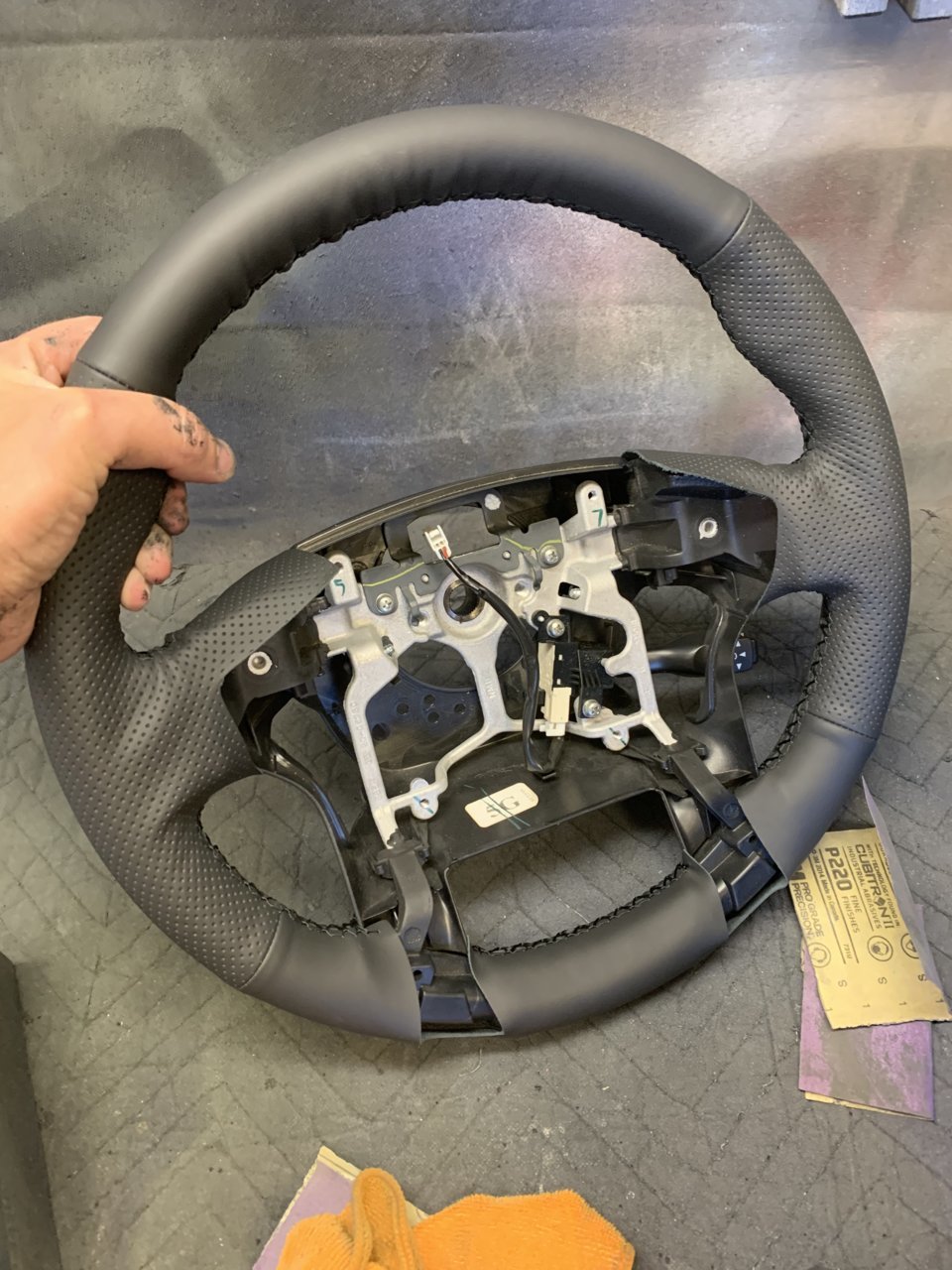

    Third time is thr charm for this damn steering wheel. I’ve tried two other times sewing the Lonky cover on. I’m horrible at it. I don’t have the patience for it, but man did I want a leather covered wheel. I hunkered down and did it today. Is it perfect? Nope. I’m happy with it though. I stripped the trim pieces and repainted them, and plastidipped the logo. I’ll reassemble them tonight, and tomorrow the truck goes in the shop for a damn front end clunk that I can’t locate.

  25. Mar 6, 2022 at 5:59 PM

    RobertD

    Robert
    DFW, Texas
    Looks good! Makes me want it even more now. Can't wait to see it all back together :thumbsup:

    #536
    BlueRibbon4x4
    BlueRibbon4x4 [OP] Let’s color match it
    Aug 16, 2018
    #18204
    3,534
    Geno
    Thanks Robert! Got her back in. Looks as good as I thought I’d be able to get it. Haha!

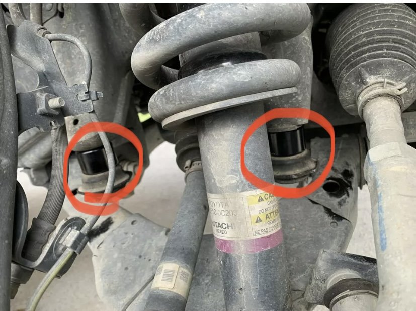

    Just a friendly PSA. I took the truck in to a shop because I’ve had a mean clunk every time I go over a hump or crest or driveway. I thought something was busted so I looked at everything that could leak or break. Turns out it was the bump stop extension on the front side of the LCA. Both were hitting going over the smallest bumps. They were hitting so much that they wouldn’t come out, they just broke off and left the threaded pin. So I’ll replace the back ones with duro bumps, and it should be good to go. Photo is not my truck.

    I was going to say, none of those parts are Blue Ribbon!

    How big of a lift are you running? Those are huge bump stop spacers.

    I’m at 2-1/2” lift. But these are what were recommended to me by the guy at Boss 4x4. I believed him, who knew?
