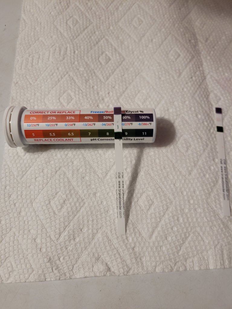

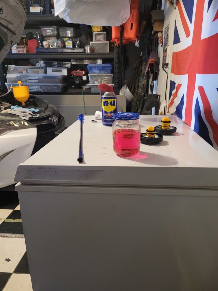

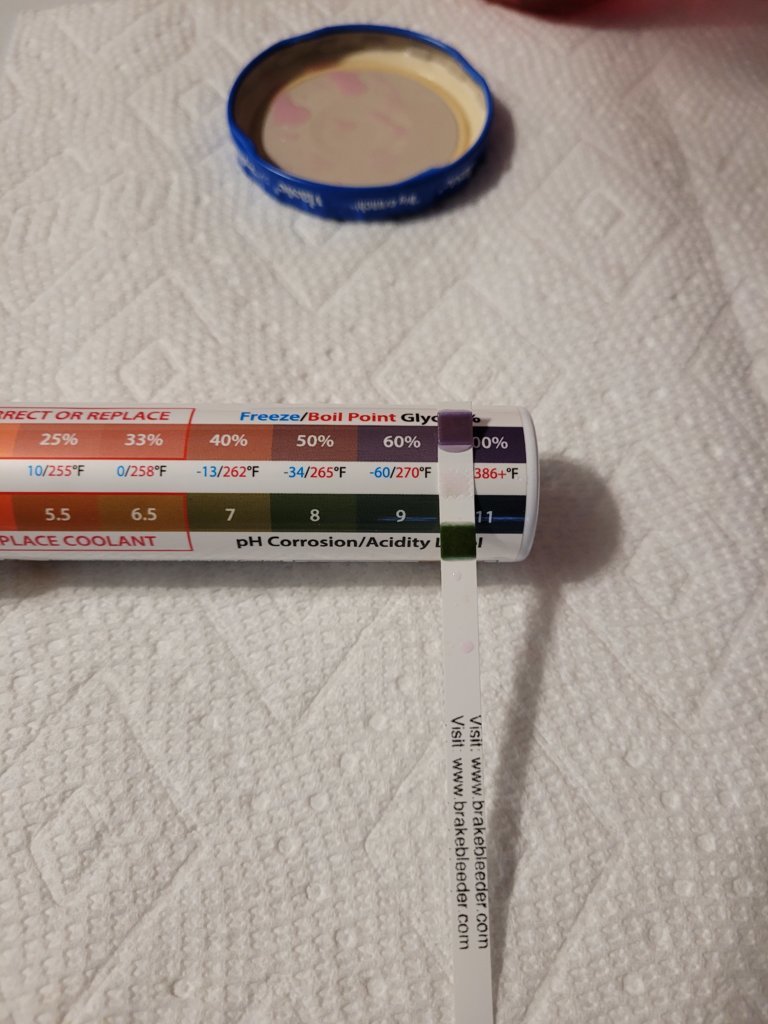

    This is out of a 2015 2GR Camry with 149,434k with day one OEM coolant. I'll test it tomorrow when the coolant testing strips come in.17259125758317648237170514116138.jpg
